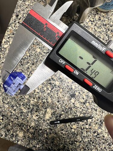

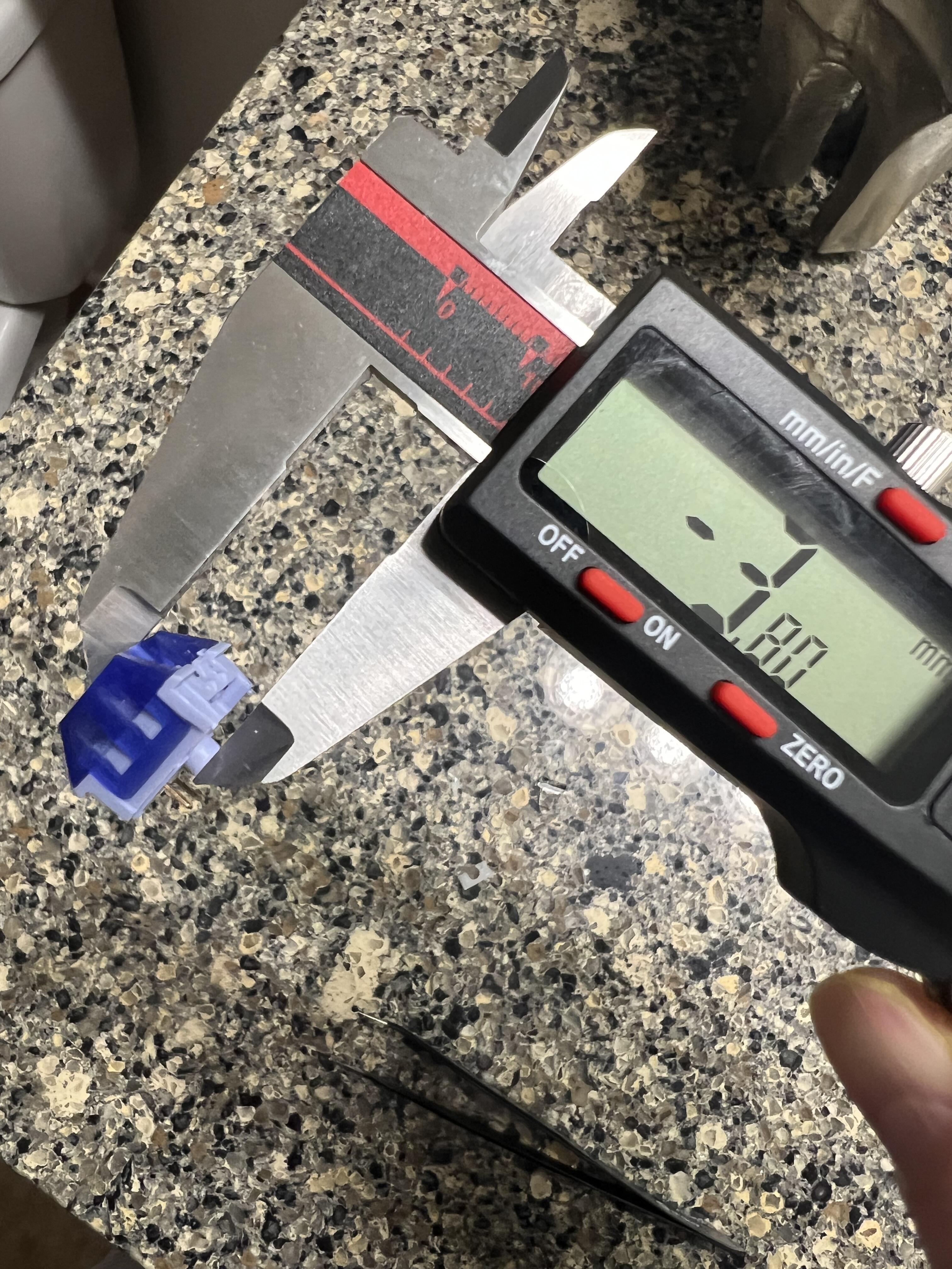

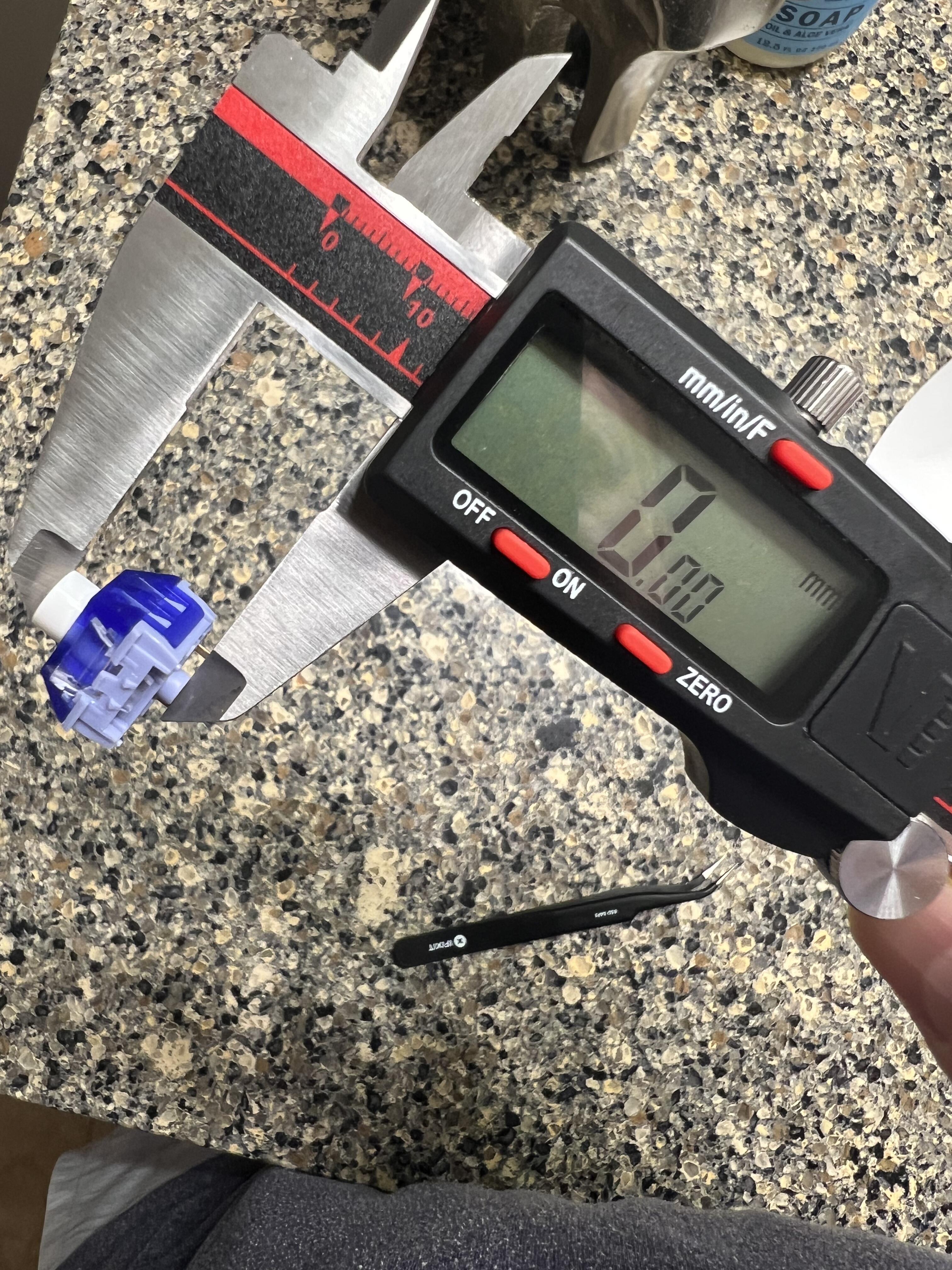

My Findings:
  • Stock 3.5mm
  • Bottom dampeners removed: 3.62mm
  • Top and bottom dampeners removed: 3.8mm
Here’s the calipers zeroed out just at the point of contact.
Then I depress the stem as far as possible
So the default travel is roughly 3.5mm

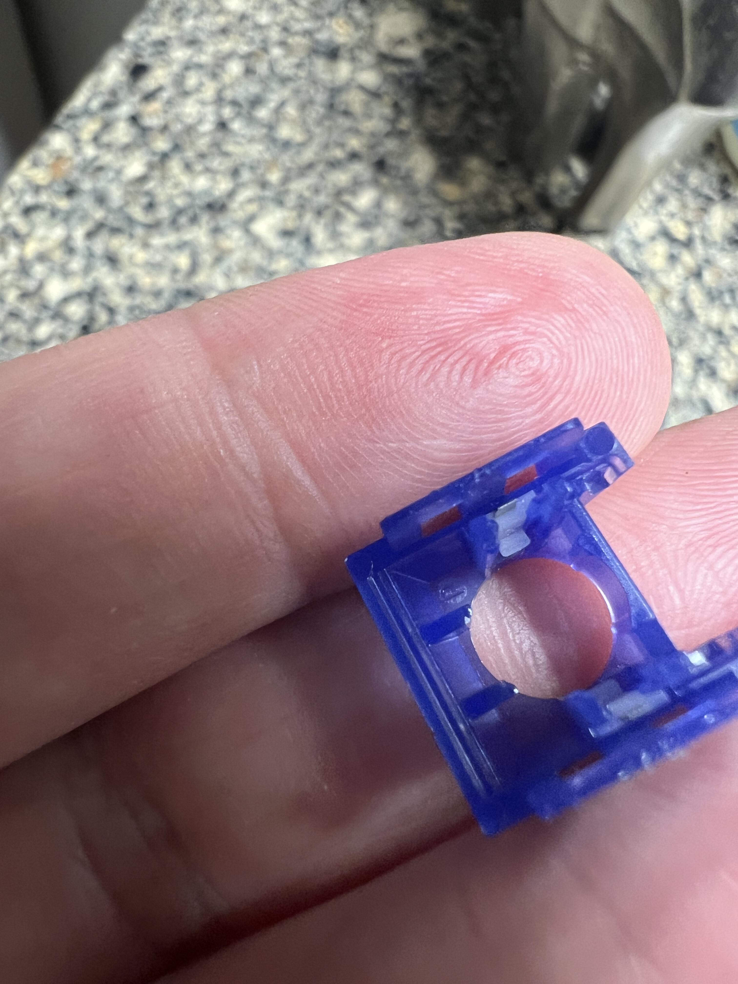

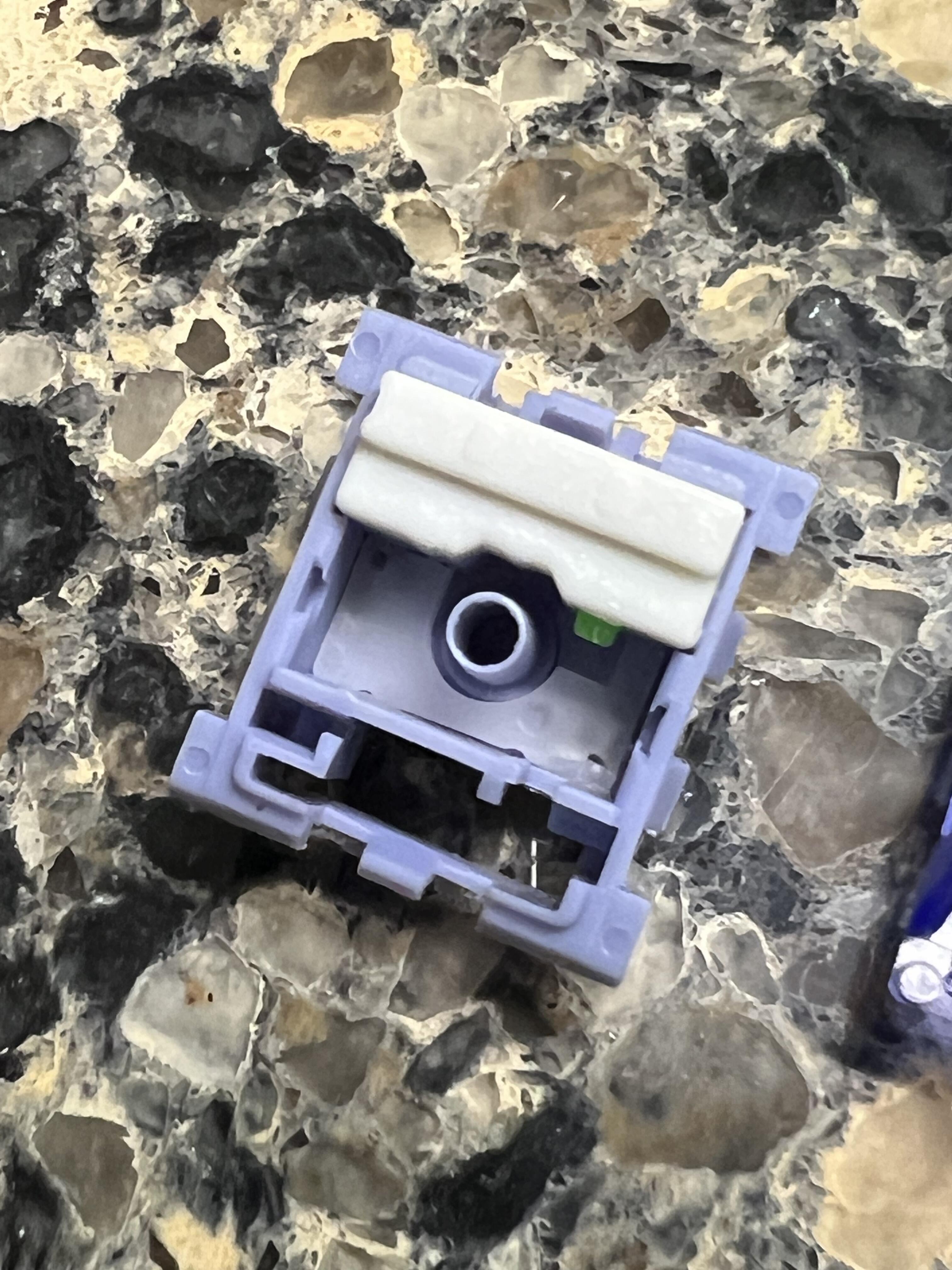

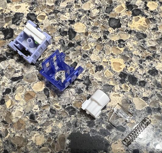

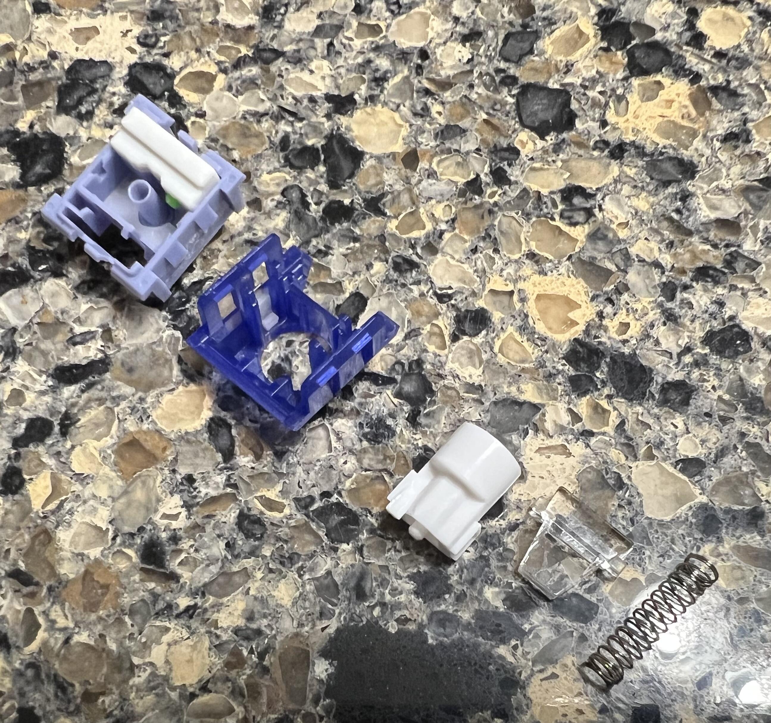

Here is the switch disassembled

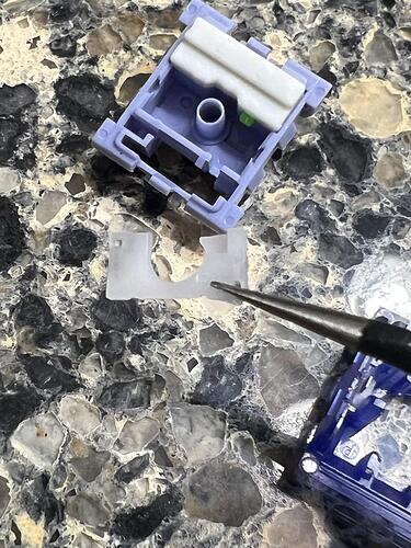

Here I remove the rubber part from the bottom
Here’s the result
3.62mm is indeed more travel

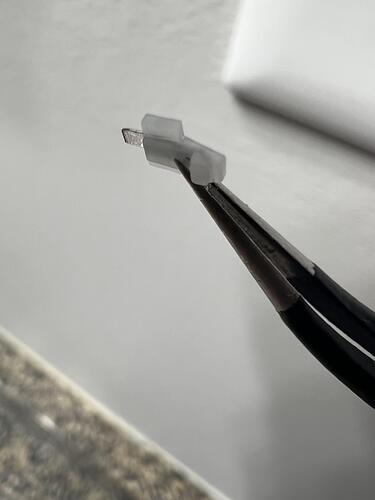

Now for the top housing dampeners
You get a full 3.8mm now with no dampening.
I hope that’s helpful.
