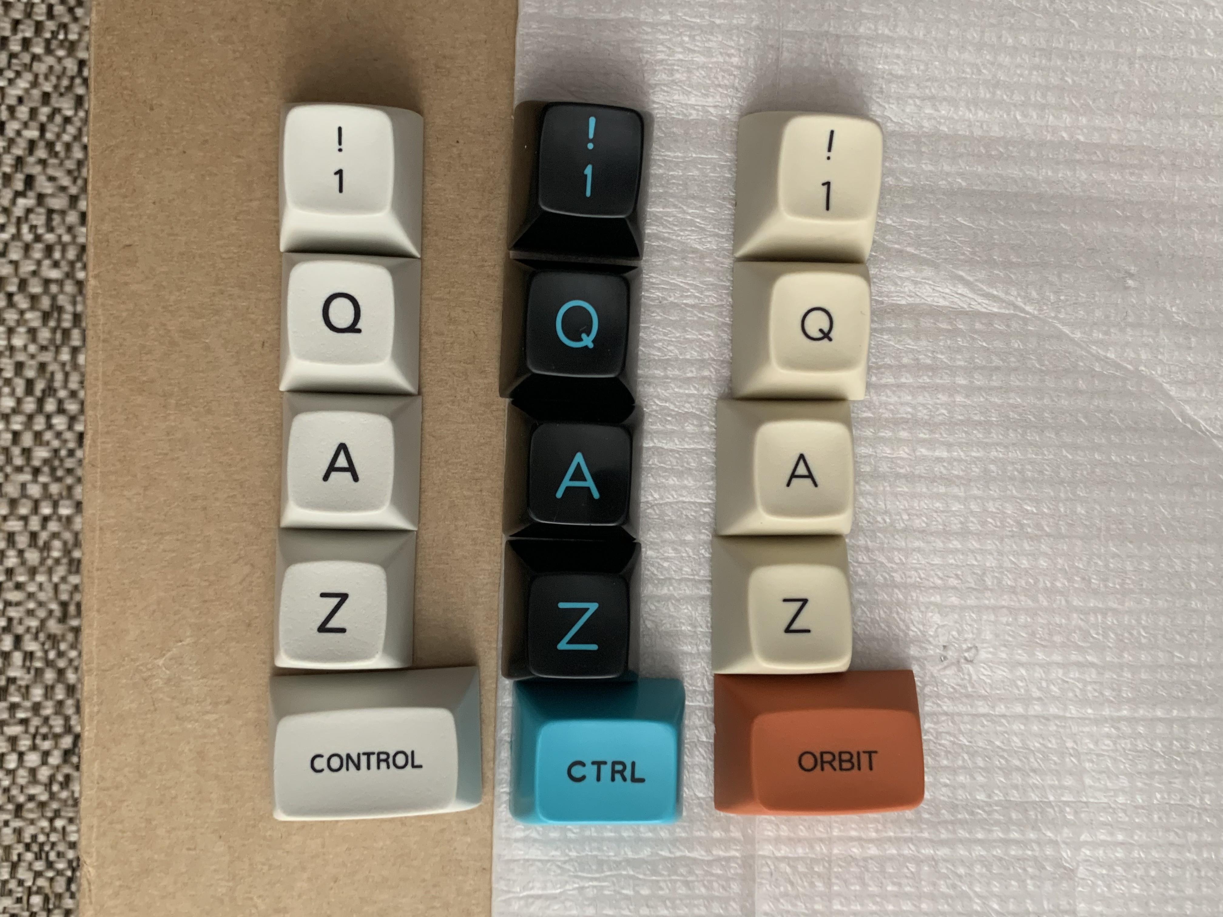

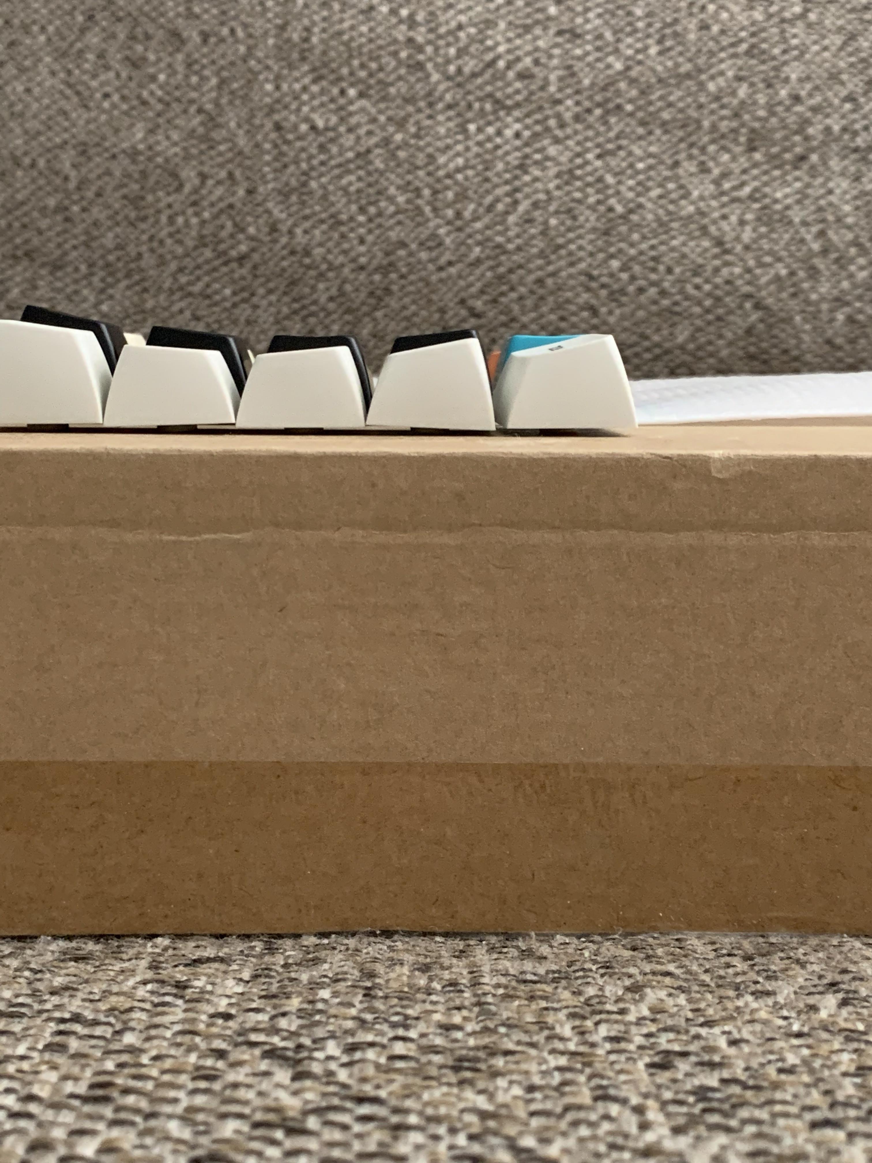

I compared these to SA and MT3 caps. Left to right is the new HiPro EC, SA Pluse, and MT3 Godspeed.

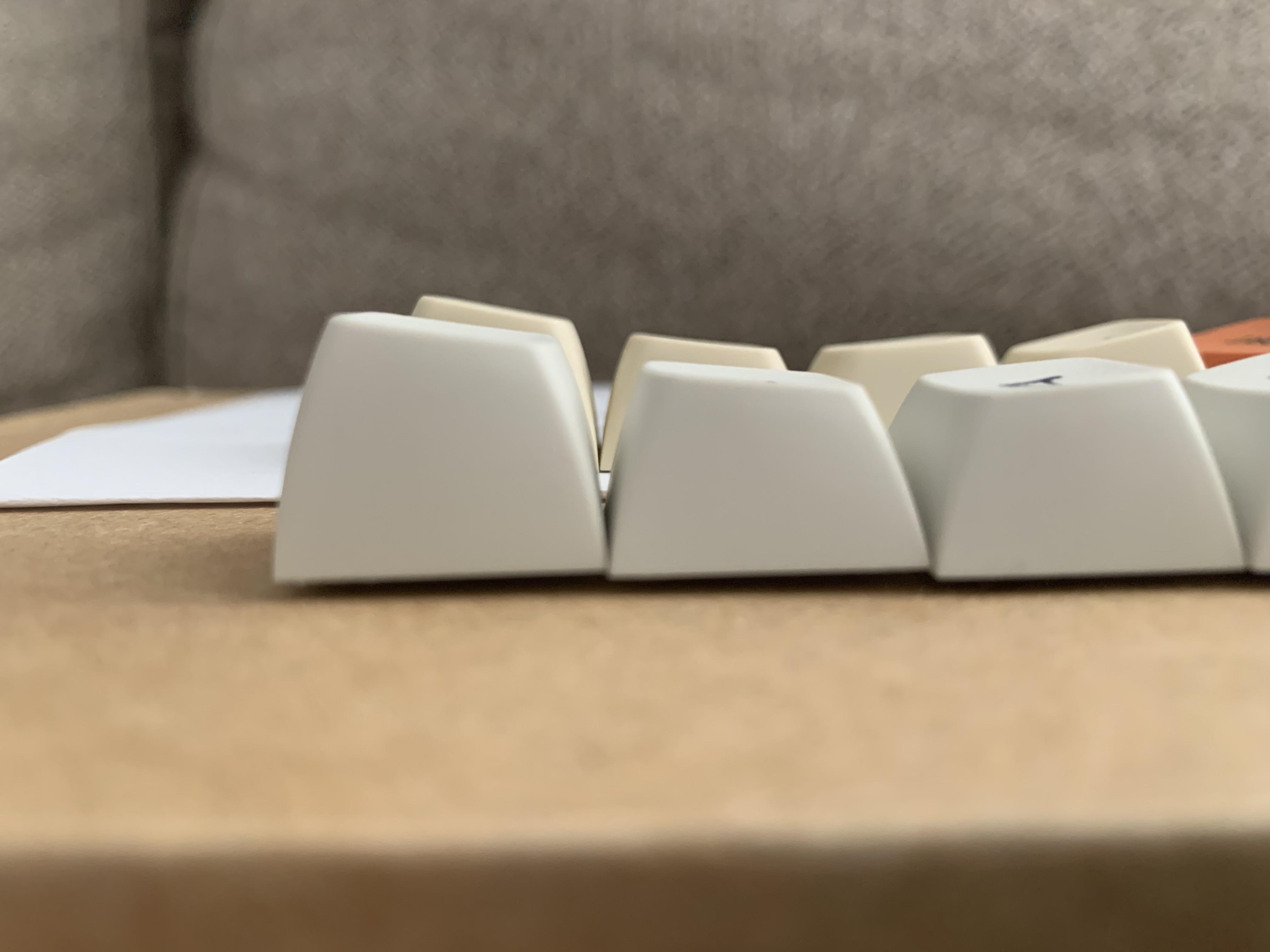

The profile view. Not the best shot. I will say they are very similar to MT3, with the exception of the z row, R4. HiPro have a less agressive angle.

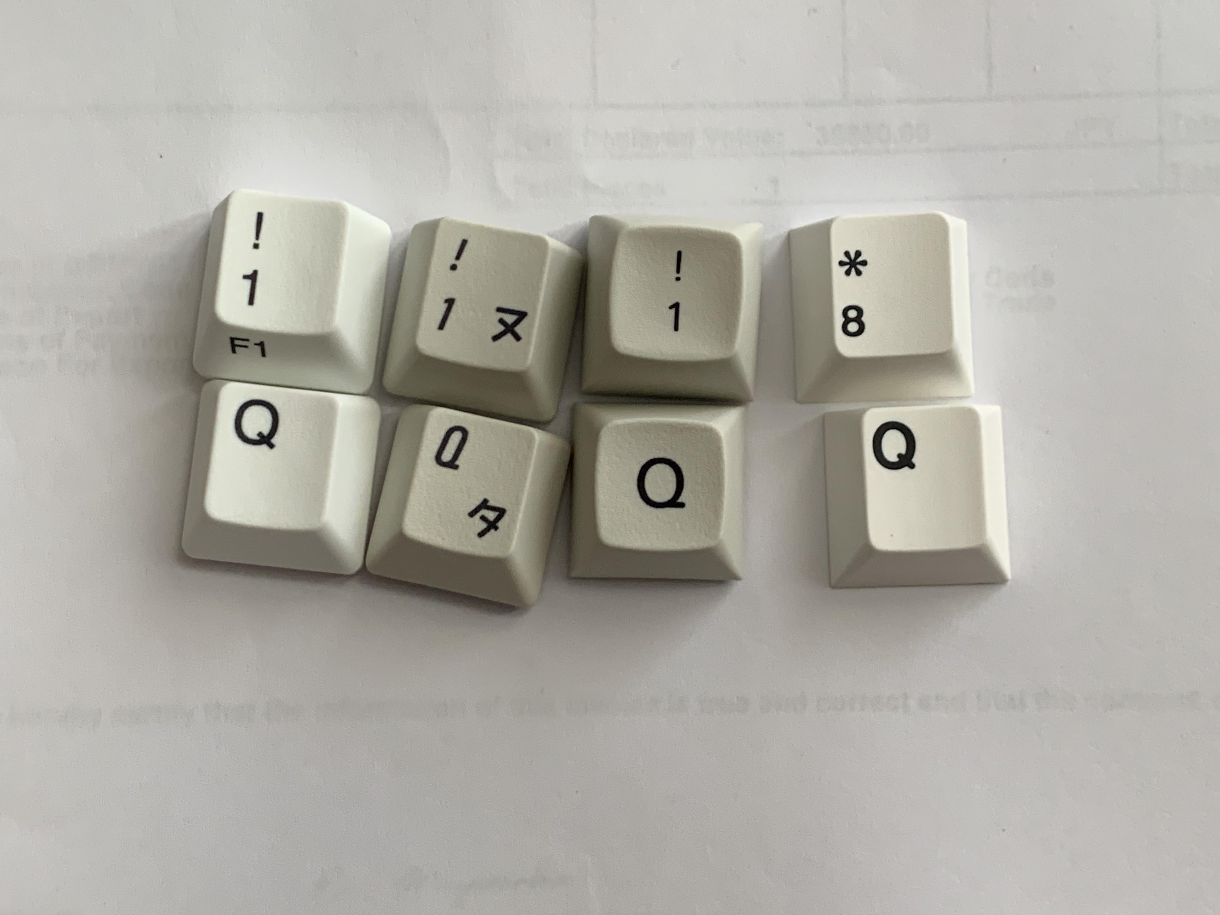

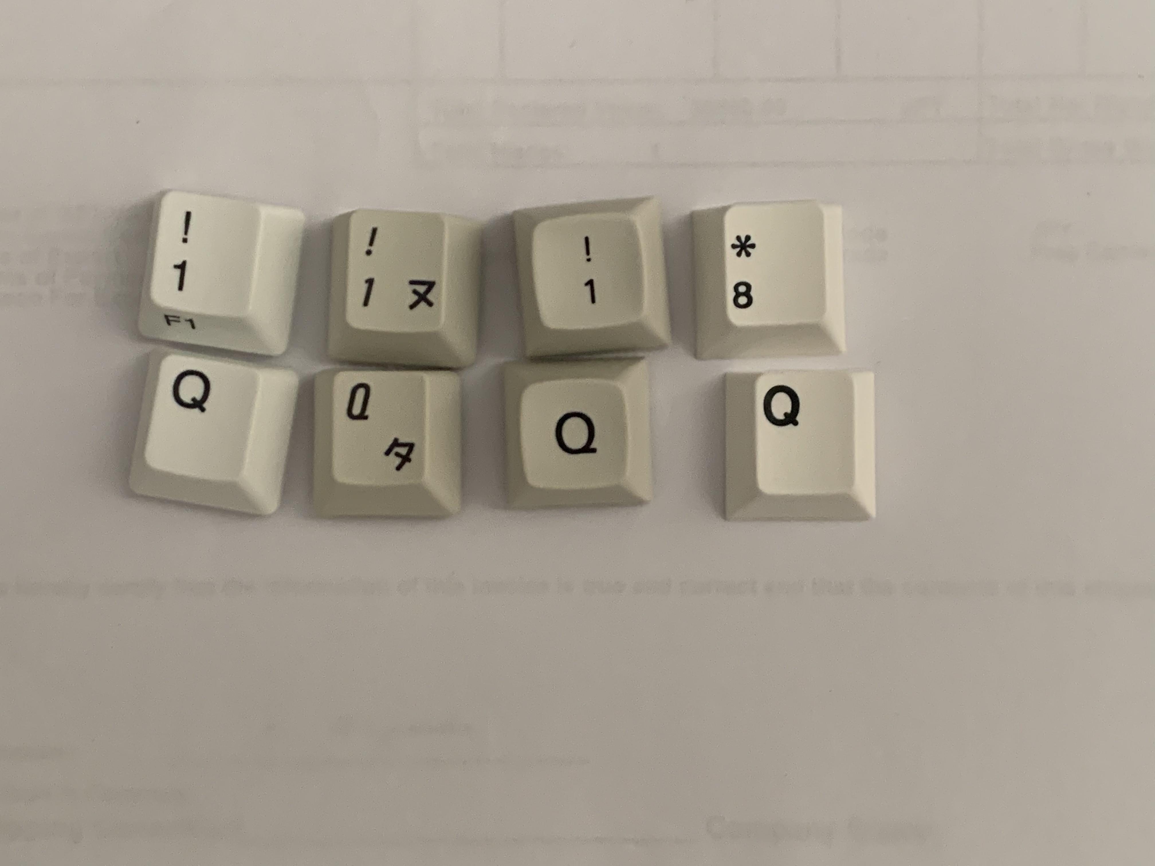

Here’s a shot for color. They are the same color as the EC Extended 2048 caps. Left to right is HHKB Snow White, EC 2048, HiPro, GMK minimal

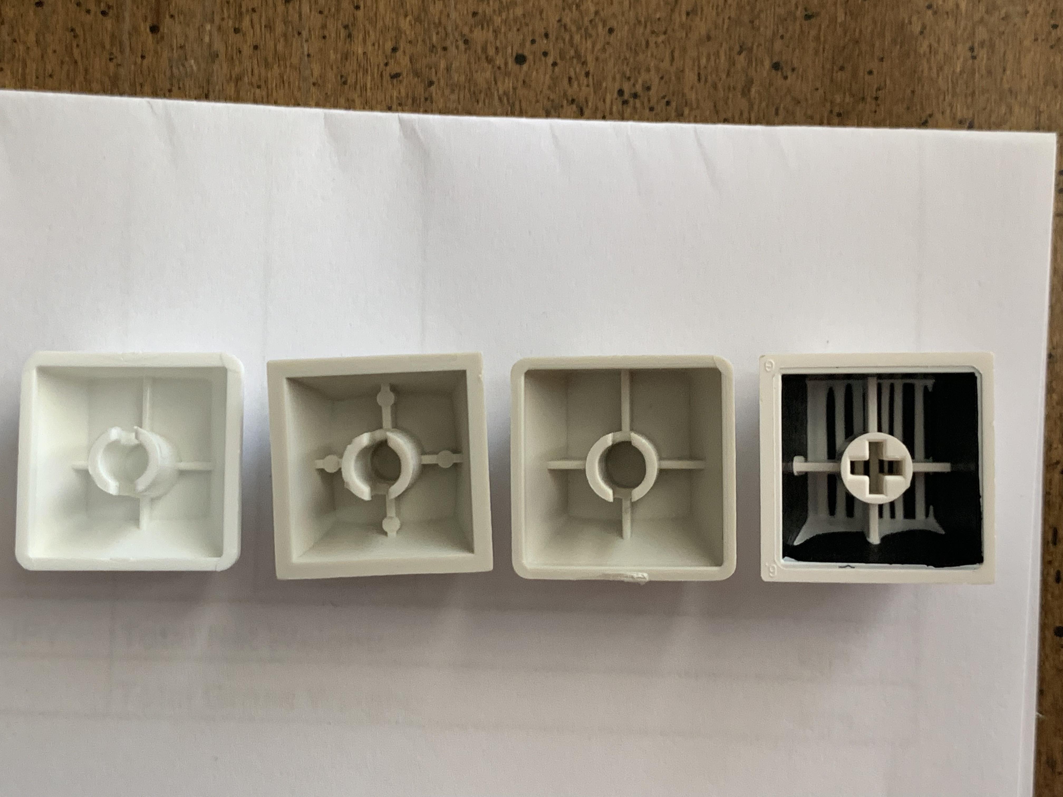

Thicker than stock Topre. Pretty much the same thickness as GMK:
Some crooked stems (see the Q here). These are mounted on the Snow White 25th anniversary HHKB for color comparison.
So, the big news here is that there is something wrong with the design. I couldn’t get the caps to snap in to the 2nd or 3rd row (Q and A rows). Upon close listening and feel, it appears they are contacting the housing somewhere.

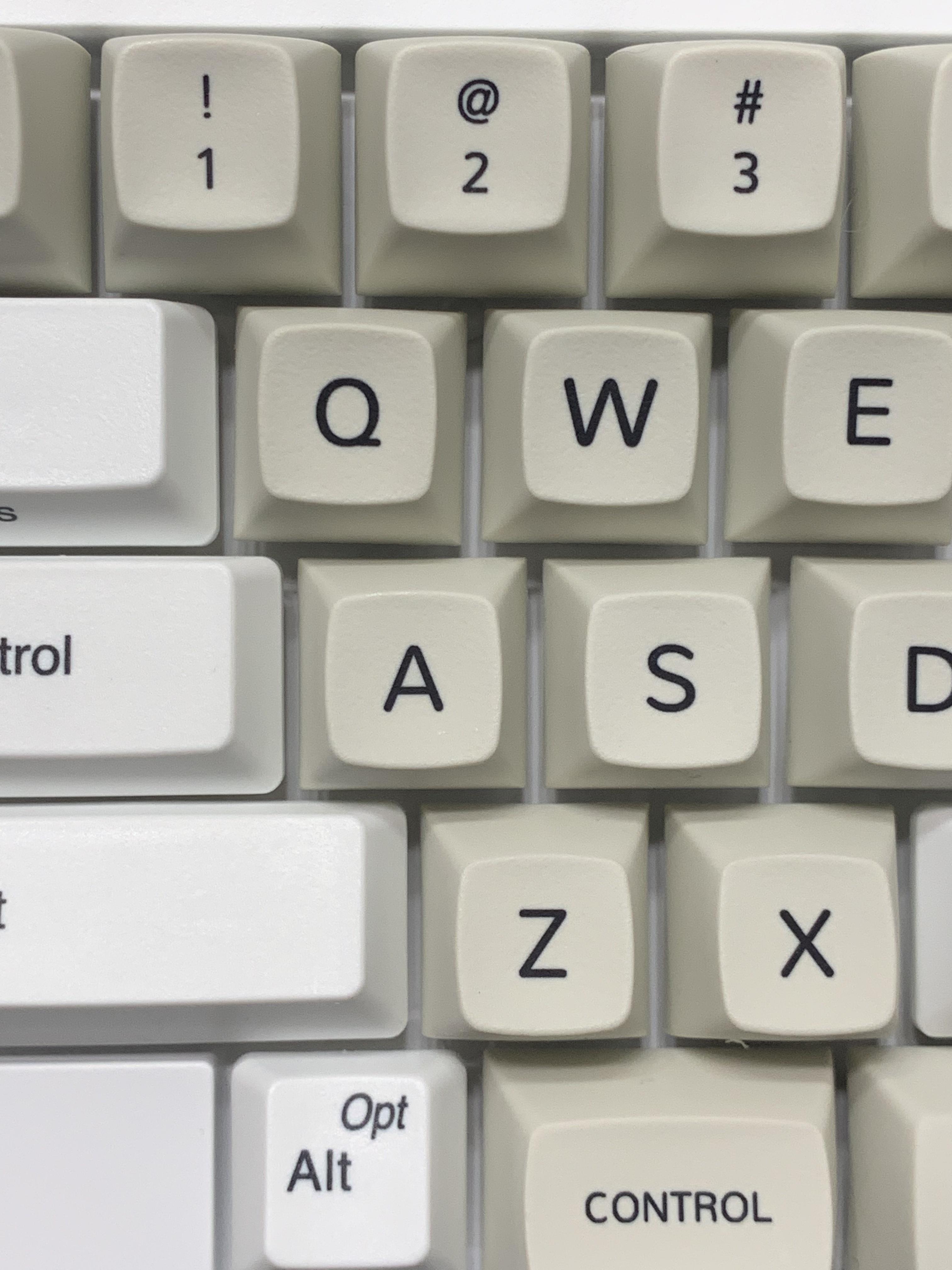

I bought these as a part of the GB, and would warn against picking these up, unless you are ok with crooked keycaps or plan to make stems straight yourself.

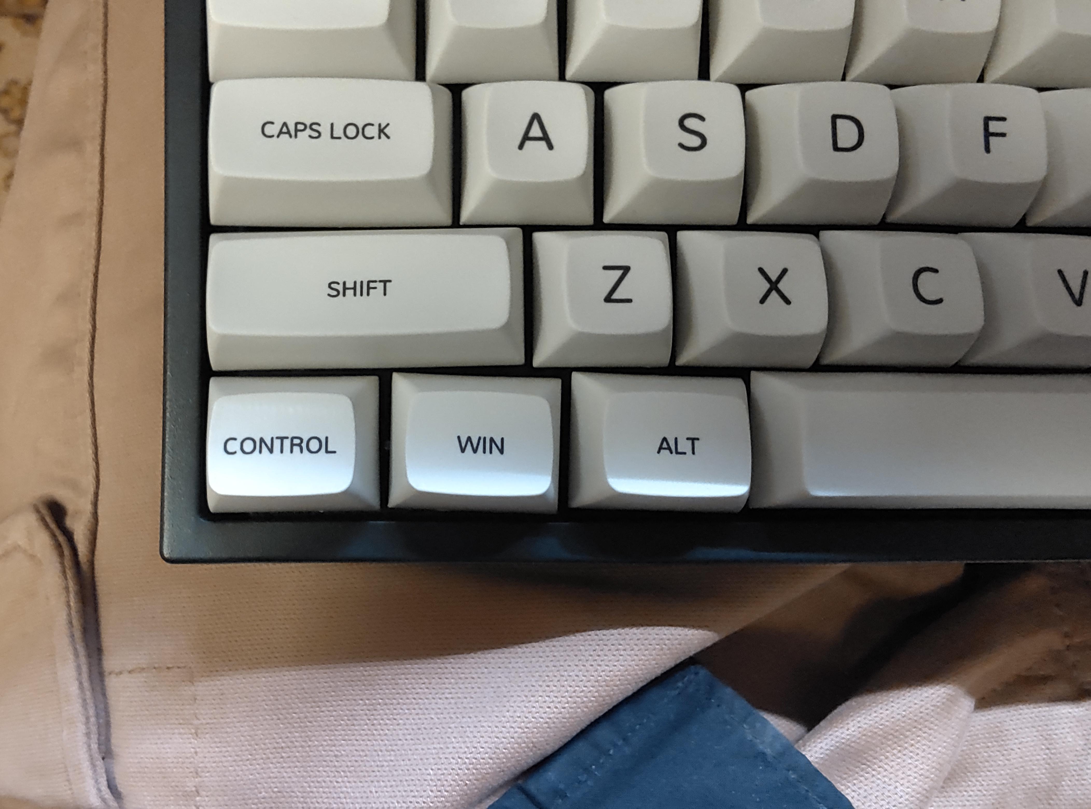

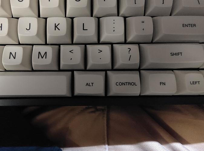

Below are some photos of caps mounted on a fc660c:
Summary
The crooked stems are especially noticeable on 1.25u caps. Kbdfans have denied my refund, stating that they don’t have any problems on their end.
That being said, the caps are made of PBT, so straightening up the stems with hot water is possible.
What a shame, the caps do look and sound fantastic, if not for the bad stems.

Got mine a little while back… The R2 R3 keycaps are the issue. Seems like the stems do not protrude out enough (or the walls of the keycaps are too “too tall”) causing the wall of the keycaps to hit the switch plate on the HHKB… Its such a shame… otherwise I like the color, lettering and the texture of these… I will keep mine and probably sand down the key cap walls to see if that works but it’s going to be a very arduous task… Though when I put these on my HHKB I have no issues with crooked stems, I must have gotten lucky.
Perhaps on the the Type-S the silencing rings make the stems shorter and causing the issue.
Silenced Hybrid here (not me, the keyboard).
About seven or eight crooked stems in total, all alphas, between R1, R2, R3. Mods are fine.
R2 and R3 quite clacky and contacting the bottom plate.
Quite a few didn’t properly click onto the stems when installing.
Not great, not terrible.
