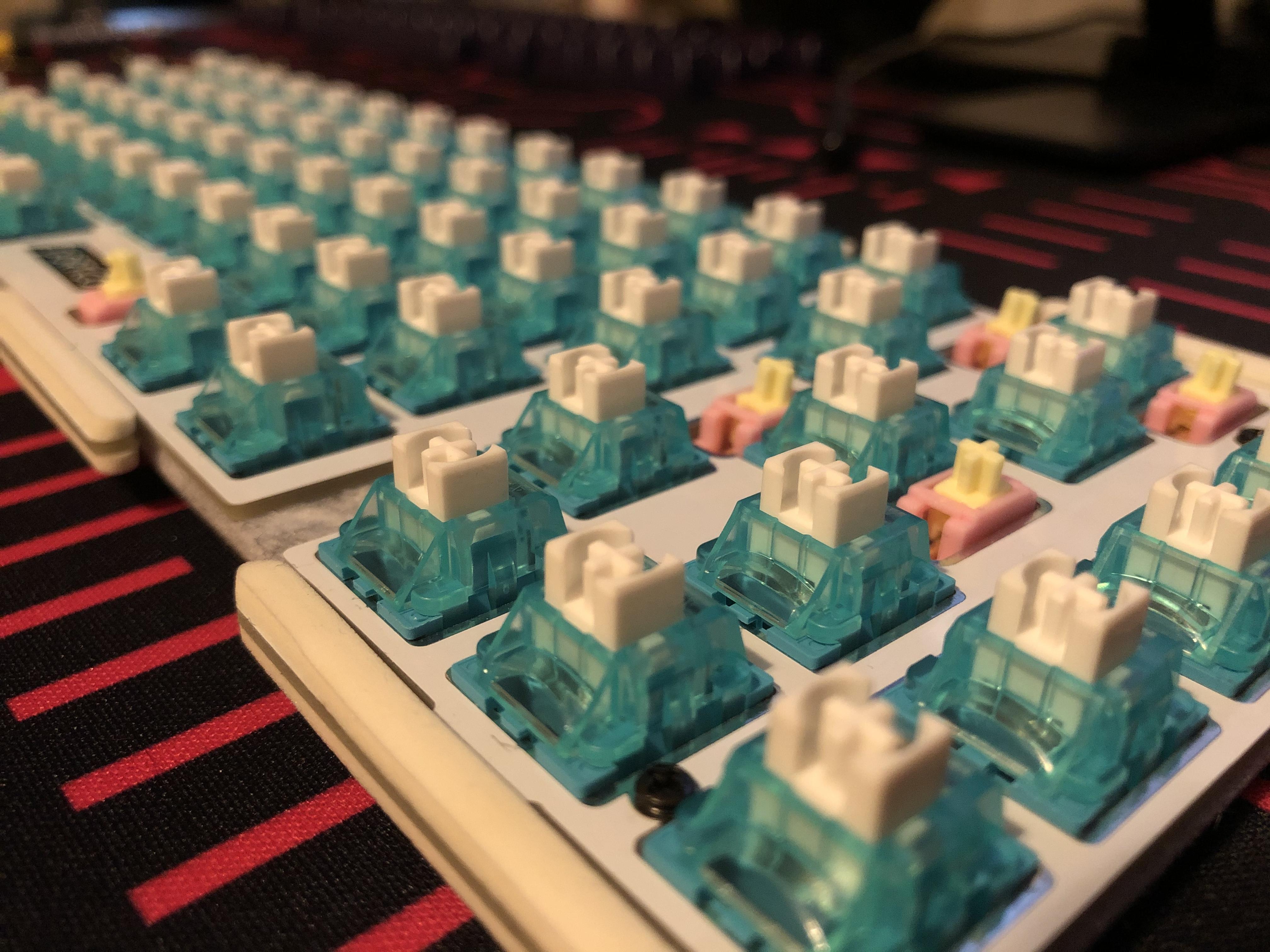

To my eye, these look identical to TTC Gold Pinks - but instead of a featherweight spring, these have longboi dual-coil ones.
They compare these to TTC switches but don’t name the manufacturer - I’d say it’s either TTC, or another, smaller one utilizing tooling supplied by TTC.
If these stay $0.25 - $0.30 apice and continue to be readily available, I think they might make something of a splash.
They look really nice. I wonder if they’ll ever plan to make 5 pin variants.
If these are good they could be titanic, but I worry in making such a cost effective switch it could really sink
The stem and shape of the housing totally look TTC - but I do see that these have wing latches instead of the four smaller clips TTC’s usually have. Kyoorious.
They are made by A-lion and manufactured in house by them afaik, the housing is branded Aflion. I’ve been playing around with them for… i think a month or 2 now? Way before Keebmonkey were even a thing as far as i know, so that affiliation is a bit…confusing to me if not a bit weird. They have a very unique sound imo, and they feel quite nice but are a bit lighter than i prefer.

I’ve had mine for a few days, typing test here.
I haven’t used them enough for an in-depth review yet, but for 25-30 cents they’re very solid. Very stable N/S and smooth as well; just a light bit of hushed texture in the press - a good bit less than average. Definitely a budget contender worth considering, at minimum.
I don’t have a “standard” one to compare it against so I can’t comment one way or the other about KeebMonkey’s input here, but either way it’s a totally decent 3-pin linear.

I’ve been using the Icebergs for a few solid days now, and I have to say, they really are very good for the price. If the main claim in question is whether or not these give the venerable Gat Yellow a run for its budget-king money, well… yeah - I think they do.
General bullet-point notes:
  • Smooth, stable full-travel linear
  • Inexpensive, good value
  • In terms of feel, between TTC Gold Pinks (skate, harsh bottom-out, high-pitched) and MMK Frogs (almost butter, kinda soft bottom-out, lower pitched)
  • Light, consistent texture; noticeably more smooth (and stable) than most linears in its price range
  • 3-pin, SMD back-lighting only
  • Not plateless friendly, but will fit just about any hot-swap
  • A little bit of metallic noise
  • Factory lubing is competent: bottom-out has the edge taken-off without being soft; slick feeling
What’s not clear to me is the exact role KeebMonkey had in shaping the final product - but regardless, the Aflion Icebergs are genuinely competent 3-pin switches being sold at a good value. The description KM gives of these is pretty accurate; they’re smooth like newer TTC linears, but less harsh - somewhere between a TTC Gold Pink and a Momoka Frog in terms of sound and feel. Not as smooth as pre-lubed JWK’s, but more smooth than dry ones.
They’re a hair light for my personal tastes, but totally satisfying in terms of user-experience.
VS Stock Gat Yellows:
  • Lighter weight
  • Less scratch feel and sound
  • Less spring ping and rattle
  • Bottom-out sound and feel a bit more solid
  • Wobble is comparable; travel feels more stable on the Iceberg
  • Yellow needs tuning to be good, Icebergs decent out of the bag
Here’s a recording of the switches:
Some Gat Yellows recorded in the same board for comparison; last few seconds might be the most informative with slow deliberate presses:
Uncomplicated conclusion: If you’re looking for a smooth linear and wanting to make the most of a tight budget, well - you could do a whole lot worse than KeebMonkey’s pre-lubed Aflion Icebergs.
