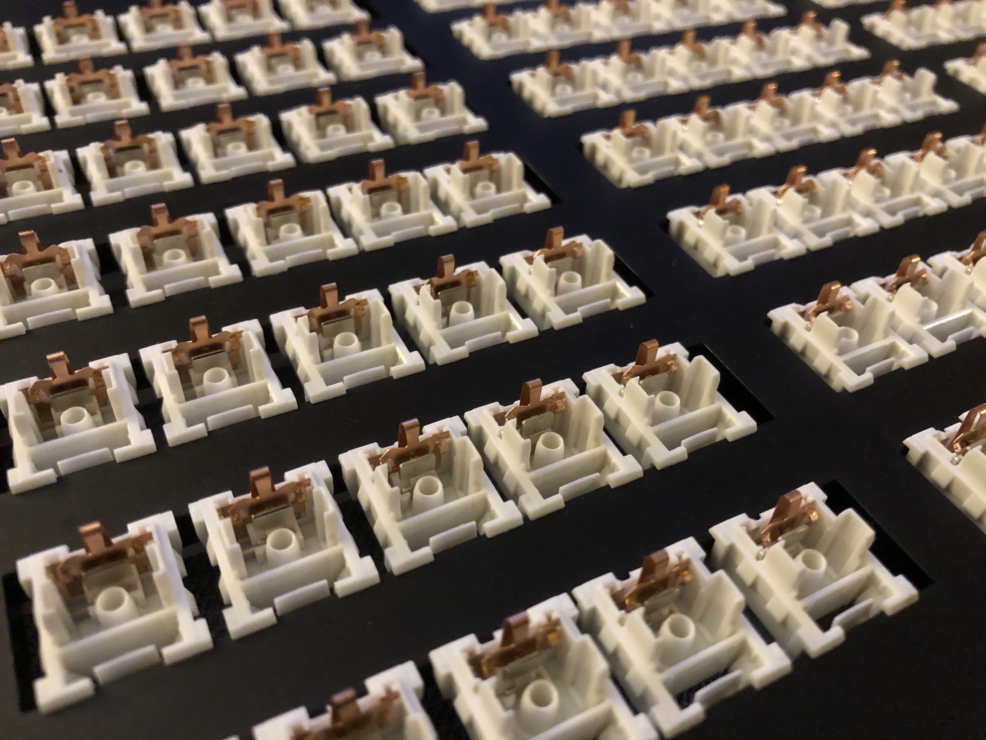

Tuning and assembling 105 Halo U4 switches for a friend’s build.
- Clear U4 stems*
- 62g gold-plated springs (KBDfans, iirc)
- Deskeys gaskets
- Giving Krytox 106 a try this time
I’ll be slowly picking at these through the day while enjoying some keeb videos.
*The clear version of these stems are slightly different from the solid white ones that come in Bobas - I’ve found them to be just a bit less tight and tactile, which my friend prefers.
