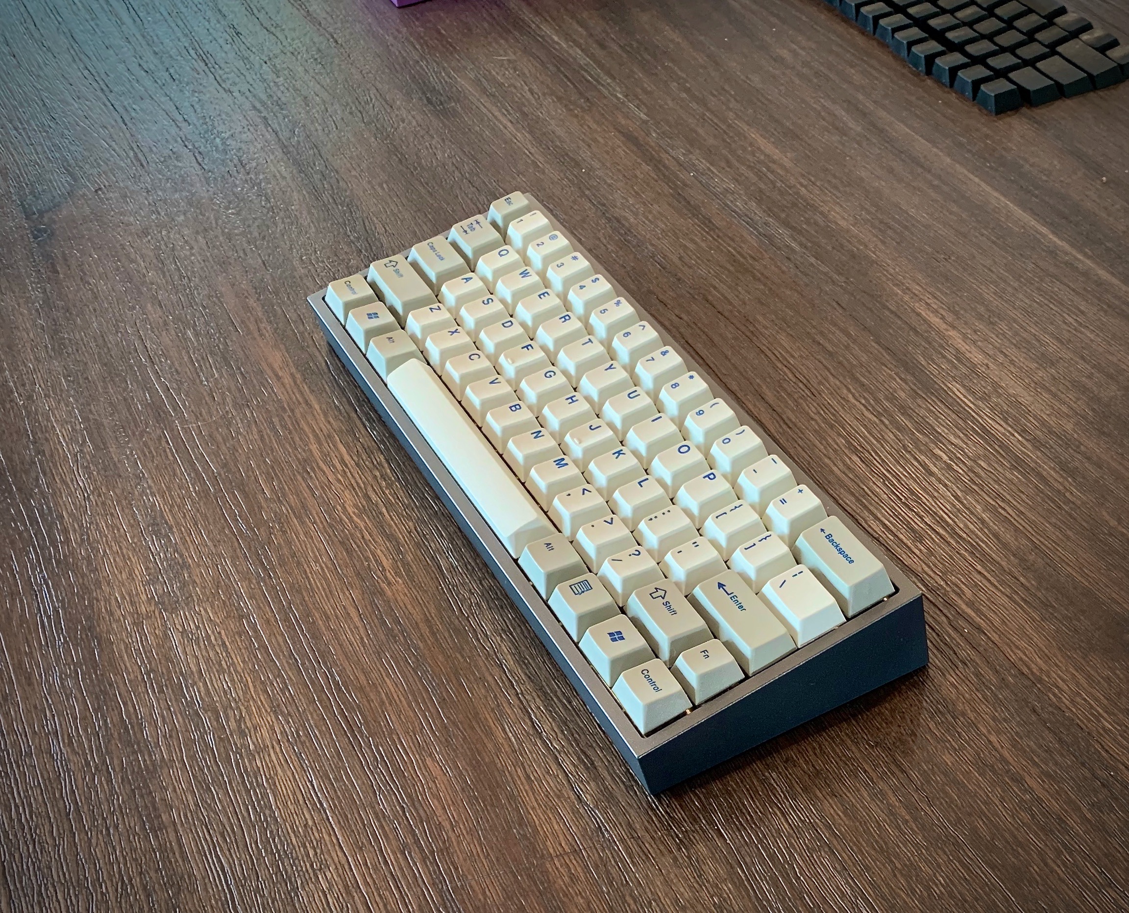

My current project is spring-swapping boards with stock Kailh box blacks with TX 50g springs. It has made a HUGE difference and made me love typing box blacks again!
Here’s a photo of an old Klippe with freshly spring-swapped box blacks. In the background are some blank POM keycaps that have been thoroughly washed and cleaned before going on my other Klippe with spring-swapped box blacks.

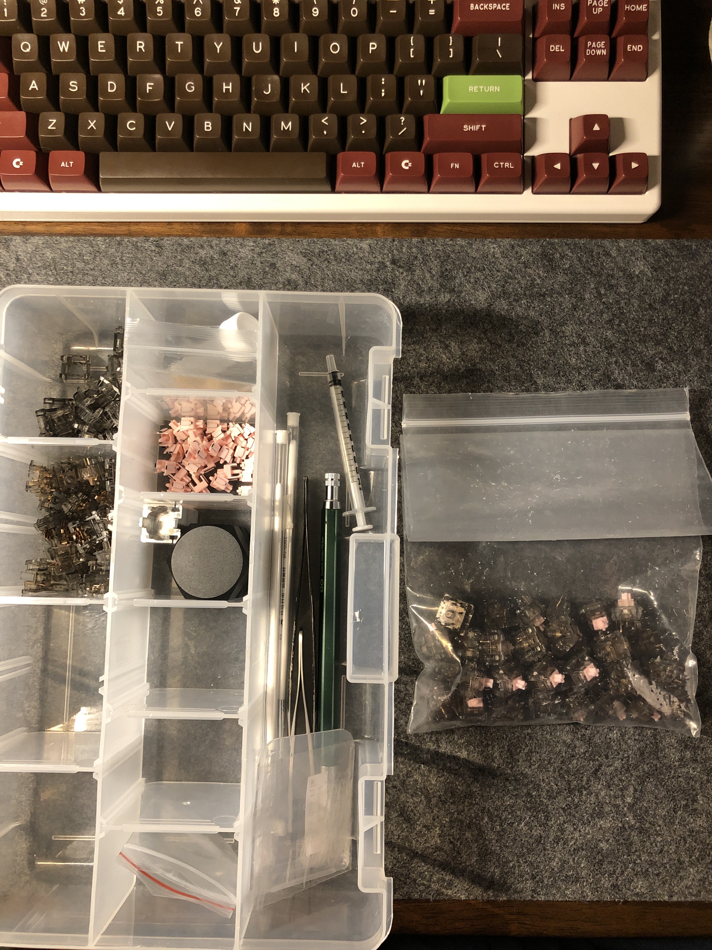

Working on my backlog of modifying and lubing switches. Right now it’s Silent Alpacas with switch films, 3204 and 106 on the springs.

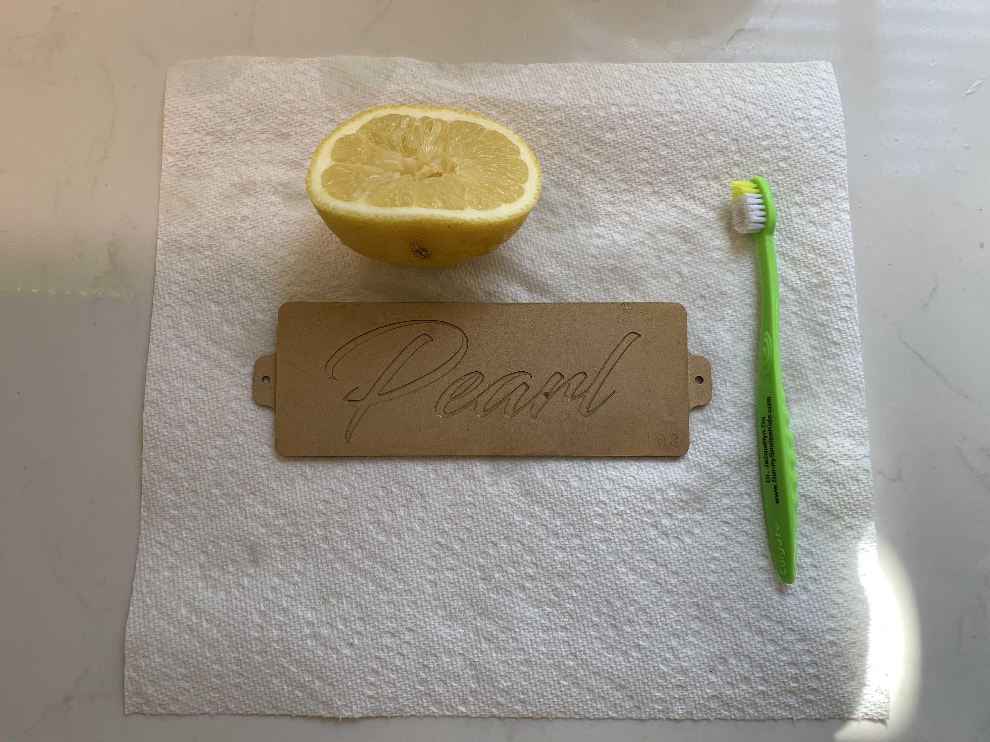

Pearl Restoration project. Part one, polishing up the weight with lemon juice and toothbrush.

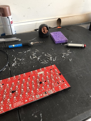

Put this one off for a year. Link to build log: Took a crack at the DSI keyboard
Wife: Honey, where have all our sponges gone?
Me: :no_mouth:

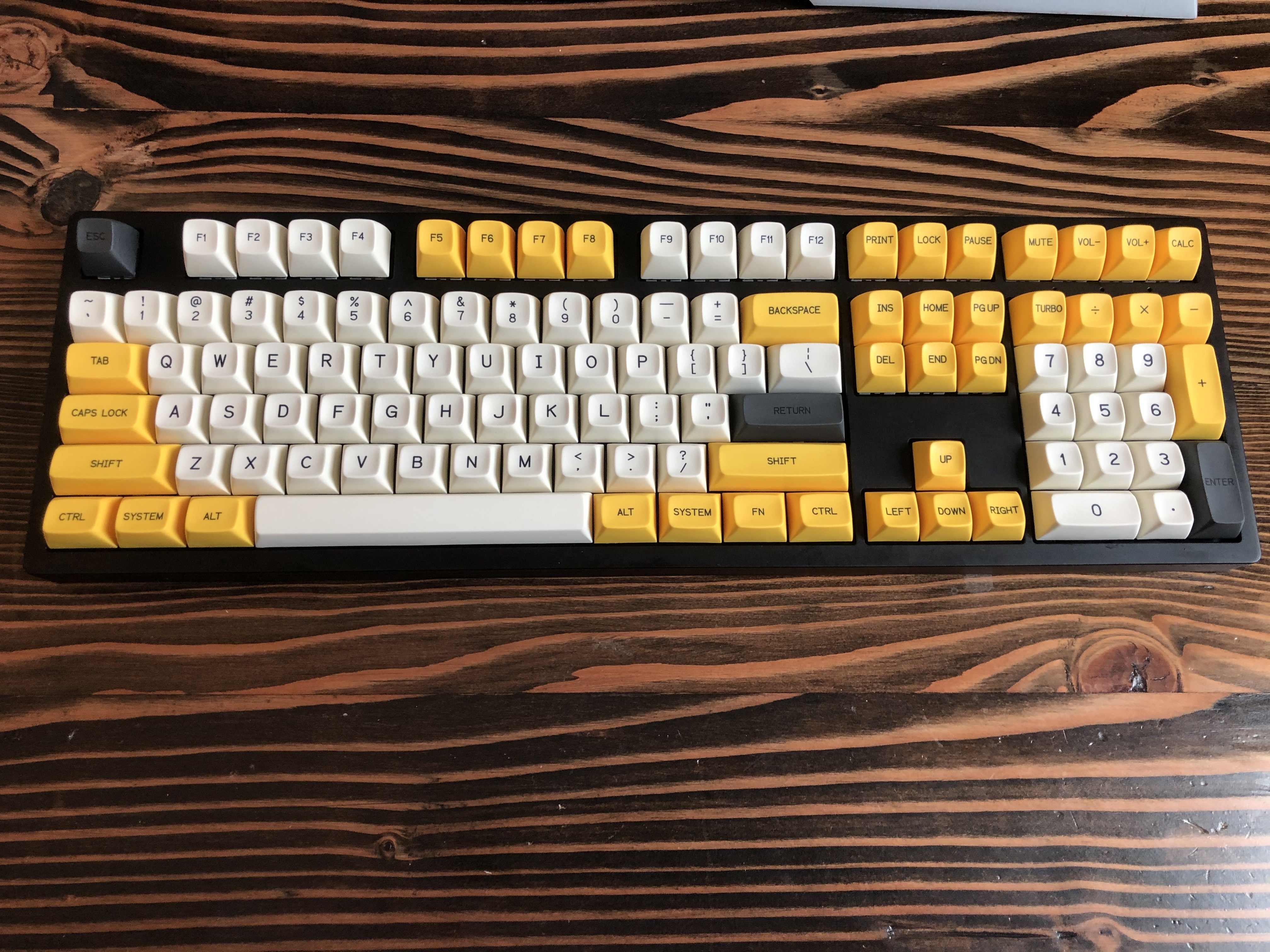

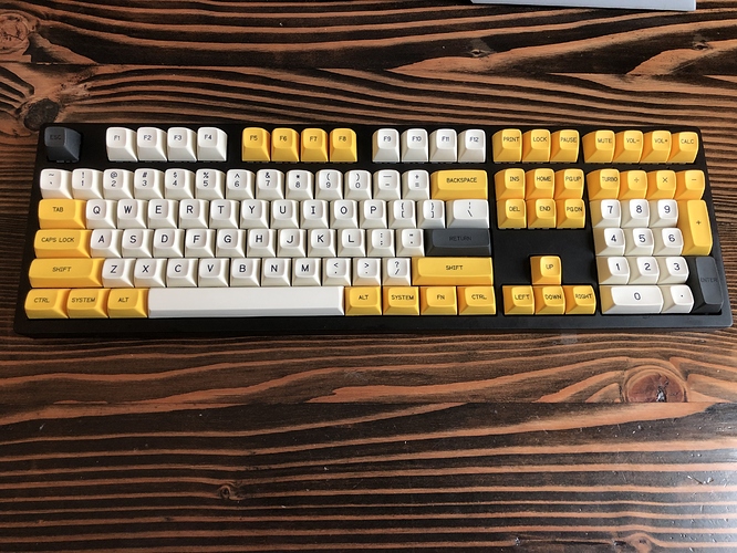

Here’s the finished product. iKBC MF108 with box pinks. Stabs clipped and lubed.

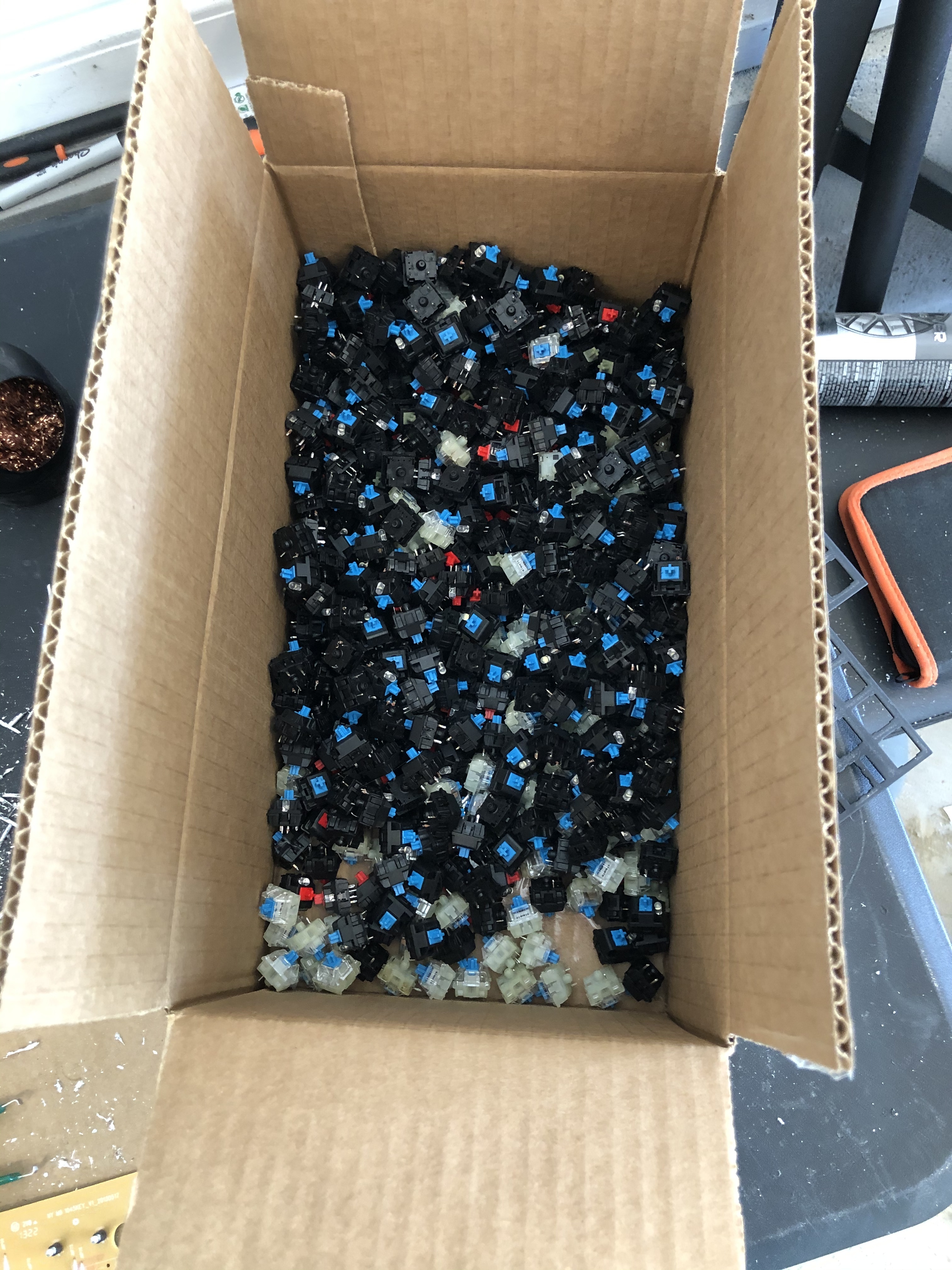

I got the blues
That’s a lot of blues
How many actually is that? What are you doing with them?
At least 400, probably more. They are all desoldered from project boards. I’ve got some MX reds and some red equivalents from a Das Keybaord. I’ll probably sell them for like 15 cents a switch plus shipping.

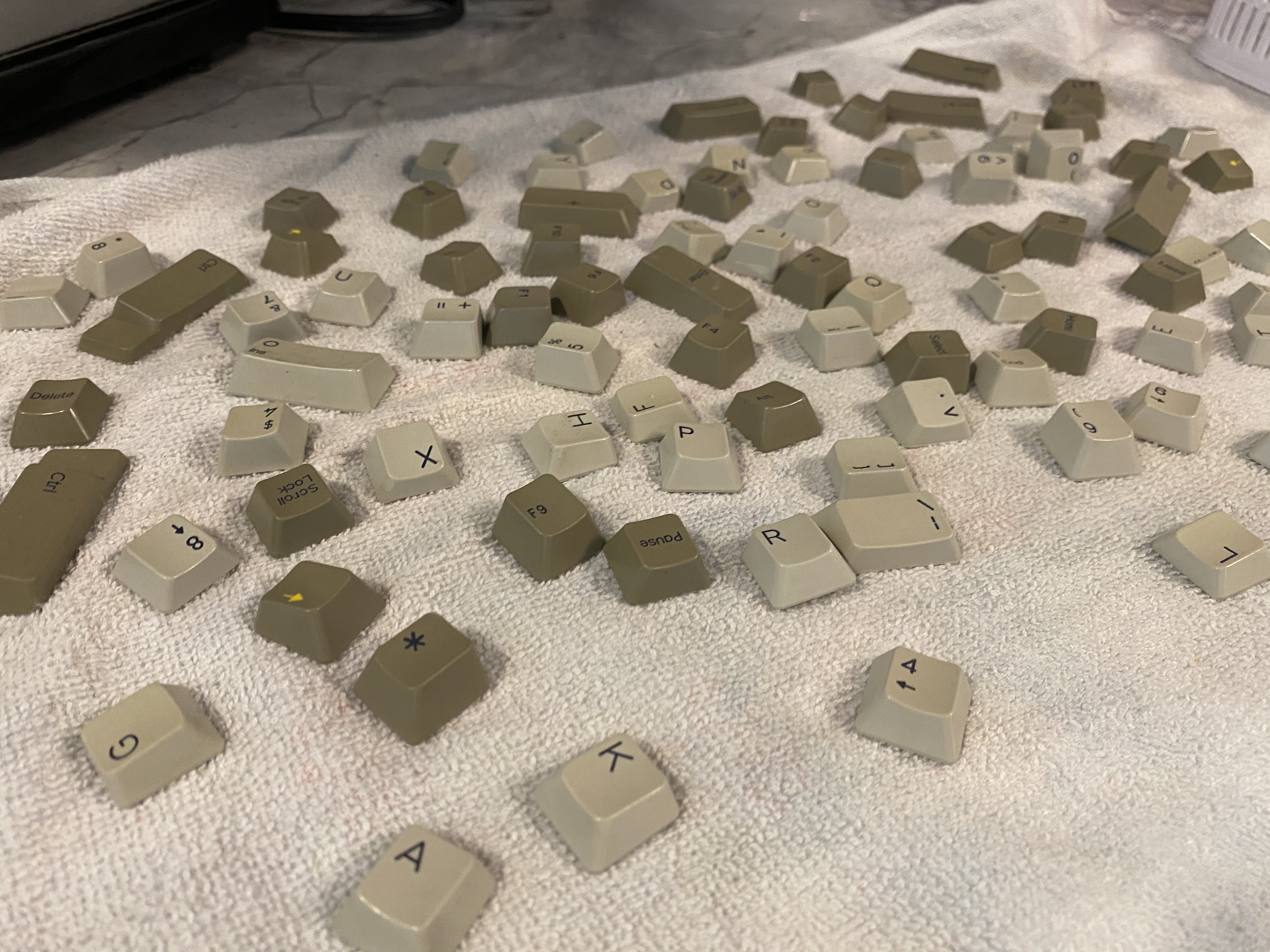

Cleaning some vintage DCS caps while on conference calls.
