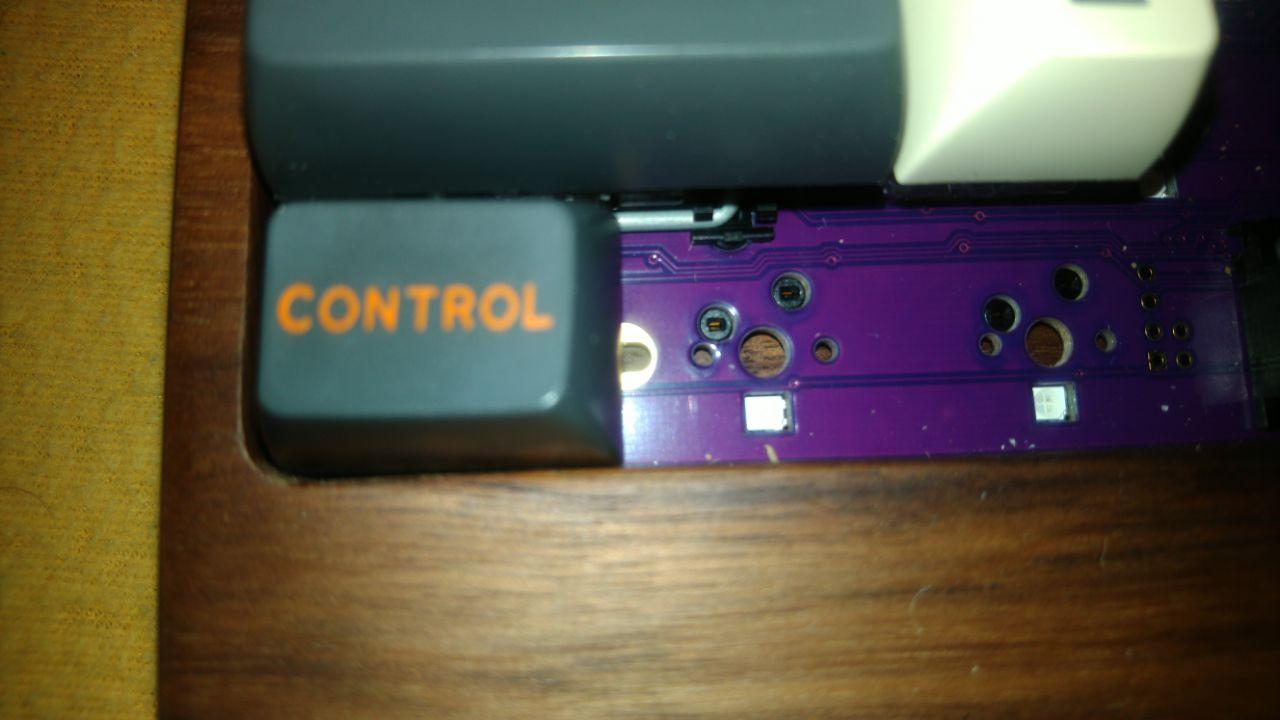

  • Two 60% builds in wooden cases with hotswap, a GK64 layout (i.e. a cursor key block in the lower right corner and 0.25u offset between all alphabetic key rows) and being fully programmable.
    • Still have to find a PCB with all these features.
      • The GK64 PCB itself is not not QMK-compatible.
      • There’s a DZ60 variant which supports the GK64 layout, but it is not hotswappable.
      • The hotswap DZ60RGB PCB does not support the GK64 layout.
      • I probably need to get a non-hotswap, fully programmable PCB (likely the non-hotswap DZ60) and make it hotswap with Millmaxes.
    • Nevertheless I put in a DZ60RGB PCB to get it at least into a usable state for now.

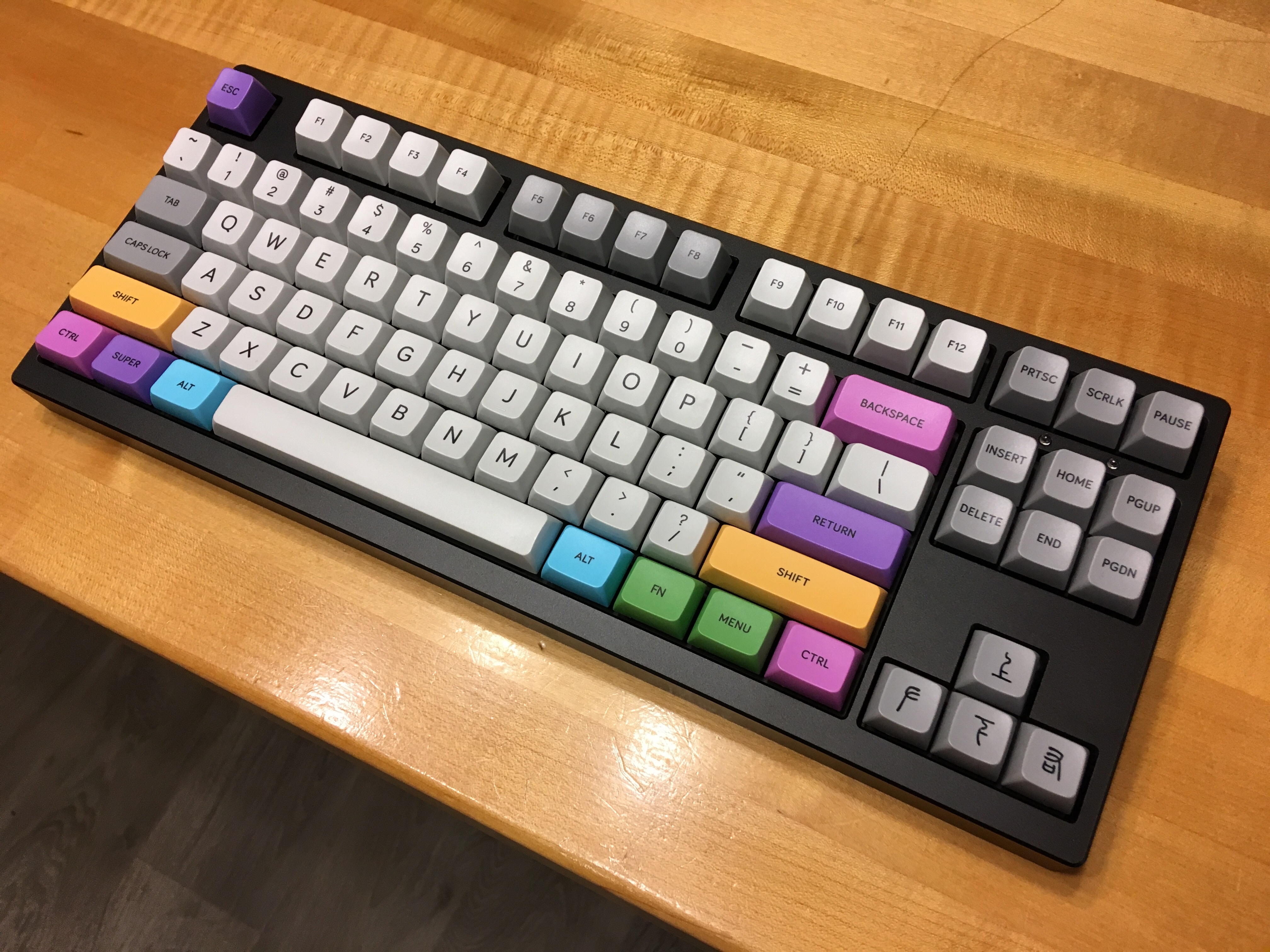

    • Haven’t even started the sister build of the project shown in the pictures: It is planned with the same PCB, but inside a wooden Datamancer case with lid.

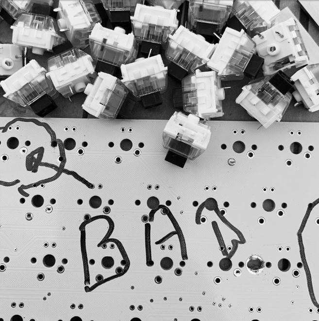

  • A KBD19X where I started soldering in Millmaxes, probably destroyed one lane or so while doing so, and then also noticed that the plate doesn’t really work properly for hotswap sockets. I guess I have to order a second PCB and write off the money I paid for these Millmaxes. And then I’ll have to finally decide which switches go in — which doesn’t make it easier to continue on that project.
