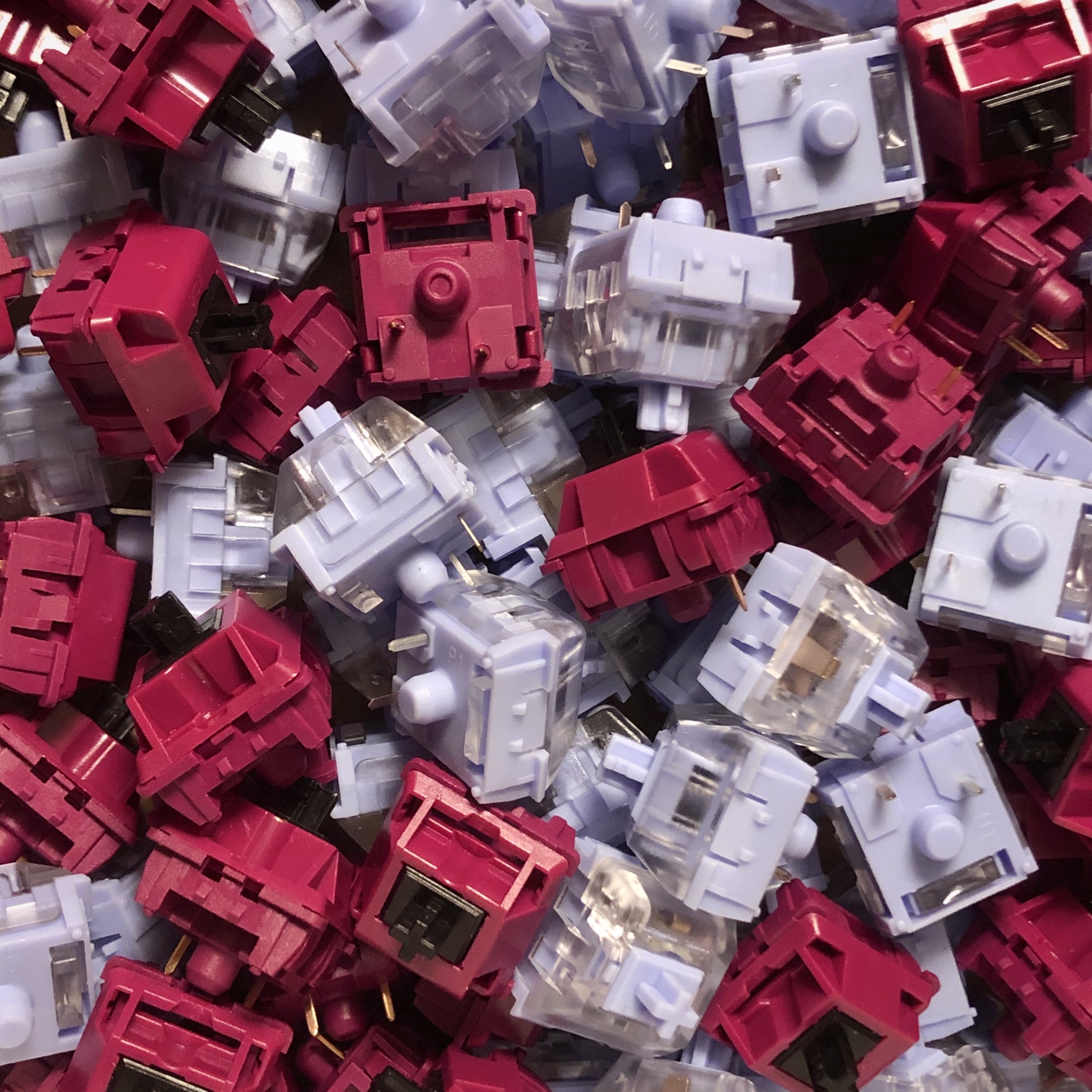

A satisfying batch of Poli Pandas featuring YOK Red Panda housings, Polia stems, and Kiwi springs.

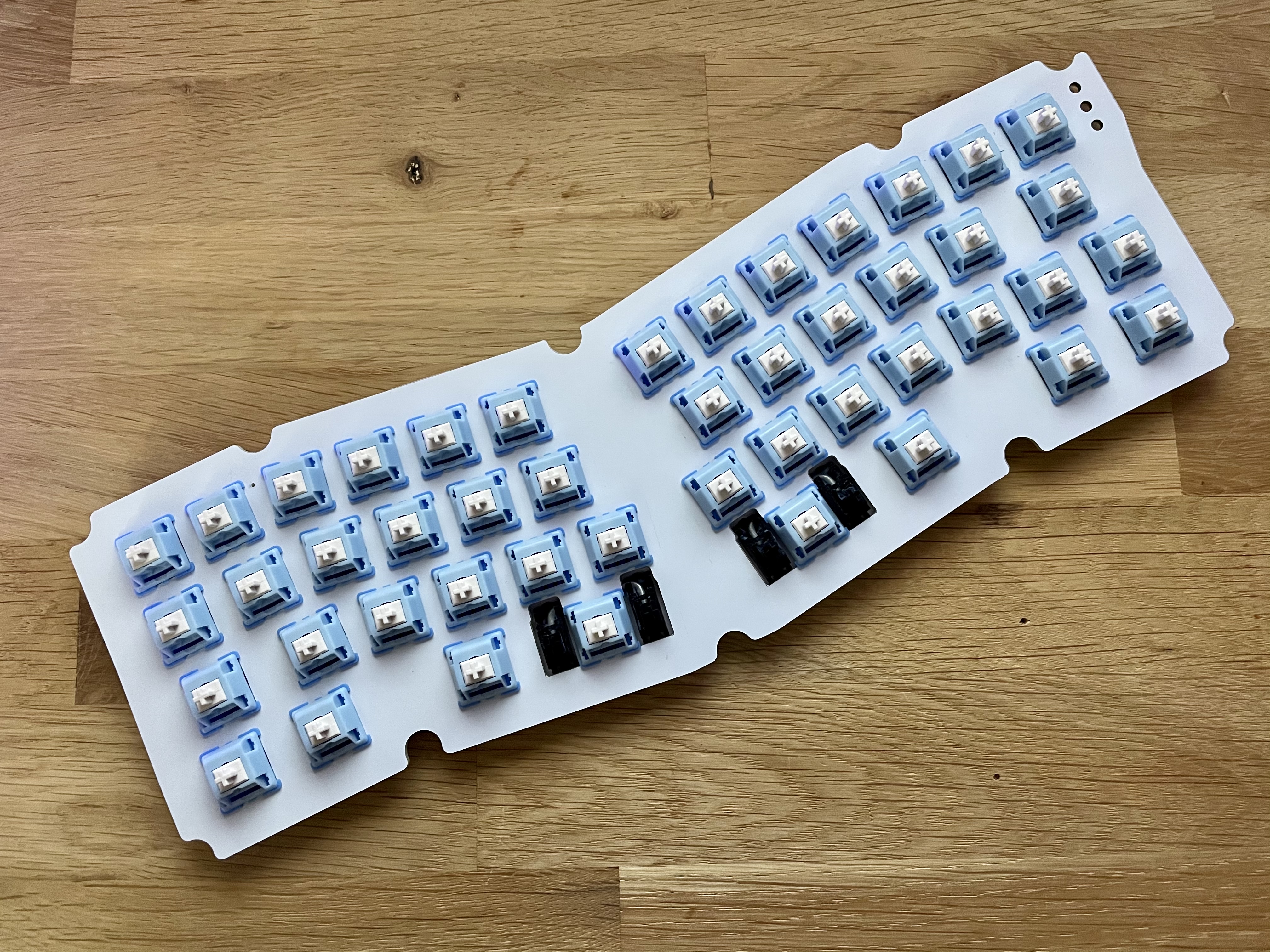

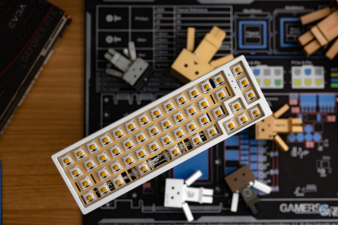

Finally trying an ergonomic layout! Build in progress…

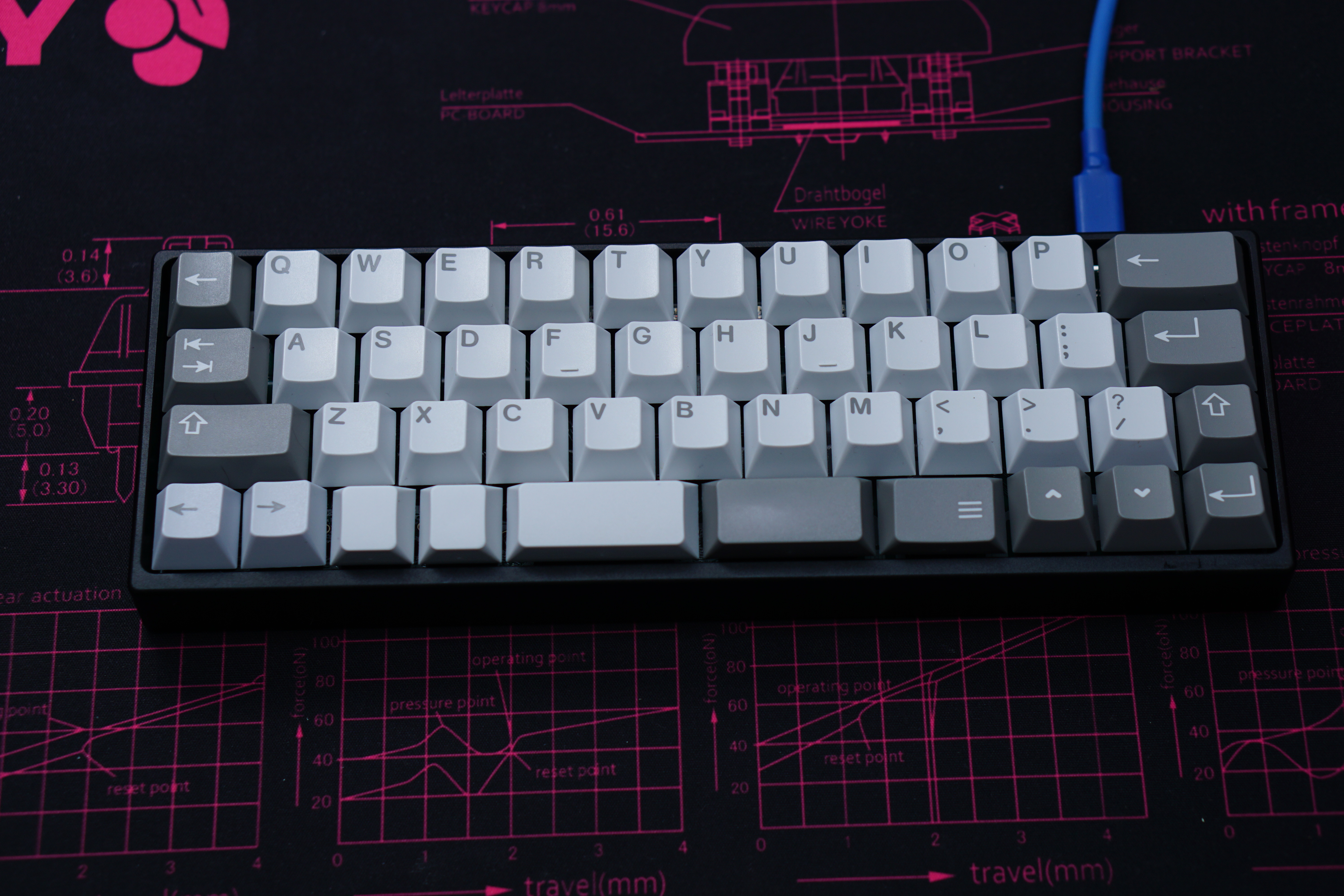

Prime-E with Penguin tactile switches.
looks great, going in a Gasket mount p3d case I assume?
Yes indeed!

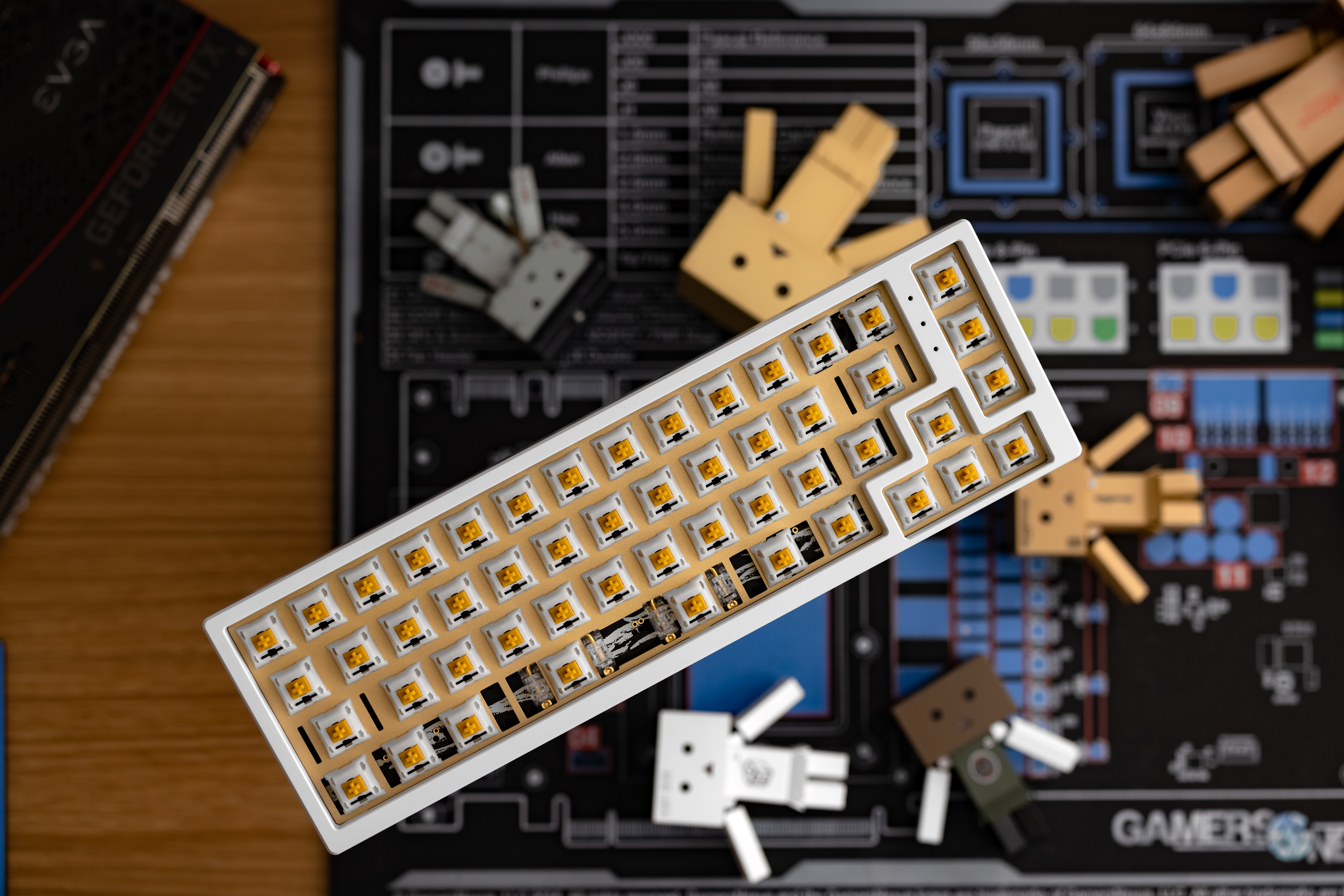

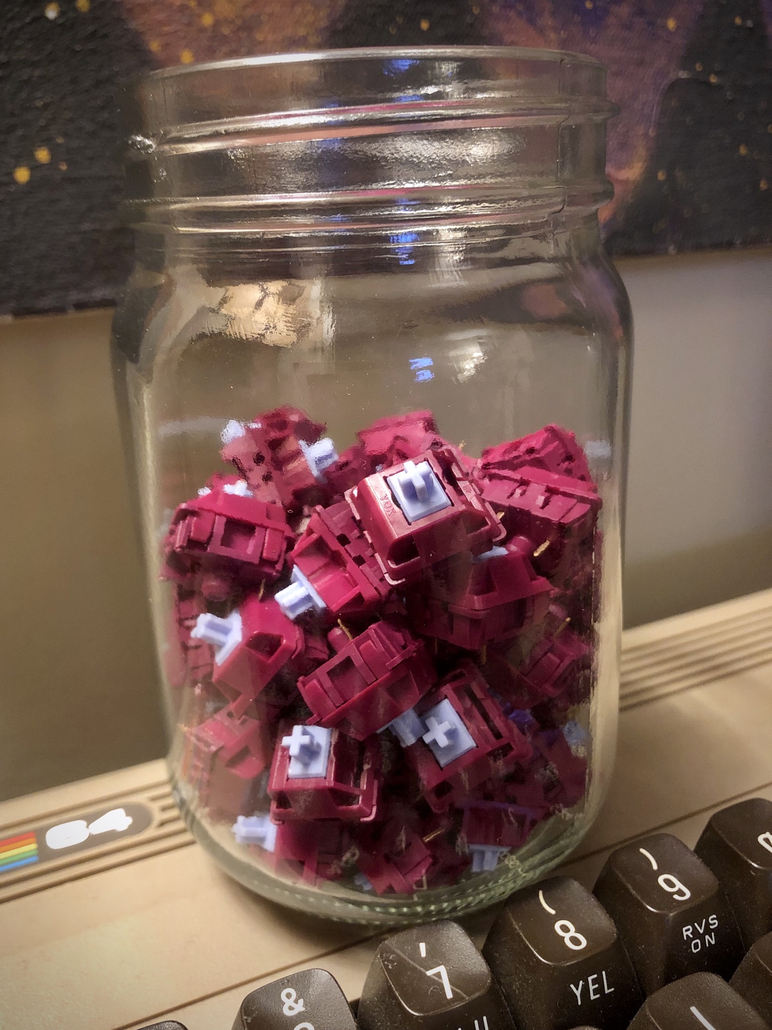

Desoldered both of these today.
Iron180 PC proto, could not get this to go into boot mode for flashing. Top reset switch was inaccessible on the proto plate (no cutout) so had to desolder the whole board to get it working. Also decided to switch out the brass plate with the CF one.

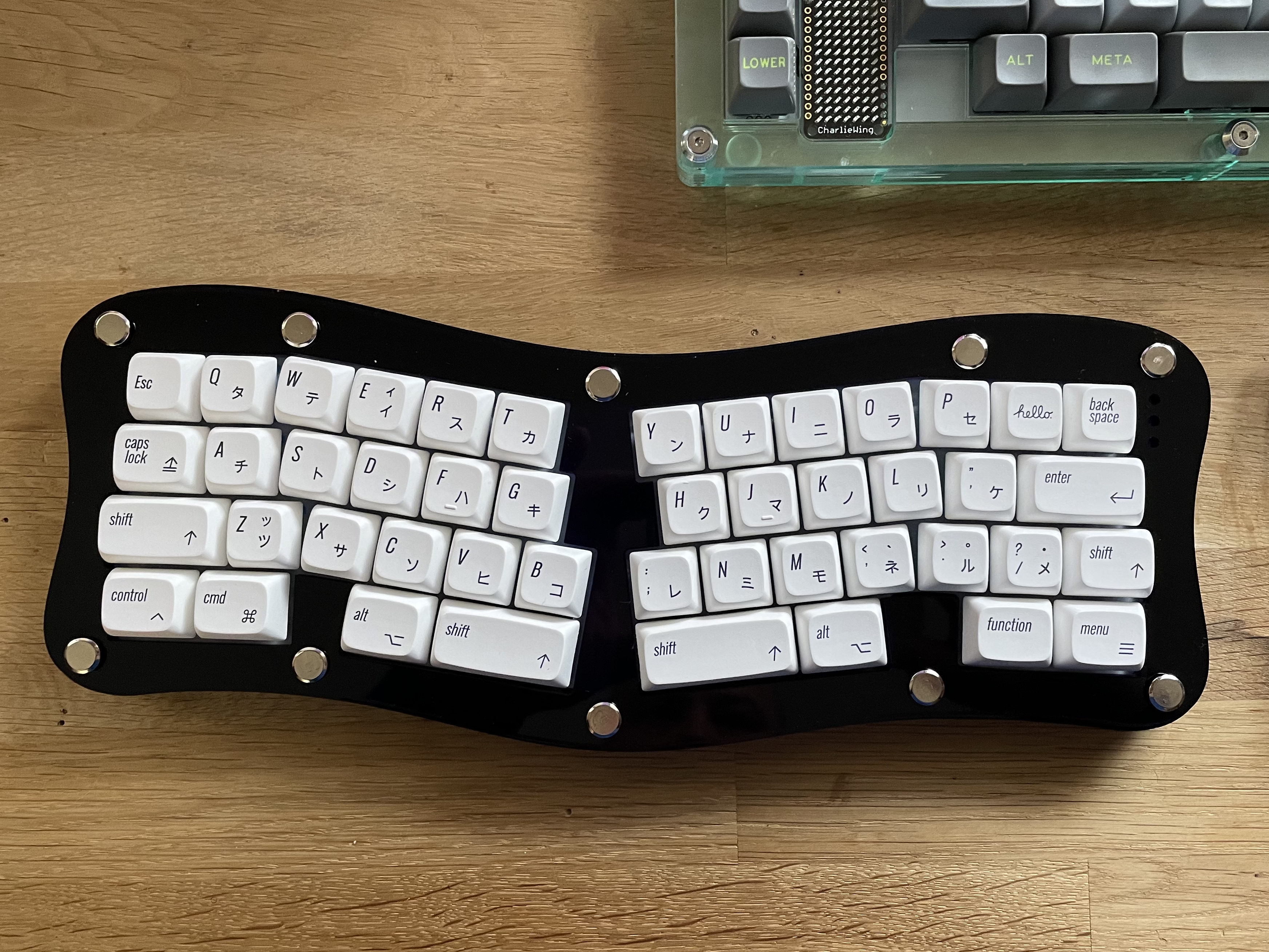

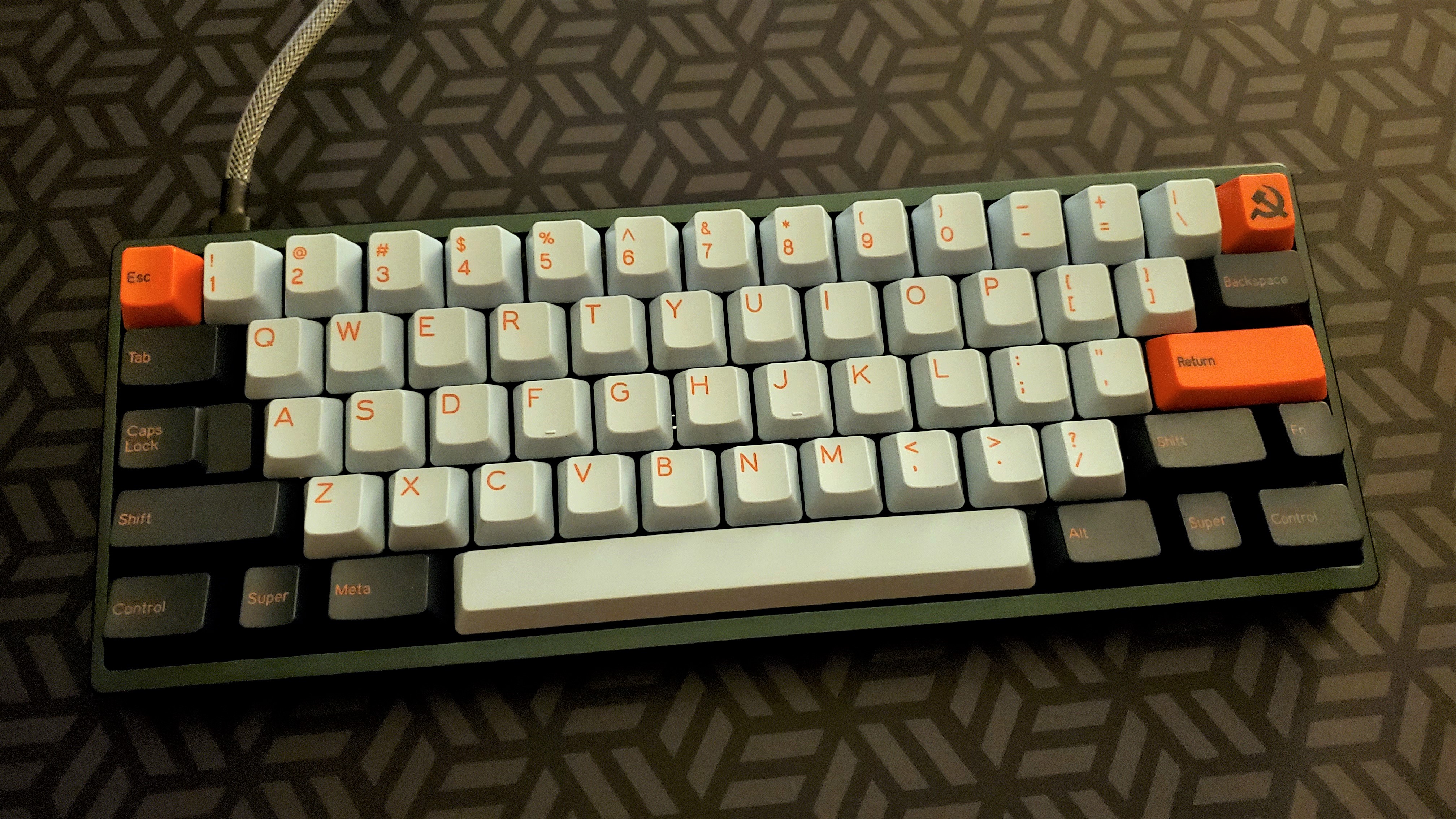

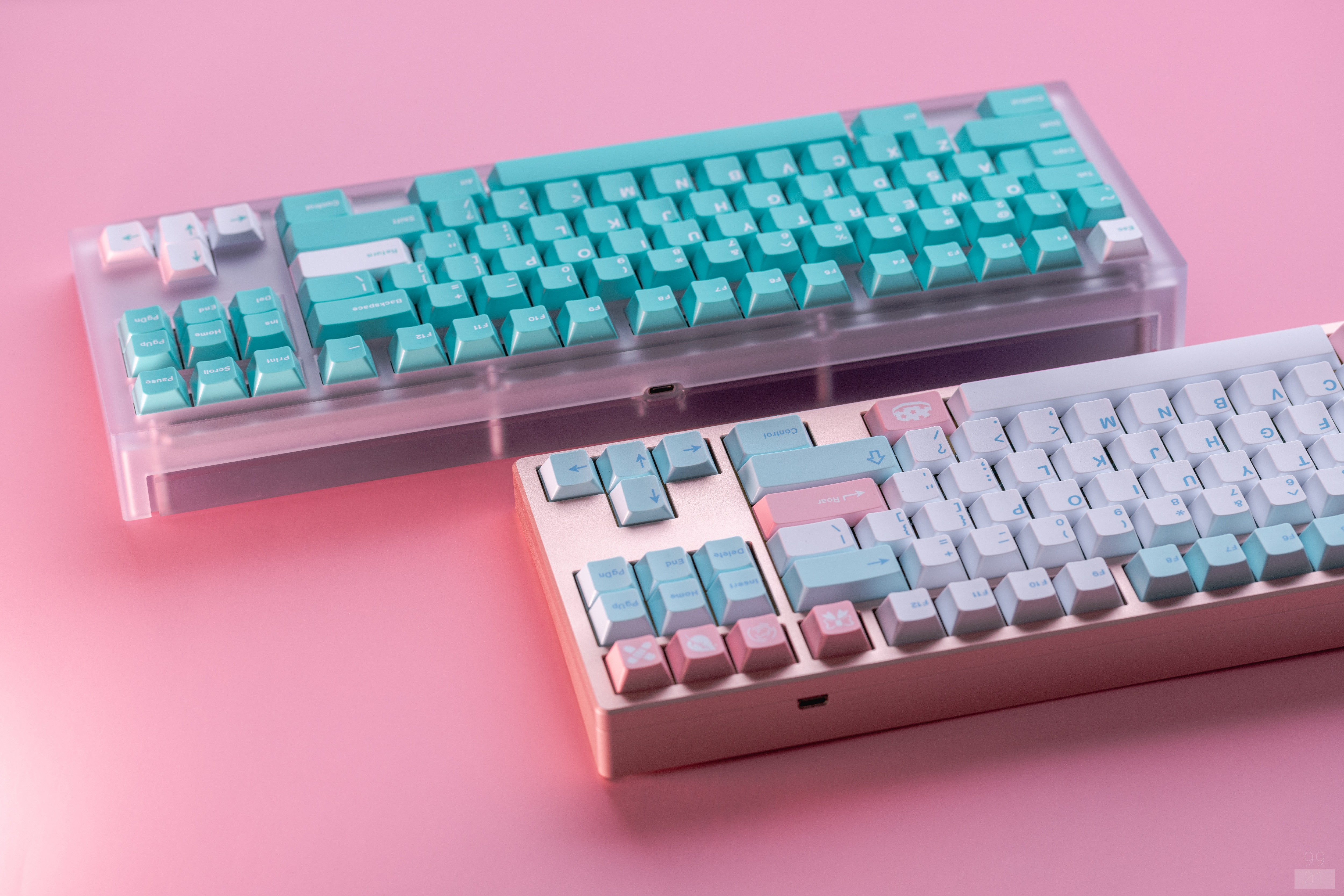

Prime-E finished!

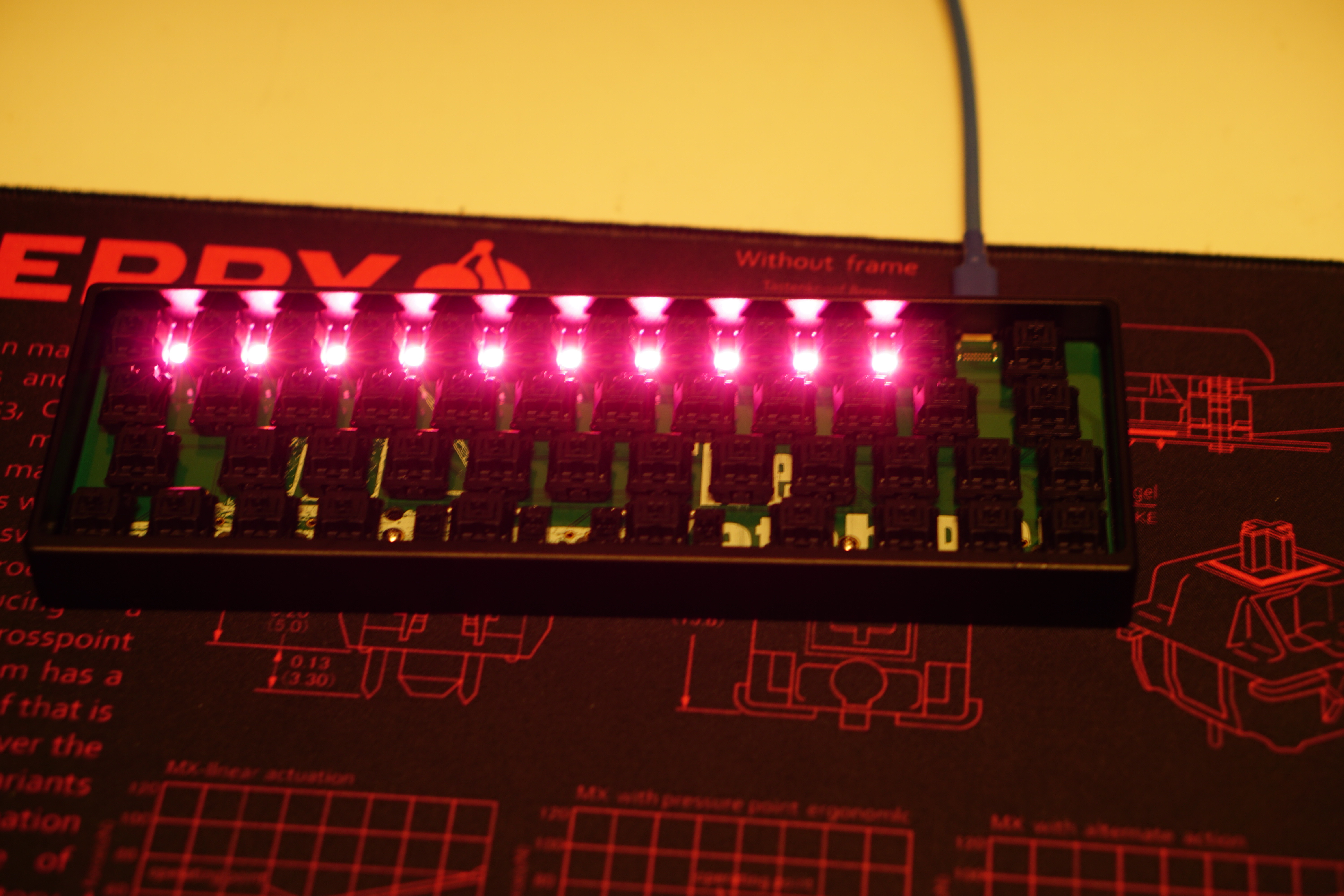

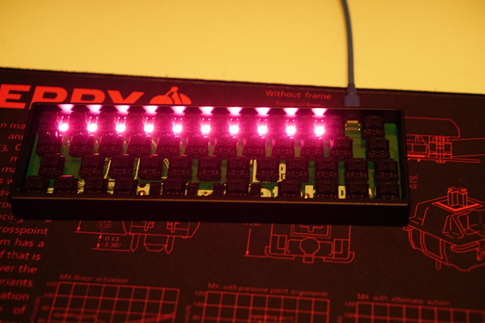

Soldered together this minivan today to discover the top mount RGB lights on the Ketch PCB are turned on by default? a surprise to be sure, but an unwelcome one

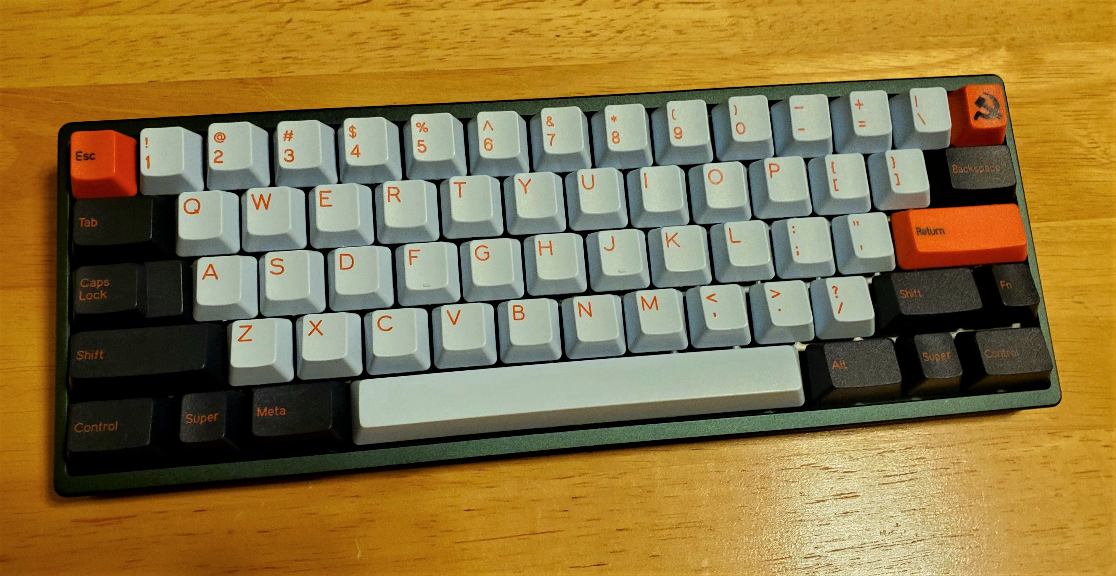

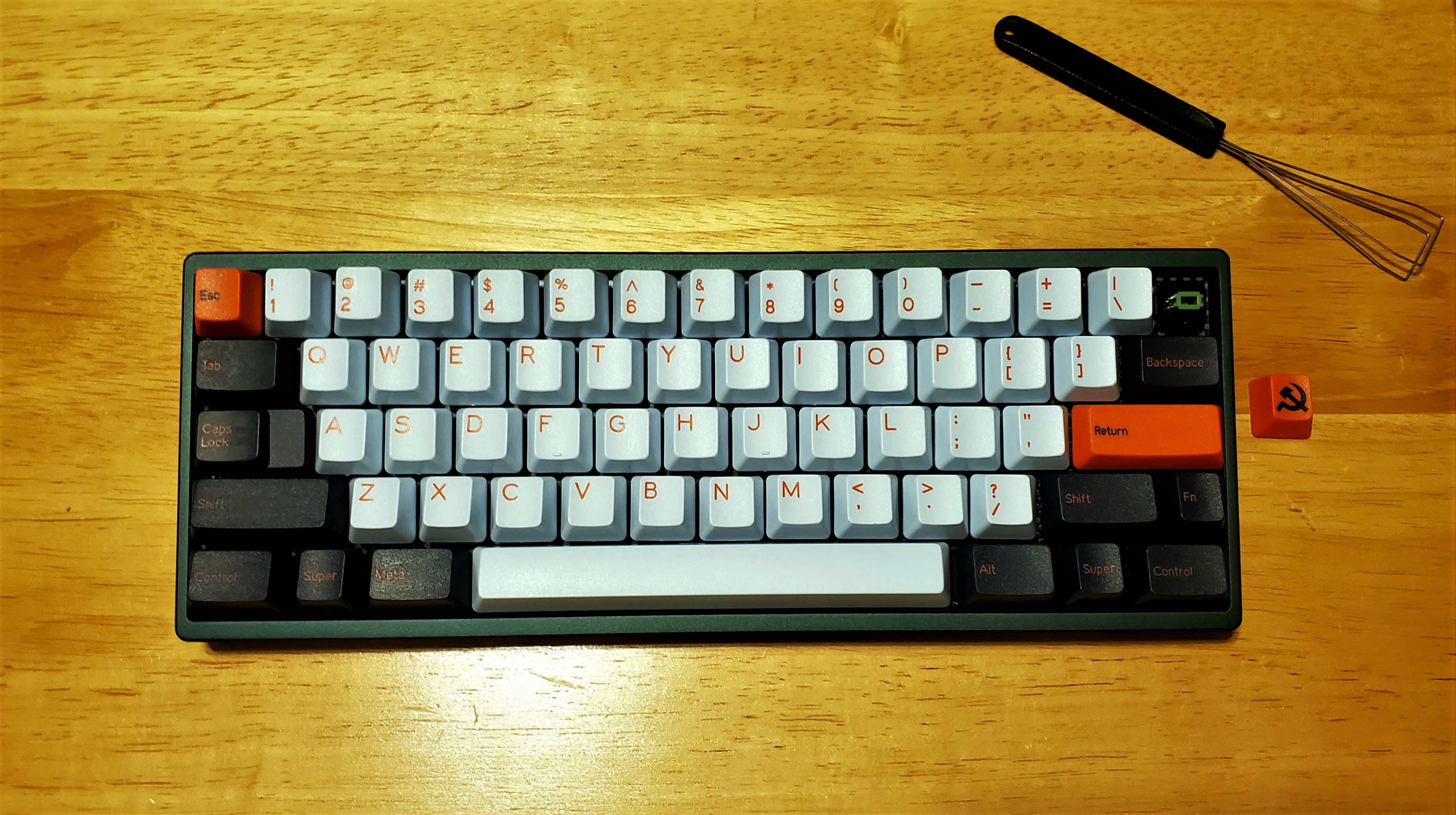

Finally got my modern layout ALPS build done! Pretty happy with it, but had a few issues lining up the bottom row. Even though the 1UP CF plate I used is ALPS compatible, the bottom row is cut for universal layouts & did not allow ALPS switches to latch in. Then the L win key footprint on the PCB is ever so slightly pushed to far to the right. The caps don’t interfere with each other I left it be at this.
The biggest disappointment with this build is the caps though. I was so happy to get a set of DCS ALPS Yuri, but after getting them on a board I’ve come to realize SP just shat this set out with pretty low QC. The stems are glued or melted on to the caps, definitely not shot with the cap. I had the stem rip right off one of my 1.5u ALT keys & it came off perfectly since it was only connected at two small points. Thankfully I was able to glue it back in & have it useable again, but that doesn’t give me hope this set will hold up to repeated changes. Then to top that off my S key actually has the wrong stem on it! It has a fricking R2 stem on it making it sit at a different angle then the rest of R3… :flushed: Again I was able to mostly compensate for that by shaving down the support bars for the stem, but FFS SP!
I learned the hard way with SP DCS caps as well (MX caps to boot). Not only are all the notches very visible from the injection molding, but stems break incredibly easily compared to Cherry caps.
I developed a new technique when using DCS caps - lube them. They should still be tight enough to stay on, but it greatly enhances your chances of getting them off if you need to!
