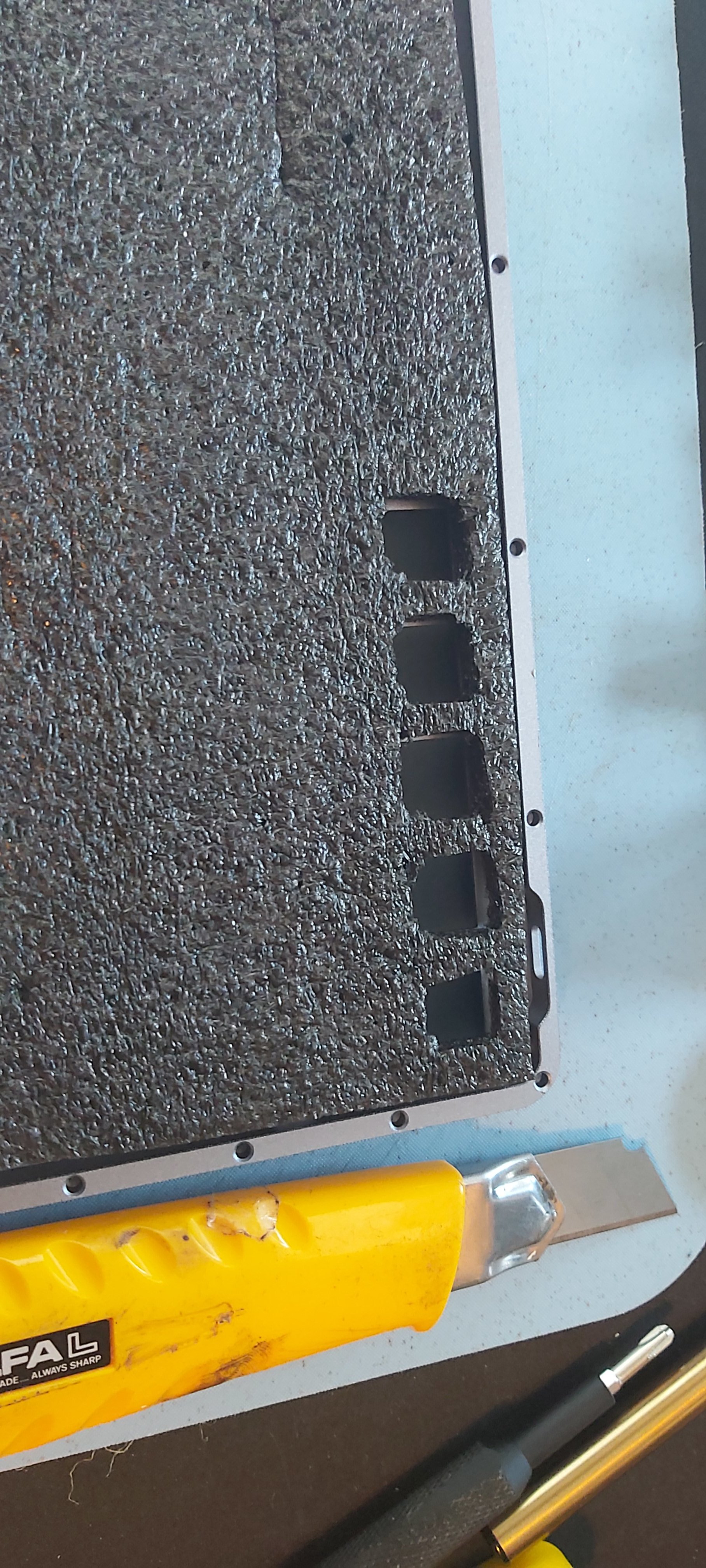

Shelf linered the Heavy-6 to reduce the metallic echoes. Worked really well!

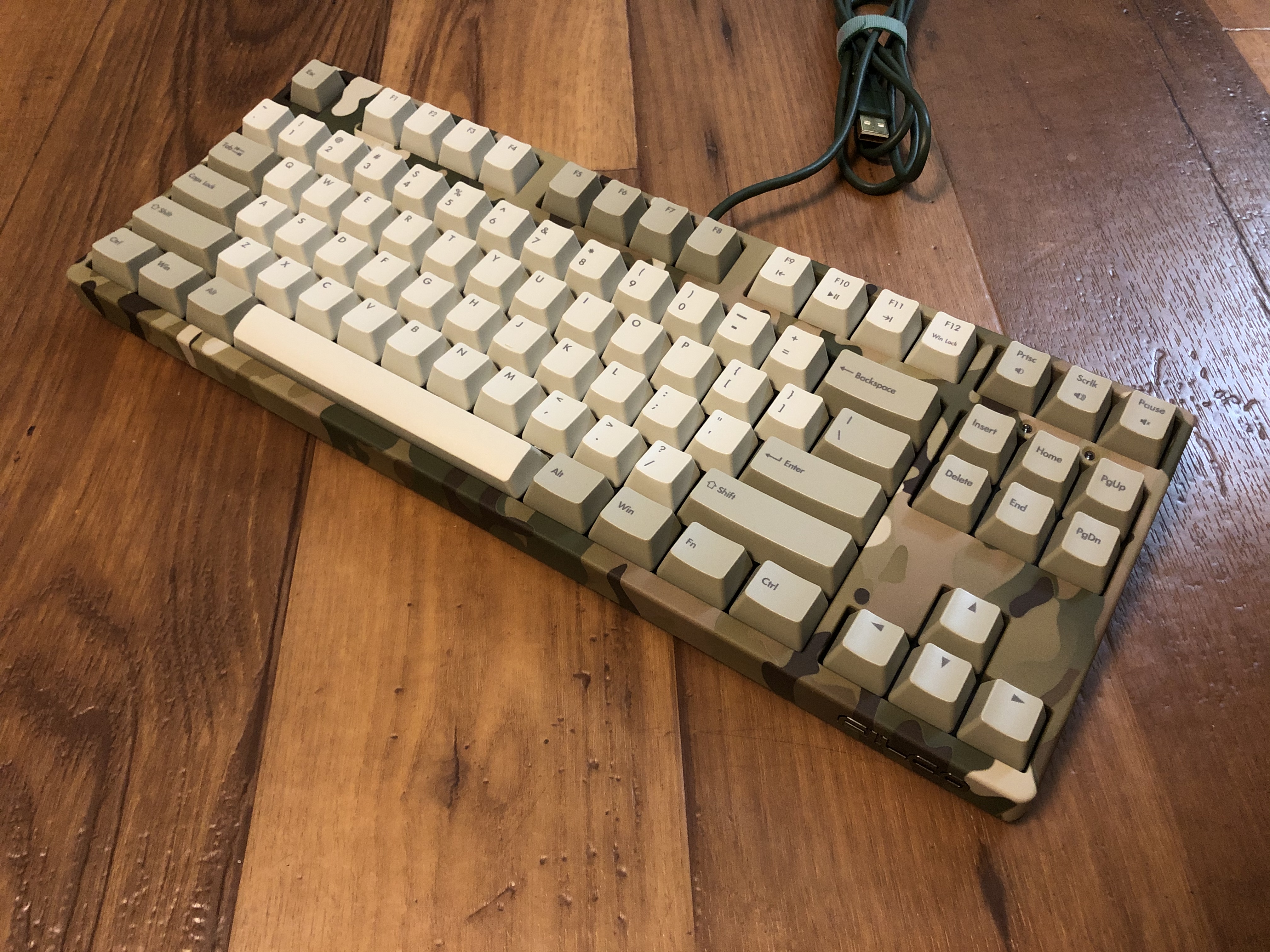

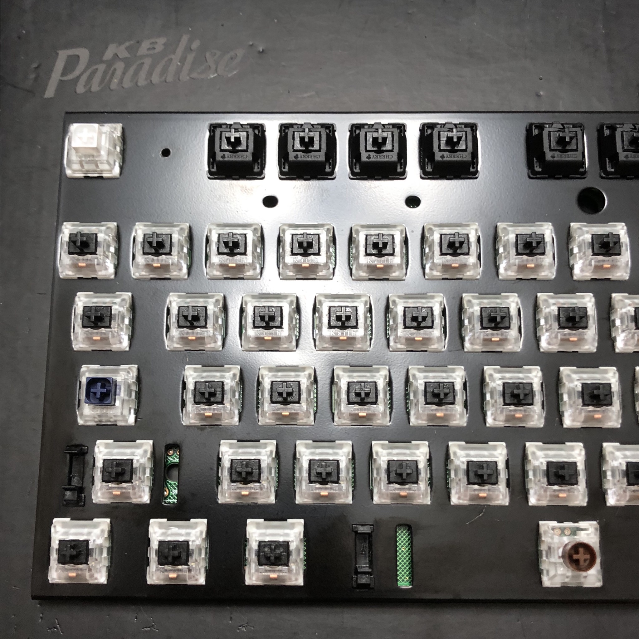

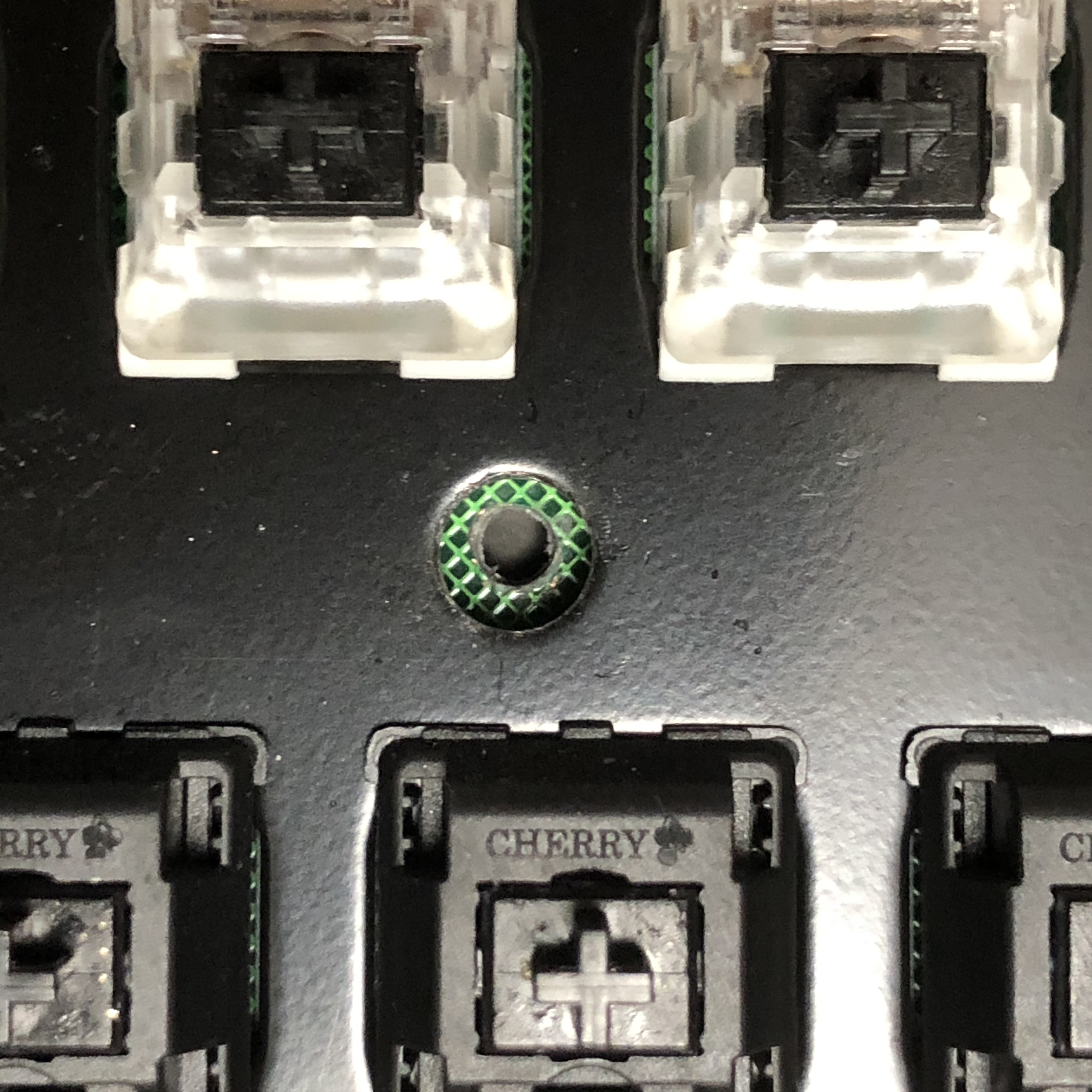

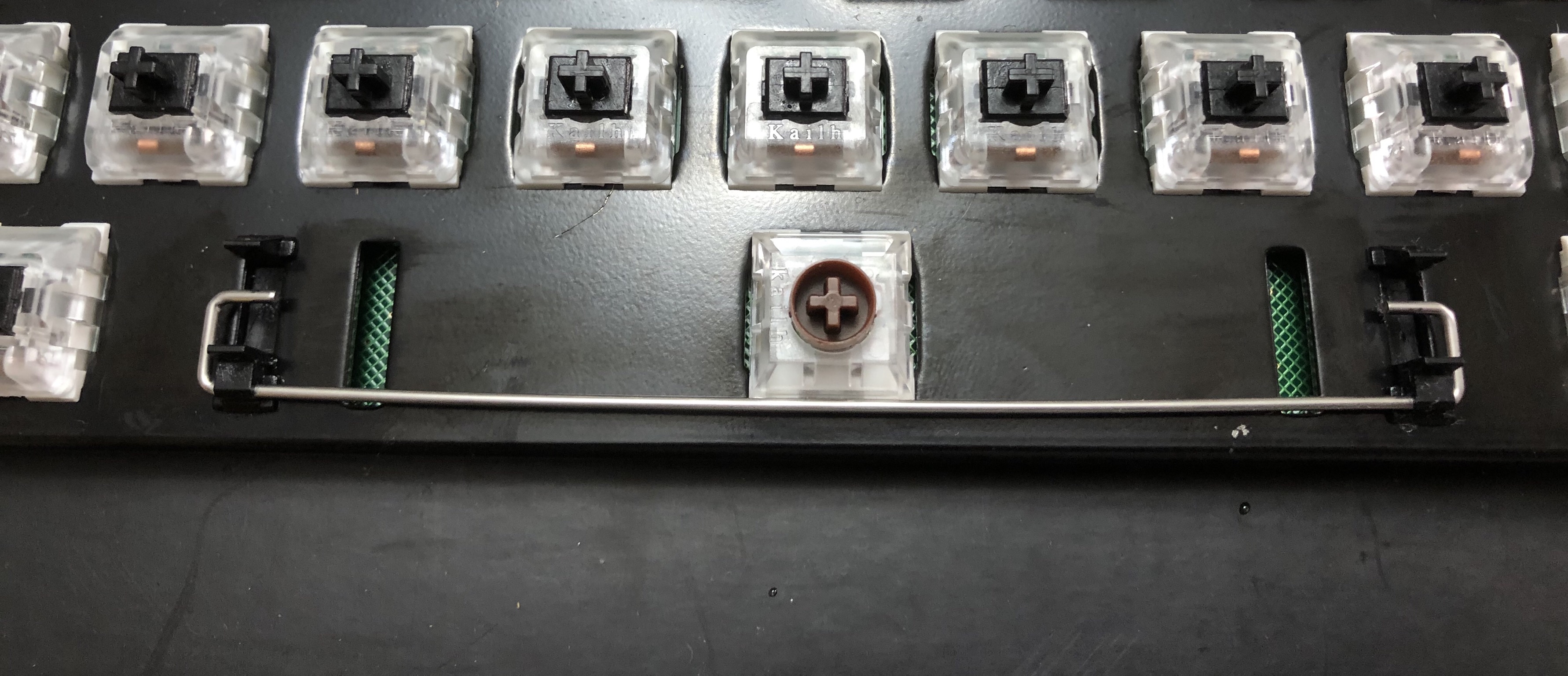

Today, revitalizing the stabs on this KBParadise V80 that I’ve been modding for my sister’s husband.
The board originally had MX Silent Blacks and pretty darn bad stabs. I removed those switches quickly and easily with the FR-301, and replaced them with a mixture of those and Halo housings with leftover YOK Panda stems. 205g0 made them pretty decent, and the thin caps I’m using with them sound nice.
The ESC and ScrLk keys get BOX whites, the Spacebar gets a Silent BOX Brown (partially for its dampening, partially for its tapered housing), and Caps Lock gets a BOX Navy.
After I snug-up the stabs with cloth tape and lube them with some more 205g0 and with a little modding, I’ll be installing this into a Filco Camo case.

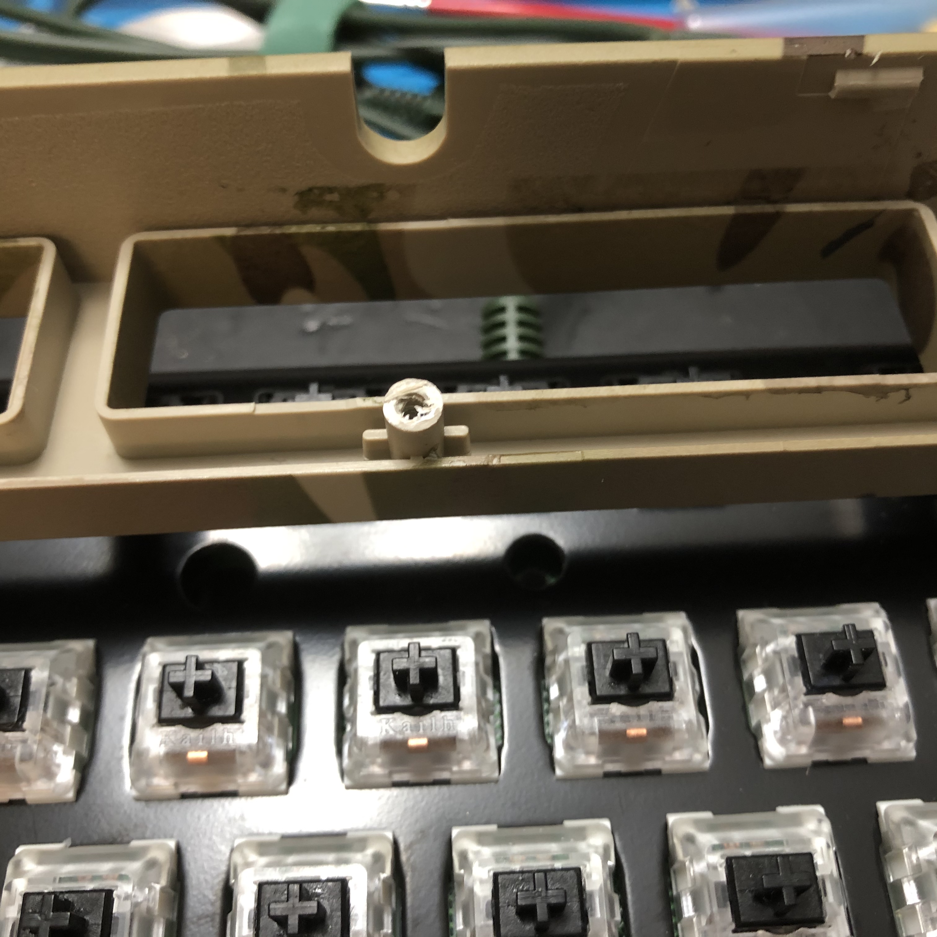

No - bad KBParadise:

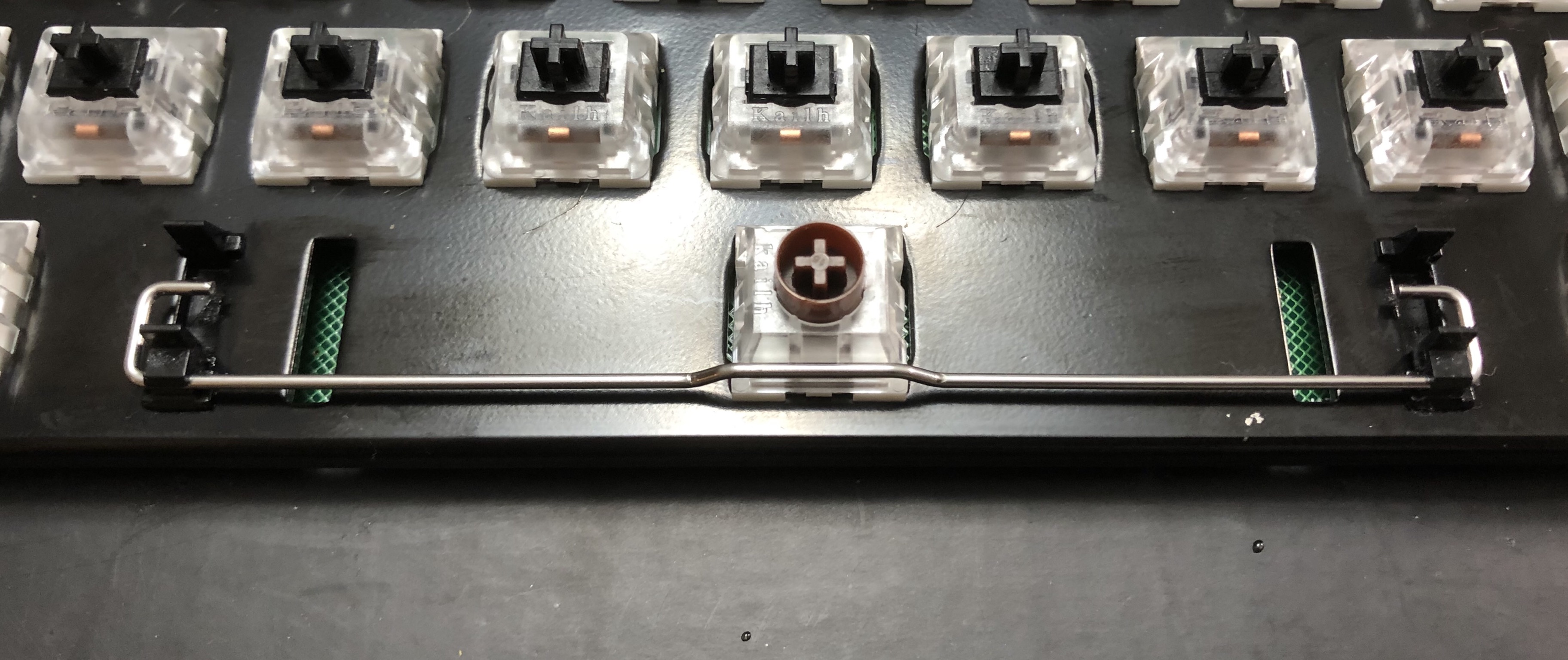

Ah, much better:
Edit:

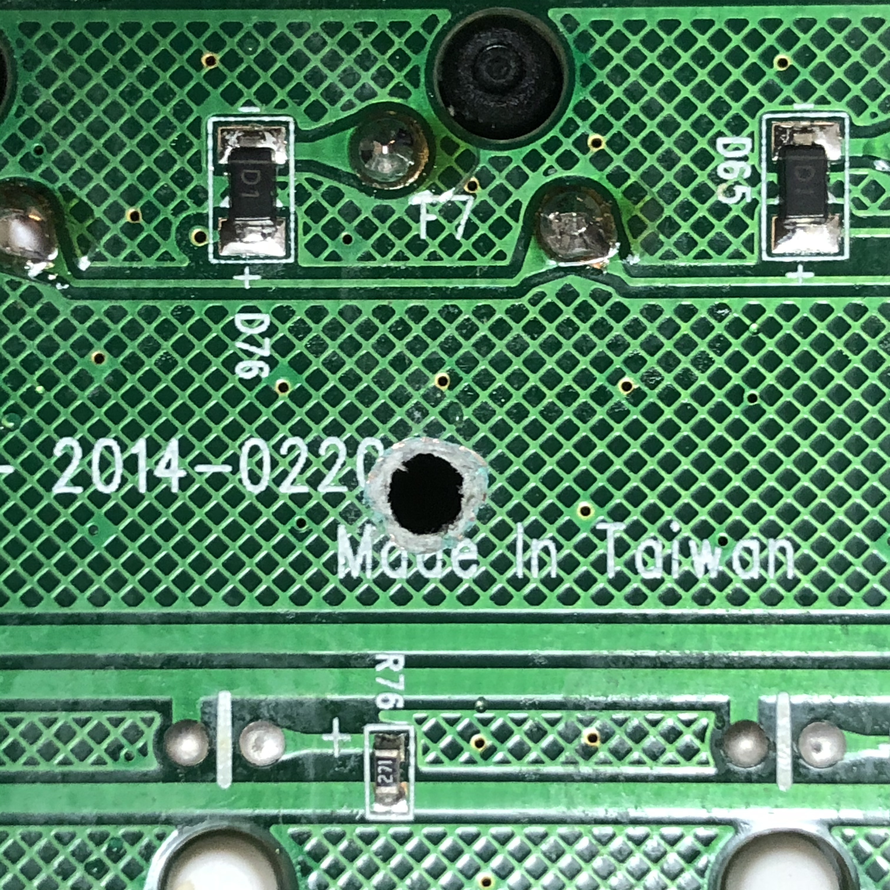

Had to do a little modding -
Remove a post here:
Shorten one here:
Drill a hole in the PCB here:
And bam! The Filco case fits perfectly thanks to using a similar template.
I’ve been working on this one a little here and there when I had time over the past couple weeks - feels good to have it done.
the beige/grayscale surprisingly works out with the camo case! i hope the recipient gives you feedback on how the mod experience is.

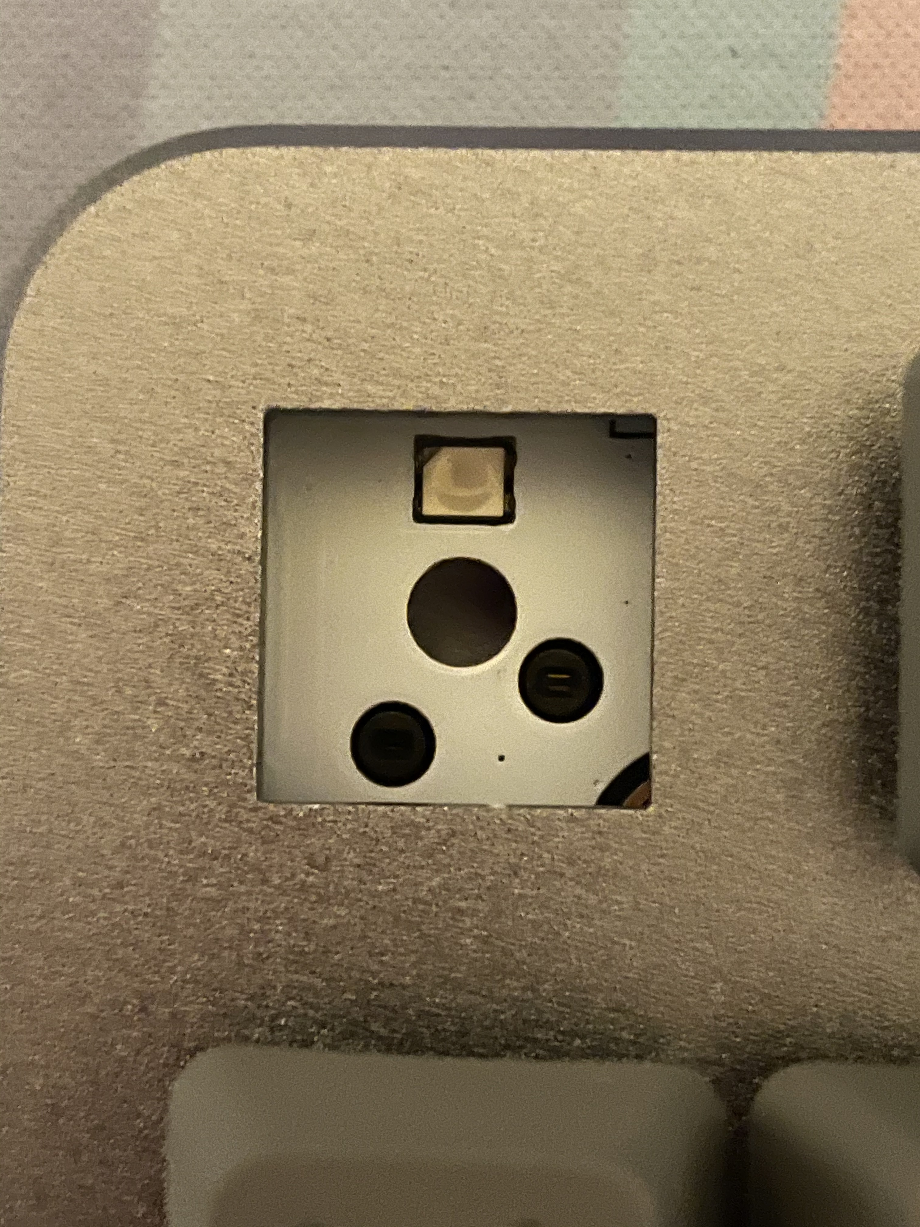

Just finished making holy (and poli :eyes:) bobas for my “try to make a Drop SHIFT sound good” project and met my old nemesis
person overacting shock to a humorous degree
Ah, frick, right, Drop loves those PCBs without leg holes. Time to break out the flush cutters again :sob:
Bring out the drill instead :stuck_out_tongue_winking_eye:

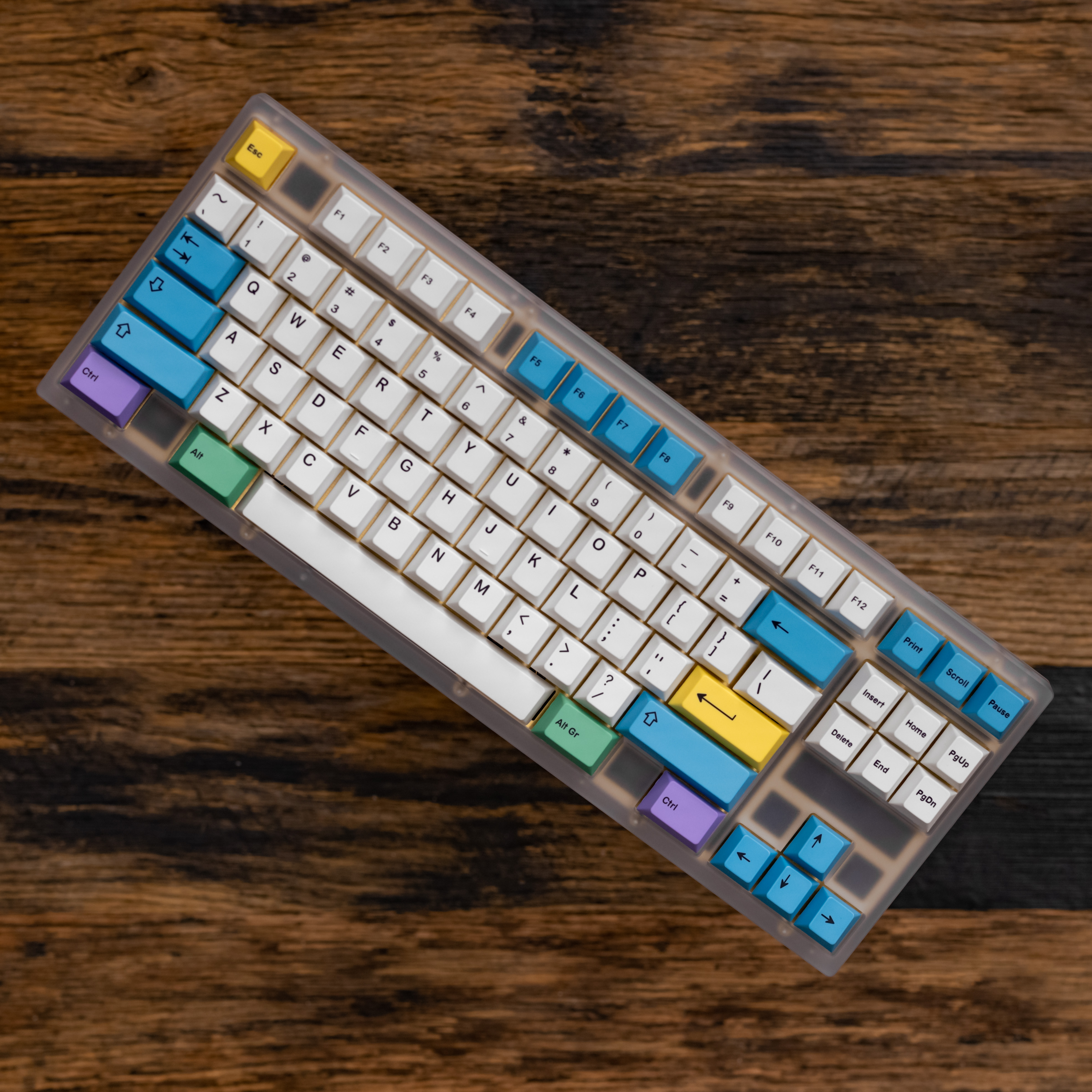

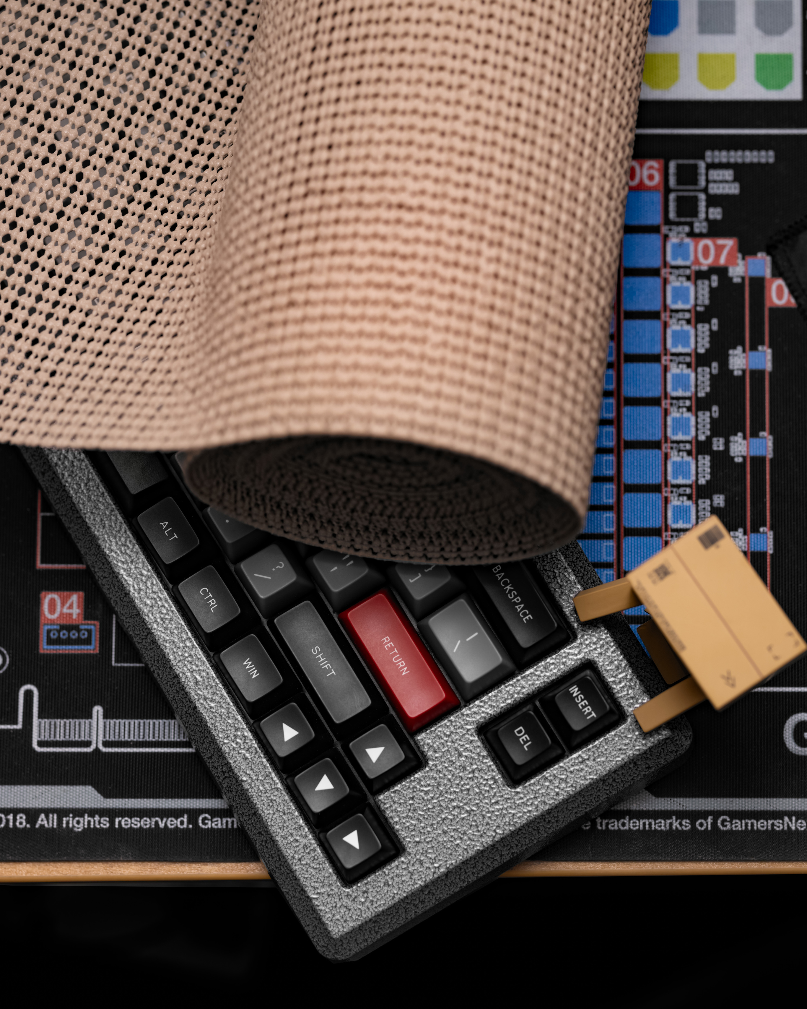

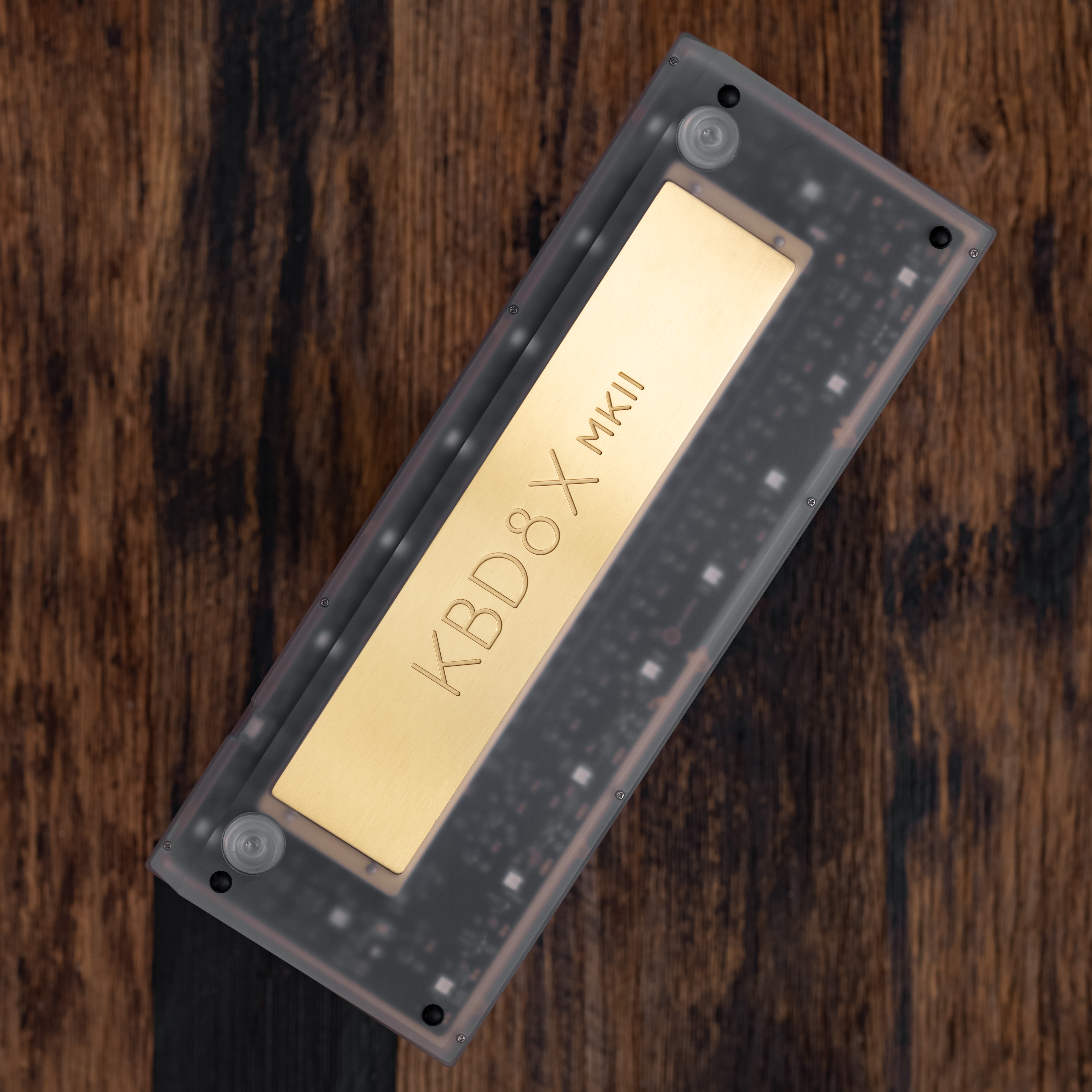

KBD8X MKII during the build phase.
Nice, I have been thoroughly enjoying my 8X MkII. Hope you feel the same about yours & can’t wait to see the finished product!
Loving the angle of the board a lot. The brass weight is also super hefty!
