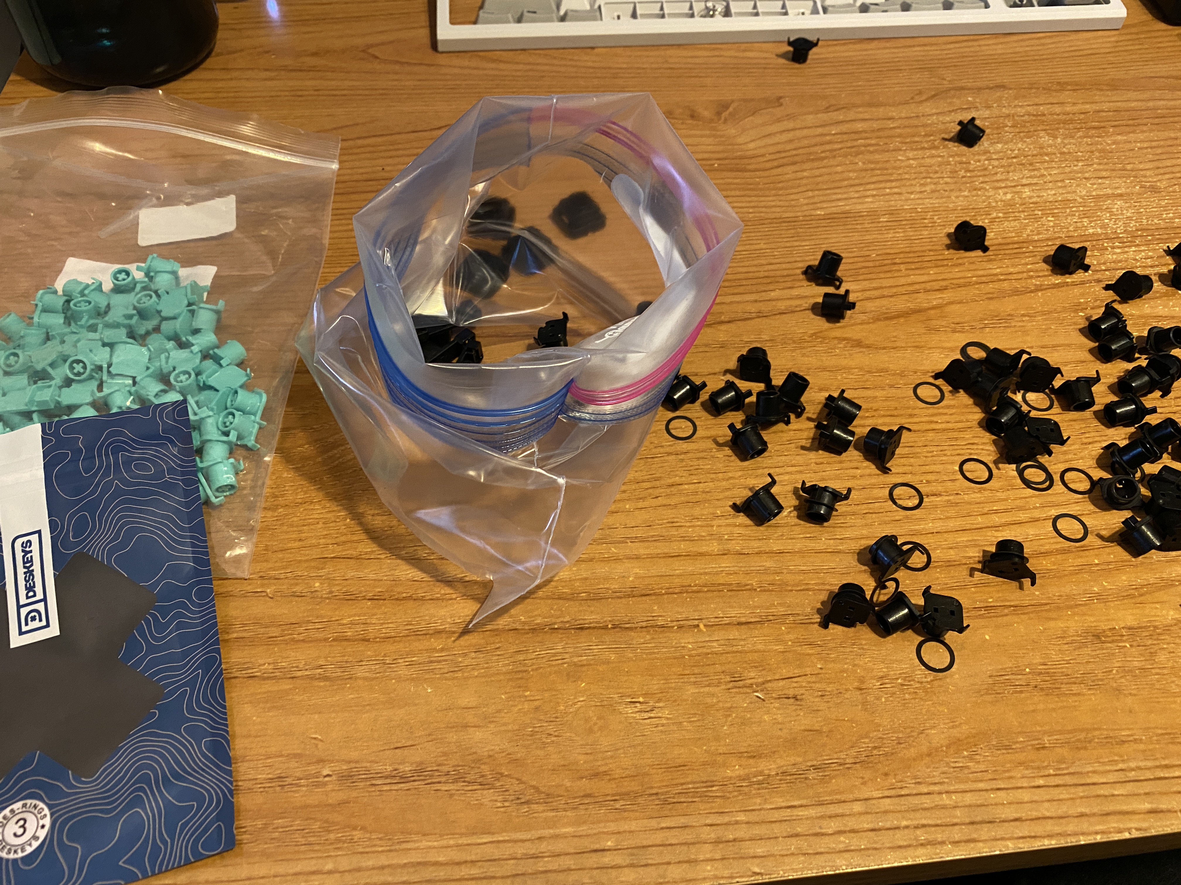

Do you have a link to the o rings you used? I’m going to be soldering up a WT60-D with my spare sirius plate once I get some switches lubed. Definitely want to try making the plate mounting points a bit more flexible to match the pcb.

Sure, here you go: Amazon.com
The inside diameter was a bit small, but it worked out in the end. The o rings stay on the screws once you get them on there. Made it easy to reassemble.

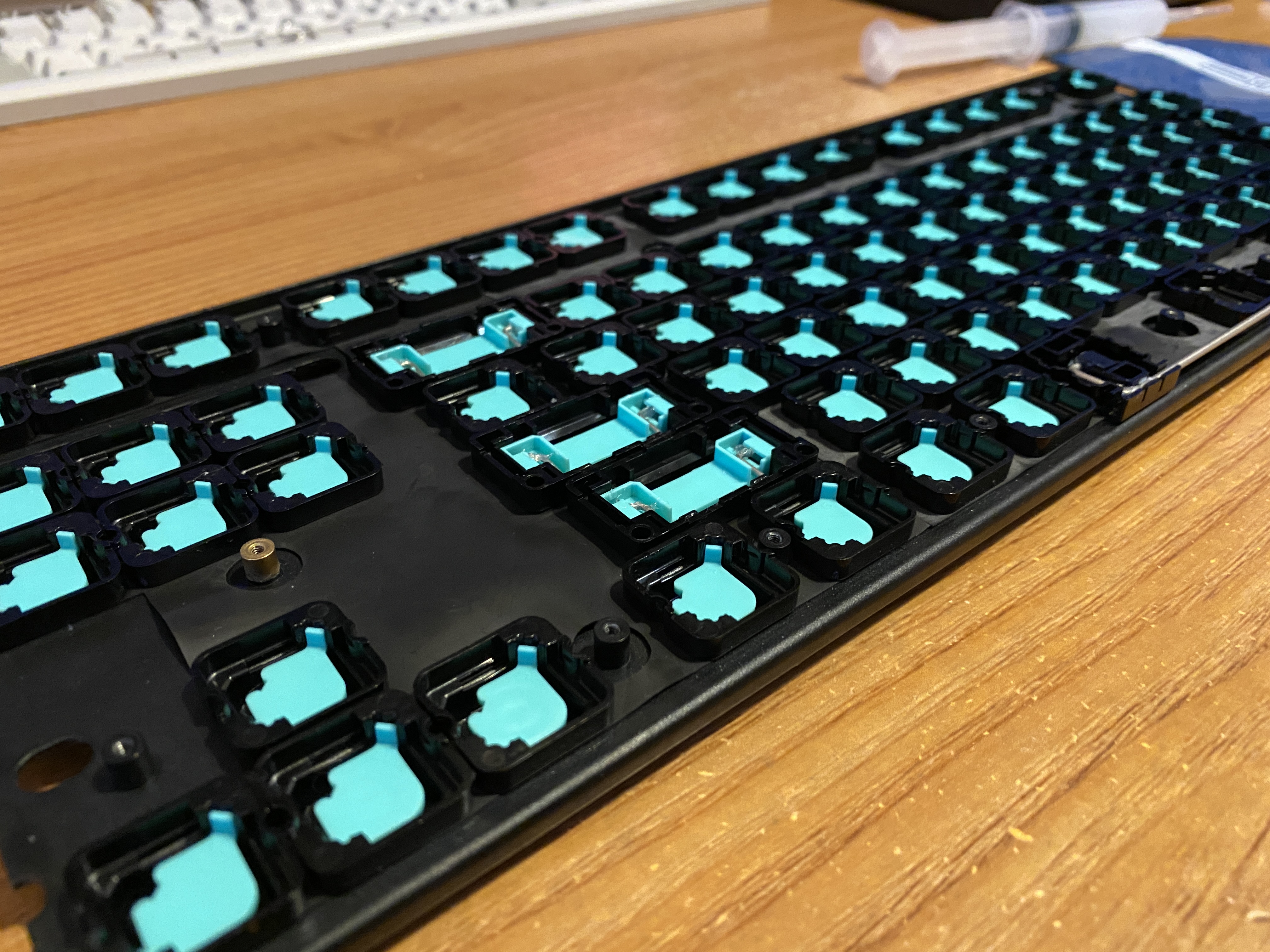

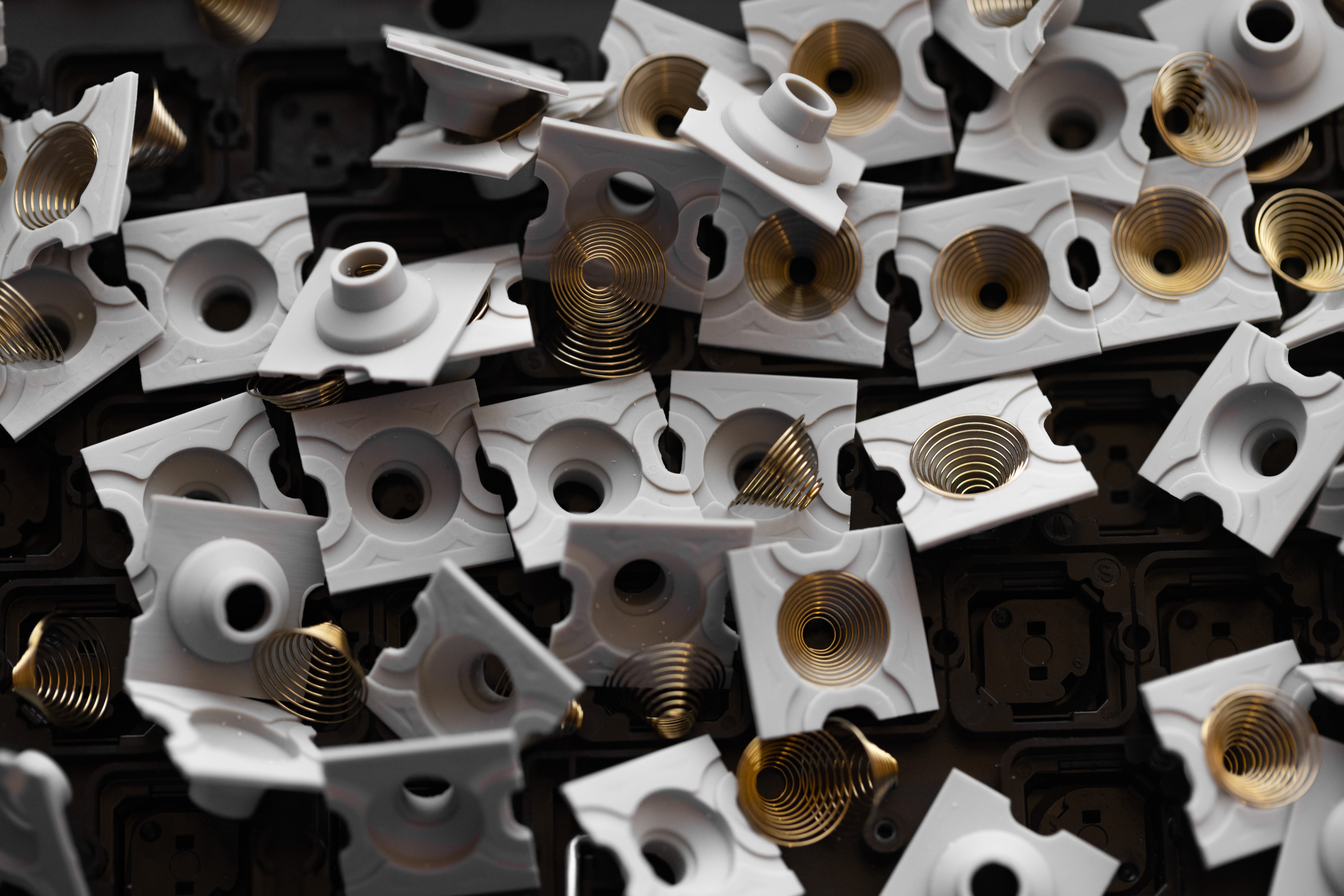

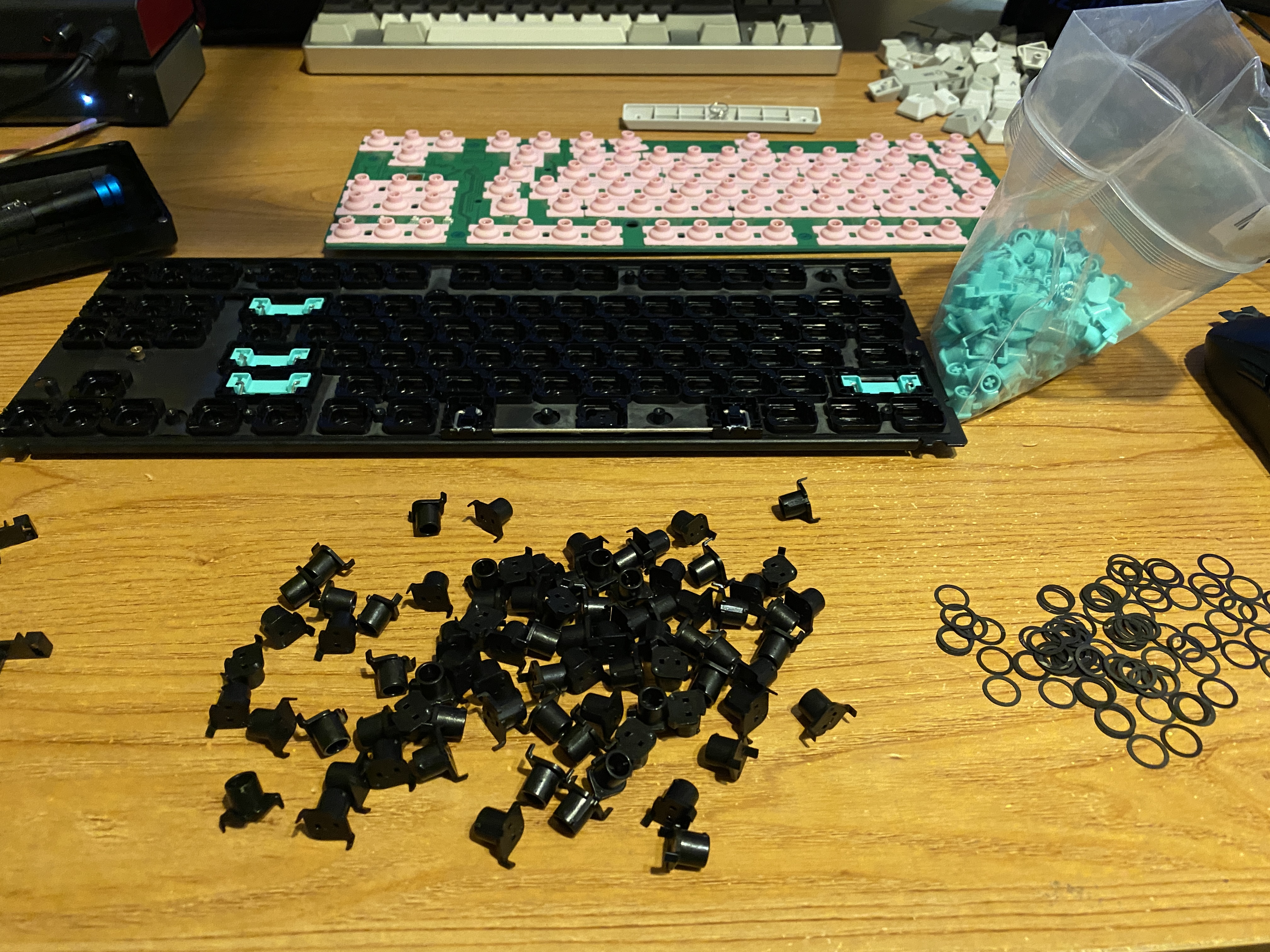

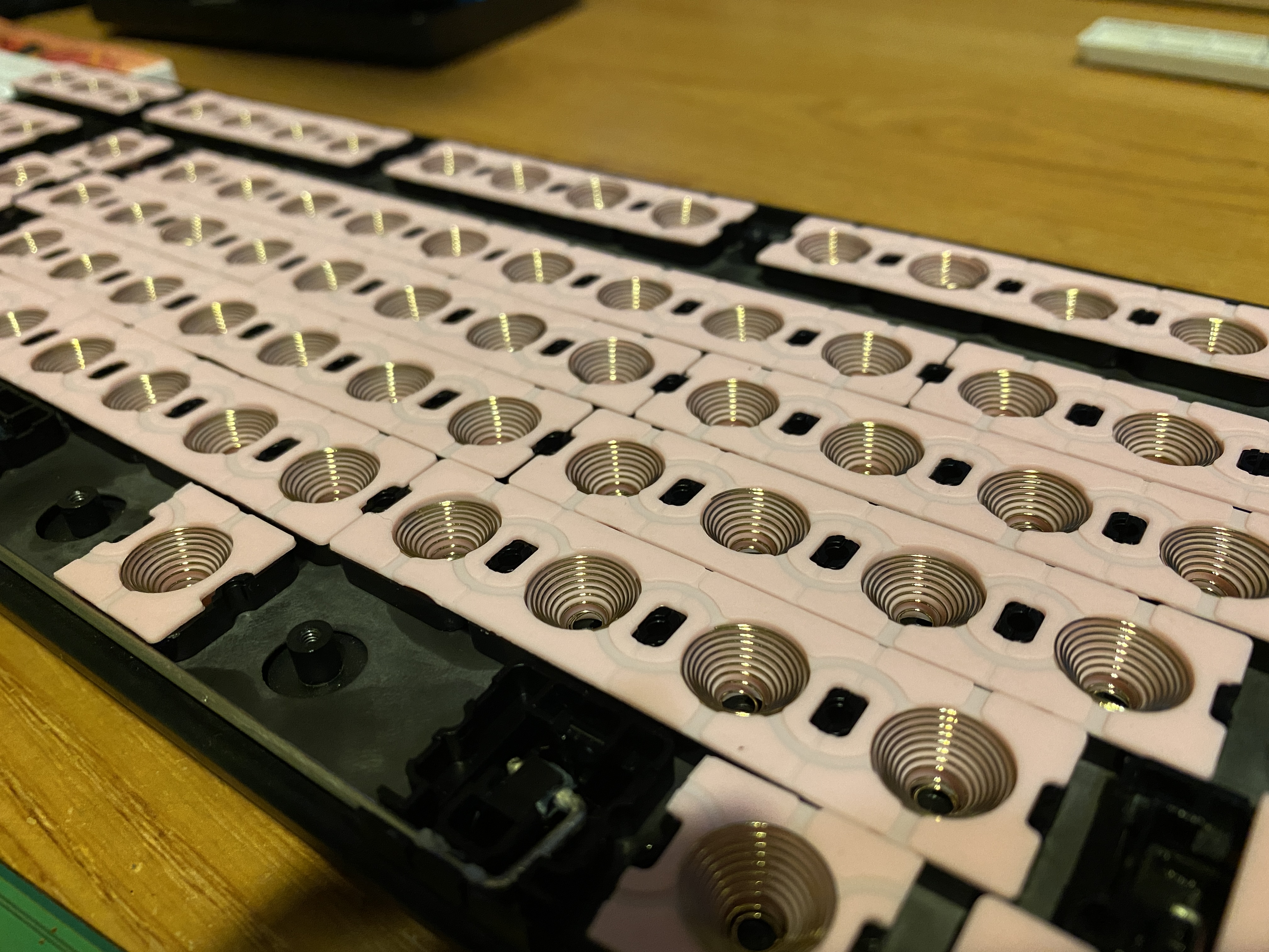

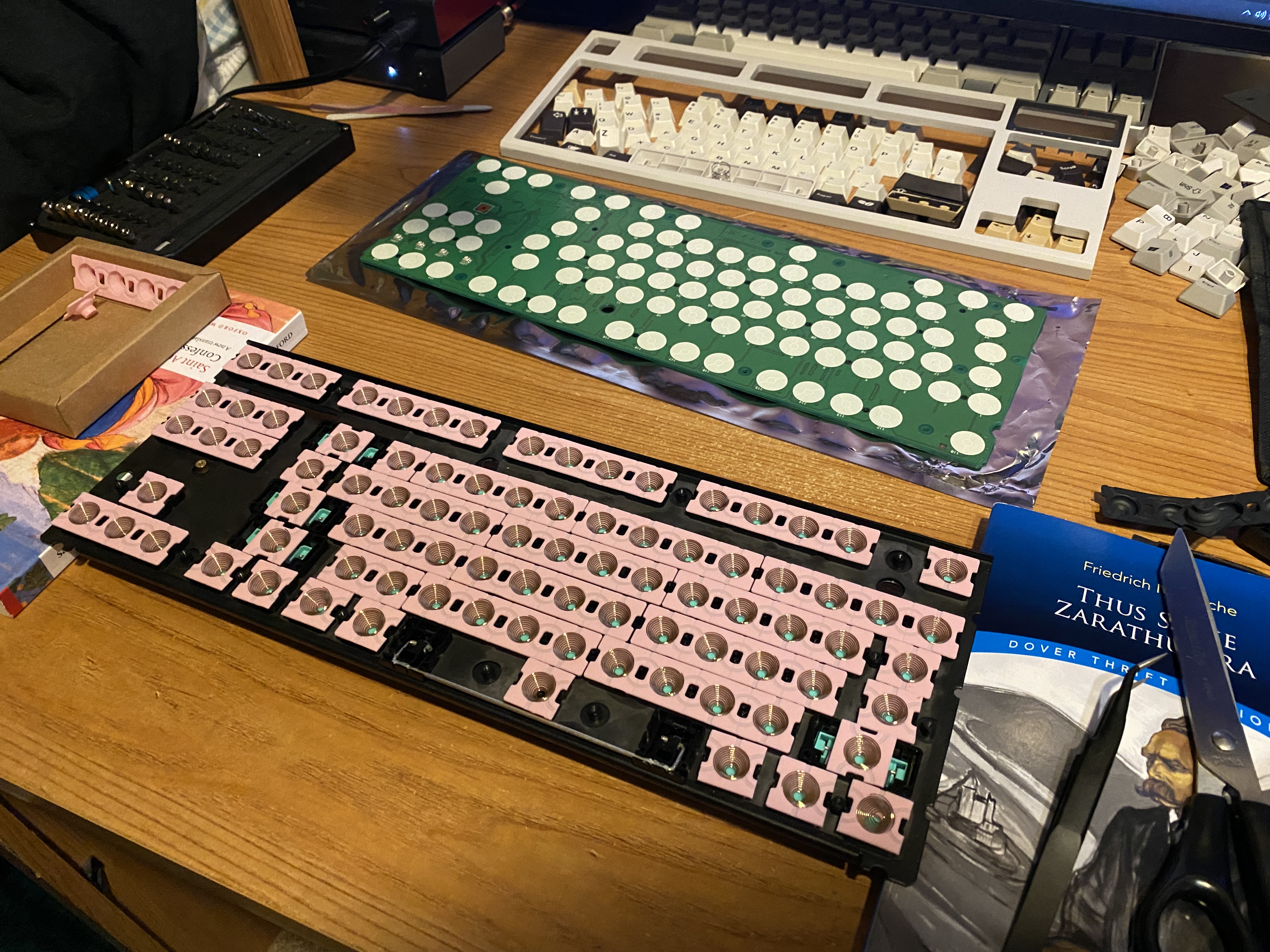

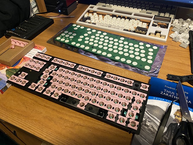

Part 6 of ??? of my topre swaps, this time we’ve got some KBD sliders. Going to get a sound test of these + the clacky mods that hit the housing, then silence and drill tomorrow. BKE domes haven’t moved from DHL in a week, still saying not picked up. Looks like DES pink domes will be my first dome swap, since they’re almost in Canada already.
Eagerly awaiting DES Sliders, since these KBD ones are quite noticeably crooked. They don’t immediately feel all too bad, but I did do a generous but safe amount of krytox lube on the slider housings.
Comparison video rendering now
Update, it’s up: DES Pink domes typing video + comparison to stock 55g!
