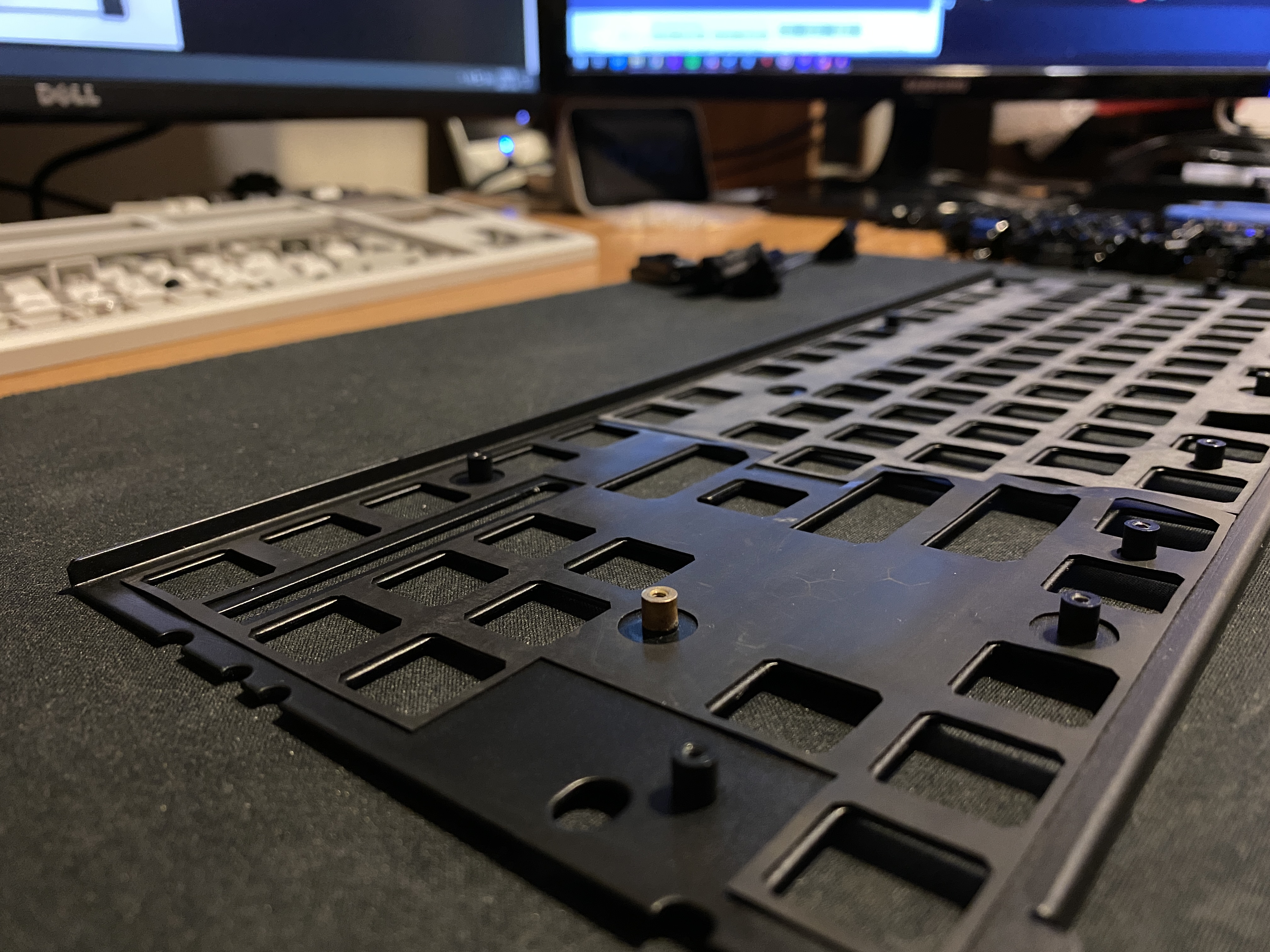

Ah crap, guess ill just twist off my thing thats been setting then. Looks like extractor set is my only option, as I’ve already given the rubber band a good run. But thank you for letting me know so as I dont waste my time further!
Aaaand I was able to get it off with needle nose pliers
That’s the way. Always works for me. Glad you got it!

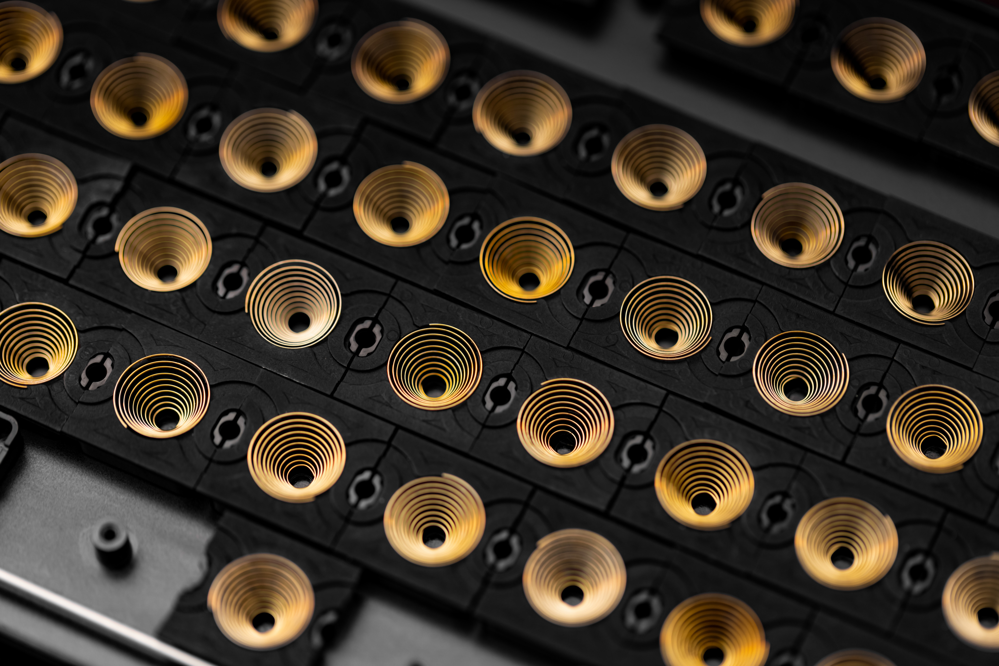

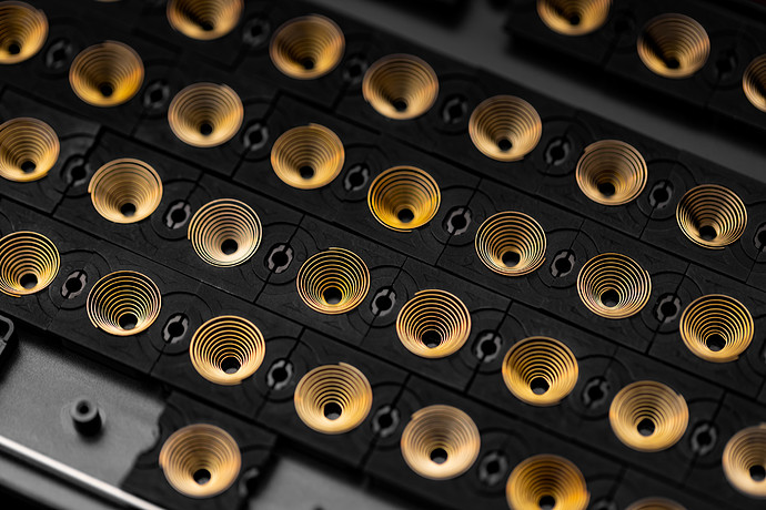

Gasket installed! Going to record the changes to typing sound at every step along the way for my realforce mod. Hope it’ll be worth it and provide good insight as to what changes topre sounds!

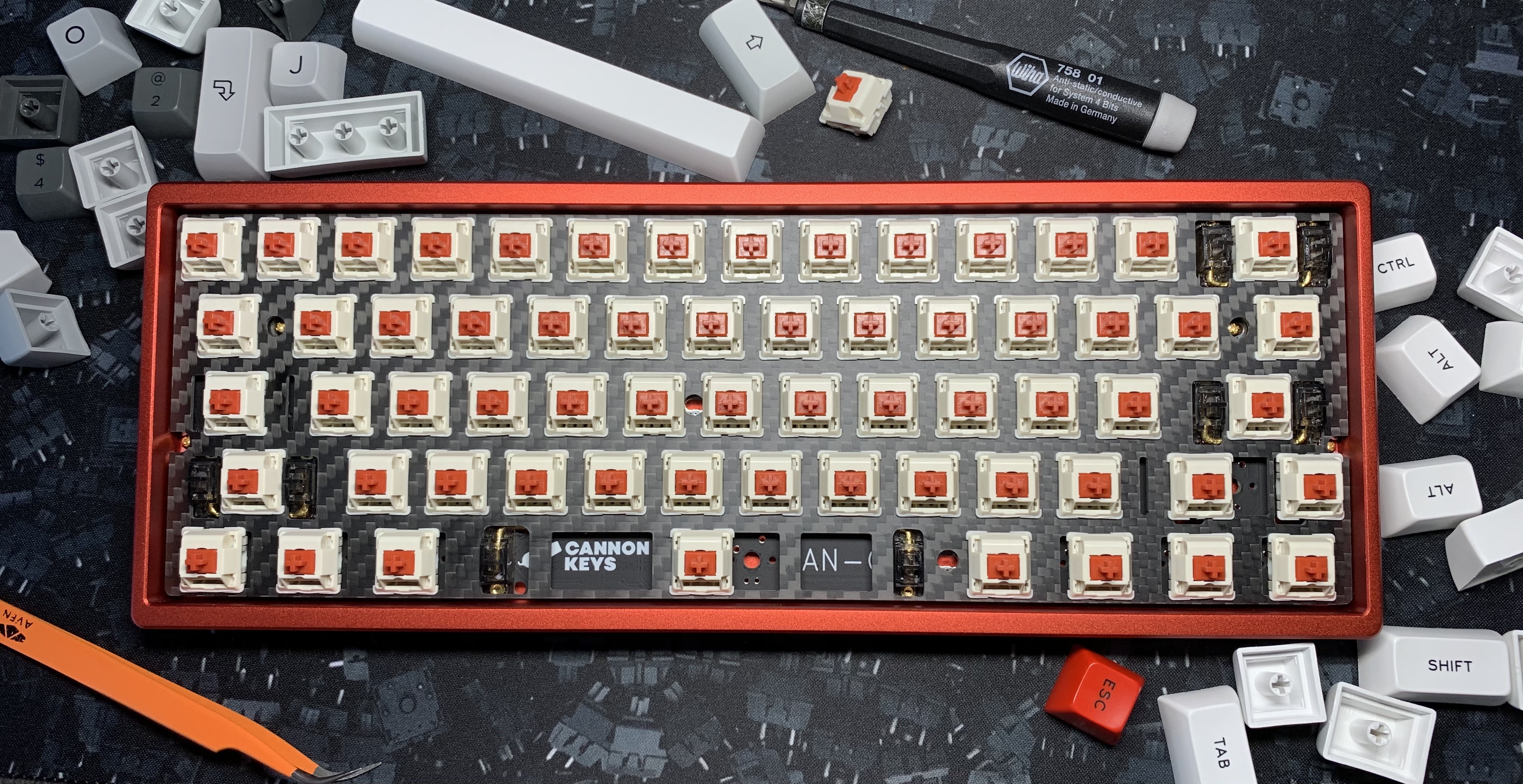

Well, here’s my first set of chores completed.
Lubed and filmed T1s - deskeys films, 3204 on the sliders and stems, 3203 on the springs.
I tried to up my stab lubing game this time. Stab housing and stem lubed with 206g0, stab wires lubed with super lube. Filled the butts with superlube after assembly. Kind of a cross between the way Minterly and Taeha do things. Thought I’d mix it up.
Plate is carbon fiber from 1up keyboards, case is a Noxary T60 in hyper red.

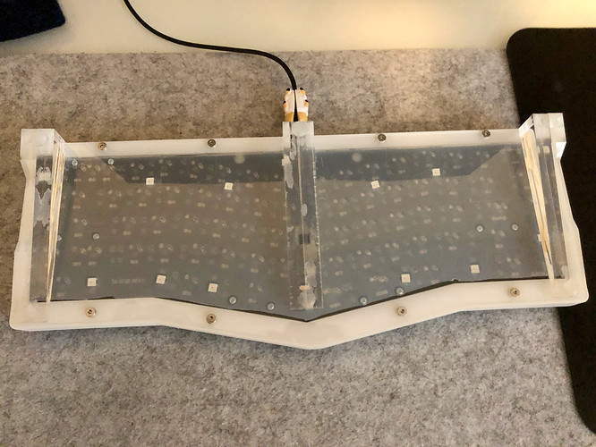

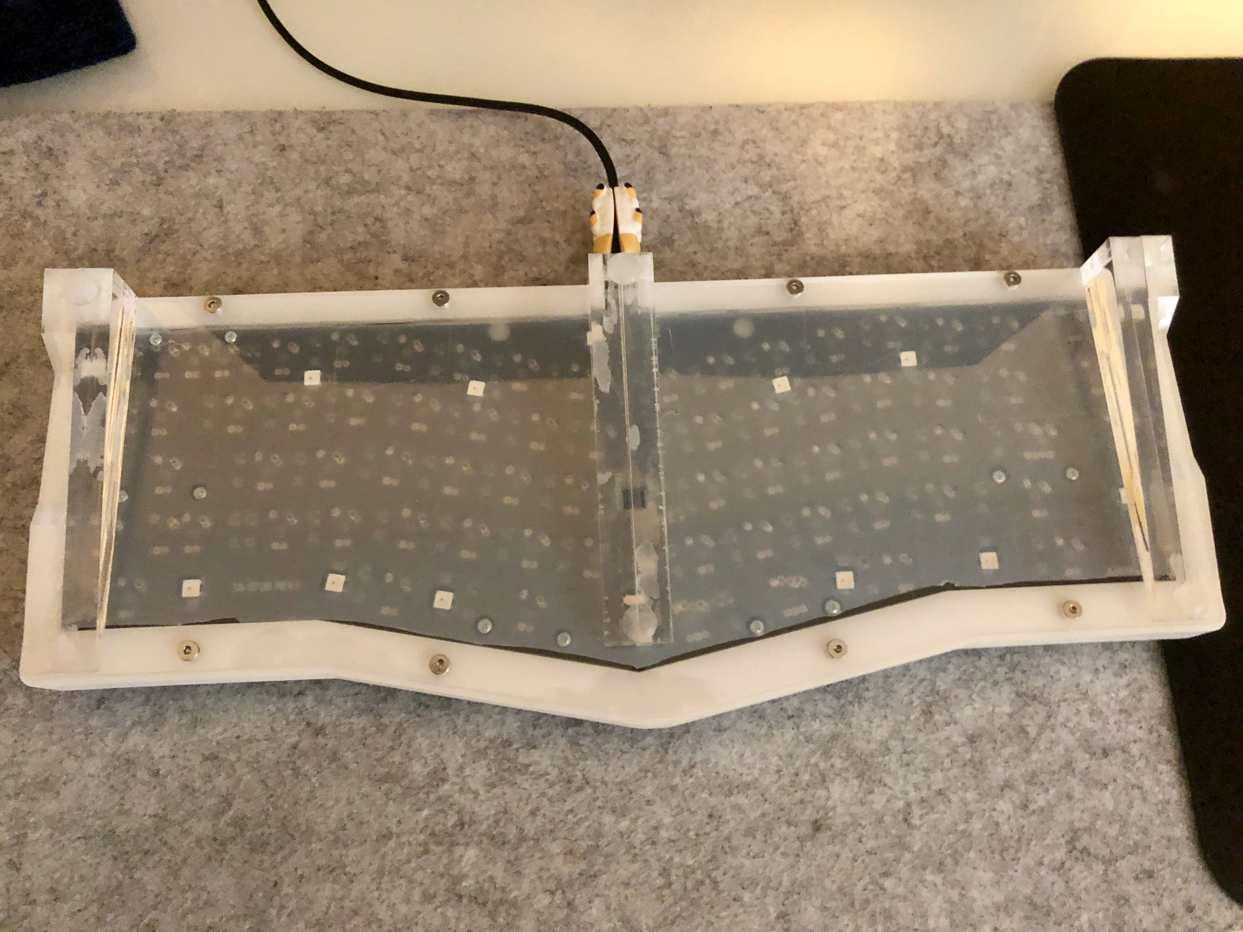

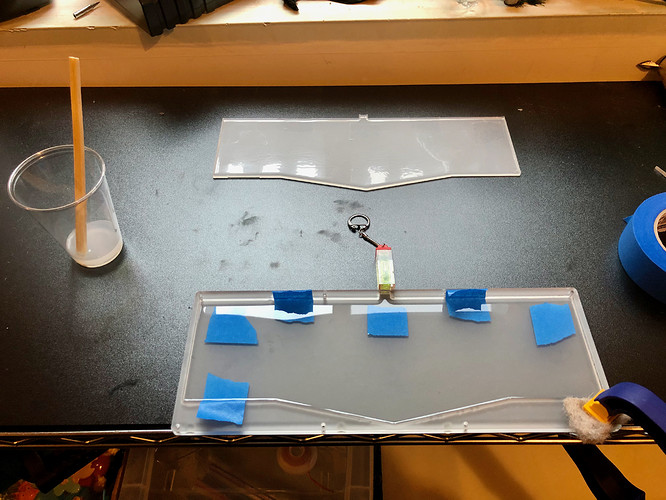

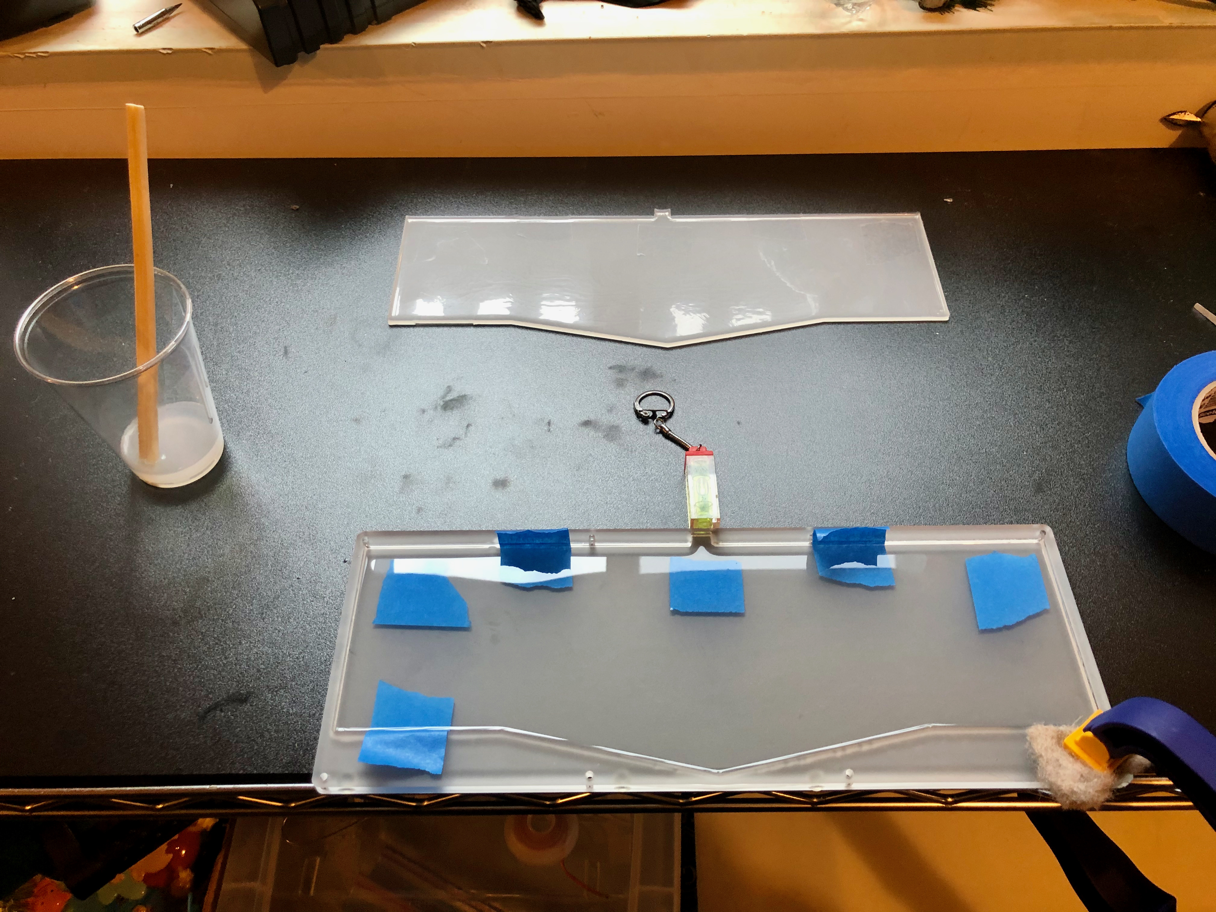

Follow up to my silicone mat project.
Silicone mat 2 of 3 done! I have not tried it in my Lubrigante yet since I am still using it as a mold. However I am pleased with the results
It really cut down on some of the echo in my non-lubrigante board pictured above. Sound did not change too much, but it added some nice heft too.
Only issue was that the silicone kinda clung to the sides of the mold, so those parts of the mat were thicker then the rest and I had to cut them off to allow for a better fit.
Pretty fun little project all and all. Not sure I would recommend silicone over foam unless you can get multiple mats like I am doing or if you need something a little more custom. Silicone seems to be just as expensive as laser cut foam, and you still have to do the work. I was gifted the one of the larger sizes in the link below, and I think I could probably do 4-5 mats with ~21 ounces. I originally got this idea from here, and I bet the 7 oz. kit would be enough to do a single board, like a Tofu or similar. At ~13$ USD, this might become a better option than foam.

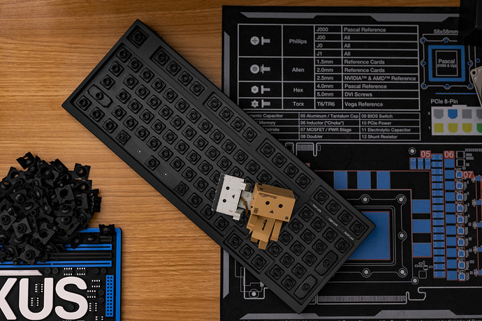

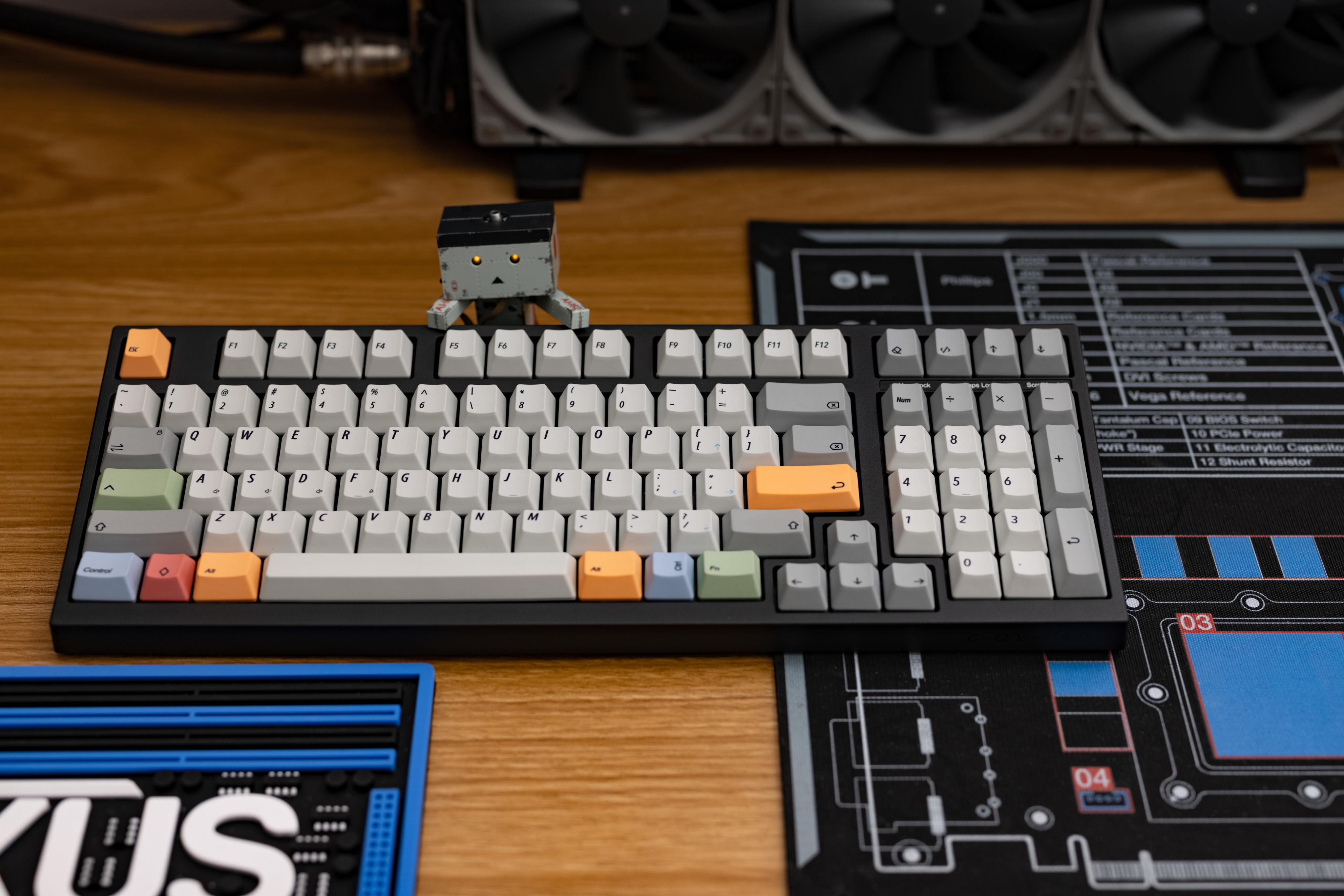

Annnnnnnnnnd done! Swapped the caps too.
Wanted to get this out of the way before 2021 and I did!
(I did not think I was going to lol)
how are they? was think of maybe getting some for a few of my mod keys.
How is it to type on?
@louuuuuuuu @ddrfraser1 I expected them to be ridiculous and they are. I have some normal Redux ones that I’m going to put into the letters. I will leave them for the modifiers.
