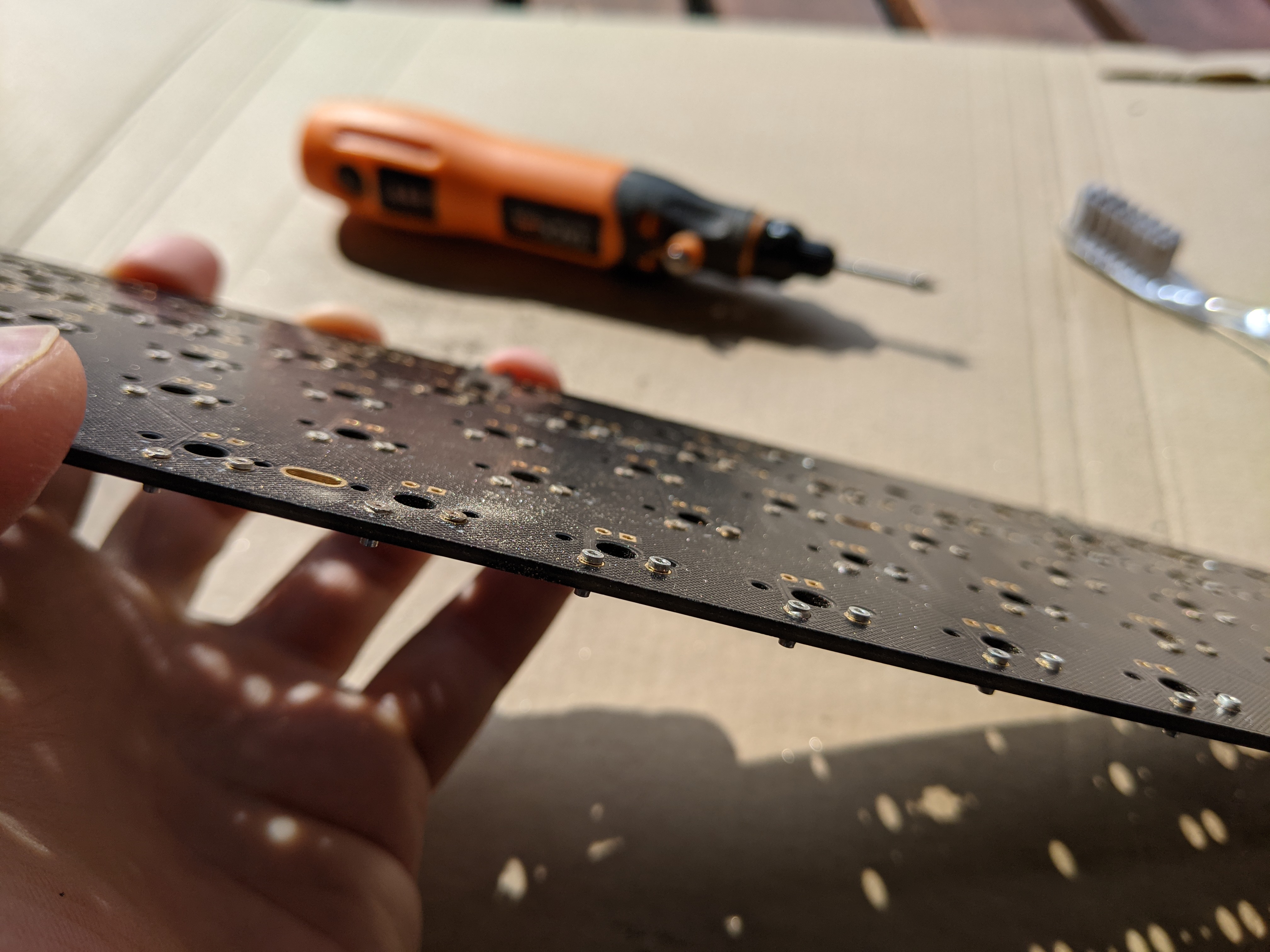

Grinding down the mill max sockets, hoping it’ll eliminate (or at least mitigate) the see-saw action with stabilized keys…
That moment when I brought the phone to my mouth and almost tried to blow the dust of the pcb.
please, do blow
just realized that some of the sockets are worn out already and need to be replaced. Should’ve done it before the grinding session…
I’ve found stem washers to be indispensable for this; whether it’s a long-pole switch, a switch that sits higher for some other reason, or stab-stems that sit low because of clipped legs; a few of these washers on the stab stems does wonders to mitigate that see-saw teeter-totter.

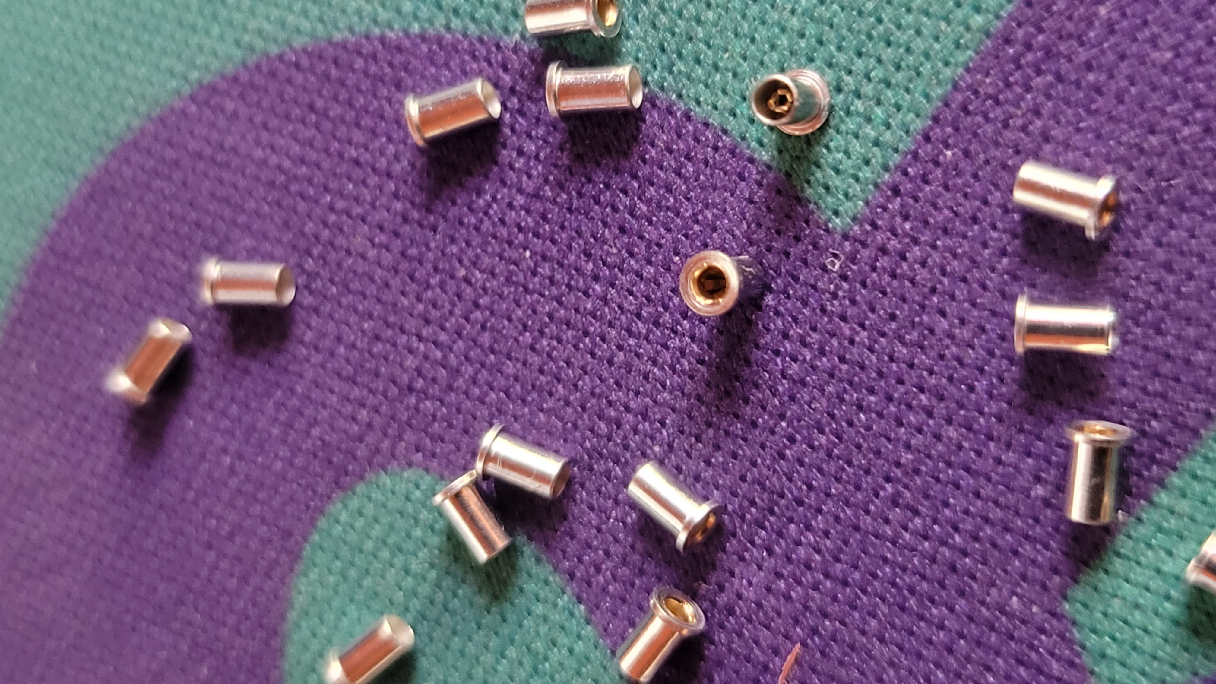

I just received some brand new sockets from Mill Max that have been designed specifically for our market. They have a thinner head so they should sit nearly flush. The come in 3 different lengths and 2 different finishes - gold inner/gold outer or gold inner/tin outer to save a little on cost. I will be stocking a few varieties as soon as my giant bulk order arrives.

Hmmm, interesting. I am not a fan of hot swap & probably not the target audience for these. Although if they work to allow switches sit just as flush as Kaihl sockets I would definitely be interested in outfitting a PCB or two with these. While I prefer my boards to be soldered I do keep a 60% with a Instant60 PCB around for switch testing. Given how delicate Kaihl sockets can be I’d see these new millmax sockets as a solid upgrade & could put them on whatever PCB I wanted.
Well color me interested
Will you post the arrival of these in the newsletter or some other medium? I really don’t want to miss out on snatching up a bunch.
I’ll be putting a small batch of them (about 1500 of each style) up on the site this coming week with no big announcement, just to start getting initial feedback from people. As soon as the larger order comes in I’ll make an announcement.
I’ll buy a few sets for sure. Have at least a dozen unused pcbs to put these in.
Definitely interested in these. Holtite sockets are hard to find outside of bulk-only vendors, so these seem like a potentially great alternative.
Thanks for the heads up! Will you be including a description that dimensionally compares the new sockets to the currently popular/standard offerings? I have limited experience with mill max, and I don’t want to pick up the wrong length.
