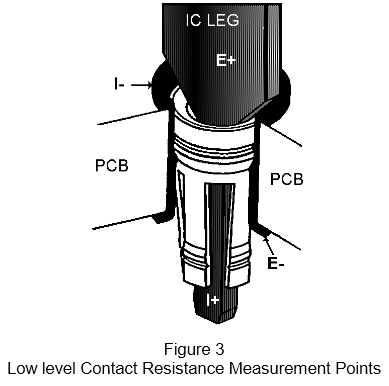

These are an absolutely new concept to me. It kind of sounds like they don’t even need to be soldered in?

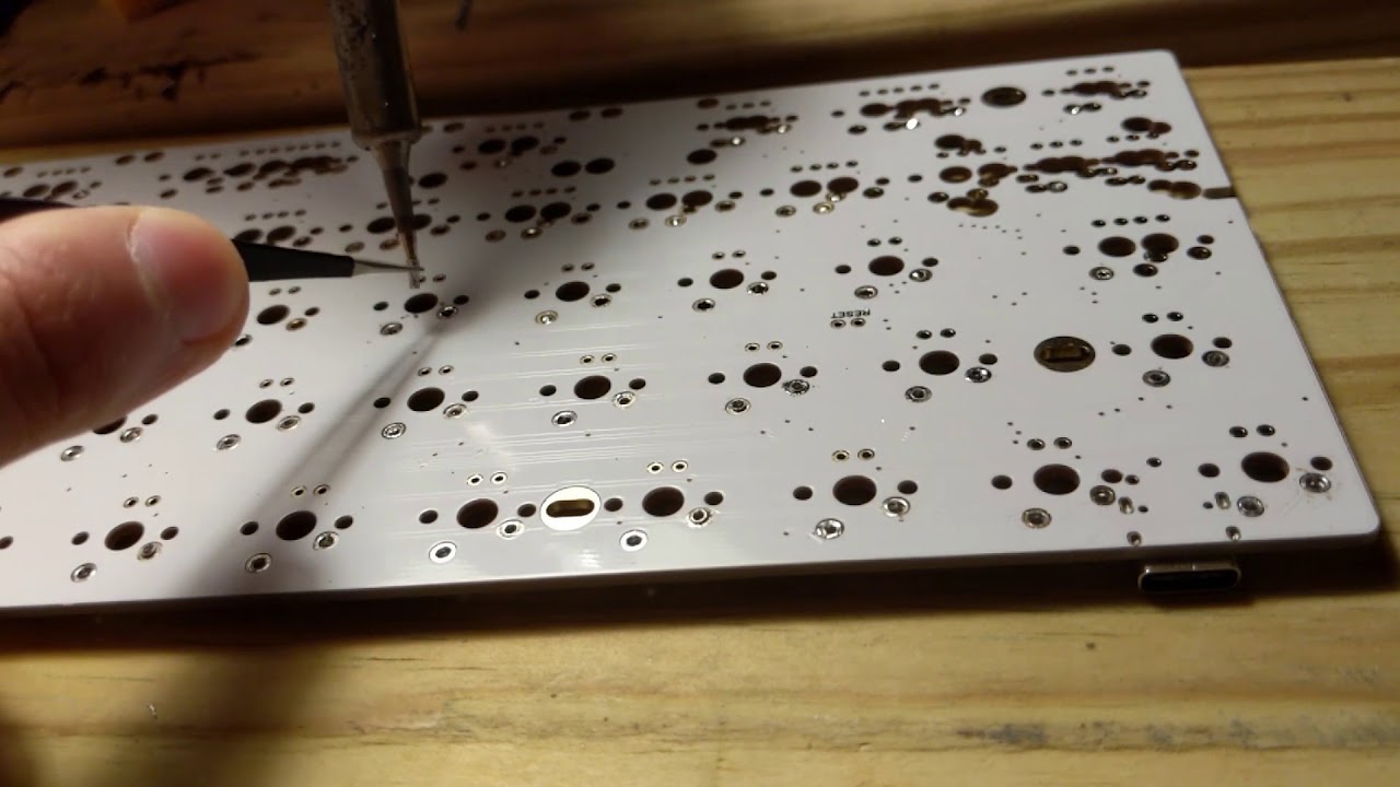

The type I’m talking about have no lip at all, and I’ve seen a couple different methods for installing them. This guy applies a blob of solder to the pad and sucks up the excess, leaving pretty much just a film. He then puts in the socket and heats it against the pad with the iron to set it in place:
Oh wow, I dig that a lot. I brought up the specs on the sockets and was reading through it and it really doesn’t indicated that the soldering is even necessary. I believe the intent is for the socket itself to be friction fit.
https://www.te.com/commerce/DocumentDelivery/DDEController?Action=srchrtrv&DocNm=108-1979&DocType=SS&DocLang=EN
The added bonus is that these sockets appear to be suited for rectangular IC legs, which would be ideal for the switch legs.

This is only true on some PCBs though. Out of the gate, not every PCB is compatible, hence why the blob and remove method is suggested. Somewhere out there, there was an old spreadsheet that listed the PCBs that were compatible with holtites. It is out of date now.

I have a love hate relationship with holtites. Mill-max are mechanically better but they sit higher. Currently using holtites because they can sit flat on the PCB. I solder them in using the technique below.
  1. Put sockets on sim card remover tool that comes with phones
  2. Using a paint brush dab a TINY micro amount of solder paste onto the sides of the sockets (don’t need much to get the job done)
  3. Transfer the sockets onto the PCB (make sure to push them down) so they are flat to the board (sometimes I use a washer to assist with this)
  4. Touch the soldering iron on top for couple of seconds to solder everything together.
If the PCB holes are too large I fall back to the video @Deadeye posted that helps to reduce the diameter. It doesn’t happen often but if the board is too tight you can using the soldering iron tip to push it in.

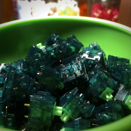

Lubed some Lightwaves

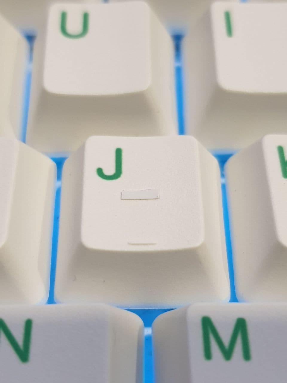

Added a little sticker to F and J keys, as the existing bump was a little too unnoticeable
How the lightwaves feeling properly lubed? I recently got a batch of the V2s & was happily surprised at how they felt. Everyone kept saying they feel like silent switches on bottom out due to the dampening legs on the stem it self. Although IME it does take a small bite out of of the bottom out clack, but nothing like switches with actual silencing pads. Then they are very smooth & stable to make it even better! Thinking I might put some shorter light springs in mine, lube them up as usual, & use them like that.
Totally agreed; I wrote something pretty similar in the script I finished last night for the video review I’m doing on these.
I’m loving the way they feel lubed. I’m a little too shaky to type accurately with speed switches like these, but they sound and feel very nice with lube. (I used 106 for mine.) Sometime this week I’ll have that video ready; it’s got a comparison sound test.

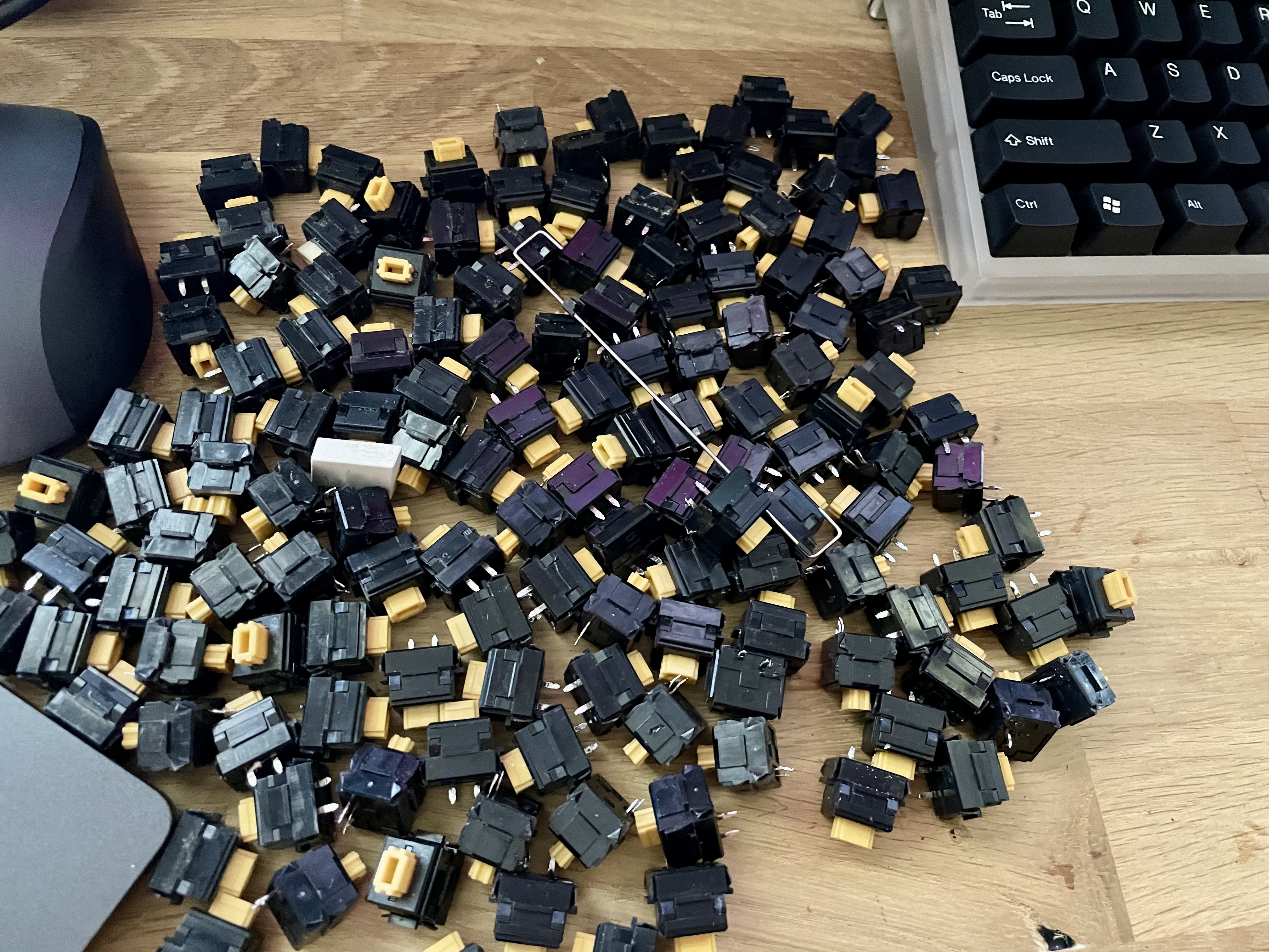

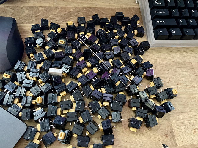

Desoldering 150+ Amber Alps… I really, really hate desoldering. Every time I do it I think “never again.”
It’s those “never again” feelings that finally pushed me to get one of these:
Same! I got the FR-301, not quite as industrial as the FM-204 station, but man has it saved me about a thousand headaches so far…

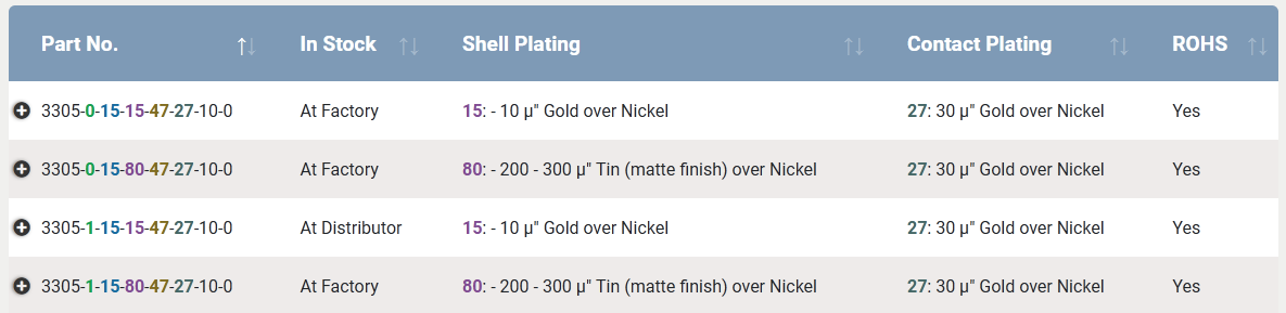

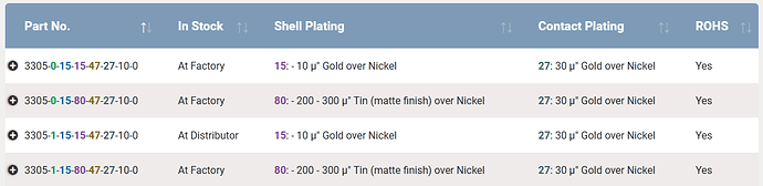

Did they sell out really fast or…
Mill Max Factory shows them as being in production.
https://www.mill-max.com/products/receptacle/3305
Mouser has a tiny quantity on hand of the mid-length, 3.3mm version (63 at time of posting).
https://www.mouser.com/ProductDetail/Mill-Max/3305-1-15-15-47-27-10-0?qs=%2Fha2pyFadujz5Ax1owBAE0PFWq3NTccLgE0UZOfZP2jf%2FIGPE1A1Dh4hYZ4%252BEop7
