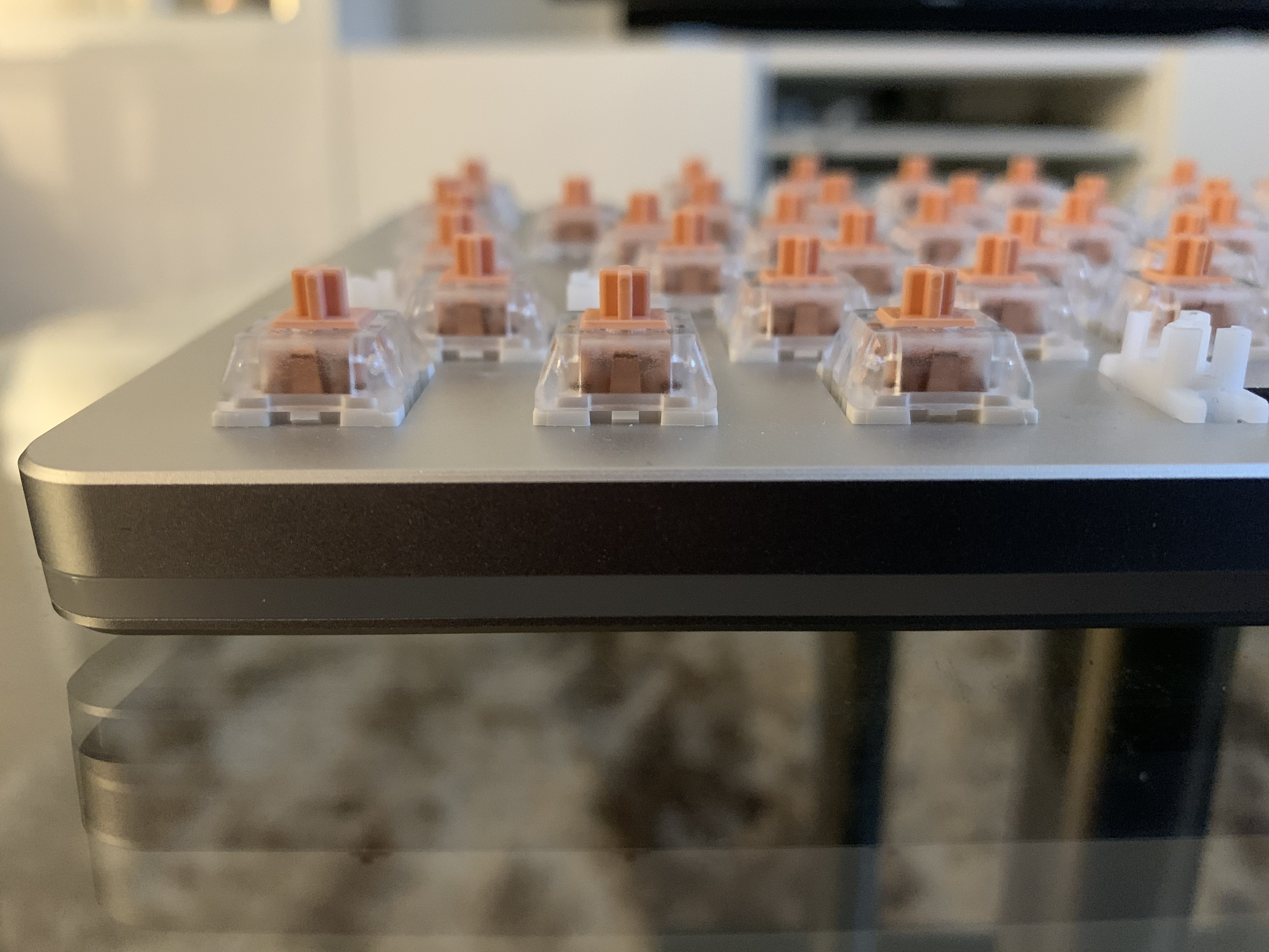

Funny coincidence - I ran into someone else who noticed the high resting position and “settle-in” in their Zilents just yesterday - right after I told you I couldn’t corroborate it.
It’s a very fixable issue (Outemu did), and I’d be surprised if innovation didn’t continue with silents to address it, whether occasional fluke or design flaw.

And talking about coincidences look at this picture, noticing something familiar?
It would seems like my Halo True they are not level either and I never noticed.
Mine are the same.
There’s a subtle difference in the resting height between most switches, and those Outemu silents sit lower than most - they’re kind of an extreme example.
The real thing to watch for is if that is having an effect on the travel or feel - in most cases, it’s just the spec of the switch - but in the case of Zilents vs Zealios, I think those top dampeners were interfering with the intended feel of the switch (by being too short for the housing), but not so with the equivalent non-silent versions, which sat comparatively lower.
I used the Halo Trues with my CTRL for a few months, and they all felt as they should to me.
Yes they feel the way the should (I suppose), I spent some time to click them eyes closed to try to feel them well as I didn’t feel anything weird.
So now I’m even more intrigued maybe get a small pack zilent and try how the fell
And today I learnt about QMX clips and I was thinking, maybe I can then use a normal good tactile switch and silence it with the clips instead of go silent and risk to have issues with them. What are your thoughts @Deadeye?
