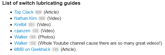

This thread should have all your answers. Which Lube for Switch Lube: An updated guide on the what, how, and where of switch lubricants - #96 by Scriba
Sadly not, that’s even the Guide I mentioned in my post. All this video Guides are definitely not recommended for 205g0 (they’re using thiner and more lube).
