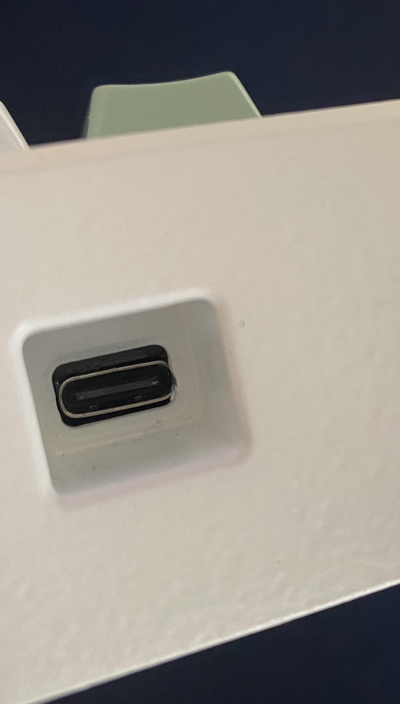

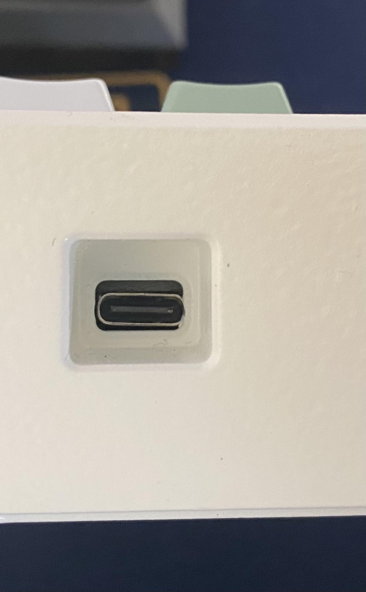

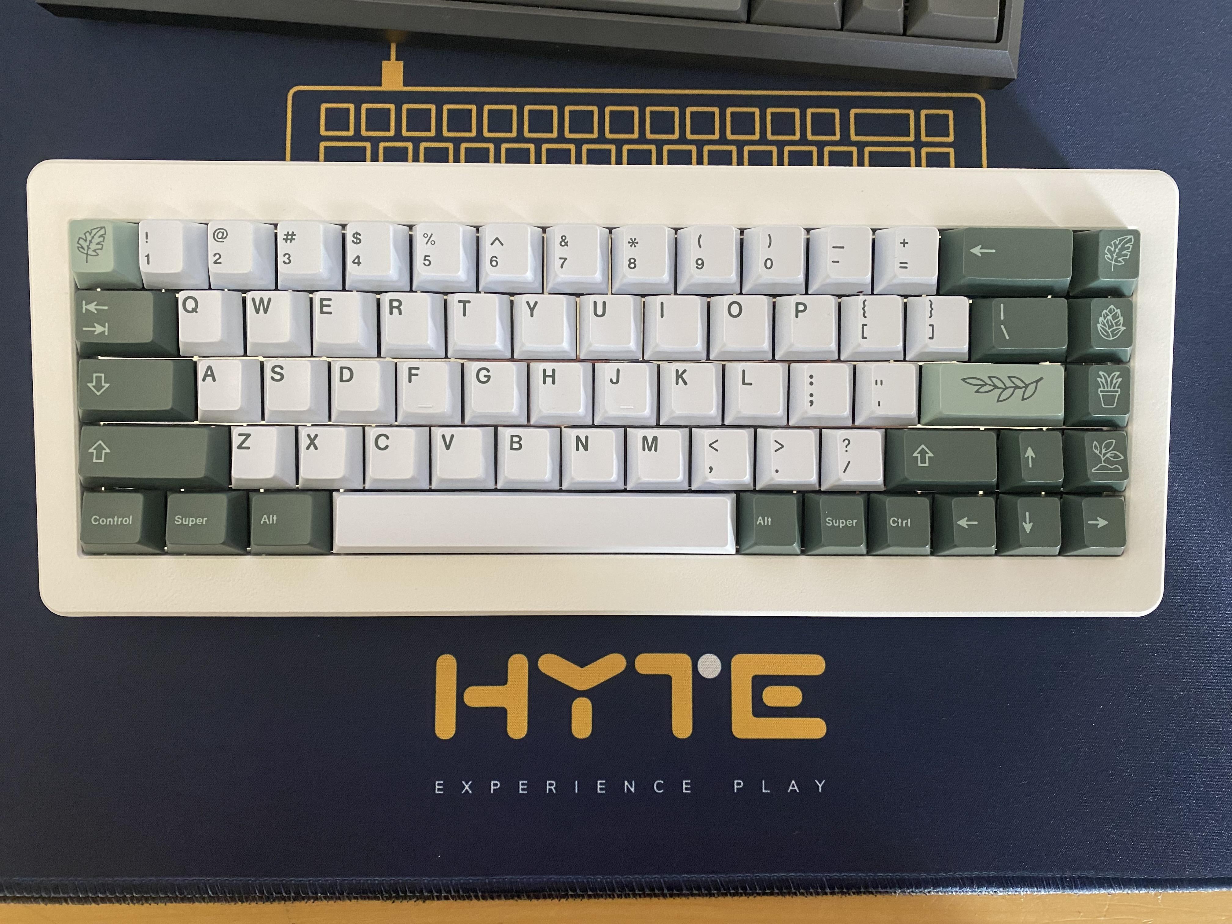

If anyone is looking for a replacement PCB, I found that the KBD67rev2 PCB works fine with the case… with some…compromise…
one, you’re going to have to jam the usb-c through the hole until it fits…quite literally… squeeze it in there, you’re going to be scratching inside walls of the hole, but I’ve honestly forgotten about the scratches till now…also some very slight tolerance issues with the plate…but it’s not that bad.
Haven’t had any electrical problem yet, had the board over over a year and a half now.
if anyone want pics on how the USB port looks, lmk.
Sure, post pics here.

I can’t contest whether or not the kbdfans PCB has static protection, but I will tell that I have desoldered that pcb with a hakko gun around 5 times? used different switches and such and typed on it for over a year before deciding to powdercoat the board. I’ve seen other posts on reddit where people had to Dremel their case in order to fit a PCB, but through determination and sheer will, I made it work. All in all, my experience with the board might be a unique one but hopefully, this helps.
Thanks! Great photos. Lovely board. Man, if only RAMA had dsigned that cutout 1mm wider! Ha.
