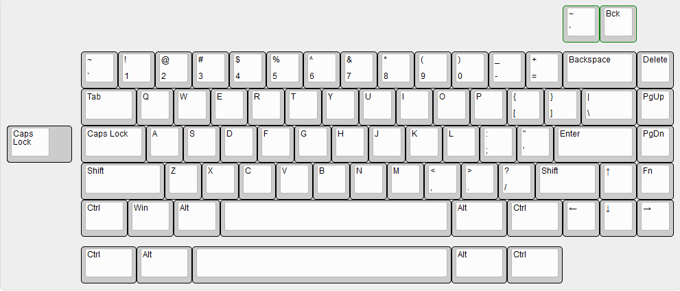

I started working on a layout options using KLE for a soldered PCB:

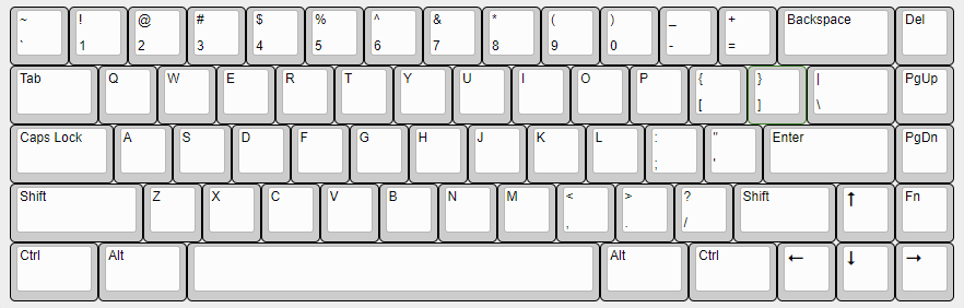

I tried to not make a Swiss cheese on the bottom row, with only two options:
- Win key 6.25u spacebar.
- Win keyless 7u spacebar.
Then an option of normal/stepped capslock and nomal/split backspace.
No ISO for now, this makes quite a mess on the PCB and not much people are using it (hey I’m French and still an ANSI layout user);
Also there is a debate on having the PCB soldered or hotswap, what do you think would be the most popular ?
In the case of hotswap, we may end up to select one of the 2 bottom rows if I can’t play with socket orientation.
Original PCB USB connector is Mini B.
Finding Mini B cables is getting more complicated nowadays and Micro USB is marginally wider (6.9mm for micro vs 6.8mm for mini) so I would lean to use micro instead. USB C is too wide for this board unfortunately.
As there are models with Nylon I’d put RGB underglow to add a bit of bling, but I do not plan to add per-key lighting.
I did not started the PCB design yet, so it is time to give your inputs guys
For example I could add back ISO support if many people really want it.
Happy to hear that someone is interested in making this. I would do it myself if I had any idea how. However, the goal was to design something better, and I’m certain anything I taught myself wouldn’t result in a better PCB.
Your decisions sound good to me. Limited bottom row options, no per-key rgb. I would prefer the original USB mini, but if micro is the only option, I could live with that.
I think hotswap might be interesting because it might interest more m65-a owners. Perhaps someone with a perfectly fine working board might want to pick up a hotswap PCB and a new plate to try something different?
Speaking of, are you thinking about making plates as well? I believe that the git repository has the original plate file that you could work from.
Good to hear you are still interested ![]()
USB mini is definitely possible, just that I personally found it was a pain in the arse to find a proper cable without buying it fron the internet.
The problem with USB micro is that it is thinner than USB mini so it will probably not be centered exactly with the case hole.
USB mini it is then ![]()
I could definitely start with an hotswap board.
I’ll see if I can fit all layouts in it, if not we may have to make a choice.
Yes I’ve seen them ![]()
And I’ll also work on plates of course.
But for the moment my idea on them is not very clear as there are a lot of possibilities.
I could provide different formats depending on the material the user would want:
- DXF format for laser cutting services.
- PCB gerbers for FR4/Aluminum PCB manufacturing.
- maybe also STEP format for CNC manufacturing (LaserBoost also recently manages this format) ?
We can keep the original shape, or go a bit crazy like adding flex cuts and/or leafsprings; the original design looks to be very rigid unless you go the plastic route.
