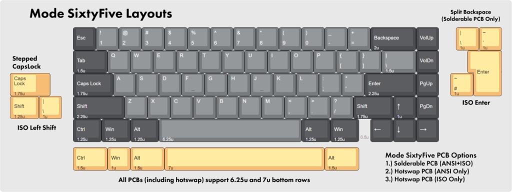

When we launched Mode we had not anticipated the amount of interest and support we received from folks outside the US, and with the SixtyFive we will be adding ISO support for both solderable and hotswap PCBs. The diagram below shows each of the supported layouts.
