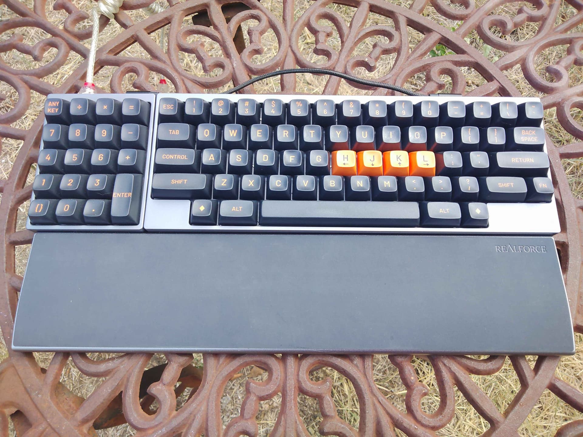

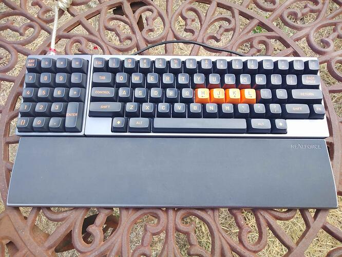

It did seem like it had been a while since I’d seen anyone talk about these.
That said, it looks like you can still order one from the site?
Just yesterday I went off about how dope these boards are to Clever. Des was ahead of his time with this release, the first all-in-but-the-keycaps custom EC kit. It’s a solid board, and the accompanying numpad with left or right passthrough connection that you could get for it really took it over the top.
