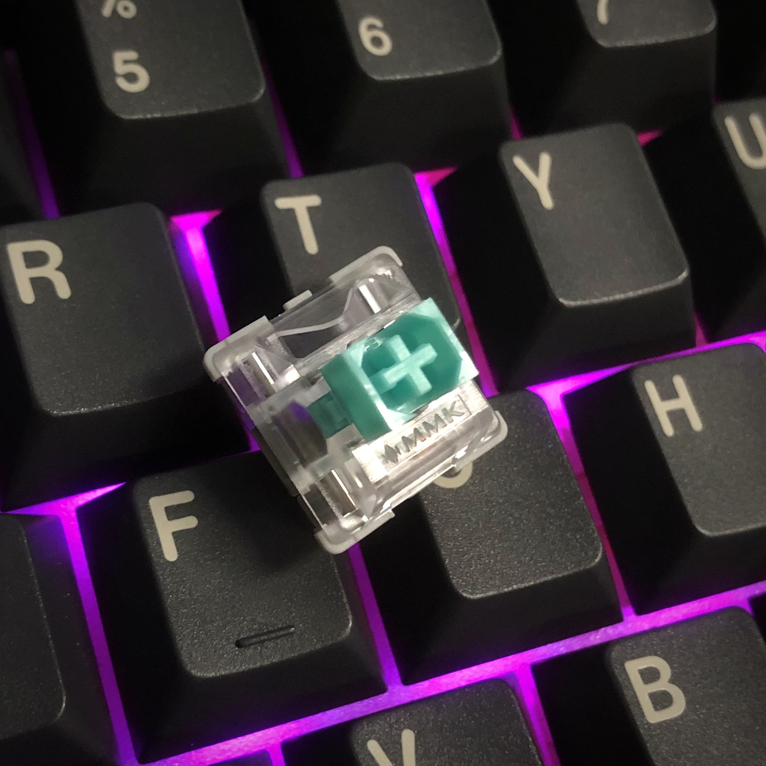

Some first-night impressions:
TL;DR: They’re good. Well above average, but there are quirks. Lower activation and an odd, if very mild resistance to the feel. If we’ve got “skate” and “butter” maybe these are… “mochi”? Between the two classical descriptions, definitely more on the butter side of things.

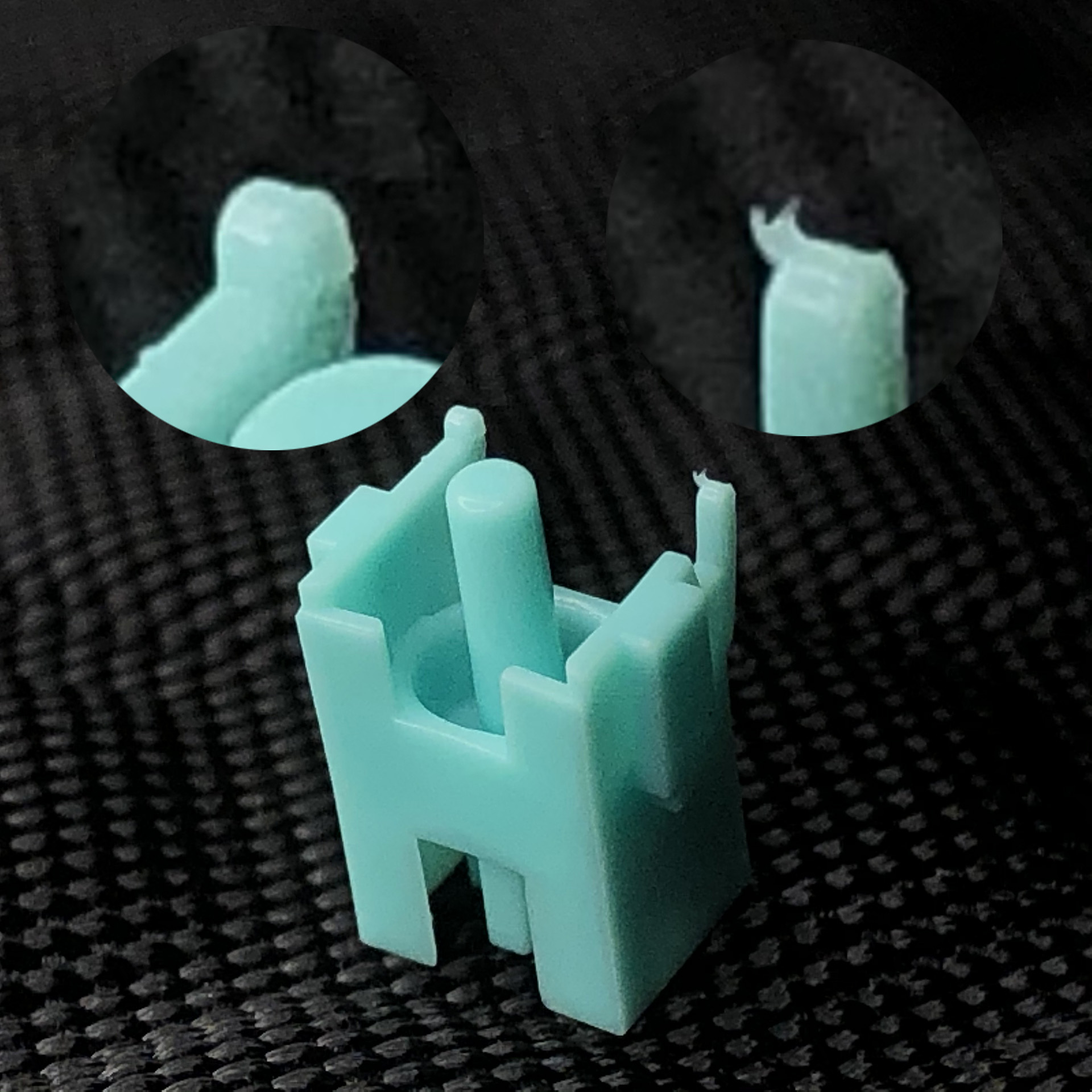

Stability: It isn’t that there’s less wobble when I put tweezers to the stem and move them back and forth, but that there’s less of the stem rattling about the housing on its way up and down the travel. In that way, they remind me of Gateron Caps - and in general they remind me of Yellows with a slow-curve feel. It does seem like there’s very good fitment between the top and bottom housings.
Smoothness: So this is overall very positive - I’d call it a “smooth” switch - but it’s also a mixed-bag, and I don’t mean inconsistency. In fact, the lube job itself is quite above-average as far as facory applications go. But - there’s another factor at work here, and (I think) that’s the interaction between the upper stem shroud and the top housing.
I don’t know how much that shroud contributes to the stable-feeling travel, but I do think it contributes to a somewhat bind-y feeling with these switches on off-center or especially slow presses. It’s not exactly the same, but not super different from the mild “sticky” feeling that factory Creams have. Side-by-side with Ink Yellows in this regard, there is:
- Less texture
- More stability in travel
- More smoothness
- More resistance
- Similar weighting through travel
Now - what’s different about these Frogs when compared to Creams, is that (no surprise) they are a lot less textured and scratchy. It also does seem more consistent during the travel, even when pressed slowly, as opposed to having a start-stop feeling like the Creams. For frictional resistance, it has smoothness of a kind. See what I mean about mixed bag?
As much time as I’m spending trying to describe it, I do feel the need to say again - that friction is mild, consistent to lateral pressure, and these switches are generally quite smooth when typing.
Not too bad to look at, really.

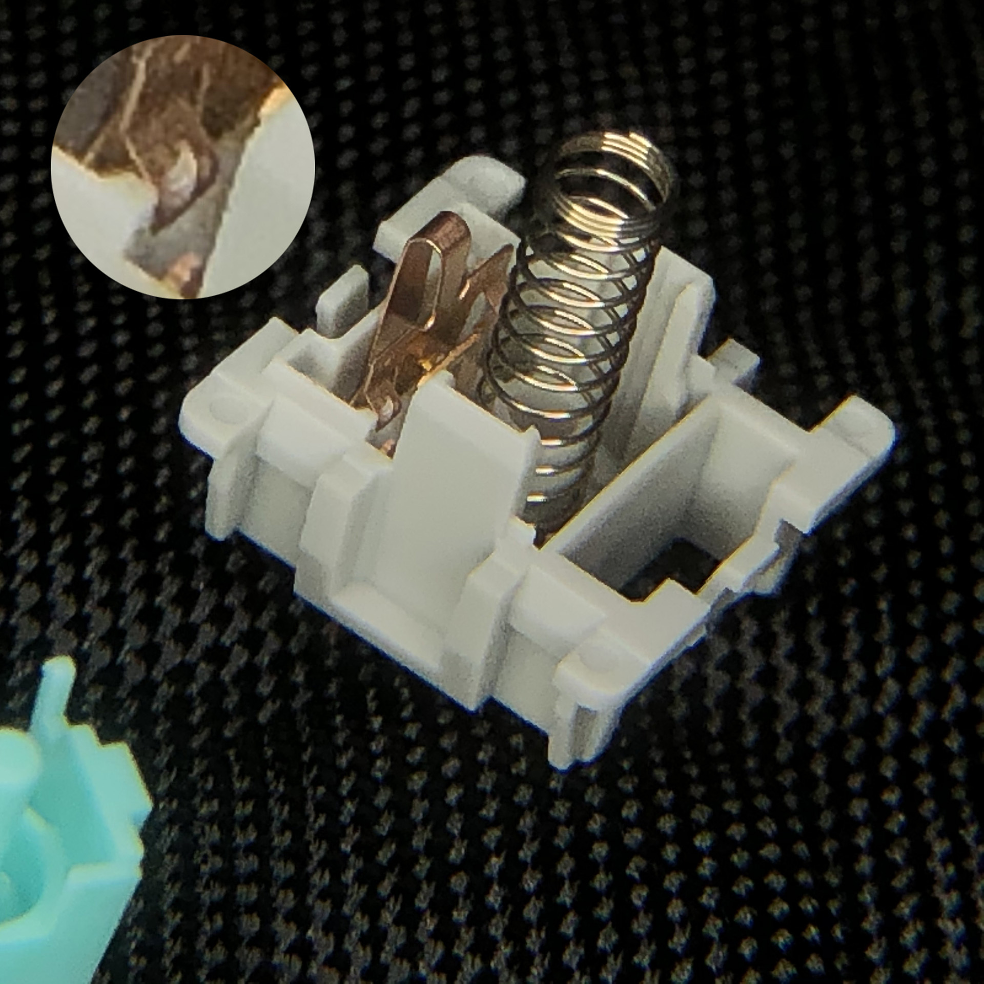

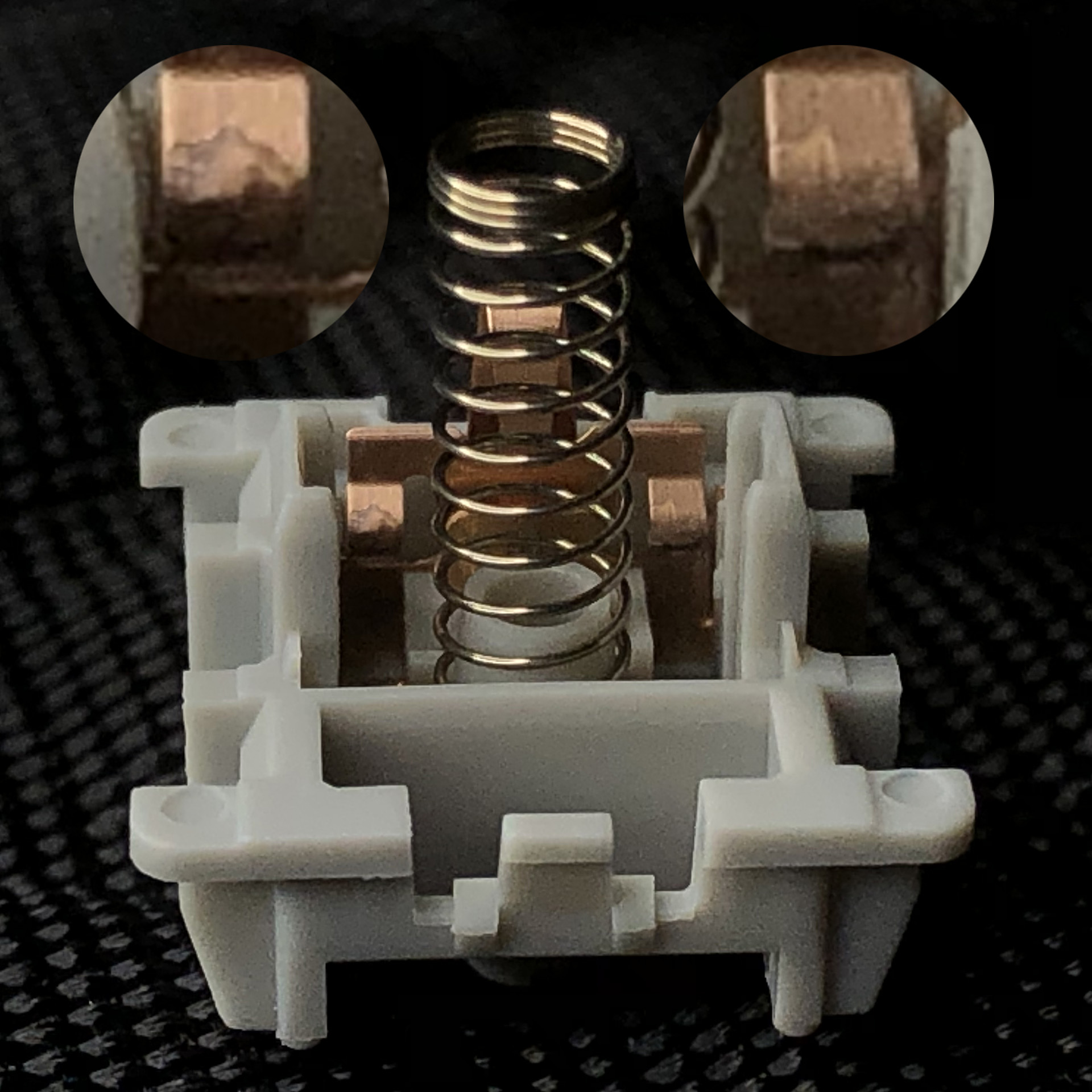

Lube: About that specifically, it looks to be a light (for a factory) application of light grease targeted to the legs and leaf:
I don’t think 105 holds its shape like that, but it’s smooth, whatever it is.
A little dab here, a little dab there…
Justa wee clart flippin’ updare, loika prhepskeul hairkot…
Not bad at all for coming right out of the bag. Most factory lube jobs are usually all over the place and too heavy - these are remarkably targeted and reserved in comparison. I couldn’t even see it on the stem without my magnifier.
