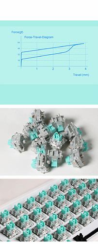

This switch has a longer actuation distance, which provides a thicker feeling and prevents typos.

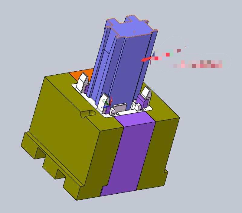

We have to say that we controlled the tolerance between parts (stem, base, upper housing) to a extremely low level, times better than other factories. This brings shocking stability.
It is hard to achieve both stability (lower tolerance brings more friction) and smoothness (needs less friction).
Thank you so much for your answer. The longer actuation distance is interesting. Most switches have actuation at approx. 2mm and bottom out at approx 4mm, but it looks like your team went with 2.5mm actuation and 3.7mm bottom out. This decreases the post actuation distance from 2mm to 1.2mm which is a big difference

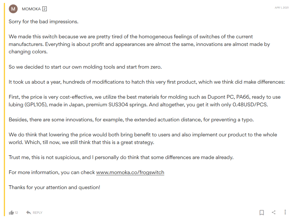

It’s a dilemma, for me, as a manufacturer, and also for all manufacturers.
The current market structure and generally used MX standard, and innovations are really hard to make under the limitations of the standard.
Innovation costs, for example, a brand new set of molding tool (about 6 parts) for a switch costs 100k USD. Making new and fancy stuff that doesn’t comply with the standards may cause huge loss.
When manufacturers are big enough in capital to make innovations, they make some, for example, light-sensed actuation switches. But because lacking the ability to promote and advertise, it is hard for the innovations to be implemented to the market.
