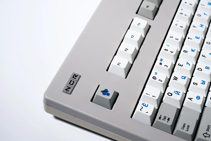

Direct quote from zFrontier for those that have ordered R2 Cool Grey:
NCR80 R2 Cool Gray Unit Update
Sorry for the long wait on the NCR80 R2 Cool Gray units. They have arrived late due to holidays but they are here finally.
However, upon inspecting the units, we found that the final product does not match the color shown in the promotional pictures provided by the supplier - the “cool gray” units are much warmer while the beige units are fine (see picture below).
We immediately reported this issue back to the supplier and pushed them to remake the cool gray units. However, so far there is no solid progress and even if they agreed on remaking the units, it will likely take an extra 2 to 3 months. Therefore, we are notifying you and will be offering the following options:
- Cancel and refund the whole order
- Get a 10USD partial refund per unit, and ship the “cool gray” unit out as is
- Switch to a beige unit
Again, we apologize for the inconvenience, please submit your response with the button below and let us know how to proceed. We will accept responses until Mar.16, 2022.
)“Cool gray” we received and the beige unit side by side
Beige and Cool gray from promotion pictures
Ha. I had a big suspicion that would be the case. I was judging color based on the keycaps used in those pictures.
I’m pretty sure there aren’t any white and gray keycaps with blue sublegends like that. That means the set was most likely beige. So the color temperature of the promo photos was very cool and made the gray look “cooler” than IRL.
In reality, the “cool gray” case was very probably very close to the GMK U9 color used on the ePBT modifiers. So… dark beige. It’s the same color as my CA66 that is “cement gray”
It’s a very nice color, I just wouldn’t call it gray. I’m happy to see that they’re trying to address the issue with good customer service. Good for them.
I hope this gets wrapped up soon as I am very much looking forward to participating in R3 for a beige case.
