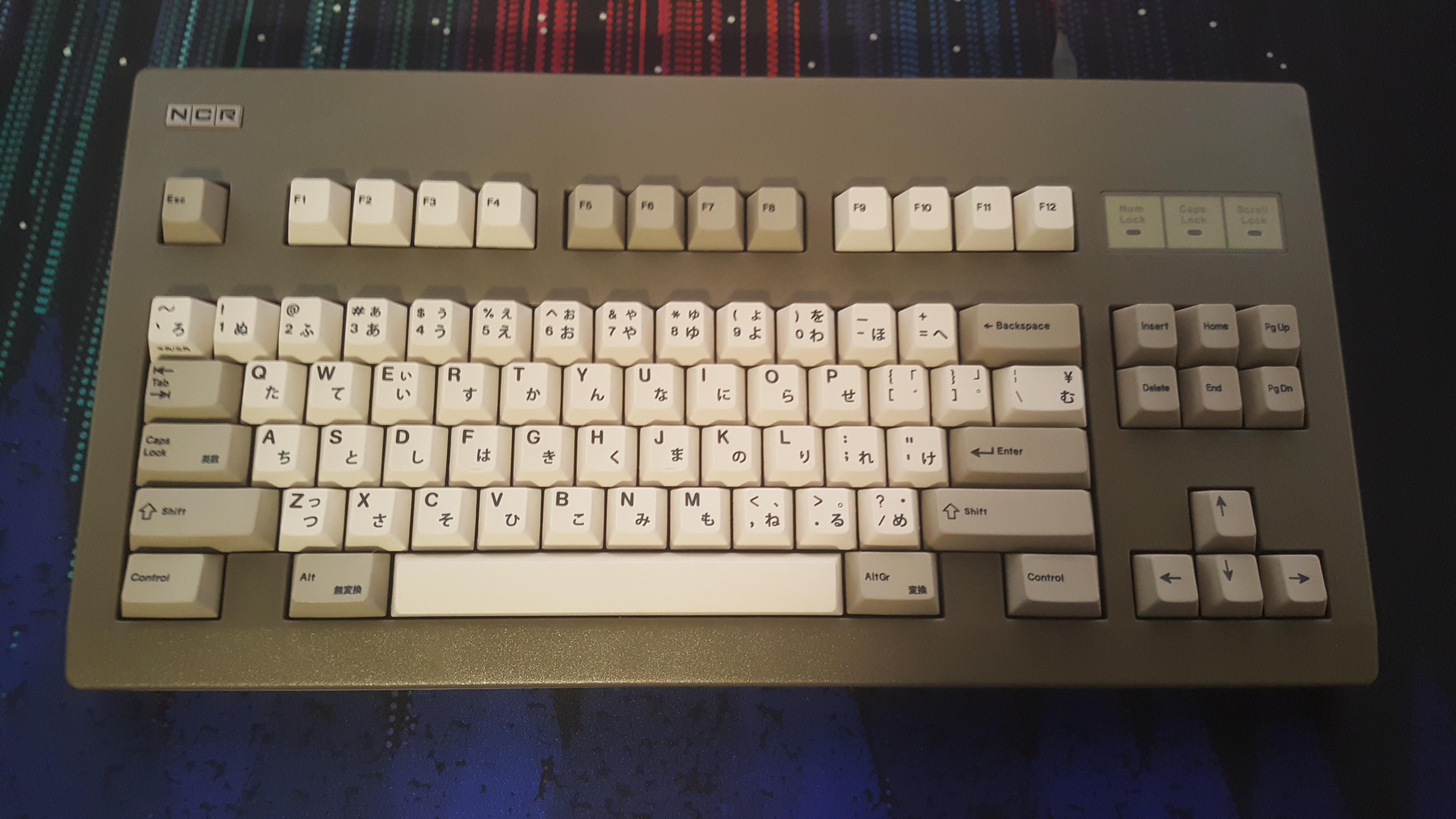

I have not been able to find a shot of the plate in the NCR 80. It is carbon fiber, but I don’t think it is attached too anything. It must just solely be used for 3-pin switches to be viable.
5-pin Clears are pretty hard to find. I have only seen CannonKeys carry them. I have some Ergo Clears that would be pretty cool for an NCR build, but I would need that plate
I purchased my kit with the CF plate (not that I’m using it) and it also came with 4 or so plastic spacers. I think this is for the longer screws to screws to secure the plate to the bottom of the case
Thank you! I guess following that logic, you could still use the plate but attached it via the PCB. Although… might be difficult to get your screwdriver in at that angle to achieve that…
Not if you went the hotswap PCB route hehe, then you could secure the PCB to the bottom of the case, then pop switches into plate, and pop the switch/plate assembly onto the PCB
I think pretty-much all of the Clears I’ve ever bought from MechanicalKeyboards.com and Novelkeys were 5-pin Clears. Just standard Cherry Clears, 3-pin wasn’t even an option half-the-time.
I’ve always had to clip them to get them into hotswap, at least some of them are soldered into a Leopold now.
Blacksimon has a decent review of this. Looks to be pretty good.
The solder PCB setup might be different, but I can speak to the hotswap version. The PCB attaches to the bottom case, but the plate cannot be secured with screws – it does however, have holes above the PCB screw locations to access them. It’s setup up like a typical bottom mount (think Tofu setup). The plate is really just meant to hold the switches in place for the hotswap version (that’s why it is an addon for the solderable version). There are so many screw points for the PCB that I don’t see a typing experience difference between using a plate or going plateless (no flex to be had), but there will be a difference in sound.
Oh the PCB gets screwed directly into the bottom case with this kit. I was thinking it was just a friction fit like OG Cherry boards.
