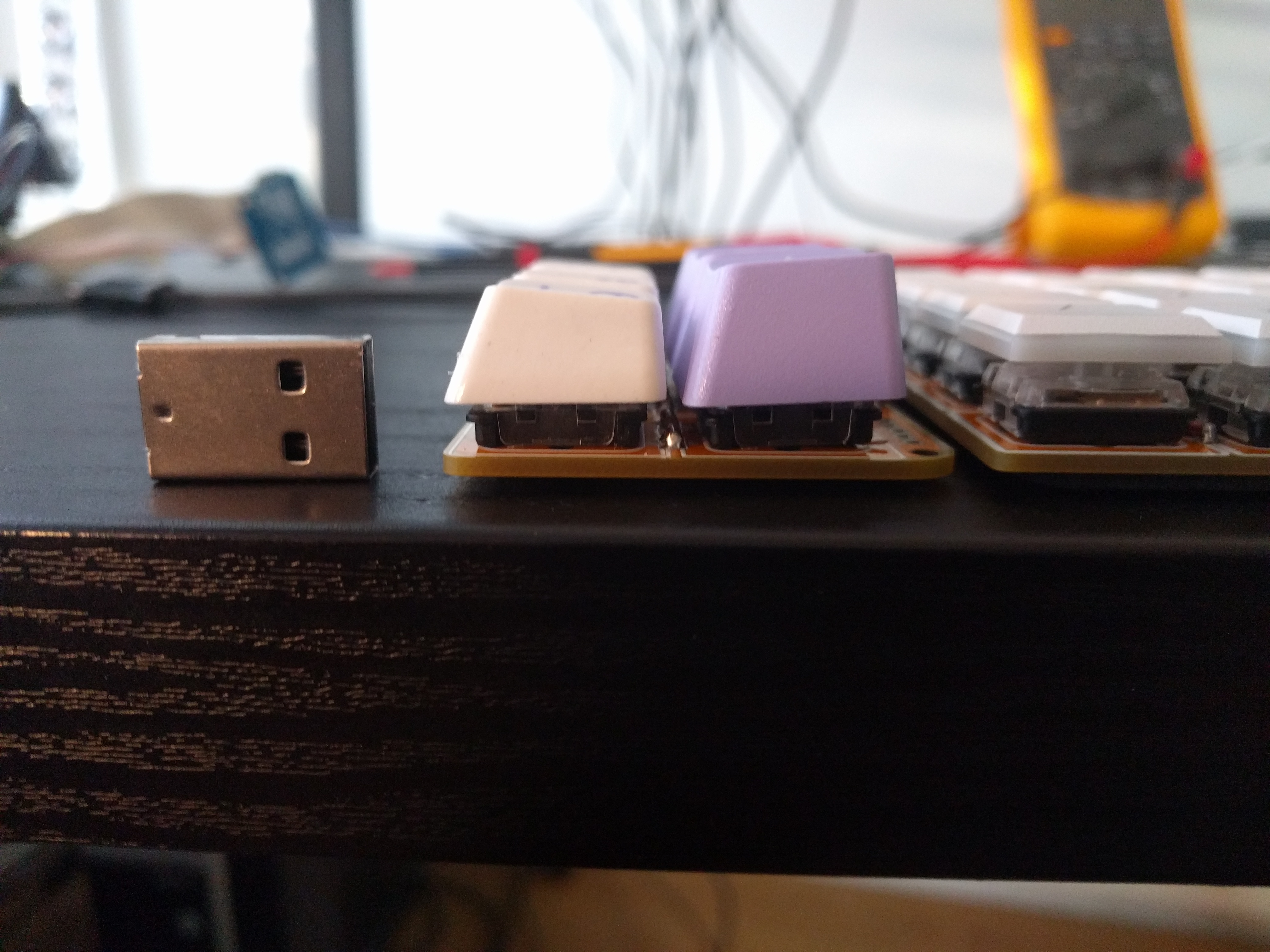

I finally have those switches in my hands, so I can write a little bit about them.

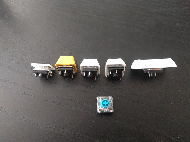

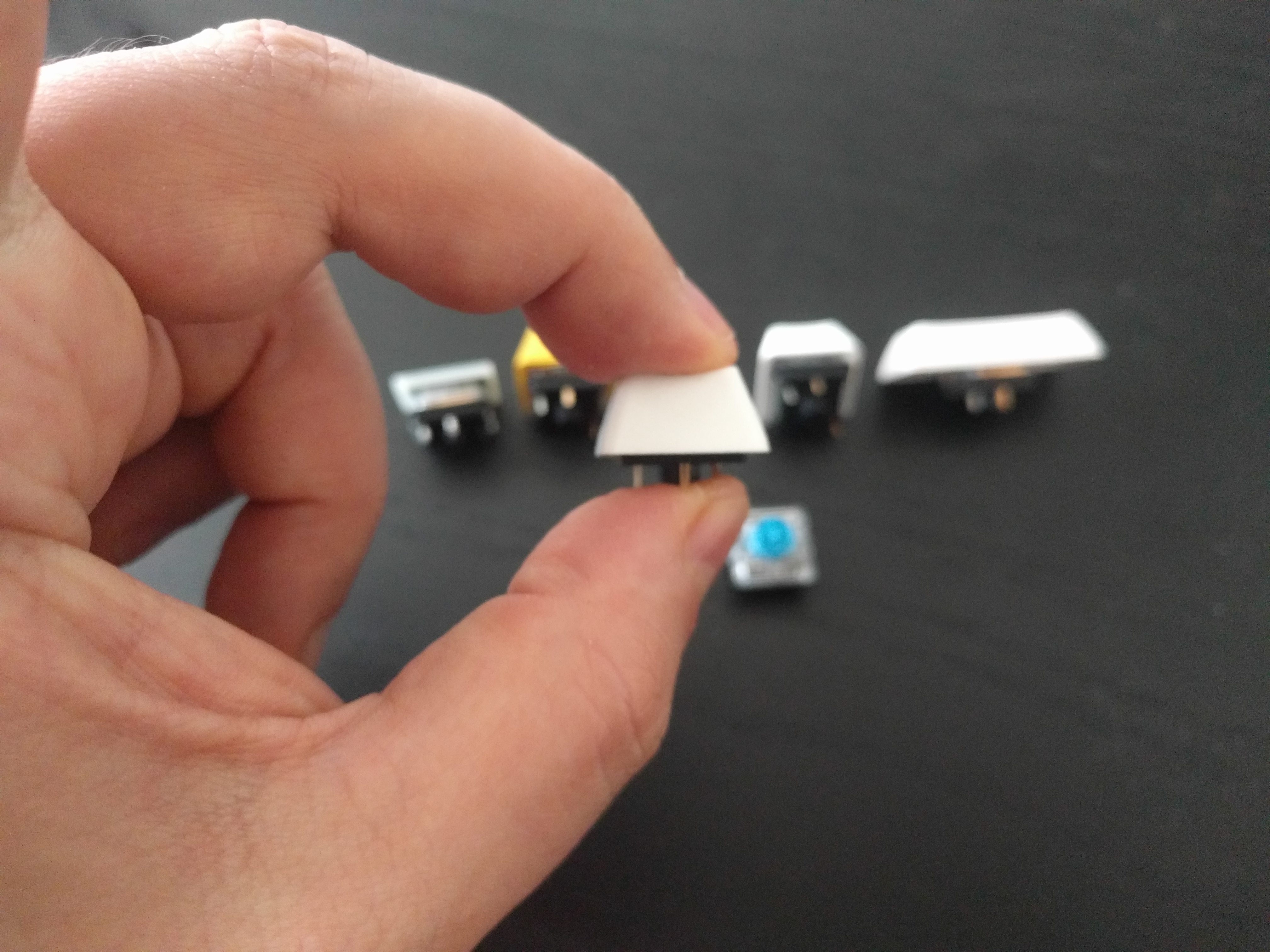

First of all, do they really fit with the regular keycaps? Yes, but with a caveat.
As you can see, they are no longer as “low profile” as the old ones — they key cap is simply too high, even if it’s a DSA profile. But more importantly, if your key cap has any kind of enforcing structures inside it, the switch will no longer fit inside the kecap.
Because the key cap goes all the way down to the PCB!

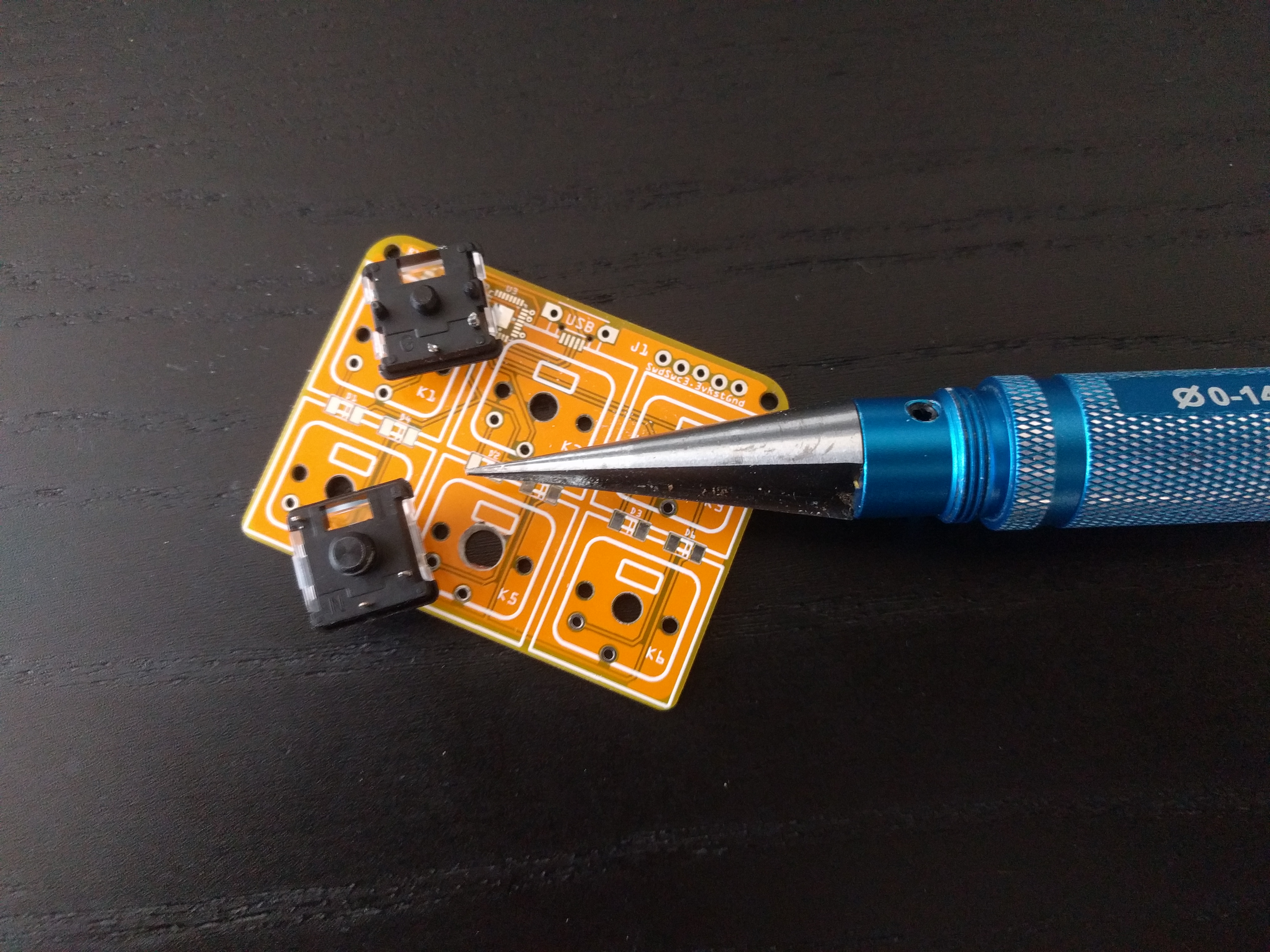

Next, let’s talk about compatibility with the old choc switches. While the pins are in the same places, there are no stabilizing numbs, and the center nub is much bigger. So I had to do a small “modification” with my reaming tool:
There is also that extra pin for stabilization, but I guess I can cut it off?
Functionally the switches are the same as the old switches — the mechanism is exactly the same, with a separate click bar, only the part of the stem that sticks out is different shape. There might be a little bit more stability, but it’s difficult for me to say.

Height comparison when mounted.
