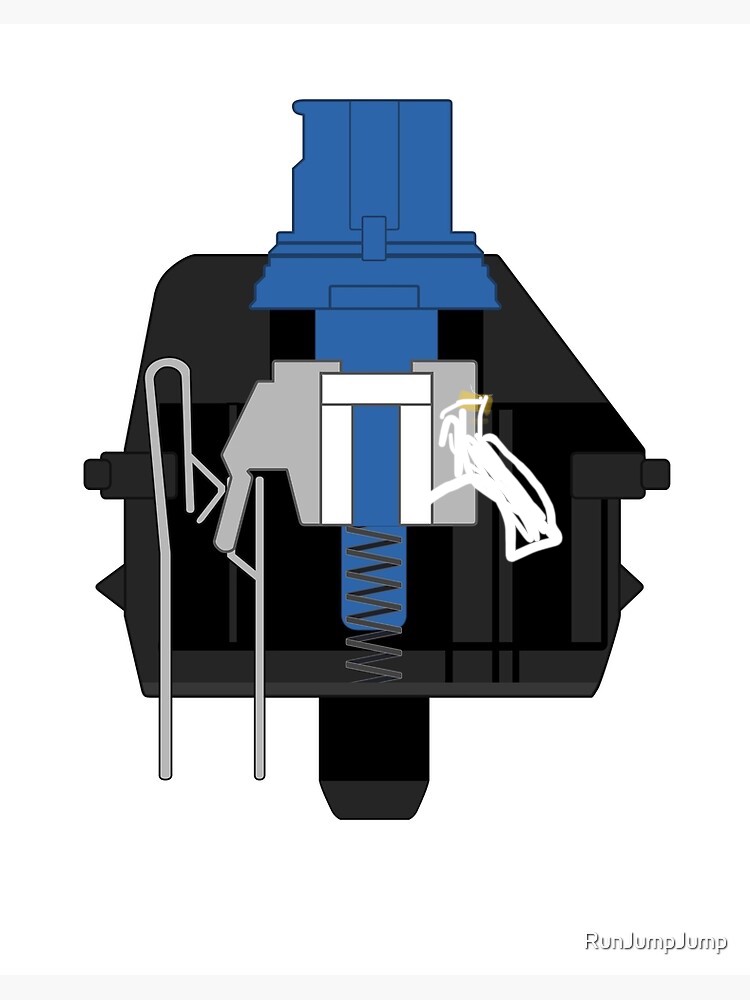

I heard one person suggest maybe twisting the stem but that would be wild
I was thinking that too but I would think the housing would have to be fatter to accommodate three sides having protrusions…
I was thinking a lockable click jacket or something. Like how people used to jail house blues… movable click jacket for clicky, locked click jacket for tactile and linear. Maybe you would flip the jacket for linear vs. tactile.
Clicky would just be a moveable tactile bump…
Here is my crude ass drawing. Clicky, jail house for tactile, back side stem has linear.
You have to lose led.
I think I cracked the case, not gonna lie. Think I should patent? @Zeal how close am I?
Novel design is cool but I’m more interested in switches I can enjoy using, not switches I can marvel over.
If Zeal recreated SKCM Orange feel and sound in MX switch form factor, I’ll scream like a fangirl.
It wouldn’t have to involve the stem if it is going to be an ALPS SKCM/L type actuation. As with those switches the slider is smooth on both sides & just serves to push the leaves for actuation &/or click/tactility. So basically you’d need one side to have a permanent actuation leaf, then on the other side you need to have a removable click/tactile leaf just like SKCM ALPS are setup already, but in a MX housing. The literal only difference between click & tactile leaves on SKCM ALPS is the top wings are bent in towards the slider on click leaves & left flat against the housing for the tactile leaves. What happens there is with the top wings bent in towards the slider the top of the leaf can bend away from the housing when the slider is coming down on it then snap back onto the housing after the slider gets over the bump in the leaf to cause a click sound. With the tactile leafs having the wings out flat against the housing, that keeps the top of the leaf from moving & snapping back when the slider passes it creating just a tactile feel. So really you could just provide a tactile leaf with the switches which can have the wings bent in to become clicky, or the leaf completely removed to go linear.
