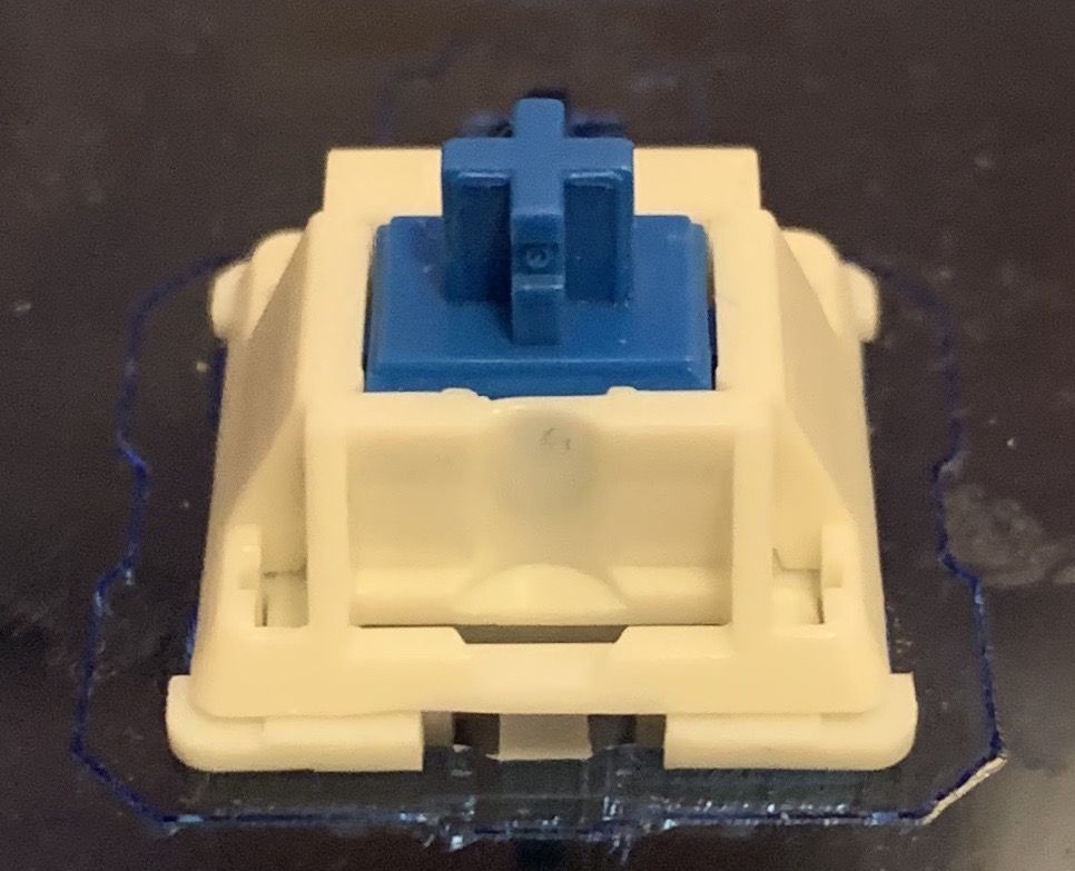

The stem
(sorry for the potato pic, I just moved and space is less than ideal right now, especially lighting-wise)
The stem is, obviously, a major focal point of this switch in particular. It’s a really radical departure from tactile stems I’m used to looking at; the bump near the start of the legs is fairly small, then there is a long flat space before a dramatic falloff (we’ll get to that later; it’s both fascinating and frustrating). Overall, the leg design on these is really aggressive compared to the more naturalistic curves we see on other stems. This contributes to an interesting feeling: the downstroke bump is relatively small, actuation happens more reliably during the falloff from the bump (it is harder, but not impossible, for me to overcome the bump on these and reach that falloff point without actuating the switch than it is with Zeal switches or Holy Pandas), and the upstroke is curiously tactile. All of these little events are sharp and crisp, there’s almost no roundness to the tactility.
The post on the bottom is not quite as long as the one on Halo stems, but it definitely is a longer post than on Zealios.

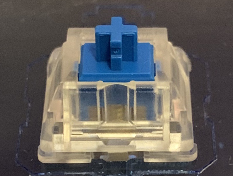

Not being a linears person, this is my first time playing with the creams’ housings. They’re a bit scratchy, initially? I’ve yet to lube them, but it’s my understanding there’s a “break-in” period I should put these through before actually lubing them, so perhaps I should hold off on that? Pleasant sound, although a bit higher-pitched than my panda housings. Opens real easy, though there’s some slight E/W wobble between the stem and housing compared to what I’m used to.

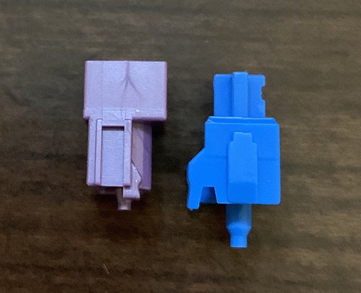

BOX Royals might be a fair point of comparison for the size of that initial bump, yeah. About a 10g difference in spring weight, though, so it requires a bit more force and as a result I’d say the blueberries initial bump feels a little less pronounced. The upstroke tactility of the blueberries is pretty unreal, though, and I can’t think of another tactile that quite feels like it.
EDIT: to follow that up, with the understanding that BOX stem leg to standard stem leg comparisons are a bit apples-to-oranges (apples to blueberries?), here’s a shot that should hopefully help illustrate some differences
Overall the size of the downstroke bump itself is perhaps a little bigger on BOX Royals than Blueberries, but we’re not talking the kind of difference between BOX Royals and Halo Trues here; it’s pretty minor. The real big differences are in how much travel there is after that ramp up in force before there is a falloff and how sharp an angle there is to that falloff. The falloff creates a really sharp dive into actuation (and then bottom-out) on the downstroke, and a really unique bump on the upstroke (which also seems to be what makes it difficult for lighter springs to overcome).

Just some notes based on experimentation with different springs I had on hand and various housings

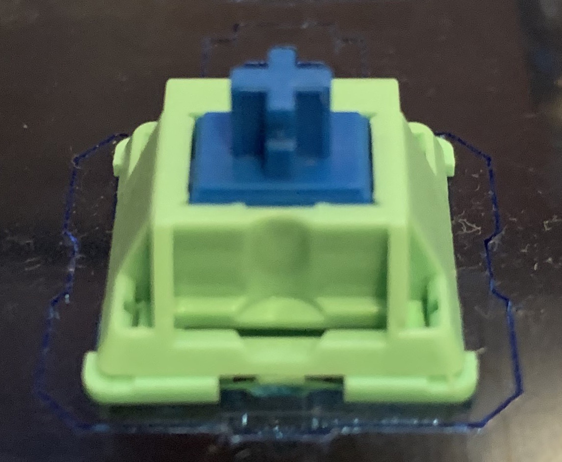

YOKberries
YOK Panda housing + Blueberry stem
Honestly, I kind of dig these. They still need a little bit heavier of a spring than I’m used to with HPs or Zandas, but they have an interesting feel to them. Might whip up enough to fit a hotswap board and give ‘em a spin for a week. Sound is clearer/less muted than in the stock Cream housings.
Warning: Extremely clacky sound if the stem sticks/slows before slamming back into the top of the housing, so avoid light springs like the plague. Needs lubing, as YOK housings can be scratchy.

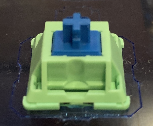

POMberries (?)
Invyr POM Panda housing + Blueberry stem
The leaves of these are very stiff (I only just opened these up for the first time, so this is also my first impression on these housings), which means even heavier springs are needed compared to the YOK housings. The leaf’s stiffness also somewhat interferes with the explosive upstroke feeling on these. Sound is slightly higher in pitch compared to the stock Cream housings, but similarly muted. (Is this just a difference of POM housings vs Nylon?)
Warning: Much harsher clack than stock & YOK if there’s stickiness/slowness on the upstroke due to a light spring. Scratchy as hell housing, too (might need breaking-in?). Wouldn’t recommend this over the stock housing, especially if you like the upstroke feeling.

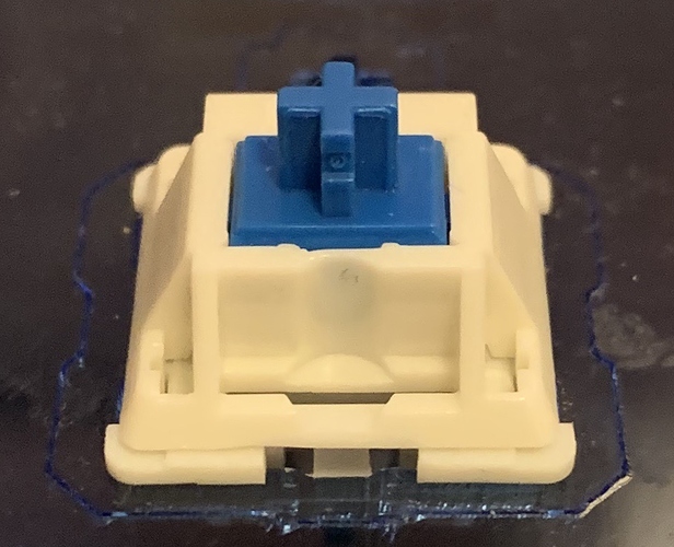

Zealberries (Berrios?)
Zeal V2 housing + Blueberry stem
Unsurprisingly, these feel and sound very clear and sharp. The pitch is the highest of the lot, as is to be expected with Zeal’s housings (although I wish it wasn’t the case). Additionally, these have little to no scratch. Zeal’s housings are pretty smooth stock, at least compared to everything I’ve got on hand for making tactiles.
What I wasn’t prepared for was how good both the upstroke and the downstroke feel in these; I knew from my experimenting with HPs, Zandas, and other frankenswitches that something about Zeal’s housings/leaves had to be working to make tactiles feel different at the top (I assumed it was purely leaf stiffness but now I suspect a combination of factors), but the downstroke bump feels more distinct than in any of the other switches and the upstroke is at least as pronounced as it is on any of them (moreso than on the POM panda housings). For whatever reason, these handle lower spring weights better than any of the other housings; less rail friction on the stock housing, maybe?
Warning: You still want to avoid light spring weights, but you are probably not going to have issues with anything >=65g except maybe on large stabilized keys like a spacebar.
