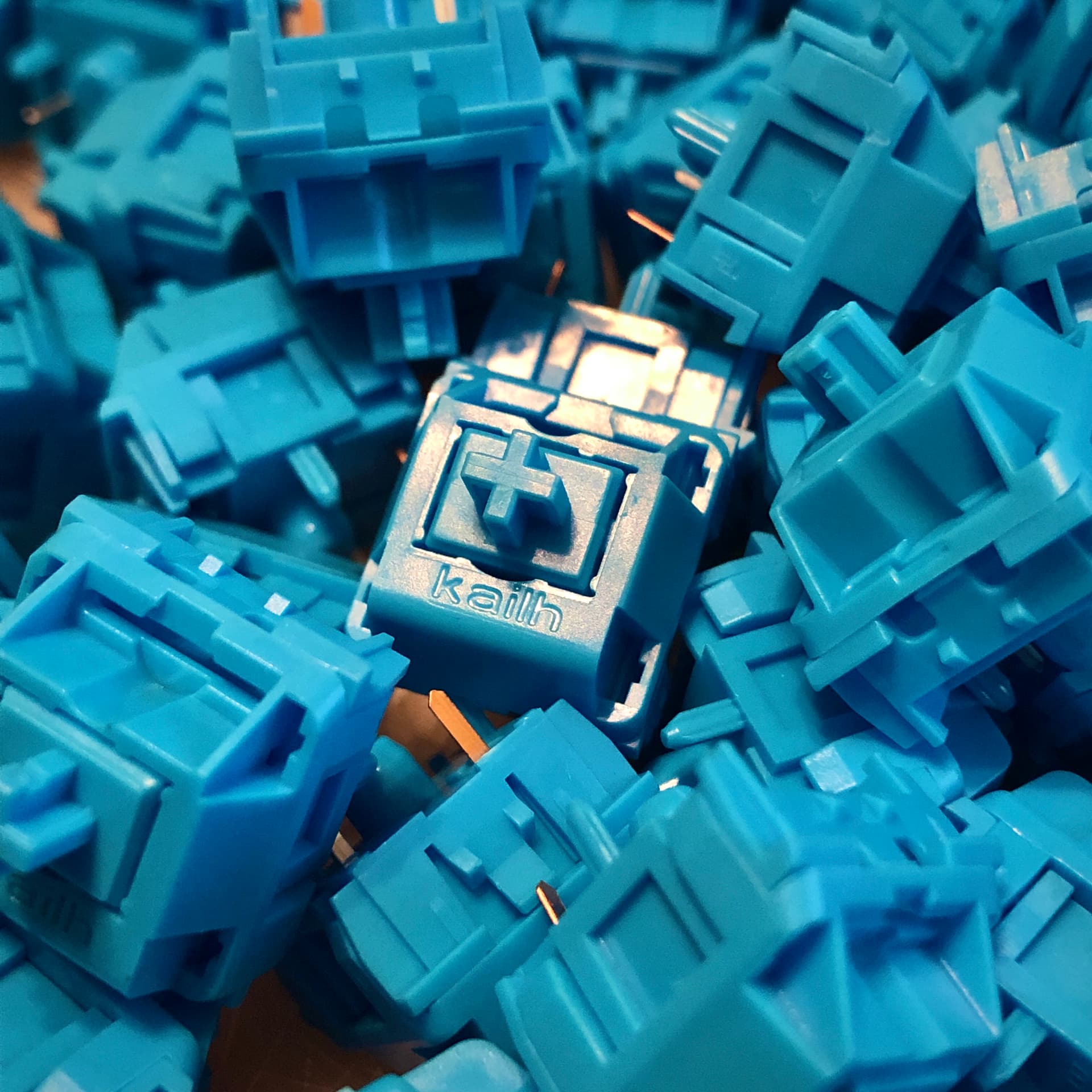

*Blueberries don’t carry the Cream name, but did utilize a version of the original Cream housing, and were the precursors to the current Cream Tactiles. (They’re also one of the most extra tactiles ever, right up there with Moyu Blacks and the like.)

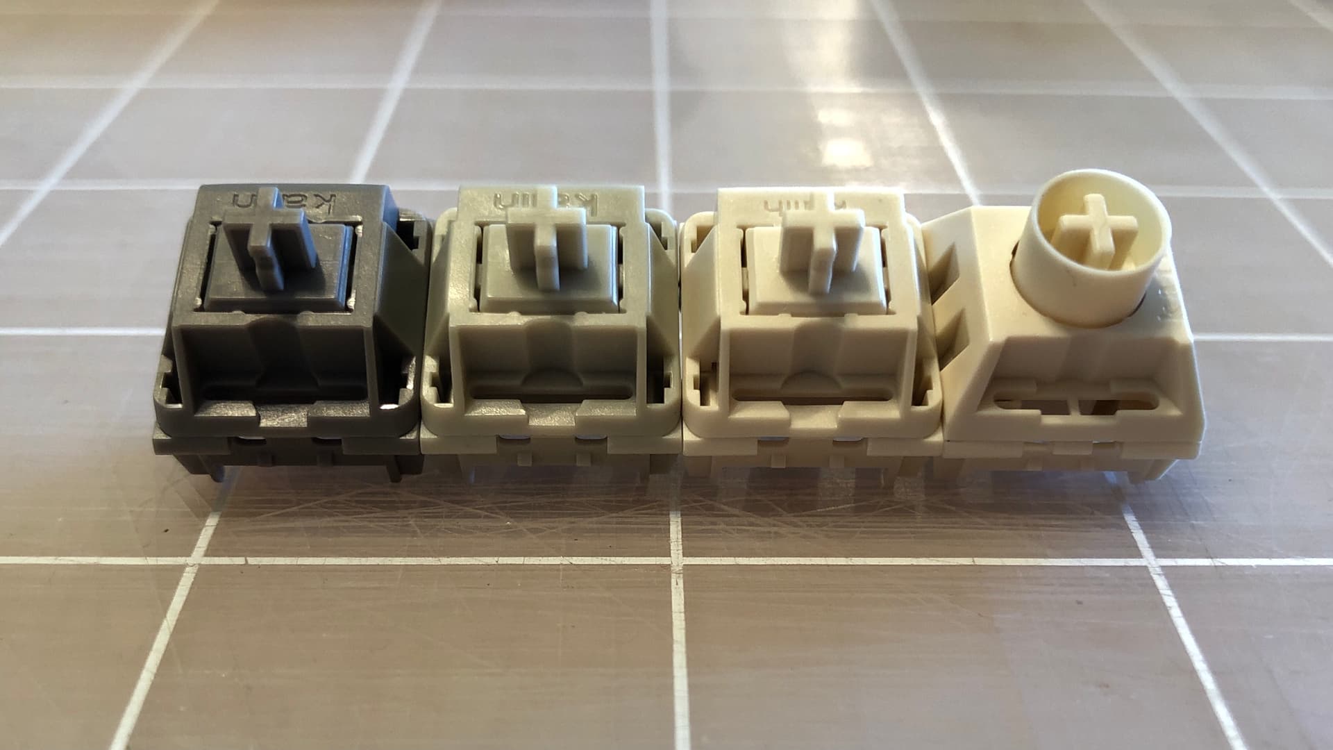

First is the BOX Cream. Three factors distinguish it from the standard cream, functionally speaking:
  • Lighter spring weight
  • Dust resistance
  • GMK/North-facing friendliness
In addition to that, however, there are other differences - a slight change in color being the least significant among them. One of the original Cream’s points of praise was its (at the time) unique bottom-out sound; a sound the BOX version does not have. On the other hand, I think the BOX version is better as a stock switch than the pre-retooled original Cream - it’s factory lubed (at least in some places), less scratchy in general, and there’s much less spring noise. I think someone could enjoy these right out of the bag, whereas I think OG Creams need tuning to be worth using.
I don’t have a whole lot to say about Cream Tactiles yet as I actually haven’t installed them in a board yet - but I can say they strike me as a good tactile if you like (or at least don’t mind) the textured feeling non-polycarb Kailh switches tend to have. They’re strong, but not quite so extra as the Blueberry. They also feature a broad-smooth crest to their tactile bump, as opposed to the flat plateu found on the Blueberry. (A somewhat similar plateau shape appears on Akko CS Jelly Blues, and with a not-too-different effect on the tactile experience.)

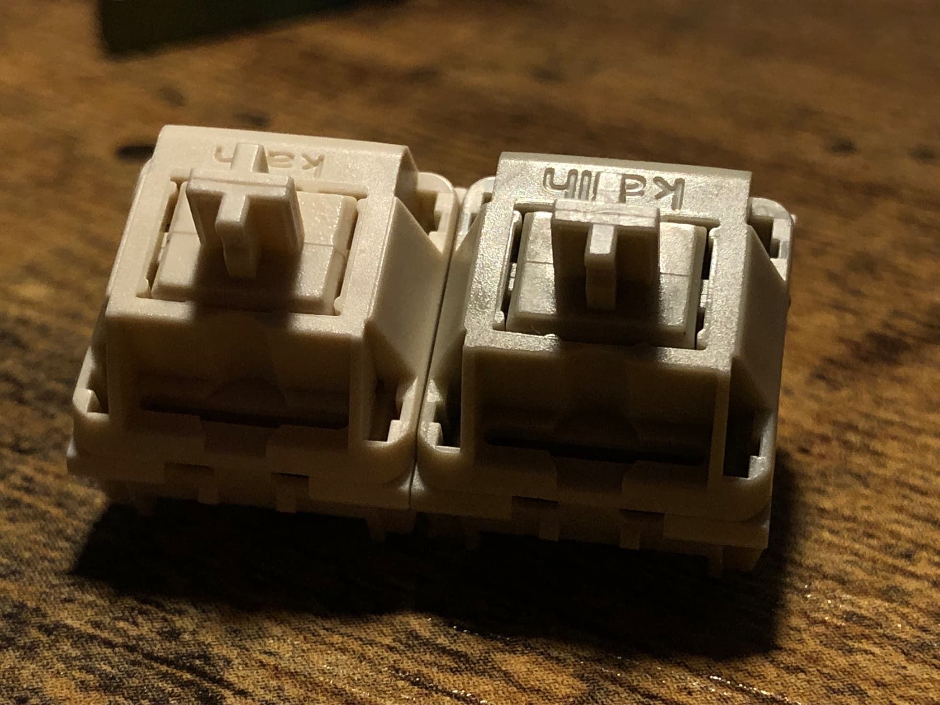

Indeed; easiest way to spot whether or not they are re-tooled is the Kailh logo. Re-tooled versions have a larger logo; in this photo, on the right, with a pre-retooled one on the left:
Compare where the “K” sits to the little rails that guide the stem.
