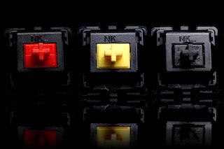

The Silk Series are linear switches manufactured by JWK and factory lubed with Krytox 205g0.
  • Red – Linear | Operating Force 35g | Bottom out 55g | PCB Mount
  • Yellow – Linear | Operating Force 45g | Bottom out 63.5g | PCB Mount
  • Black – Linear | Operating Force 55g | Bottom out 72g | PCB Mount
nk_switches-dry
The Dry Series are linear switches manufactured by JWK and are not factory lubed. These are best for people who want to open and lubricate switches without having to wipe off the factory lubricant.
