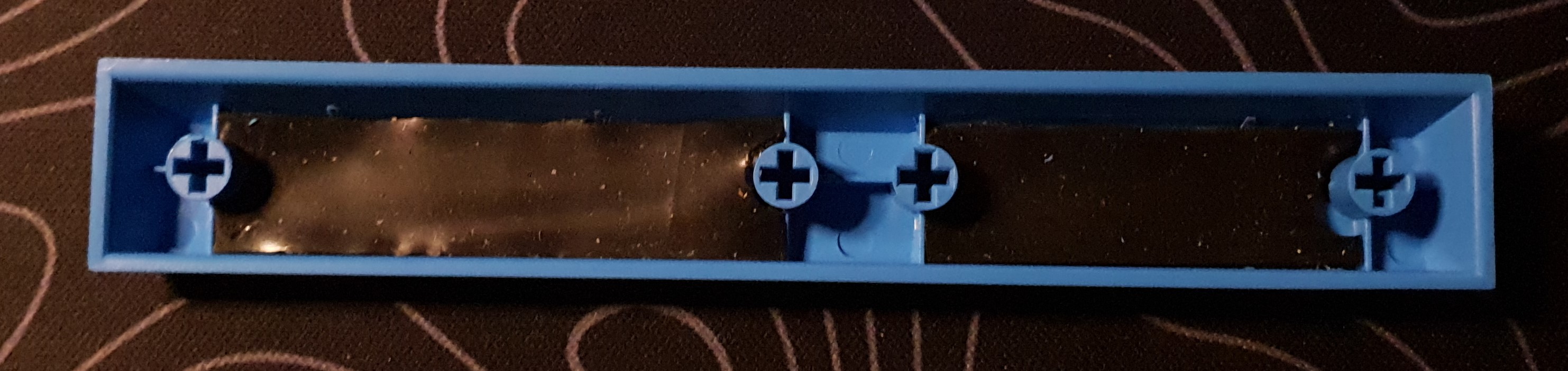

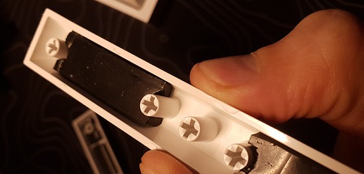

The very first attempt was using a crudely hand-cut insert fit under an SA spacebar as shown:
I’ve used a 40 duro 0.10" sorbothane sheet from Amazon [link], scissors and office staples to cut the insert out of the sheet.
Keyboard setup was as follows:
- Tofu 60%
- Holy Pandas
- ZealPC stabs
- Maxkey SA set
Upon the insert installation, the effect on the spacebar sound had been evident immediately.
My personal textual description of the effect is that it became cleaner from noises and lower-pitched, but not silent.
I did not make any “scientific” sound recordings to demonstrate the difference, but here is the non-scientific, asmr’ish version: https://youtu.be/HFiE4tGkHbg
Using similar inserts on other stabilized keys had no effect that I could notice in this setup.

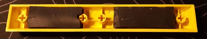

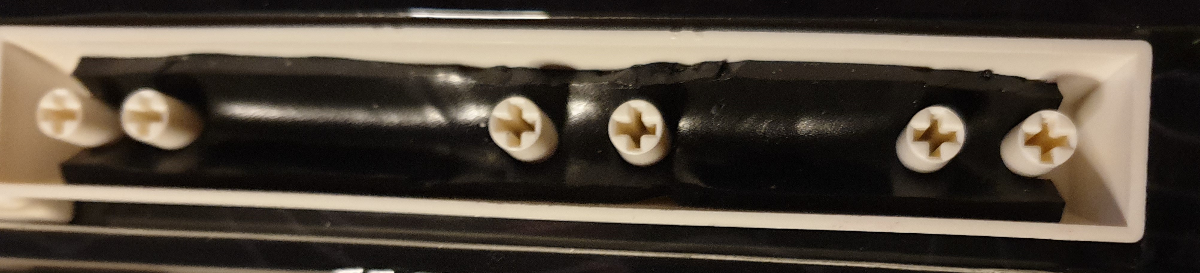

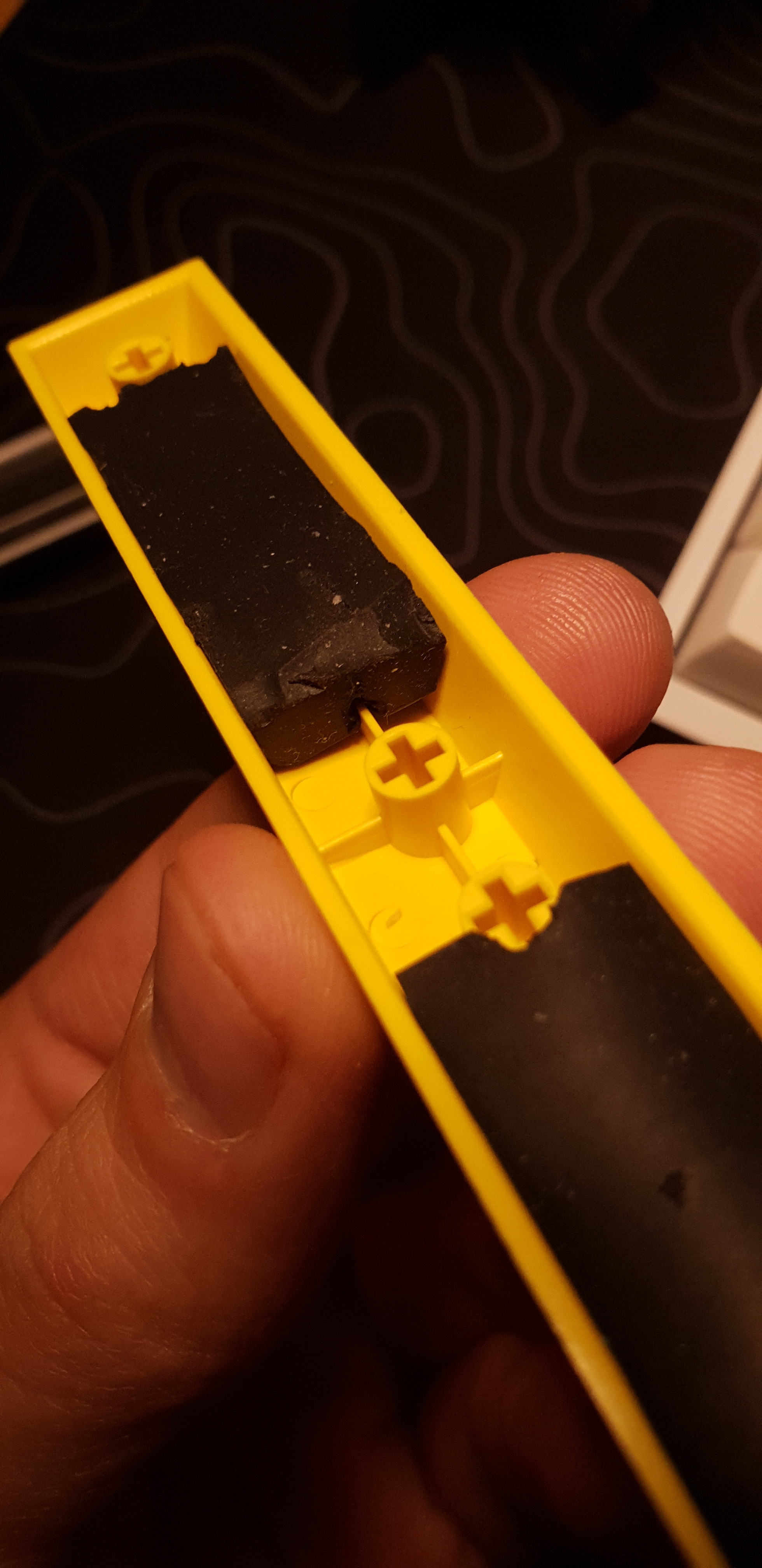

Before proceeding to my attempts with the GMK spacebars, here is one more SA variant that works:
Closeup:
Here I’ve used a 30 duro 0.25" sorbothane sheet from Amazon [link] inserts, cut with scissors and a wire cutter.
It is a cleaner cut and sits tighter, and has about the same or better acoustic effect than the first variant.

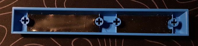

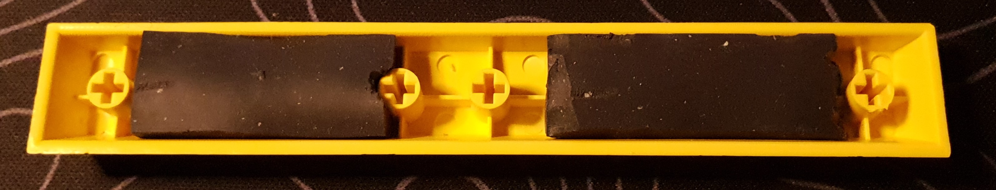

Here is the spacebar from the Leopold keyboard (OEM profile):
Here I’ve used a similar 40 duro 0.10" sheet, but this time with a PSA for adhesion to the spacebar.
The 0.10" is thin enough to put it in under switch and stab areas (*).
Cutting was done using small scissors, and it was very difficult to do accurately. You can see that I have cut one of the sides too short and the other one too long, which prevents perfect contact and compression.
The effect on the spacebar sound is evident, but to a lesser degree than on the SA spacebars.
(*not entirely true because of the plate mount stabs which protrude higher and press against the sorbo)

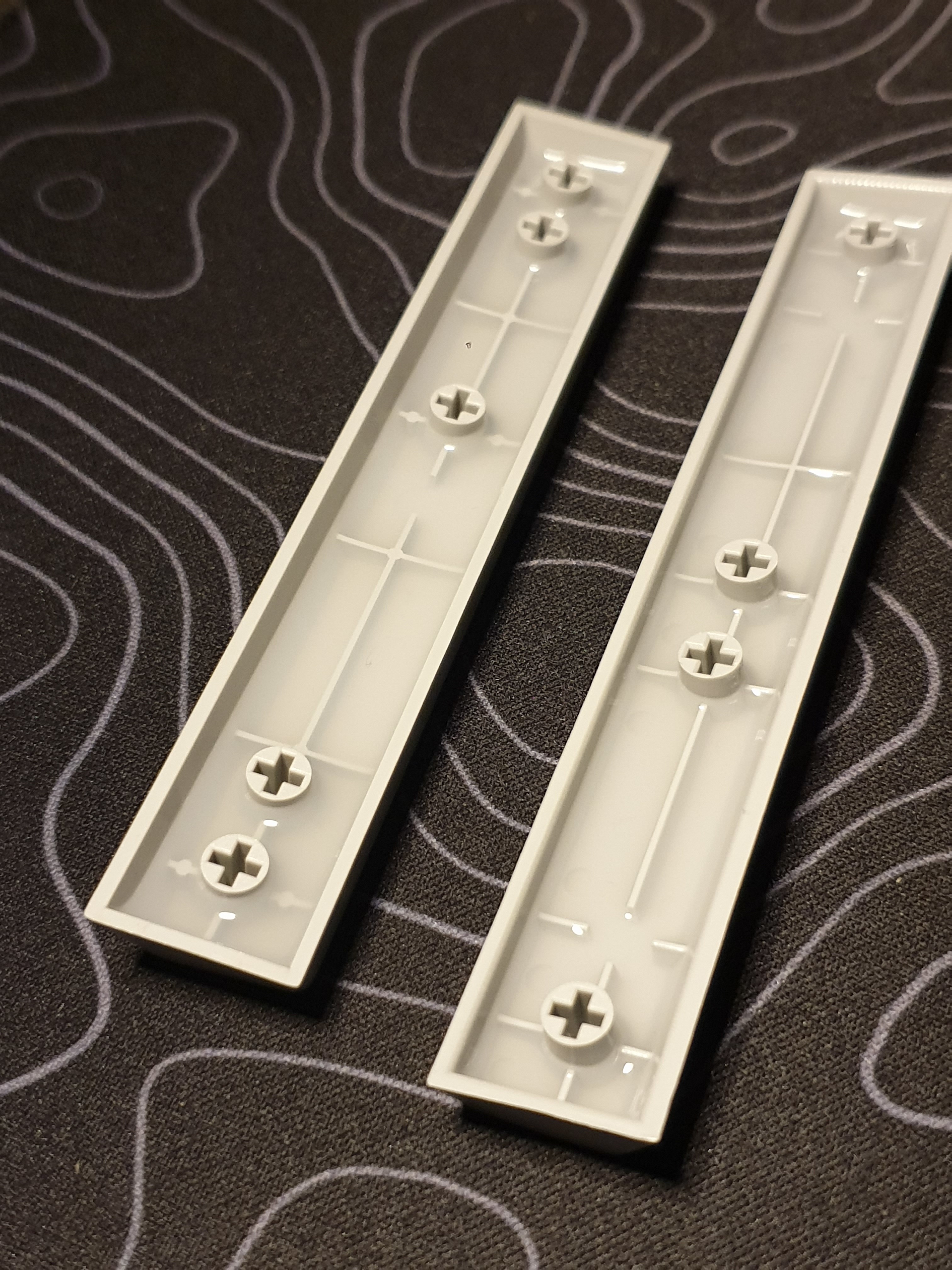

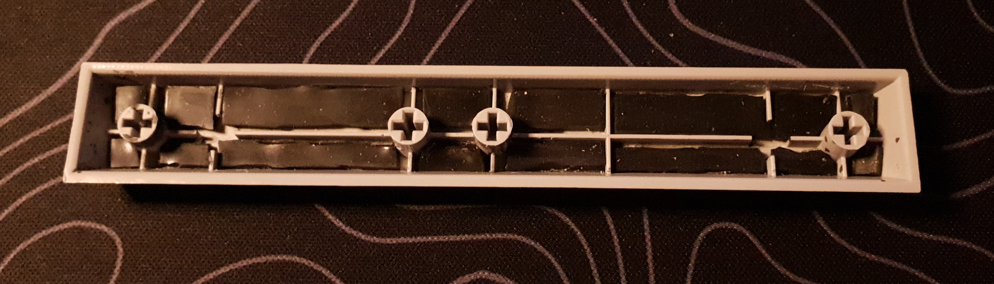

So far I’ve tested three different variants for 6.25u GMK spacebar sorbo inserts, here they are:
Using 0.10" sheet with PSA, I’ve cut small pieces to fit in between the ribs.
The effect on the sound is barely noticeable. My explanation for it is that each of the small pieces is too small on its own and that the degree of contact I was able to achieve is poor.

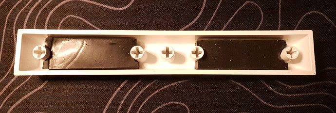

Using the same 0.10" with PSA, I’ve resected some of the offending ribs to be able to insert more sorbo, and in bigger pieces.
Suprisingly, there was no big improvement with this one. My explanation is that I have cut the sorbo too wide of a piece, and thus it separated in a few spots because there was too much of the compression.
Also I think that the amount of the material could be just not enough.

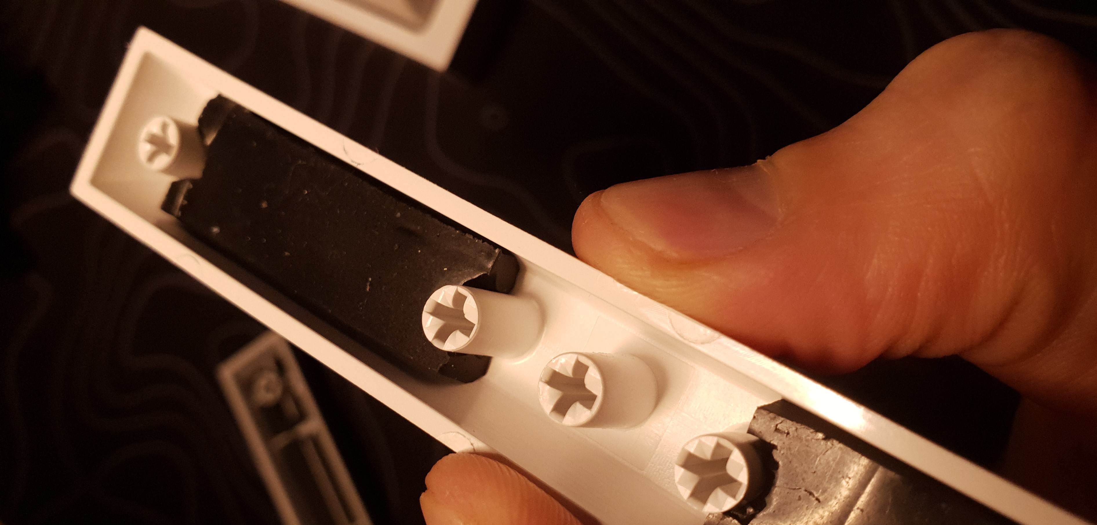

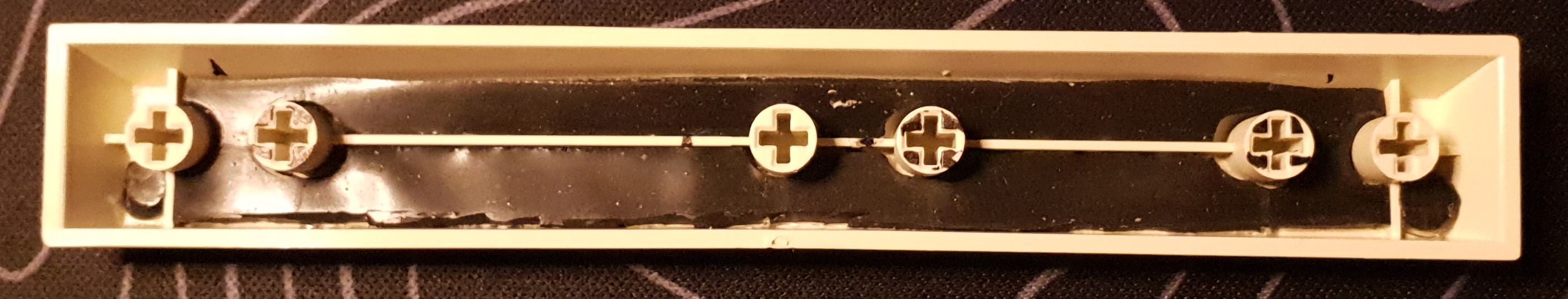

Using the thick 0.25" sheet, I’ve cut two pieces using scissors and a wire cutter. Then I’ve made the cutouts for the ribs using a small wire cutter and dremel with the disk tool (which was not fun).
Using dremel on sorbothane is apparently suboptimal becase the sorbo is too soft, but I could not find a better way to do these cuts.
It can be seen from the above photo that the sorbo-to-plastic contact is not good around the ribs. However, the contact on the sides is good, compressed evenly and there is more sorbothane overall.
This variant showed the strongest effect on the sound.

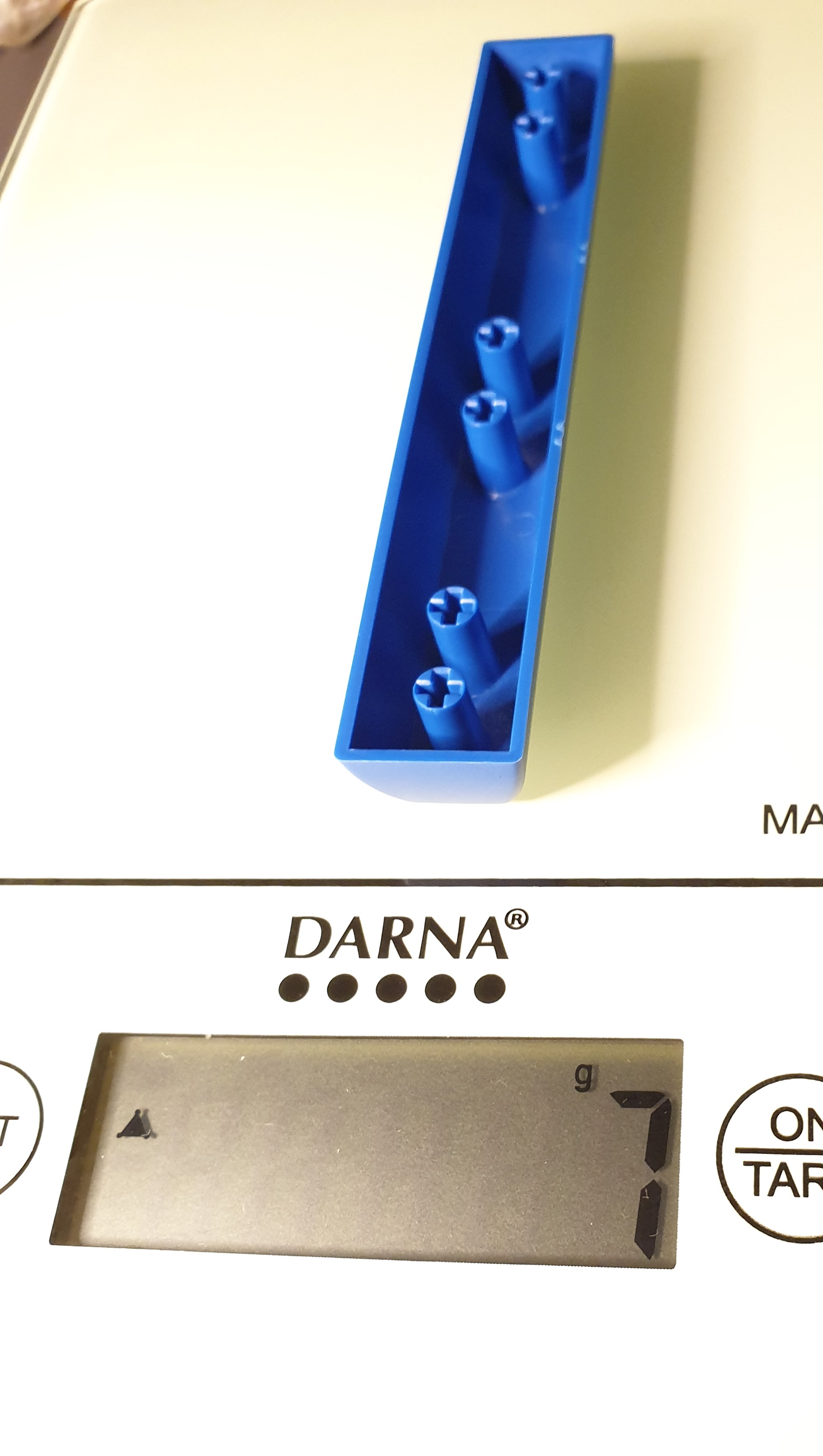

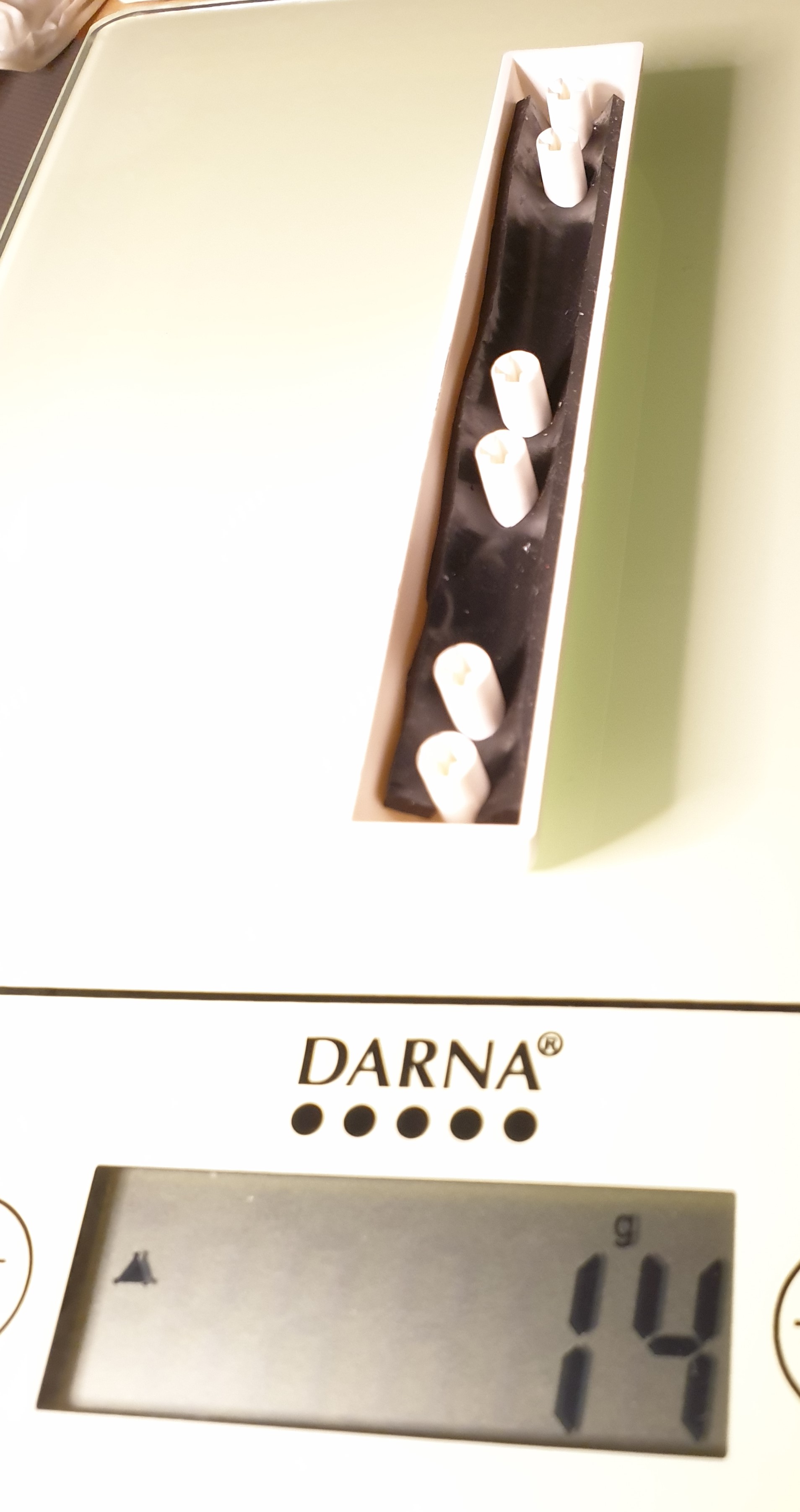

Sorbotane adds heft to the spacebar, so you might want to increase the spring weight by 5-10 gram:
