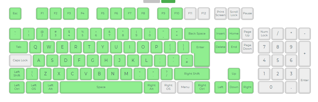

Found time to solder the tkl.
Flashed the QMK thing (work in progress), found a couple of errors (I did the right thing, and soldered without testing at any point. Like that’s what real men do)
Will need to add a led fort caps lock, later.
Back to soldering iron !
Getting better
Got electrics working, probably the qmk thingy a bit wrong regarding caps lock.
Fixed caps, changed scroll lock and pause for page up and down, added a caps lock led and done.
It will require a bit of butchering on a mini usb cable (ordered one, lost it, ordered a new one) but it’s done for the most part. Needs to fit the back cover and rubber pads, bit i’ll need the usb cable first.
