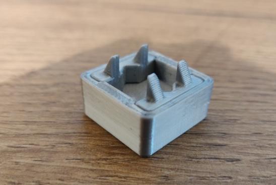

I’ll get a switch opener and krytox gpl (turbo zsmax RR special edition) in the same shop hopefully.
(I’ll print a switch opener instead)
[edit : this one works quite well : Cherry MX Switch Opener by Avatar7 - Thingiverse
(not my picture) ]

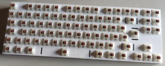

I currently am building a sort of tkl at the time being :
(brown switches from aliexpress just to see what it feels like, 3D printed case, handwired, and finned underside like a racing car, loosely based on keebcu - andimoto smallTKL iso - mechanical keyboard by andimoto - Thingiverse )
(funnily enough, it’s much more painful and fun to push in the swicthes when you’re half expectig the thing to crack and shatter)
So I’m not entirely closed to the tkl idea. I may even do one smaller without the function rows with the gateron clears that will be salvaged from the gmmk, but these won’t be my daily drivers.

I just put keycaps on my 3dprinted plate mounted tkl-ish.
Made with the cheapest stuff available, so aliexpress sourced “gateron browns” and same provenance ymdk keycaps. Wether it’s genuine or not i don’t really care, the noise is very satisfying, the action has quite a bit of friction and the “costar” (aliexpress purchase too) stab (only put one under the space bar) defines new level in rattling.
But quite happy. I’ll have to wire the thing, I save it for a rainy day.
A bit of 205g0 on the parts of the stabilizer wire that touch plastic should help with rattle. Might be good to check if the wire is bent, though I don’t know if thats as much of a problem on costar stabs as it is on cherry style.
Should do the trick. I have only one stab under the space bar, maybe I’ll put another one under the left shift, I’ll probably try to make the best assembly out of the bag of stabs I have. Metal vire doesn’t seem to be bent, but I’ll check with a better eye later, I just slapped the keys to hear what it sounded / felt like.
The pla I used is quite stiff (pla is kind of stiff), plus the extensive ribbing within the case made it quite a sturdy assembly, even without the screwed underside plate. That’s something you can do with additive manufacturing, putting fins and ribs all over the place, but still making holes and passages for the handwiring, that would not be doable thanks to machining.
Wiring it wil still be fun, every switch is kind of jailed in a cubicle, tweezers will be put into action. Quite happy with the feel though, even if it’s a keyboard that will spend most of its life gathering dust on a server…
