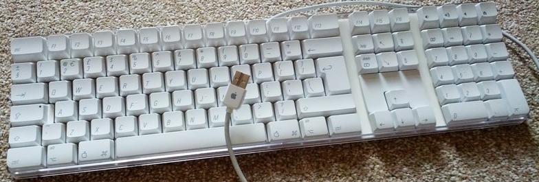

Some months ago, my A1048 (apple) keyboard let me down. Used it for more than 10 years, fine.
What can I get that is as compact as the late white keyboard ?
