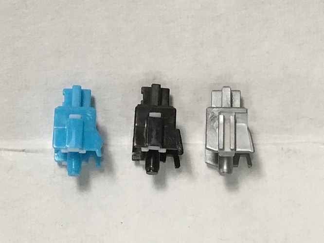

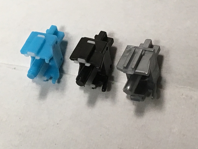

Stems;
Zilent | Gat Silent Black | Outemu Silent Sky Linear (v2-ish):
Notice how different the [Outemu] stem is. The dampening material is completely distinct, as is the shape of the lower “foot” area that impacts the bottom housing. The dampener is much softer, and can also be easily removed / replaced if need be.
It’s a more simple design, but it works. Note also the taper at the back of that stem - this presumably prevents the occasional “tick” sound that happens when the bottom-back-side of the stem sometimes hits the housing in other silent switches on hard or off-center key-presses.
One other detail - notice the dampeners on the [Outemu] stems extend out more both at the top and bottom of the slider - I presume this has an effect on the feel, but it also eliminates an issue I’ve noticed with many other silent switches…

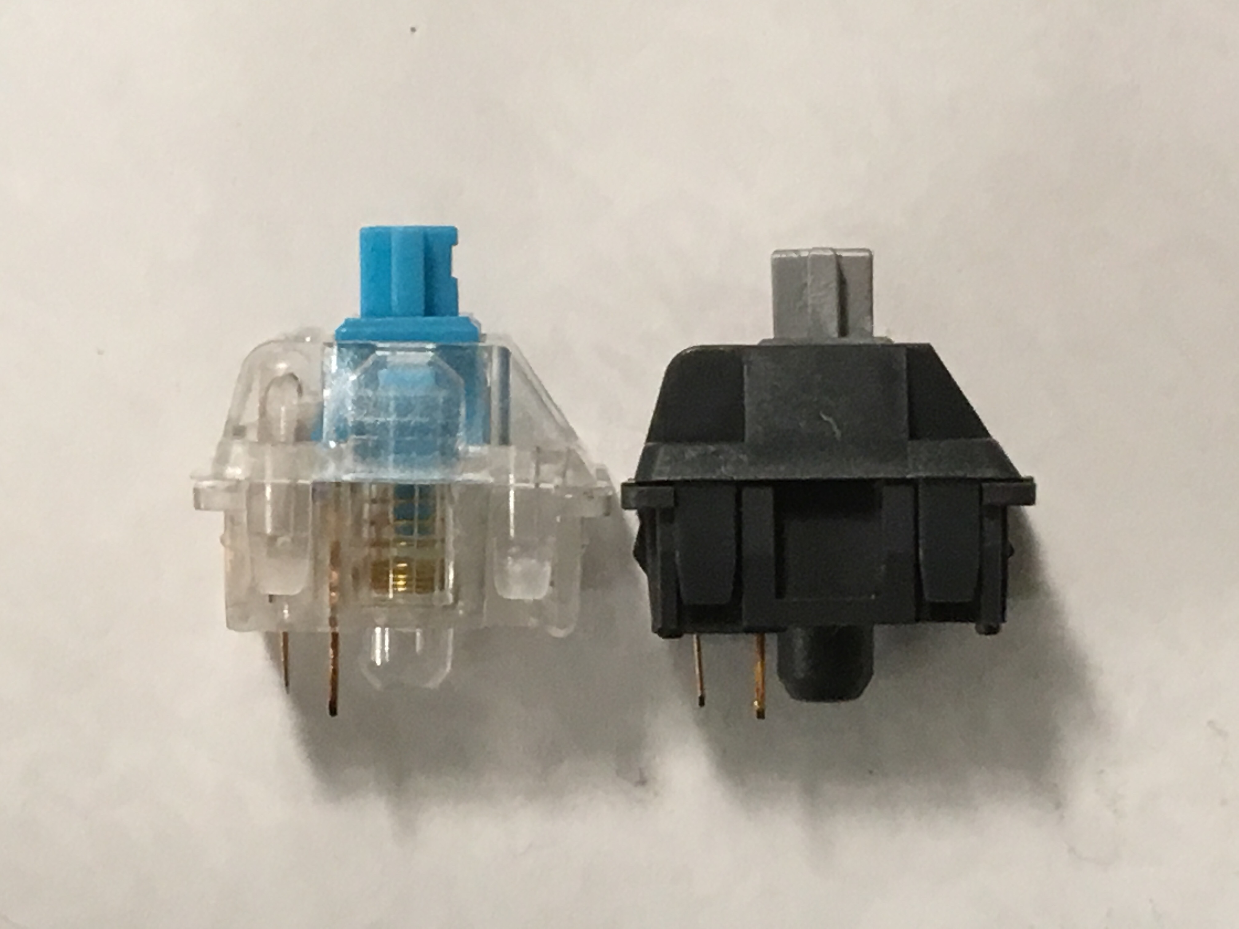

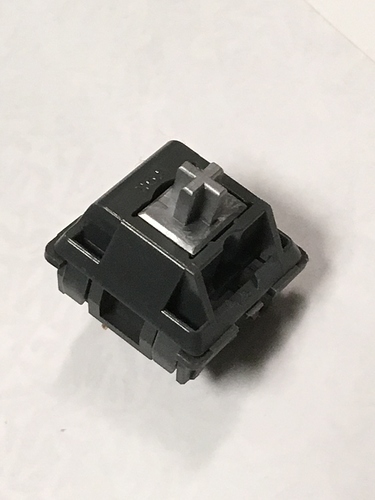

Resting Position:
See above a Zeal PC Zilent next to a “Silent Silver Sky Panda” - notice how much higher the Zilent stem sits, while the slider of the [Outemu] stem is flush with the housing.

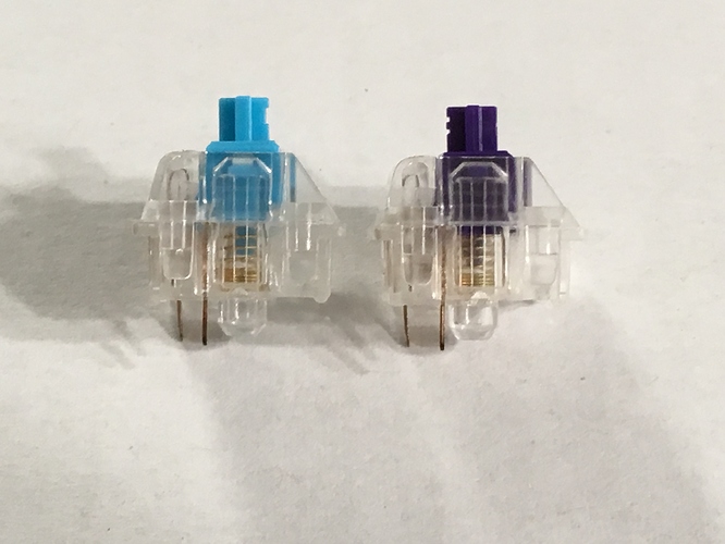

A Zilent and Zealio (both V2) for comparison:
The Zealio is essentially “normal” - that is, most MX style switches I’ve seen have the slider juuust peeking above the housing as it is in this photo. Compare that to the [Outemu] above which is almost totally flush, and the Zilent next to it which sits much higher.
Aliaz and other Gateron-manufactured silent switches all appear to do this, and on the more tactile ones, this actually creates what I perceive as a fairly annoying amount of pre-travel before the “actual” (or maybe intended) feeling of the switch kicks-in. While I’m not the biggest fan of the tactile [Outemu] stems, they do not suffer from this issue at all due to their longer dampeners up top.
