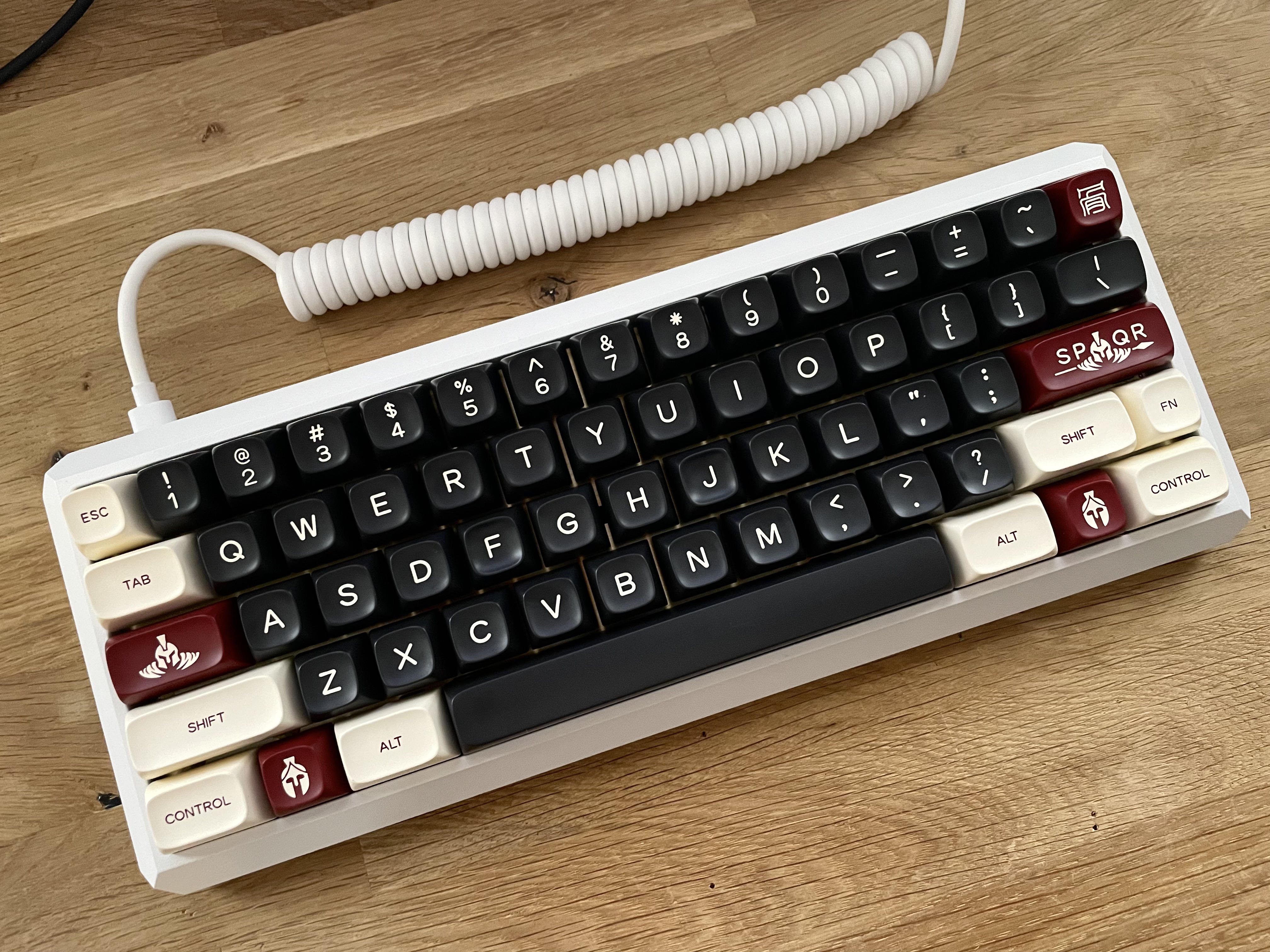

First Impressions:
  • They look and sound amazing
  • Similar sound to MT3 (Maybe even thockier)
  • Deep dish encourages accurate typing and is very comfortable
  • Homing scoops are deeper but don’t differentiate the keys enough since all keys have a decent scoop
  • Should have noticed this when buying, but there is no 1.5 Backspace for HHKB
  • 7u spacebar is quite loud and needs tuning (it is straight as you would expect from ABS, but it is even louder than an SA spacebar) and maybe spacebar foam

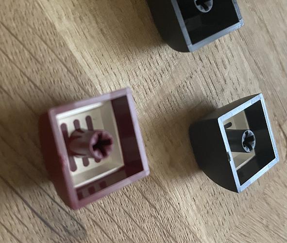

Also, I am trying these on switches that I never used before - Anubis Tactiles - and some of the stems seem a little loose. Not bad, they aren’t falling off, but noticeable when slipping the keys on the switches.
Not sure if this is a property of the keycaps or the switch stems since I’ve never used Anubis switches before.

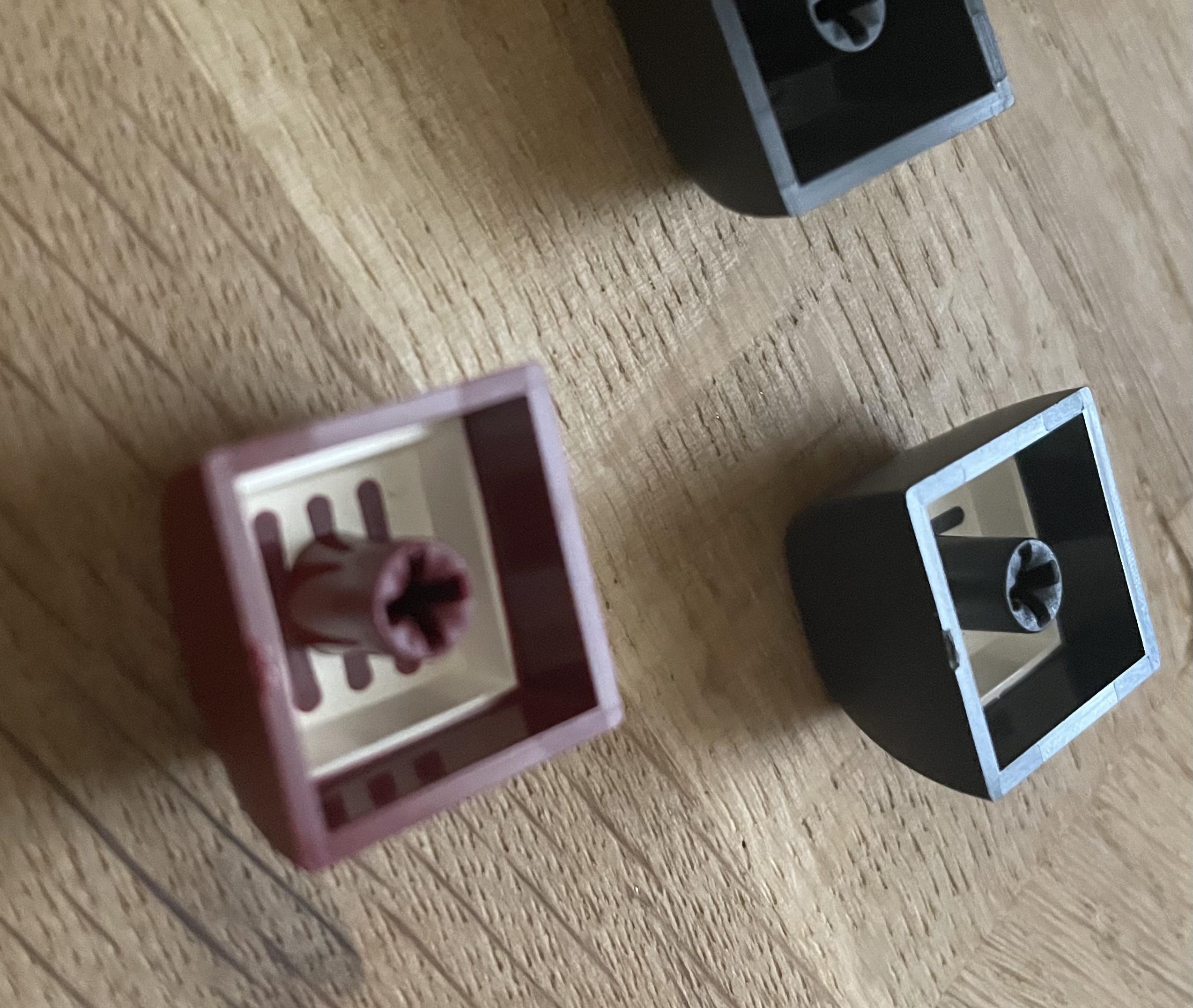

They are only about 1-1.2mm thick BUT the double shot inside each key is quite thick and extends 1/3 way down each cap, adding to the overall thickness and weight of the set. This is why space is so loud. Without the extra thickness from double shotting it’s quite hollow.

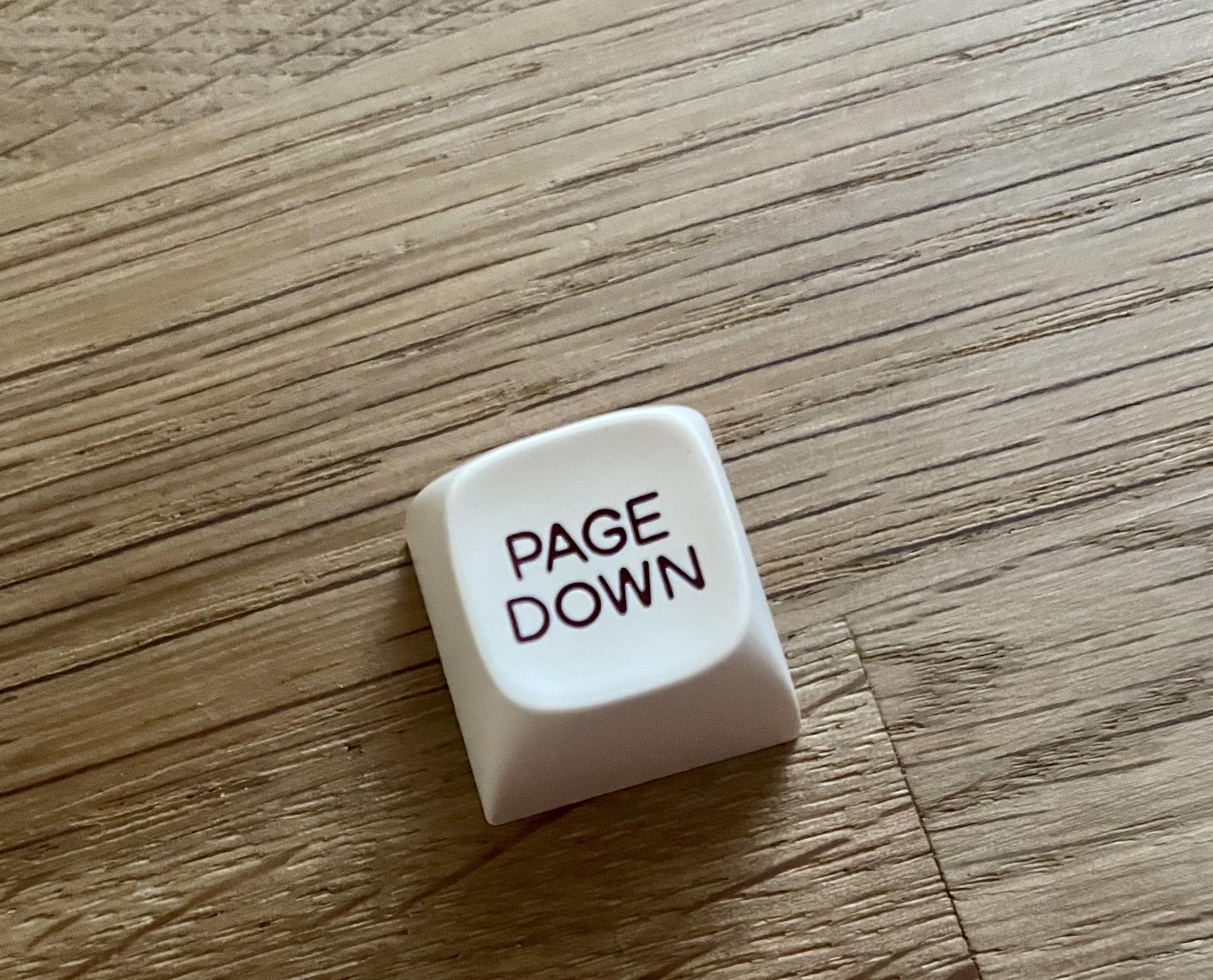

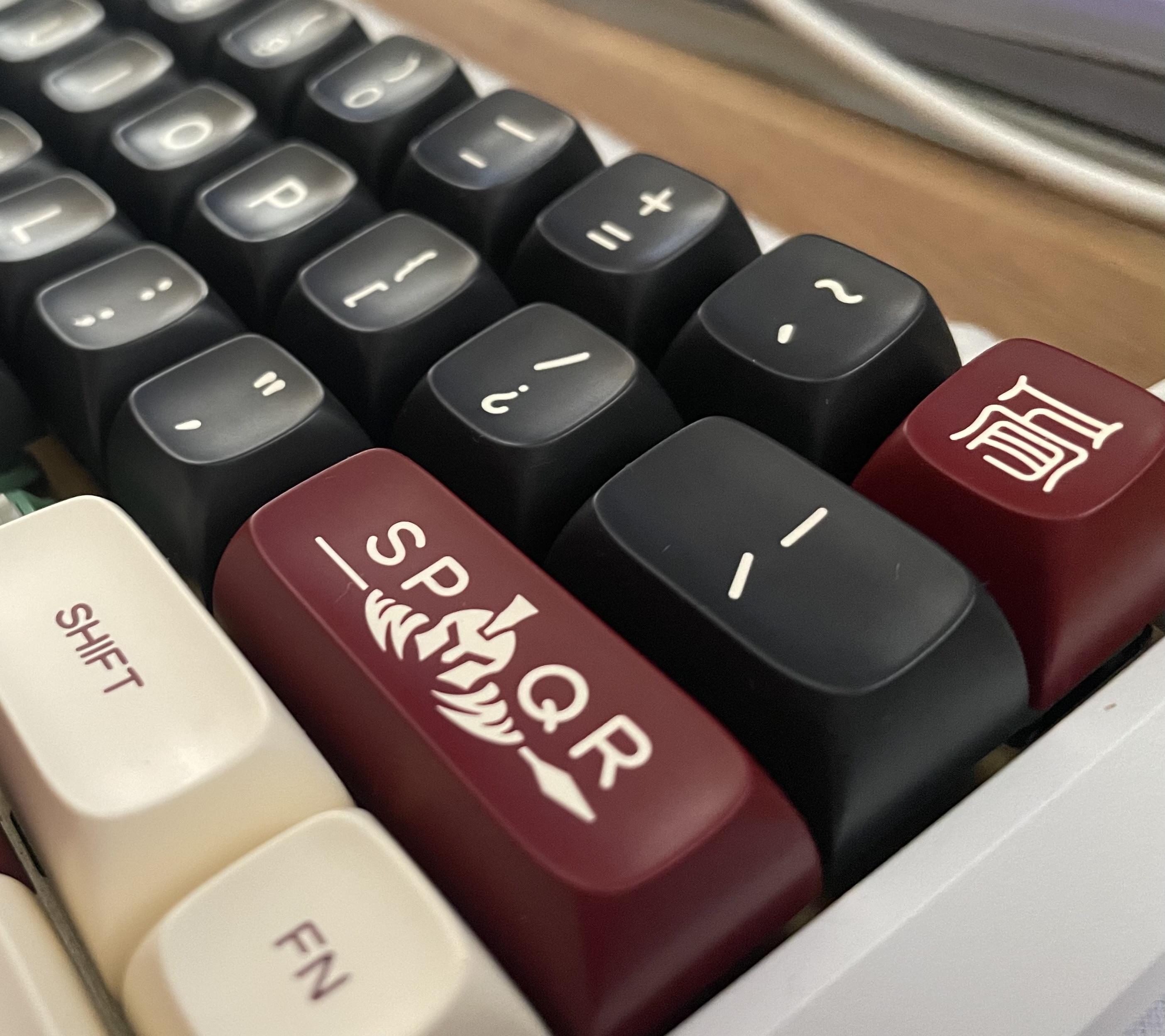

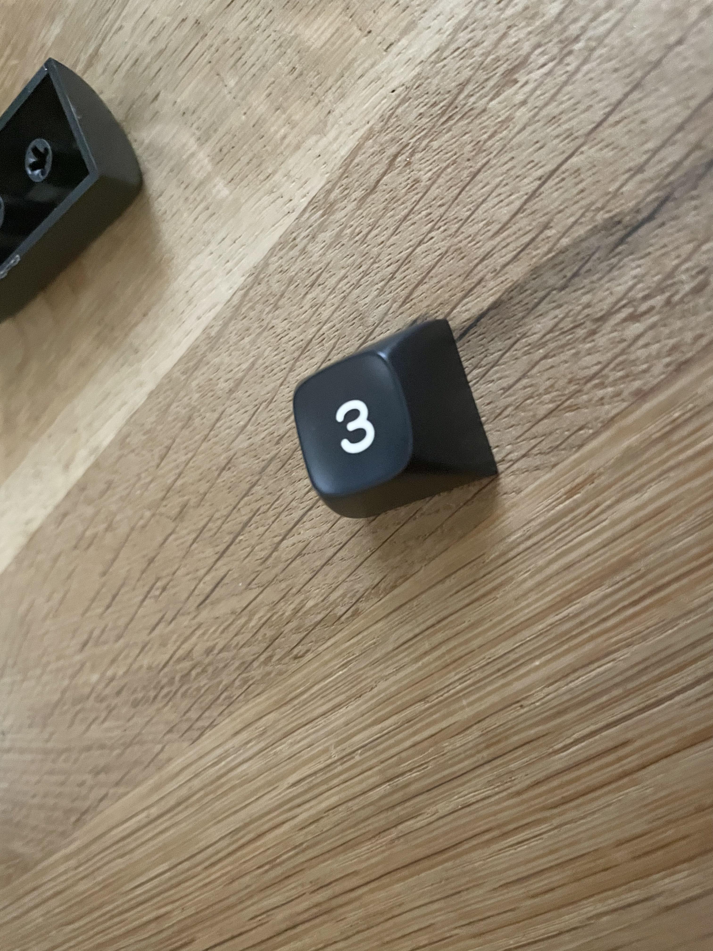

Here are some close ups. The legends are super sharp.
How’s the scoop size? My biggest complaint about MT3 is the scoops feel too small (in area, not depth). HiPro seems about perfect, and SA is pretty good in this regard too.

The scoops feel pretty big. I had a TEX ADA set with small scoops and I couldn’t stand them. These feel nothing like that.

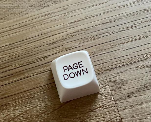

How’s the flipability? Thinking of how an upside down SA r4 can serve as an r2, same with MT3 r3 & r2.
They are hard to photograph without a macro lends (iPhone13 Pro can’t ship fast enough), but initial observation is that YES they are flippable.
I think there may be a slight difference, but could be an optical illusion.
They feel fine to type on when flipped, no discernible difference.
