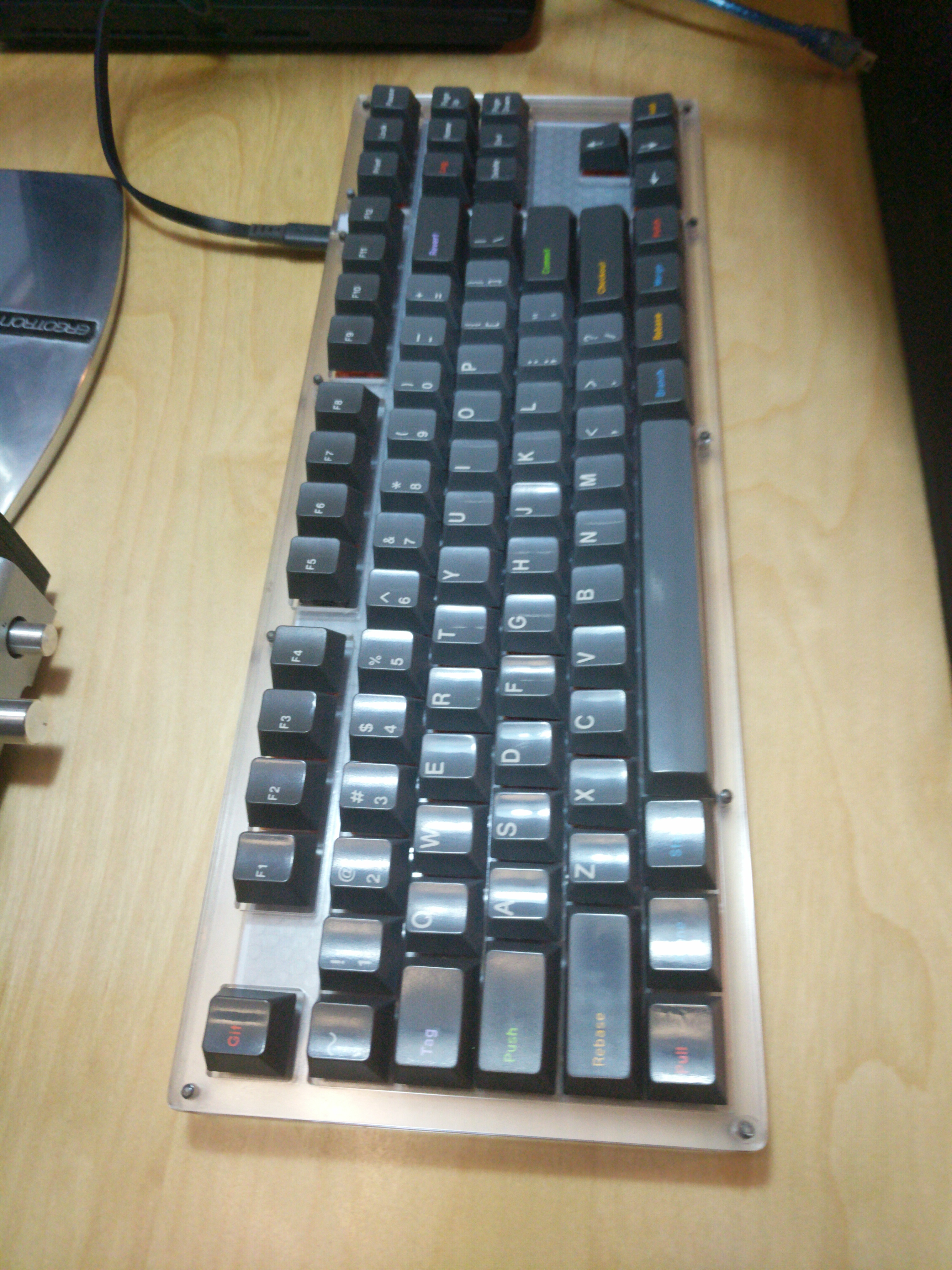

This is the only place I’ve seen anyone polish a keycap. I have some that are starting to shine, so I was thinking of giving it a try.
https://www.massdrop.com/buy/pulse-sa-keycap-set/talk/2250872
Worth it to note also that the other way around is possible (i.e. Sandblasting shiny caps to restore its matte texture). Wodan of deskthority fame has written some documentation on this.

The other approach would be to lightly sandblast, removing all uneven shine. Same idea, opposite solution. Soda blasting seems like a fairly easy DIY and might take even less time than polishing.

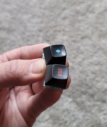

First cap polished after trying a few different techniques. I ended up needing to use the dremel with a cloth wheel and running at only a 2 on the rpm speed adjustment. What do you all think?
Edit: diamond polished and RSE not touched yet.
