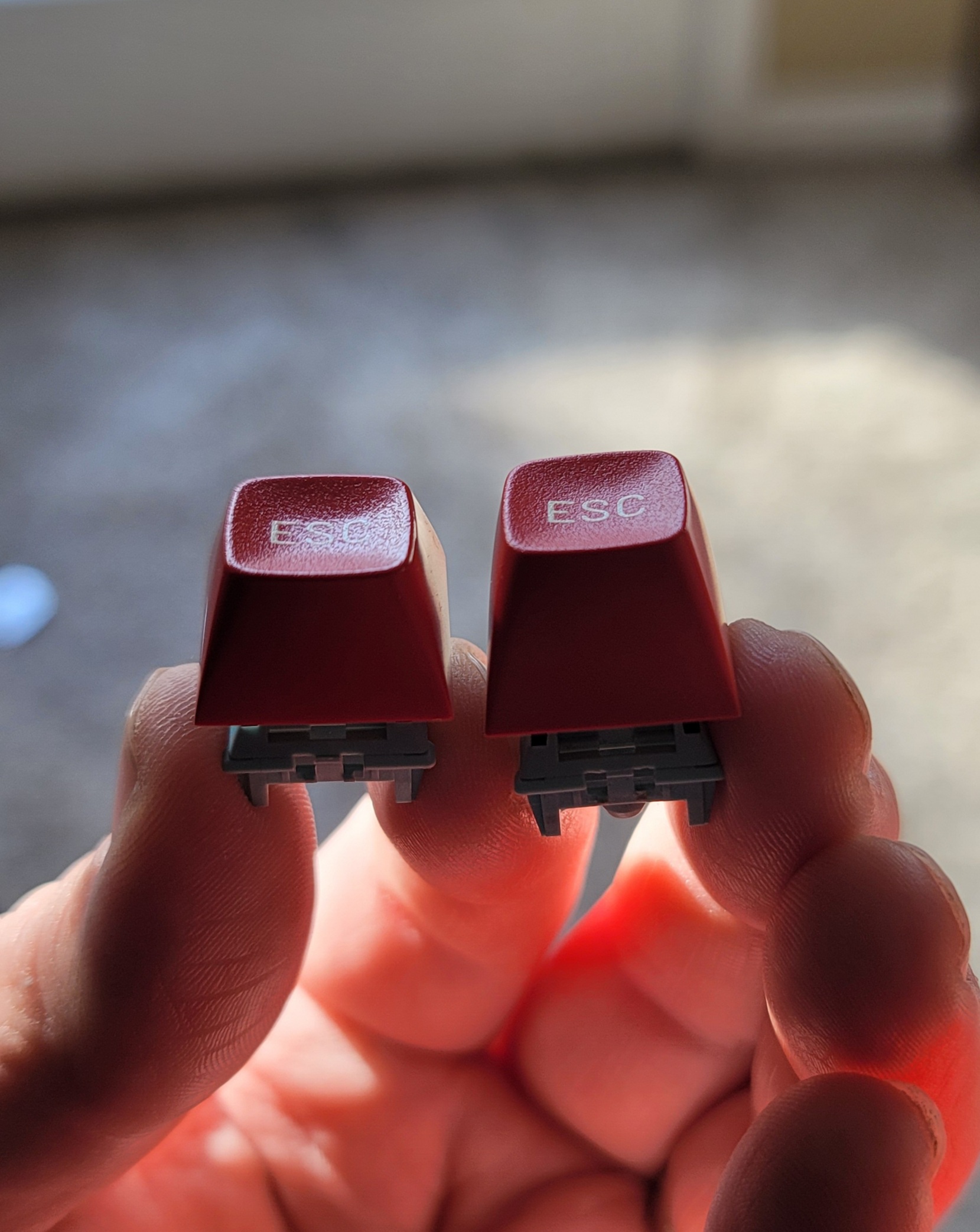

Here’s another… It’s kind of hard to capture the shine. Left is polished.

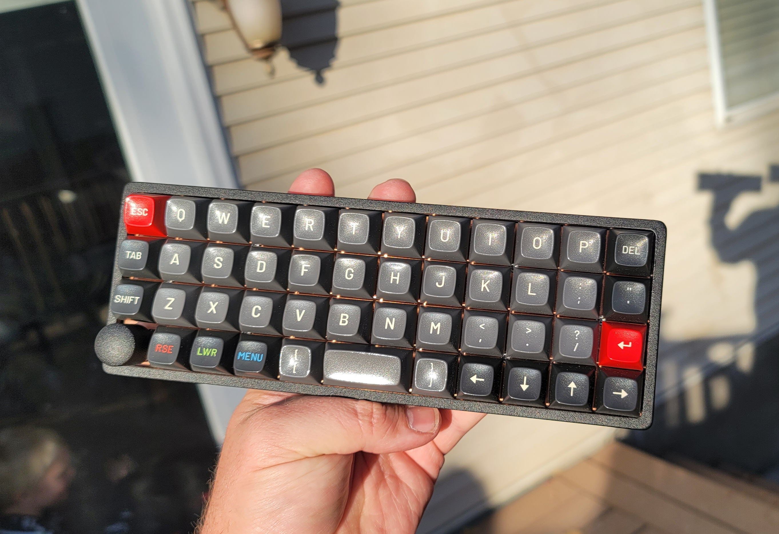

Edit : Bottom row done
Compliments that powder-coated case really well.
Very nice! Polished red all the way.

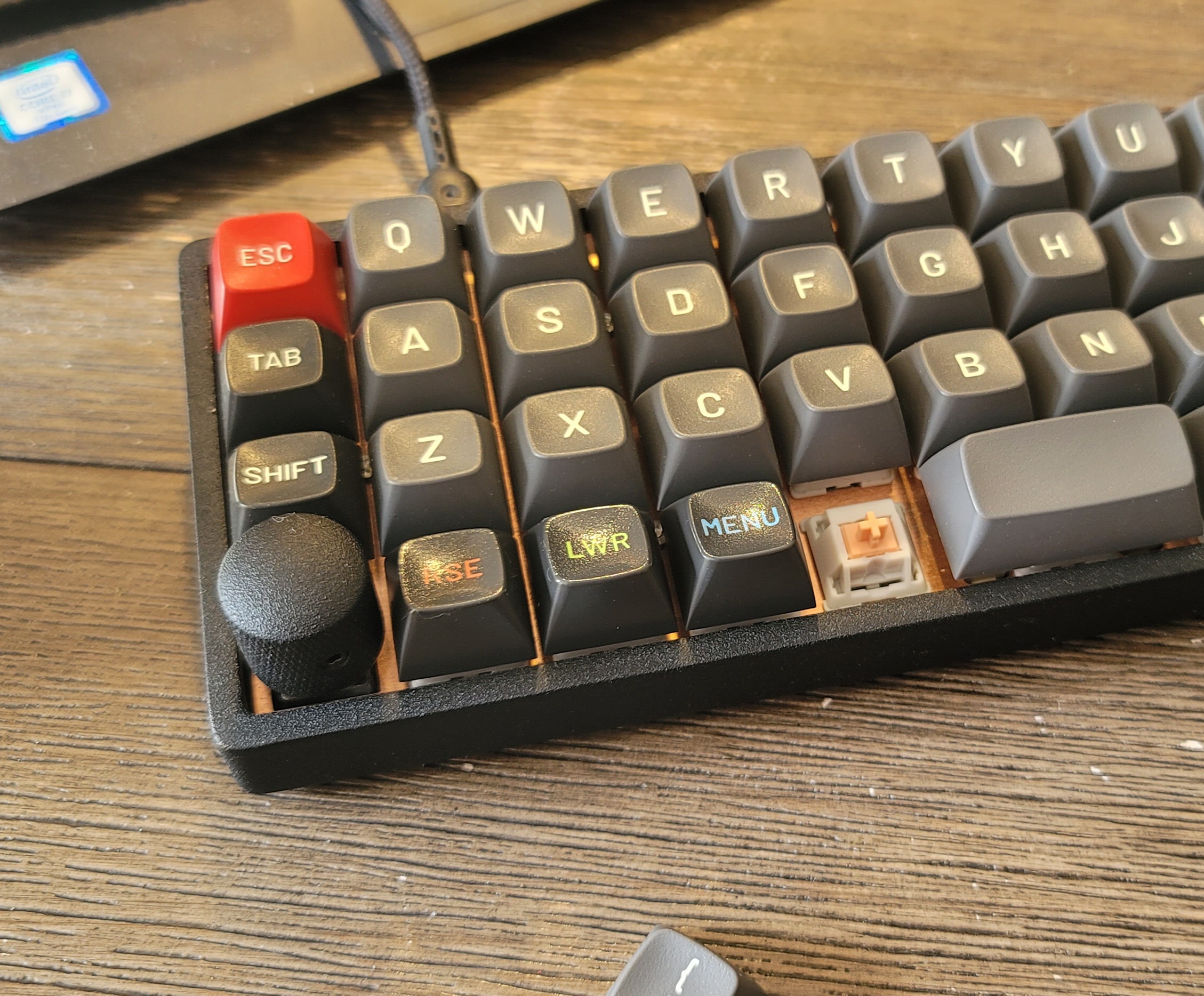

So after getting a row done, I’ve gotten down a pretty good method:
I polish the face in all four directions, turning the keycap after polishing the face three times.
I do this four times, adding a little polish to the face in between each.
I finish the cap off by hand polishing in a thick microfiber cloth on all sides.
Pretty happy with the results so far, just wish it didn’t take so long :laughing:
Hopefully this comes through OK. Polishing finished. Looks much better and feels way more smooth.

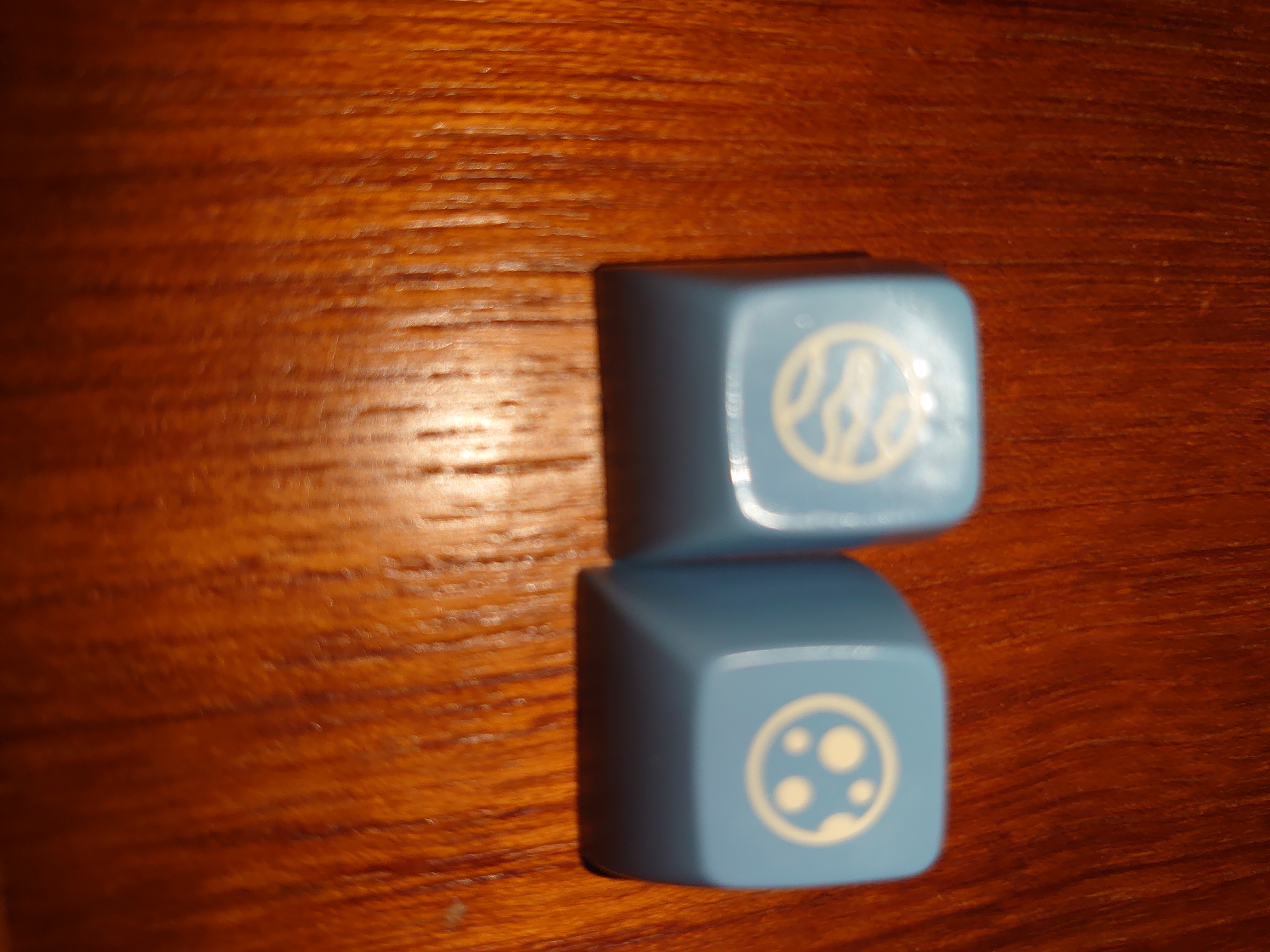

Someone on reddit shined his SA keyset using acetone vapors.
He placed the acetone in a glass, and the glass in a plate with hot water, then he hovered the keycaps through the acetone vapors.
Here is his full album
And his reddit thread
Well that looks easy. :thinking:
I gave it a try and I guess I had it to long in the vapor cuz I got some bubble. :grimacing:
