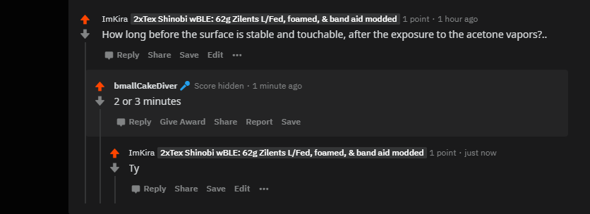

I wonder how long before the surface is stable and touchable, after the exposure to the acetone vapors?..
I want to say 5sek, definitely below 30sek.
Hmm, guess it’s best to go for that.

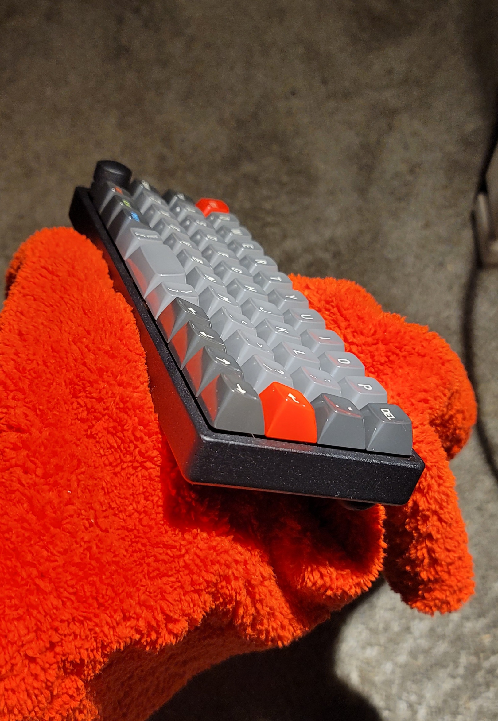

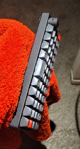

Internet has been down most of today so I decided to utilize the time to polish all the sides and the top a second time on the Susuwatari. Took me about 4 hours but I think it was well worth it. Here are a couple pics I captured tonight. I’ll try and get better ones when it’s not dark out.

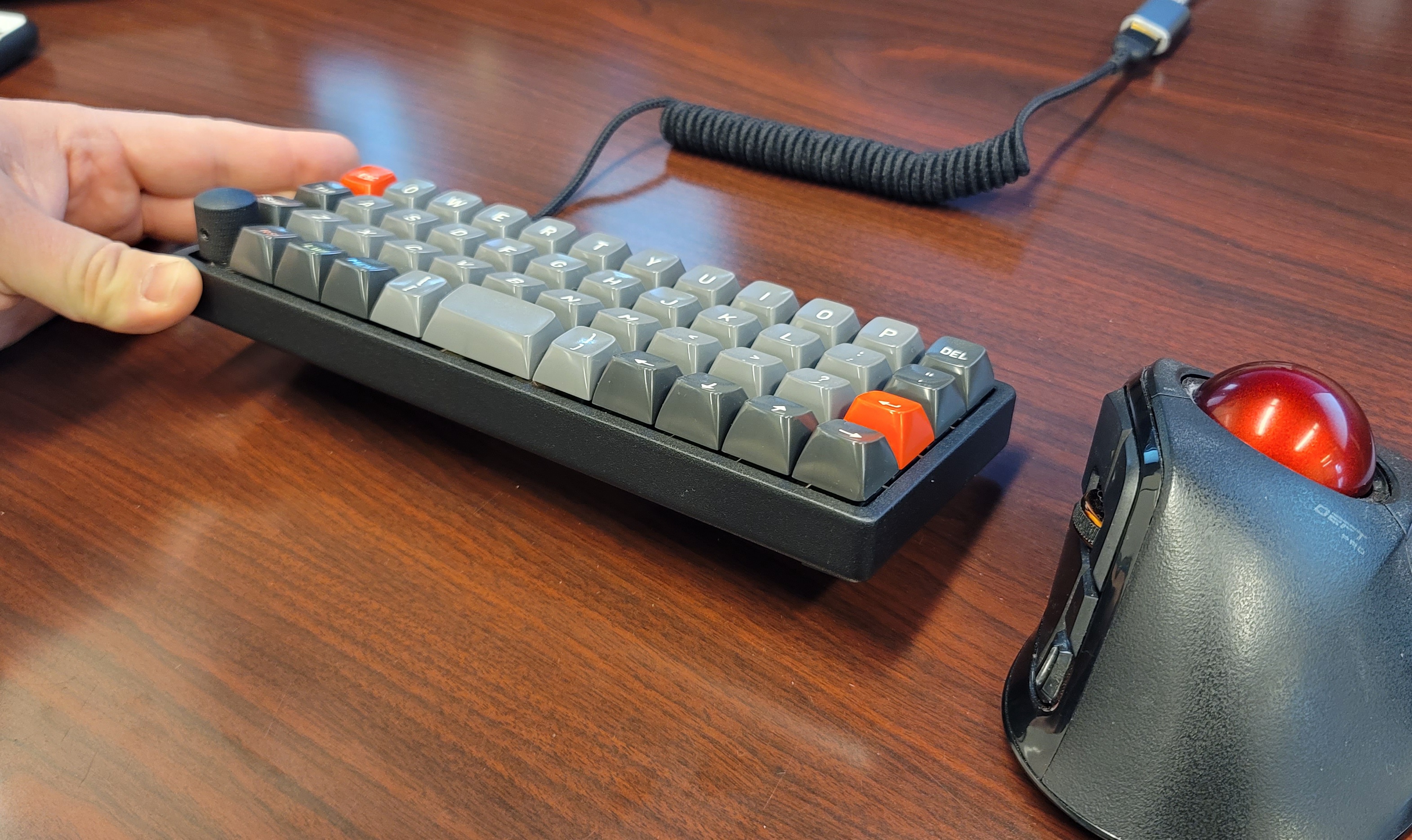

Here’s one at the office. Best I could do with how dark, cloudy, and snowy it is outside lol
wow that came out great! any tips for getting a consistant level of shine? or not getting bubbles?
What I did is I used a dremel with a polishing wheel at speed 2 and I hit each side 4 times. After the dremel, I wiped them down thoroughly with a microfiber polishing cloth. I also used Mcguires Plastic Polish that seemed to work pretty well.
