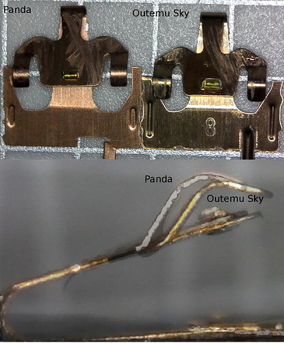

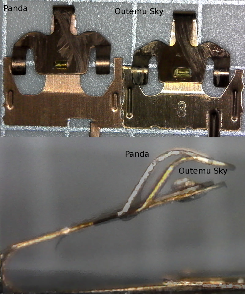

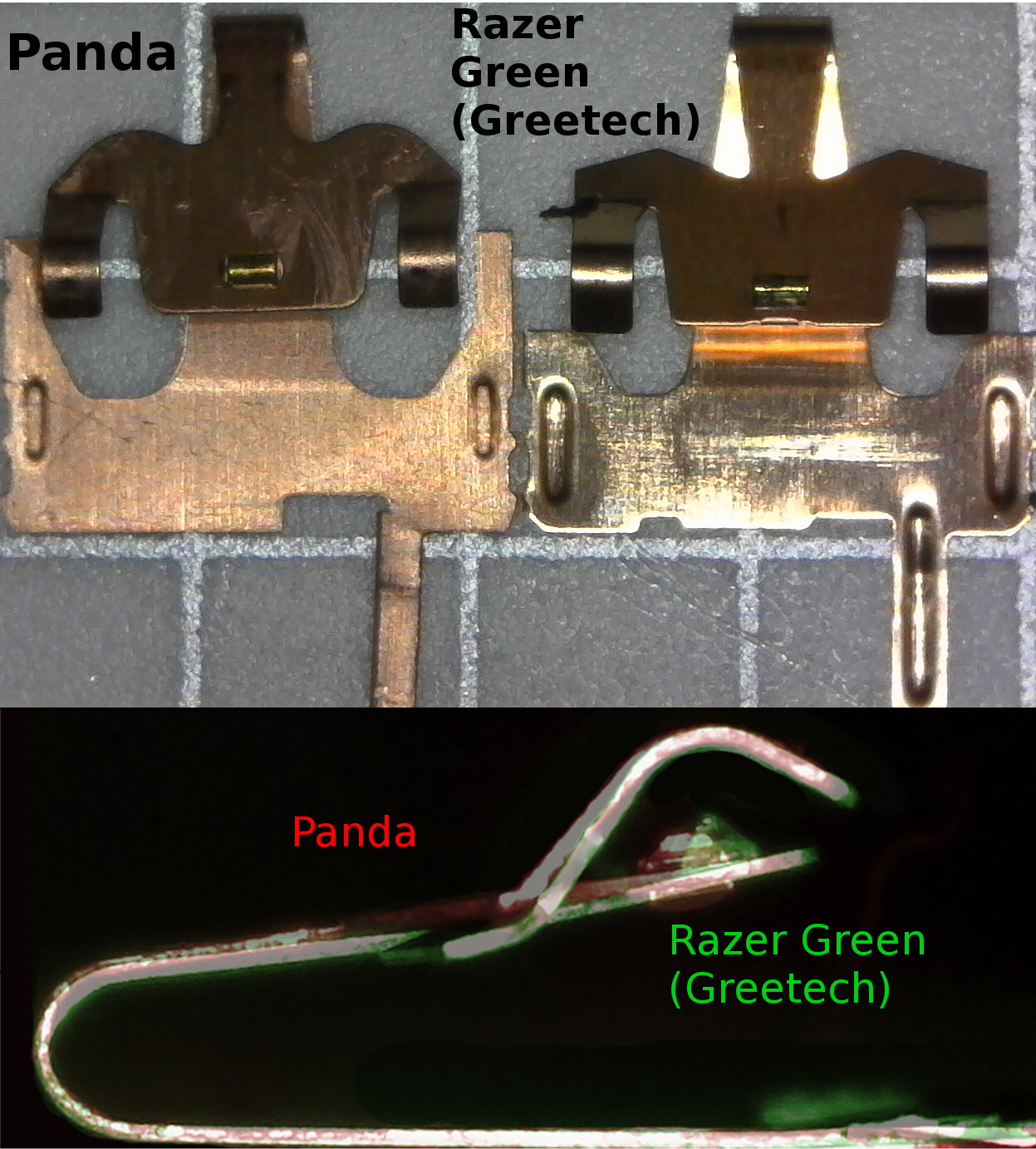

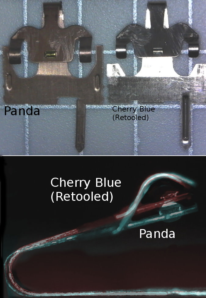

Here are leaf comparisons for 3 housings I have found create tactility that is similar to pandas:

On the other hand, I can totally see the Razer (Greetech) leaves being a good bit stiffer than most as I have a few Greetech Greens & they are easily the most clicky stock (i.e. sans any stotle variants) click jacket style MX clicky switch I have tried. Think I’m gonna do some messing around myself once I actually getting moving today to check out some more possibilities with Halo stems. Anyways great post & thanks for the contributions @Walkerstop!

AFAIK it’s the actuation leaves that make Pandas special. I could be wrong about this (I don’t got no Pandas either ), but I think the metal used for them is a little bit thicker & the contact legs on them jut out a little bit further than most other MX switches. Which causes them to apply more pressure against the slider & increase the tactility of tactile stems. Combine that with the design of the Halo sliders & it does make for a very unique feeling tactile switch IME.

I’m also very interesting in getting a alternative with a clear housing as well. I hear the new Outemu Ice Switches are a valid option as well based on the design on their leaves. However there seems to be some confusion on exactly what switch is what based on the specifications provided my the manufacturer.
