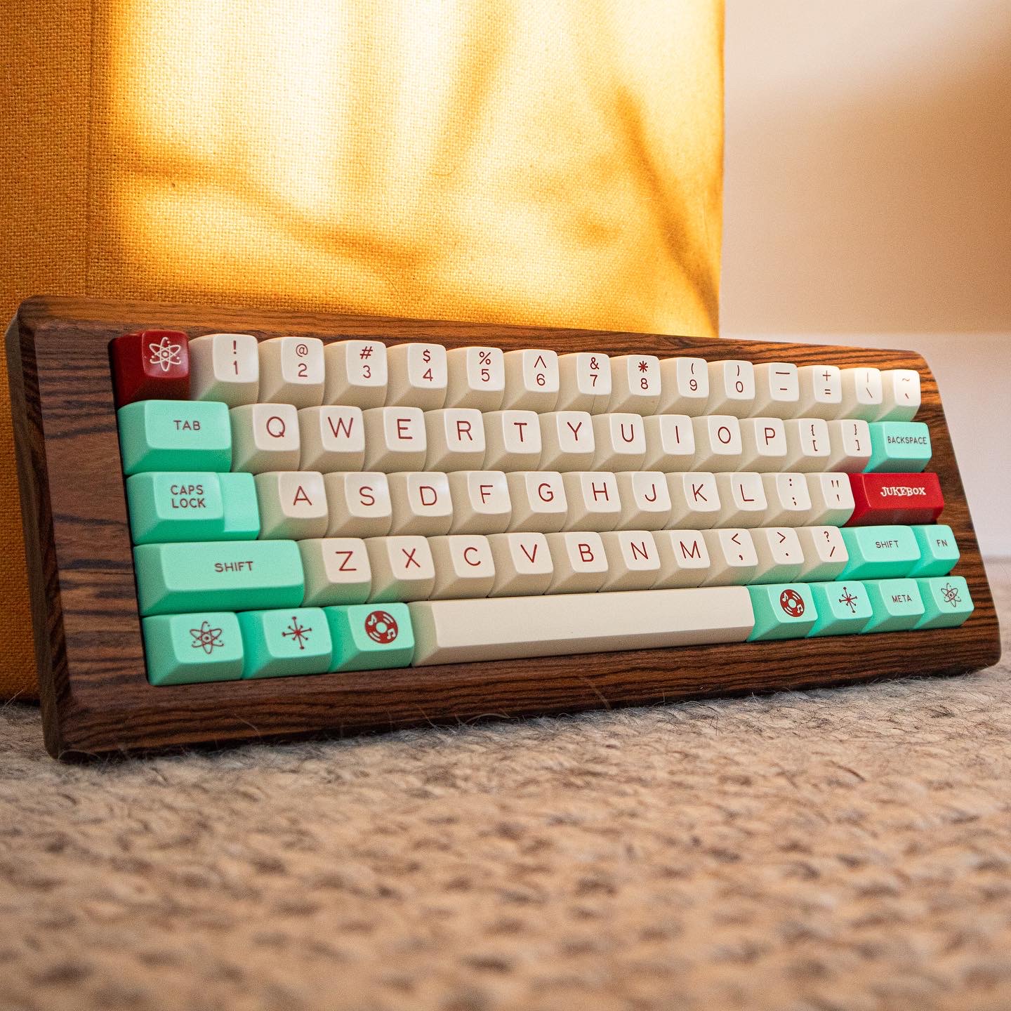

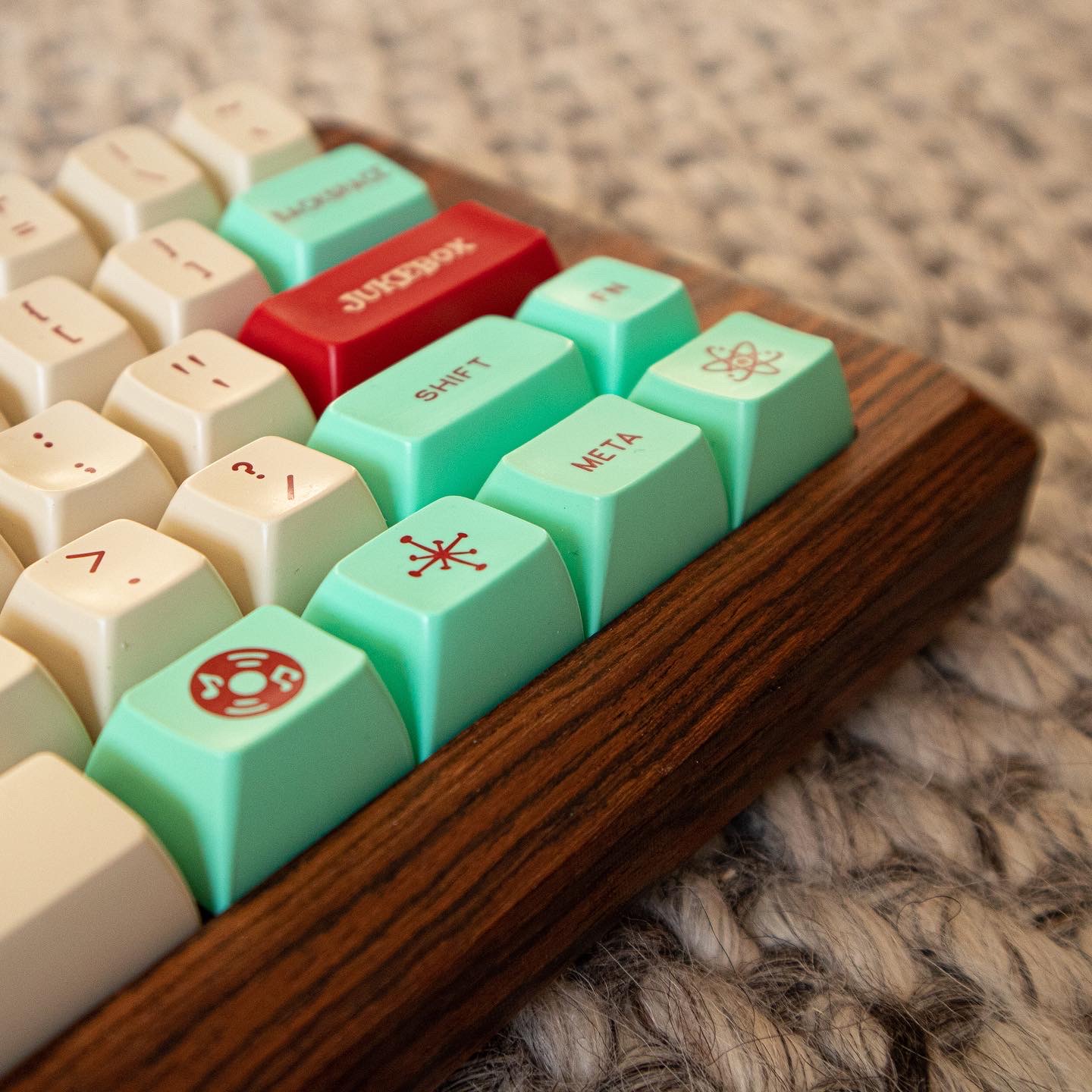

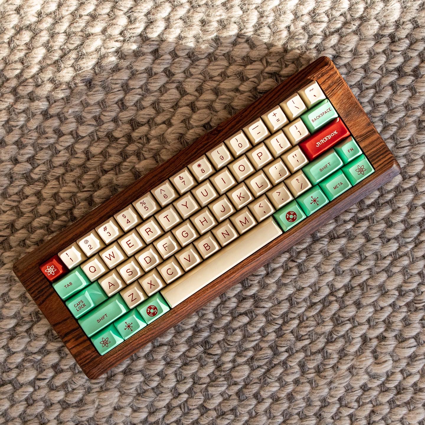

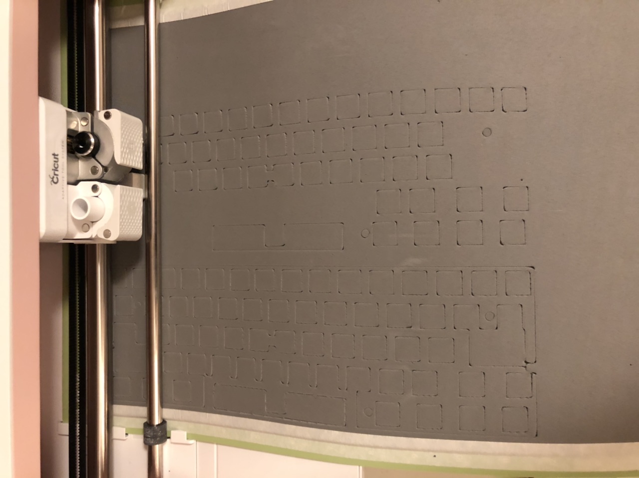

SA Jukebox on Retro60. I cut the plate foam with my wife’s Cricut. Just did two layers with a sheet of craft foam and it’s a perfect fit!
What can you tell us about the wooden case? Zebra wood? Who made it?
It’s a retro60 from thevan keyboards
As @dwarflemur said, it was a group buy run by The Van Keyboards. I believe the wood is bocote. Inside is a banana split PCB that was made hotswappable with a carbon fibre plate.

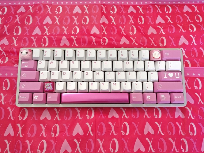

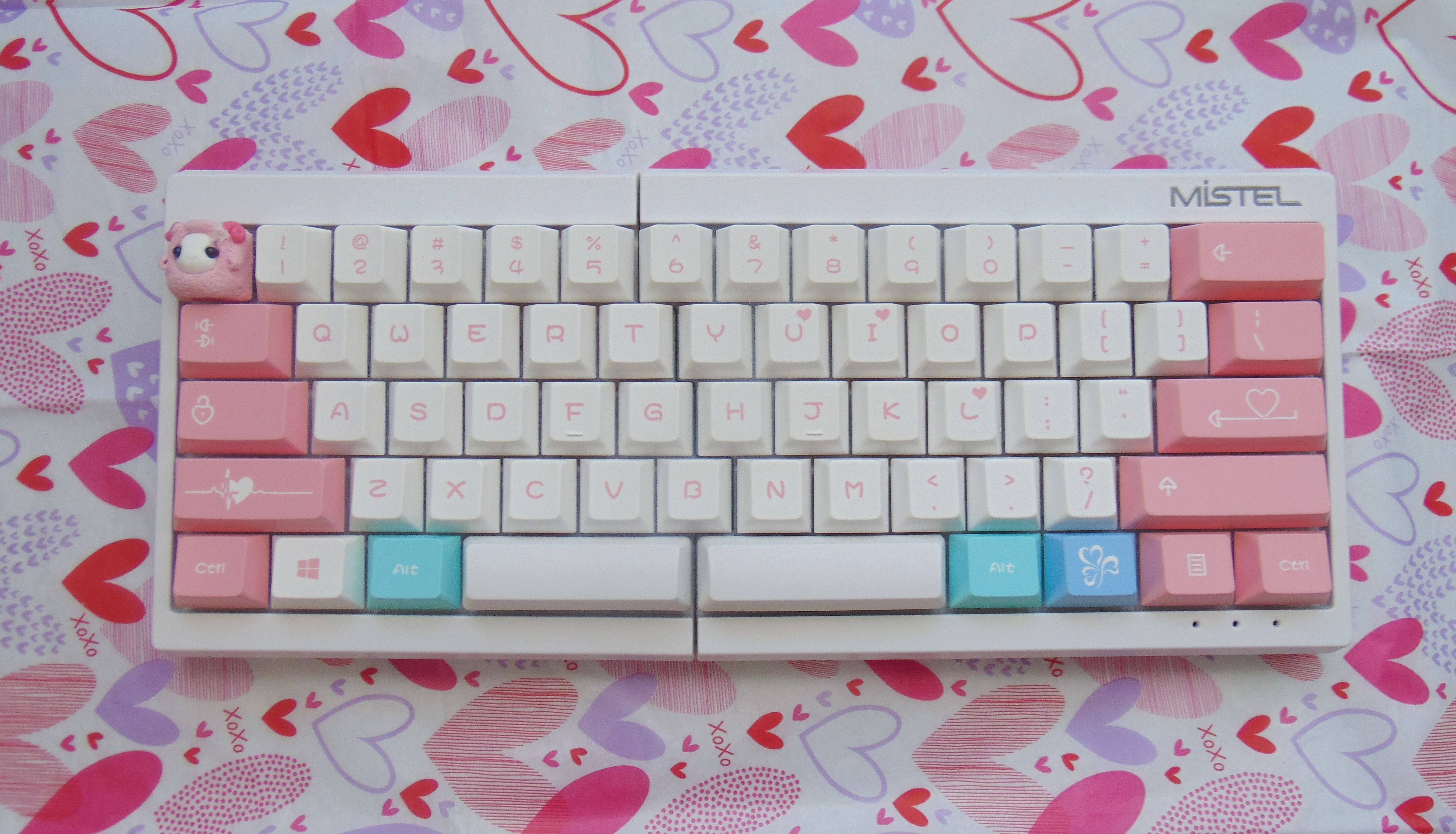

Recently got gmk valentine 2019 and it’s seriously gorgeous

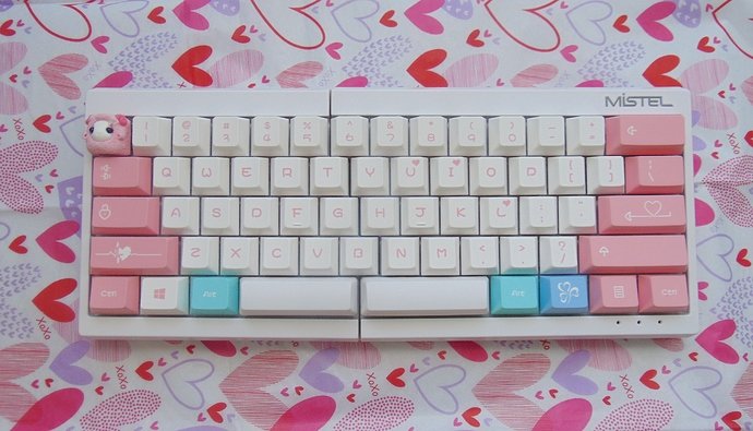

And then here’s my newest kb!
That spacebar looks delicious.

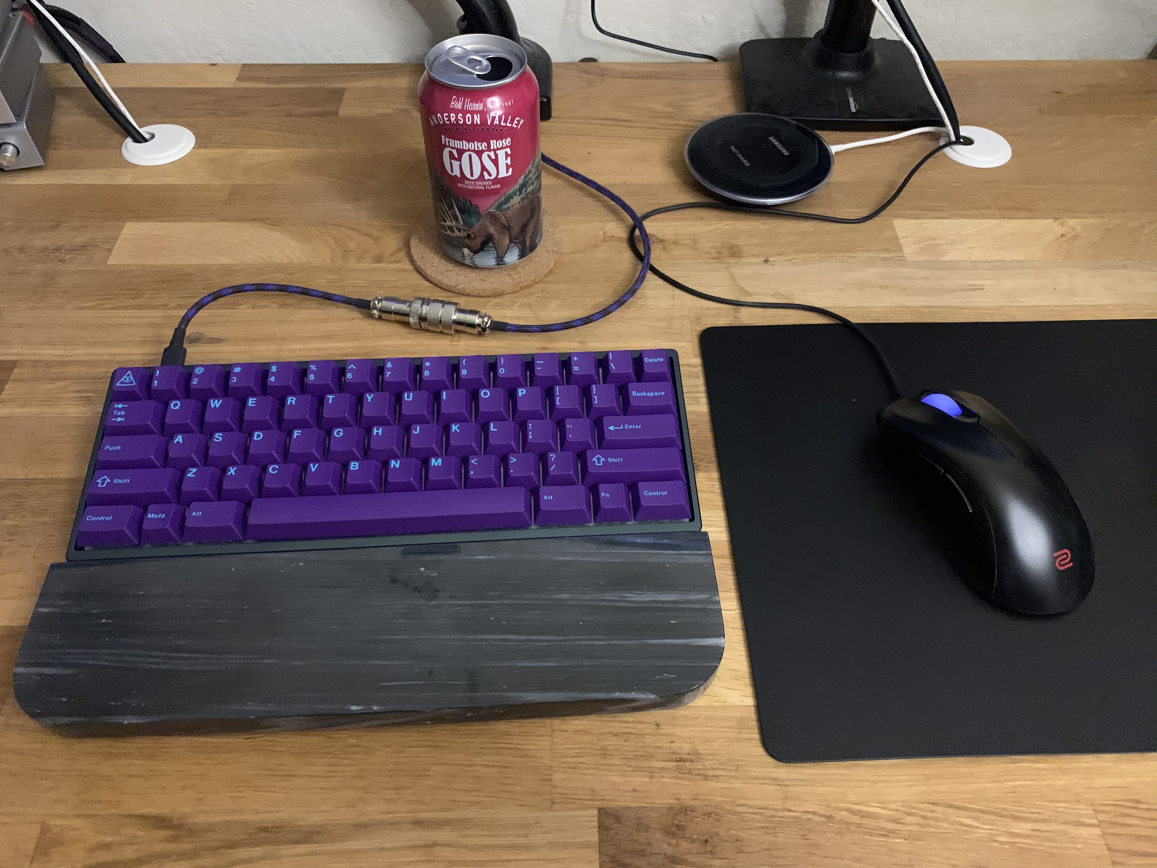

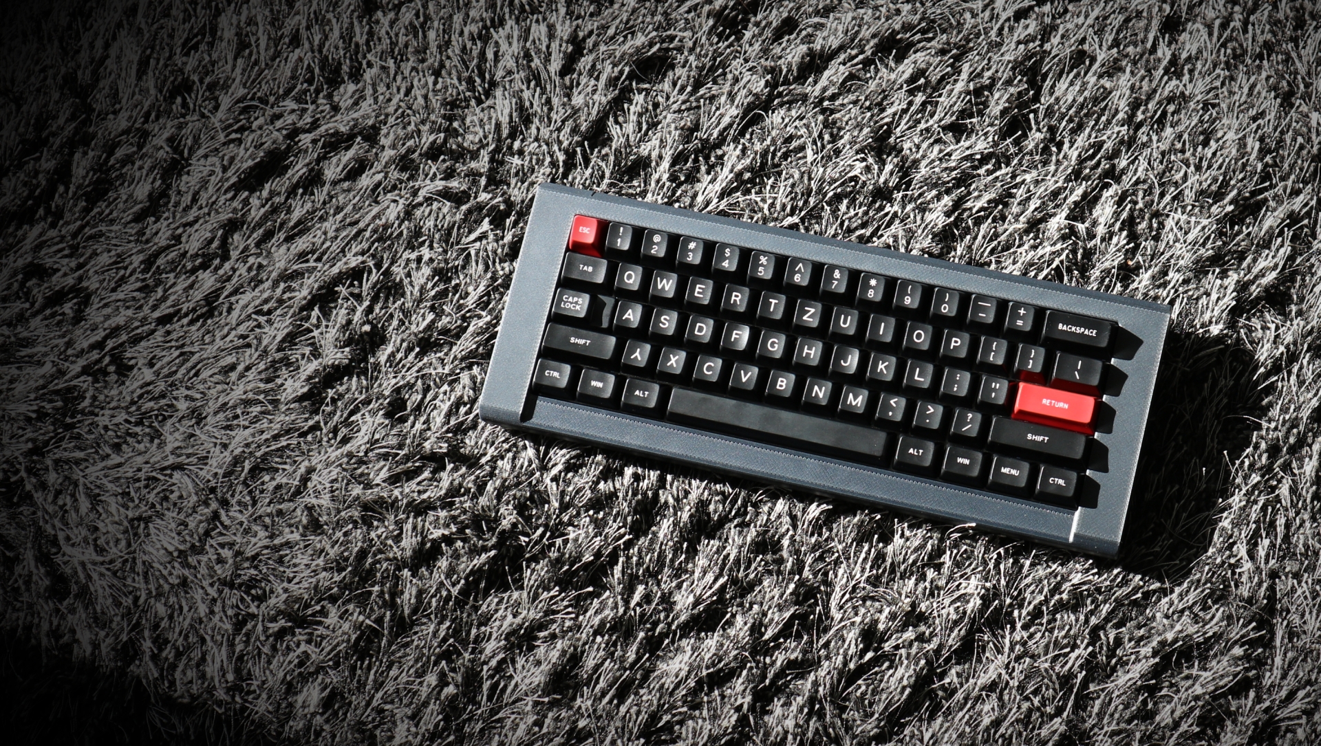

Keyboardbelle Cadette with 5 degree wedge
DZ60 with alu plate
C3 stabilizers lubed with 205g0
Creams lubed with 205g0, TX films and TX 50g springs (also lubed with 205g0)

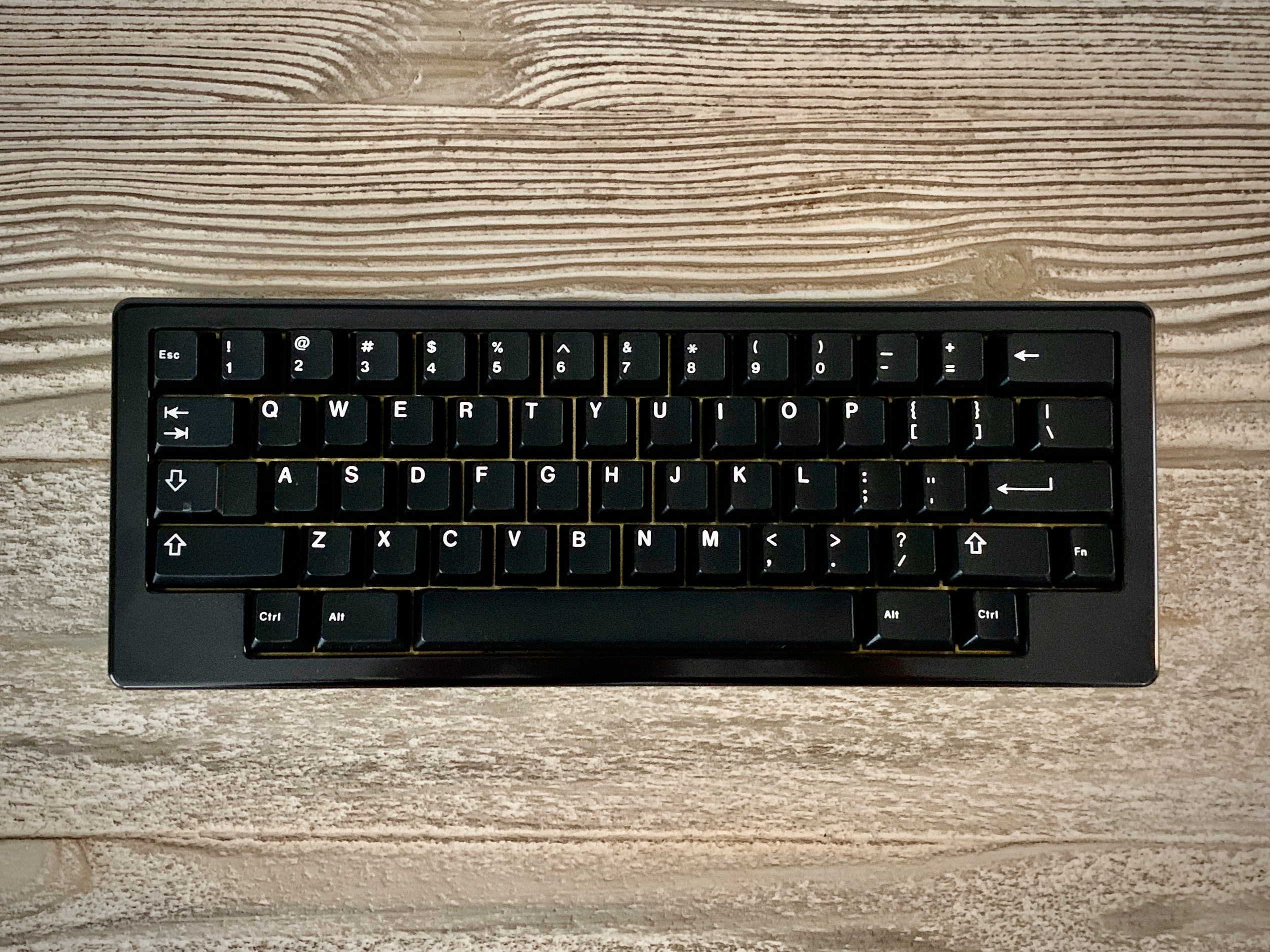

HB60 with GMK WOB

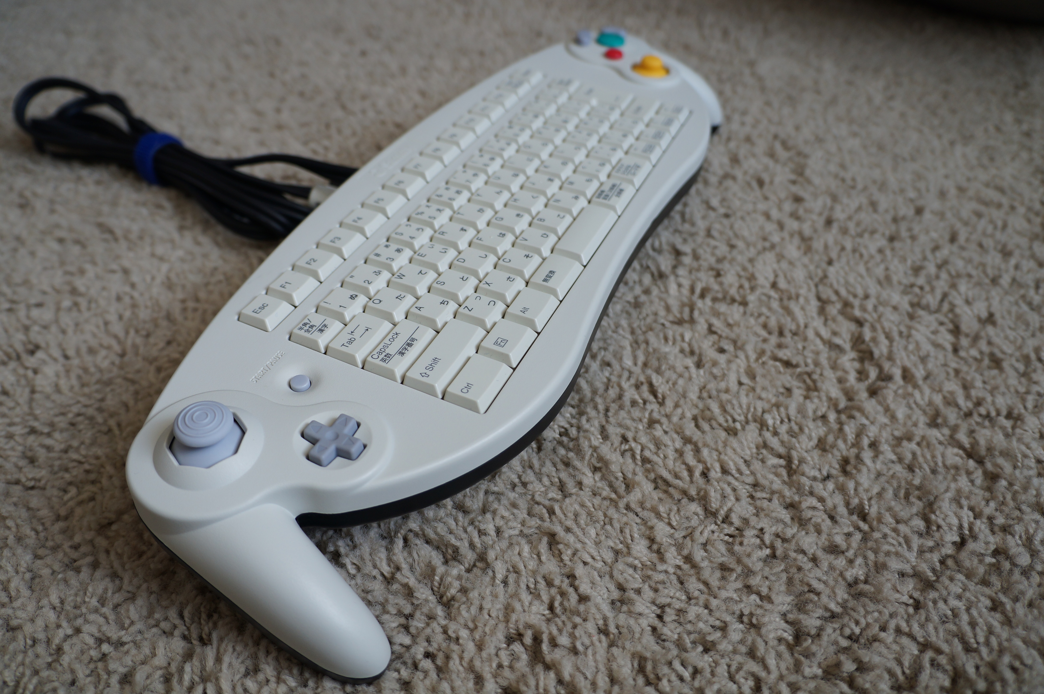

Gamecube Controller/KB for PSO.
Wow the condition on that looks amazing. The stick looks brand new and everything is pristine. Where tf did you find one like this? And I’ve never seen one with a black bottom shell. Huh.

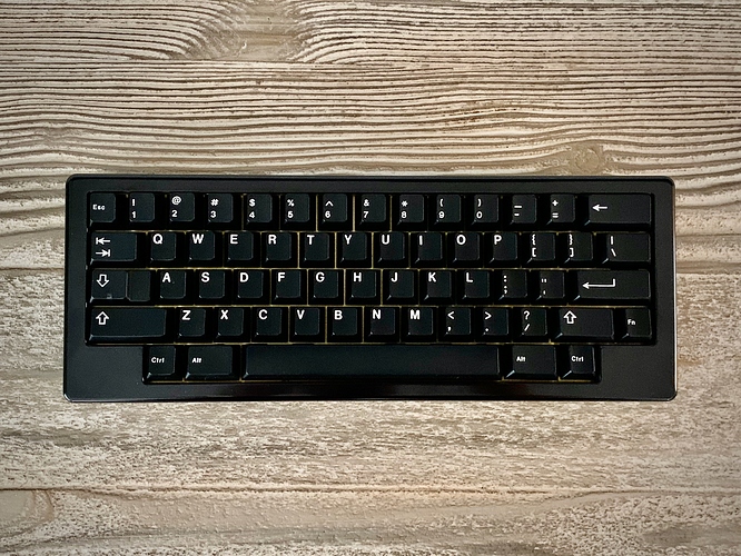

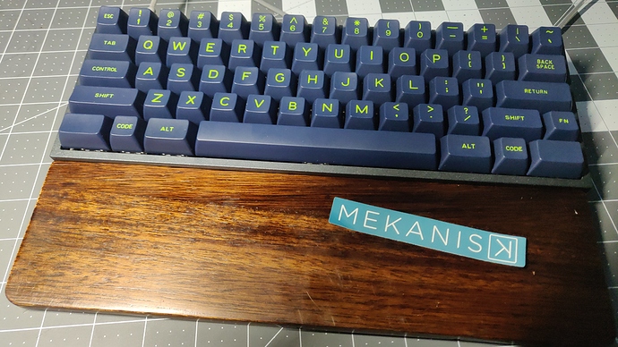

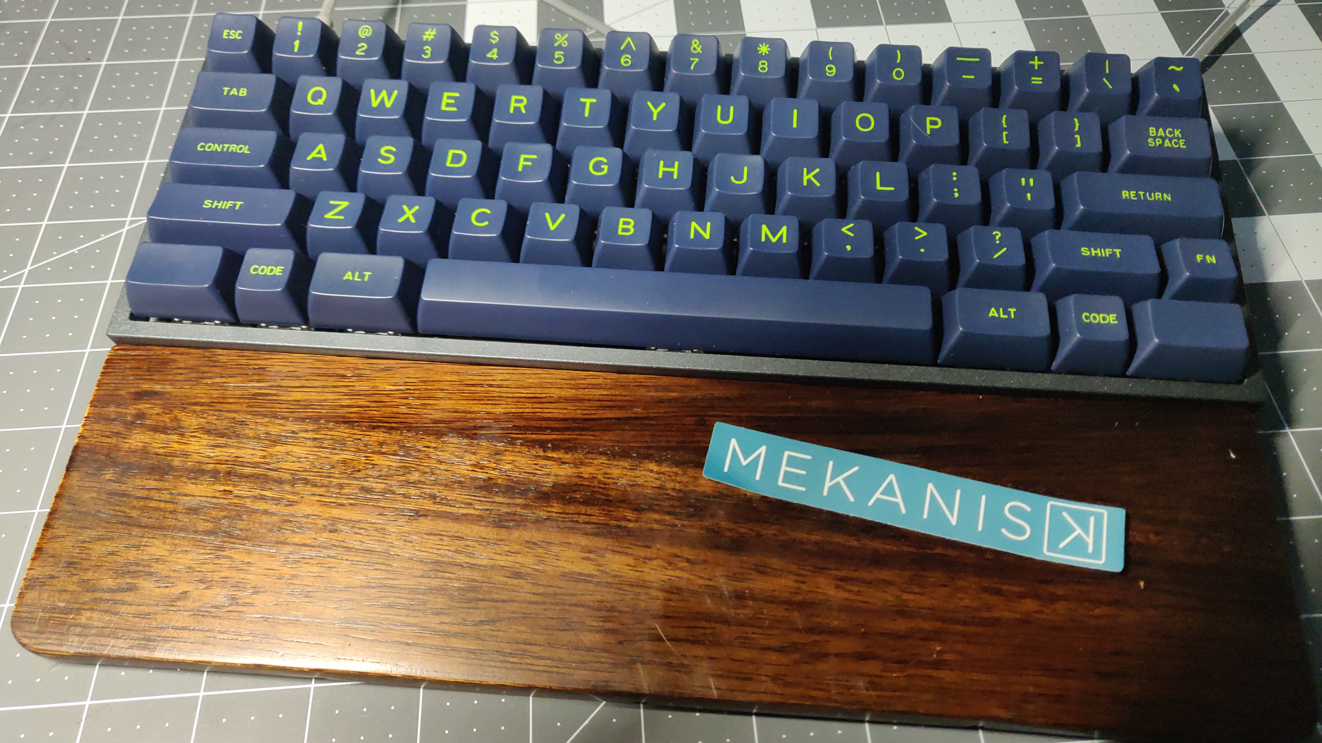

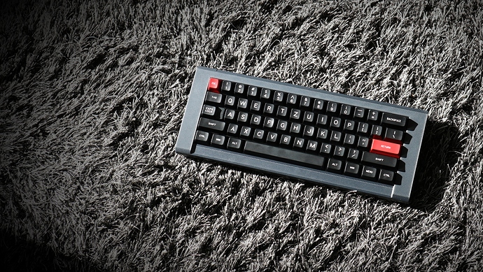

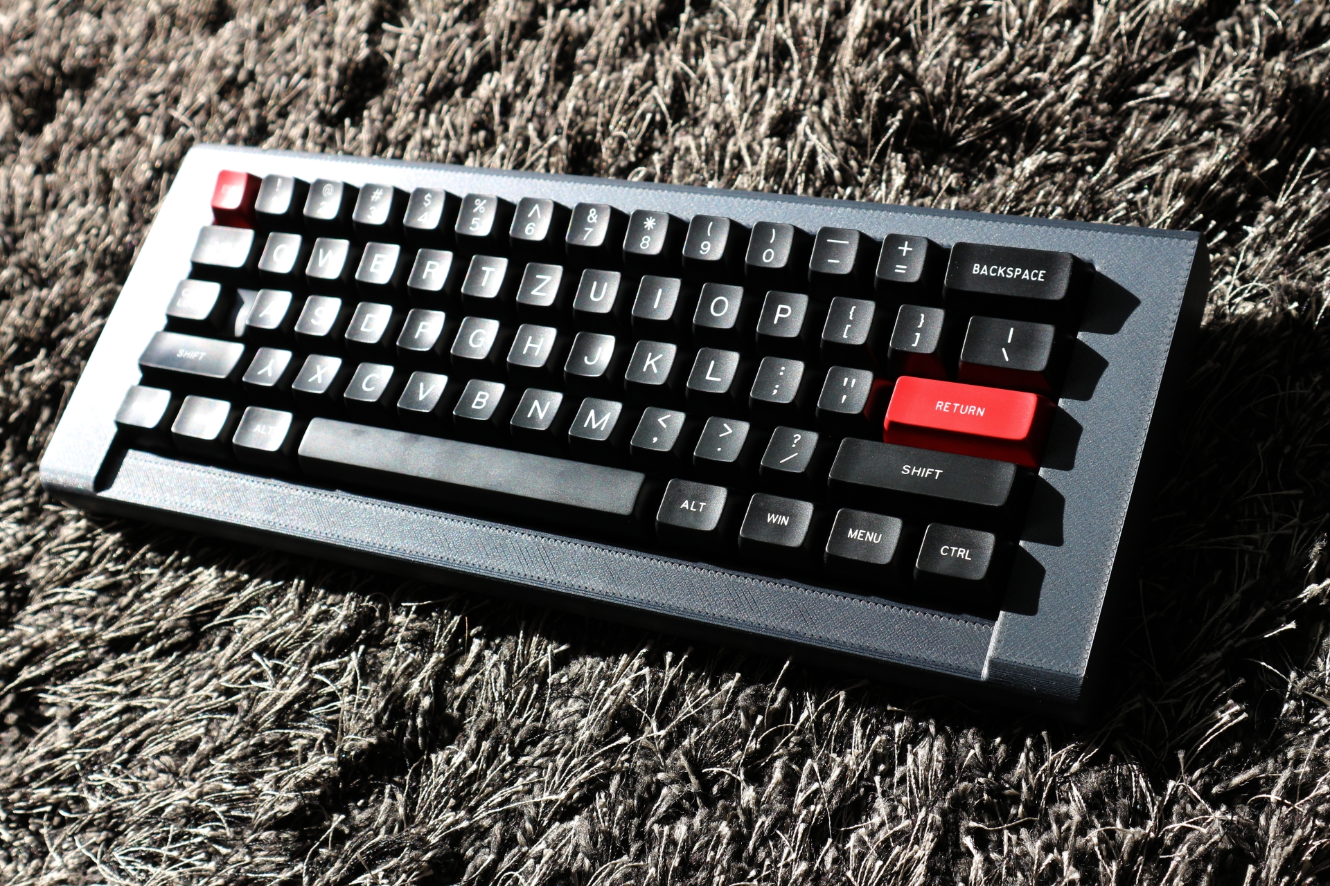

Just finished putting together this board today:
Here are the specs:
  • Klippe Case
  • Plain60-C PCB
  • Screw-In gold plated stabs
  • Aluminium Plate
  • Zilents 67g switches
  • Maxkey Leviathan keycaps
The Zilents’ stems are lubed with krytox 205 and the springs are lubed with krytox 105. The stabs are lubed with krytox 205 also and the band-aid mod is in place. There is a Sorbothane pad between the case and the PCB for extra dampenning. Very smooth, quiet, yet bumpy feel on the keys … I’m pretty proud of this build, if I do say so myself. One slight annoyance is that the stabs on the space bar hit slightly on the way back up … If anyone has any pointers it will be much appreciated. Perhaps more lube?

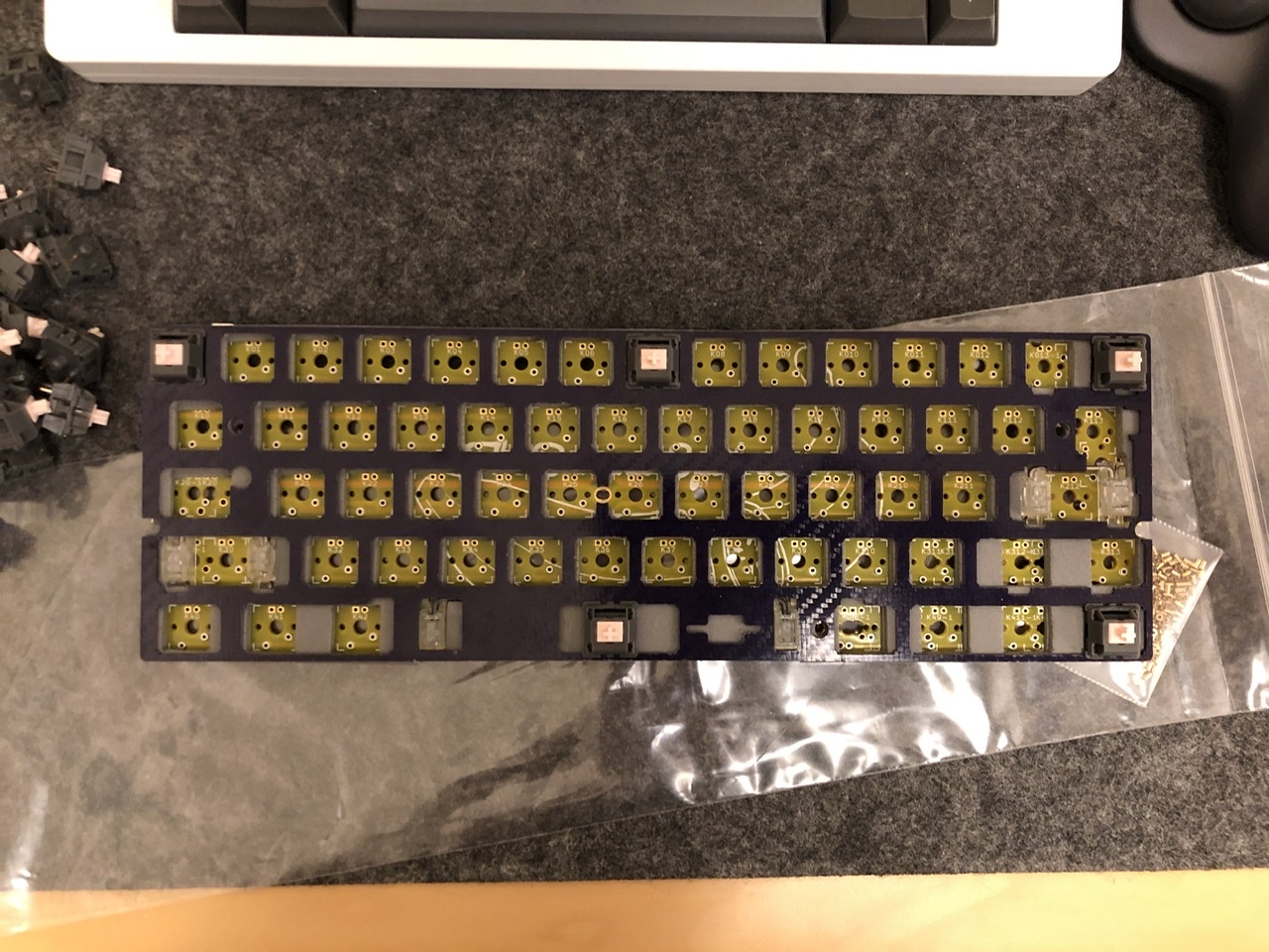

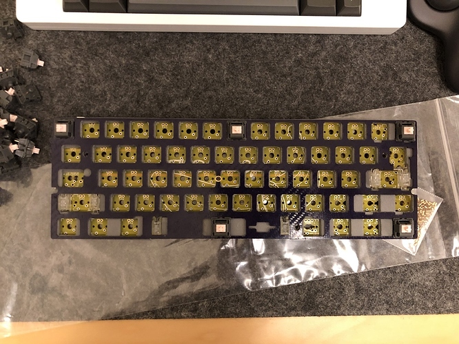

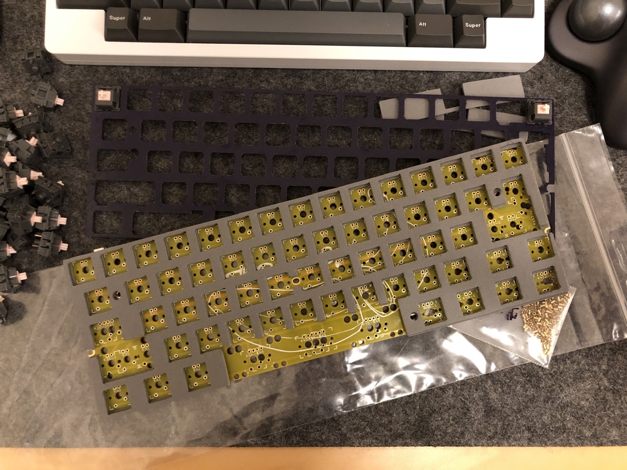

  • noxary T60
  • tealios w/ 3204 + films
  • C3 stabs
  • mkultra foam
It’s my first build with the C3 stabs, and my impression is they’re fine, I don’t notice them, which is probably a great review because I usually use zeal stabs which cost considerably more, so I’m glad I got a bunch of these. They weren’t great to install, but that’s just like a one time thing. Maybe I’ll write a build log for this one there was some interesting stuff. Feels great to type on.

I bought it brand new. I still have the box in mint condition too. I had the original version but my cat chewed through the cord while I was playing and the controls went dead. I picked this one up from a reseller on eBay way back in the day. This particular version was branded for PSO Episode III (Card Game).
It has a few hundred hours of use on it, but when I’m not using it I keep it inside an ottoman away from light and dust.
The KB feels so good… I love this thing.

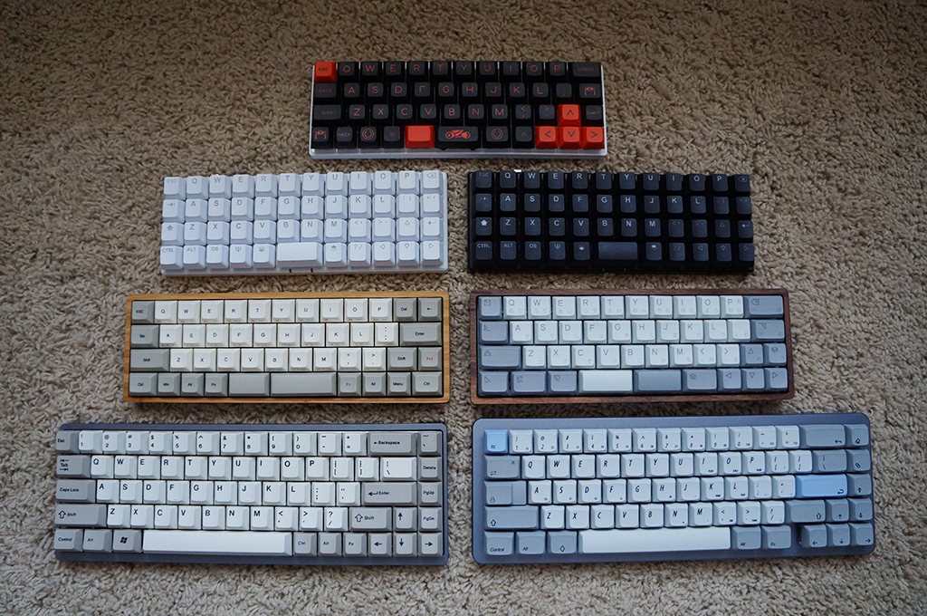

Addicted to 40%'s but need my dedicated arrows
  1. UT47.2: (Kailh Copper): Light Cycle/Control the System / 3D printed case
  2. Planck EZ Glow White: (Blue Zilents V2 62g)
  3. Planck EZ Glow Black: (Kailh Gold)
  4. Vortex Core: (Cherry MX Blue): Bamboo case from Alex Kahn
  5. Minivan KUMO: (Purple Tactile): Walnut case from Alex Kahn
  6. Tada68: (Cherry MX Black)
  7. Drop Alt: (Gateron Silent Brown): R1 XDA
This makes me feel better about having 3 plancks.
If they made more than two colors, I’d have more too :wink:
Ohhh, I totally glossed over the fact that they were the Planck EZ. Got a lo profile green rev4, a hi profile purple rev5 and one of the EOTW plancks. They’re a fun keyboard to mess around with :slight_smile:
