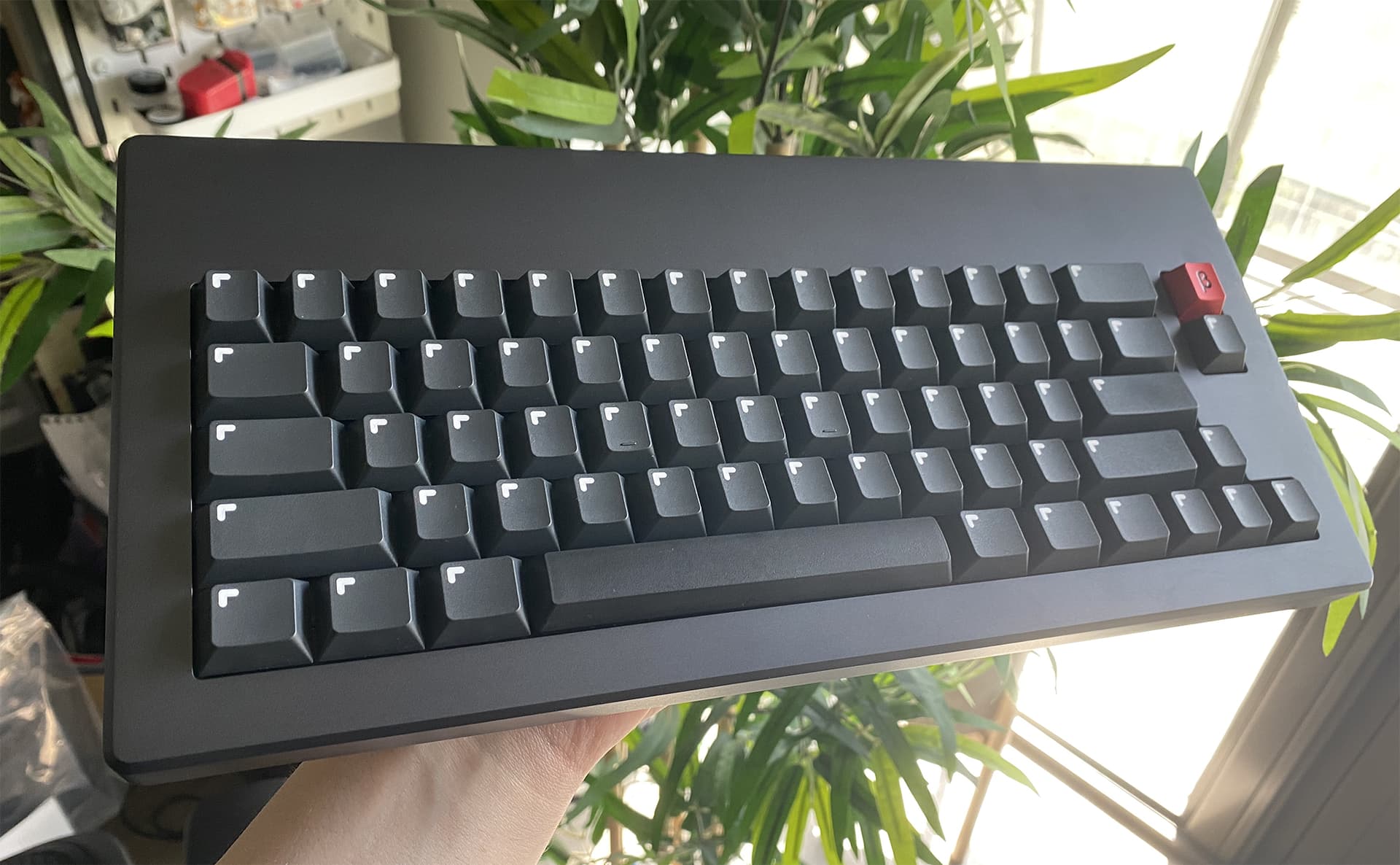

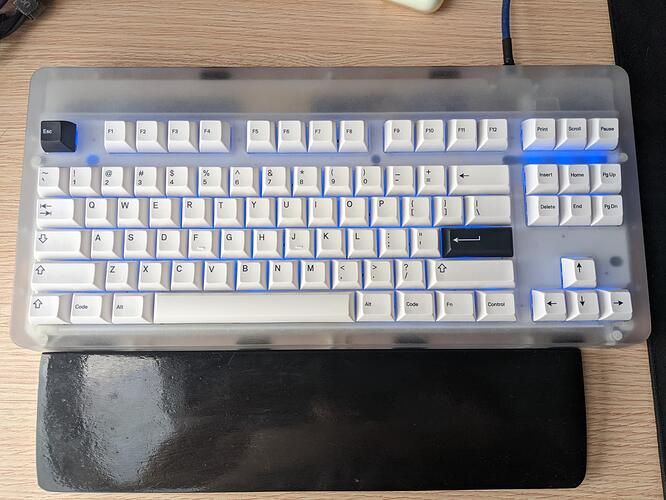

This is my workhorse - excuse the KBDfans keycaps as I don’t have more 104UG to spare LOL
They just released a dark color way for the hi pro

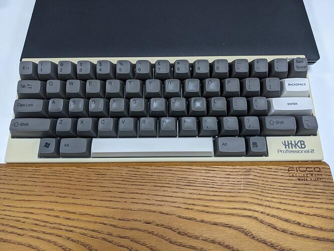

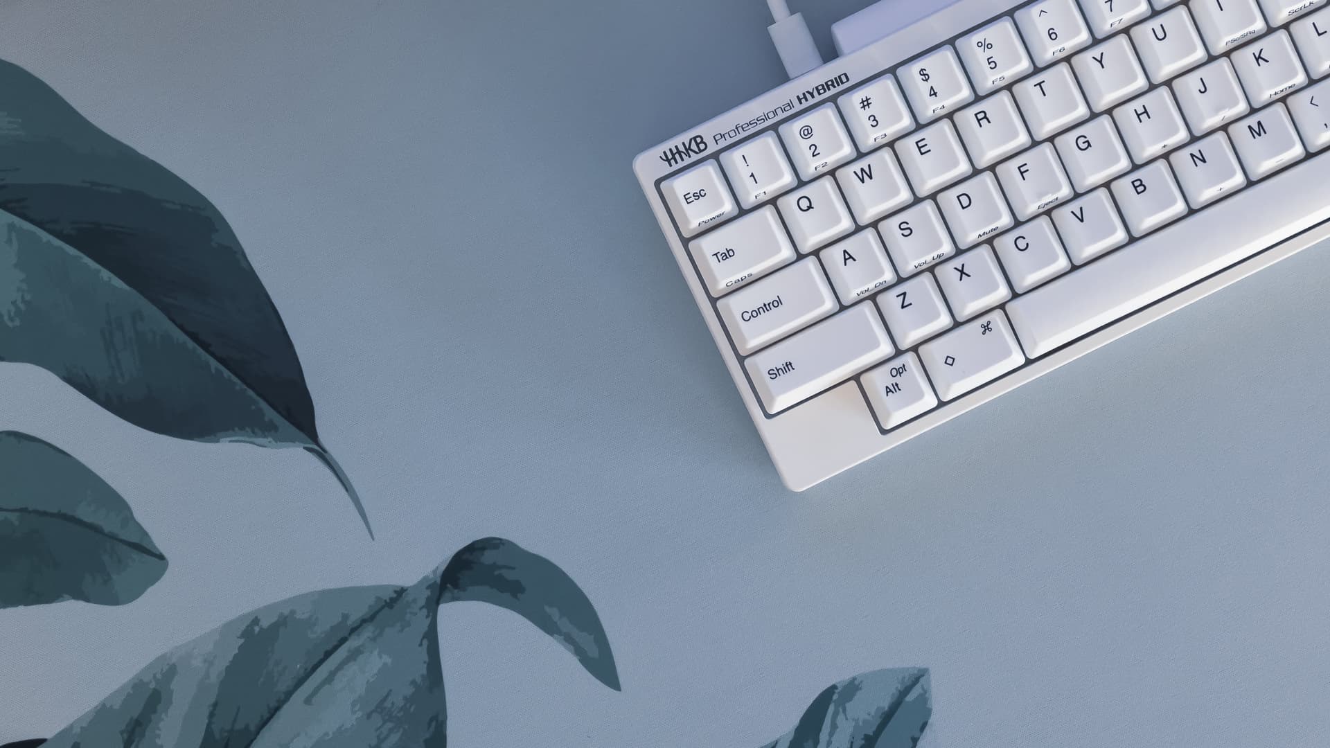

HHKB Pro 3
Deskeys Brown v2 domes
Silicone #5
MX sliders
GMK Serenity

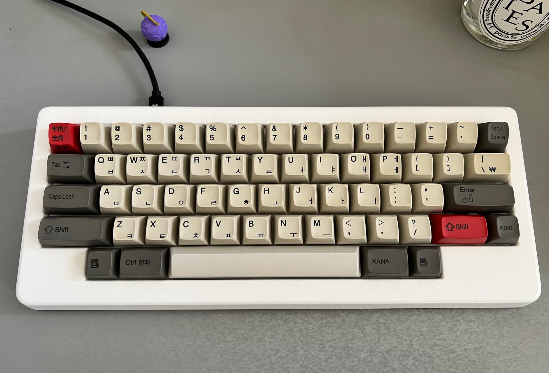

That’s really nice! How did you paint the case?
Topre “Dual Shot” :wink:

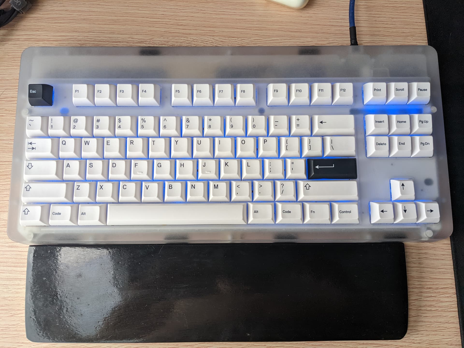

Yin & Yang - at work and at home
660c Silent in Heavy-6 UEO, Yang BLE USB-C controller, 45g OEM domes, OEM Silent housings & silencing rings, Deskey sliders, KAT Refined WOB with BOW accent
RGB TKL in Norbaforce GOFC, 45g OEM domes, OEM RGB housings & sliders, KBDfans 0.2mm rings, KAT Refined BOW with WOB accent

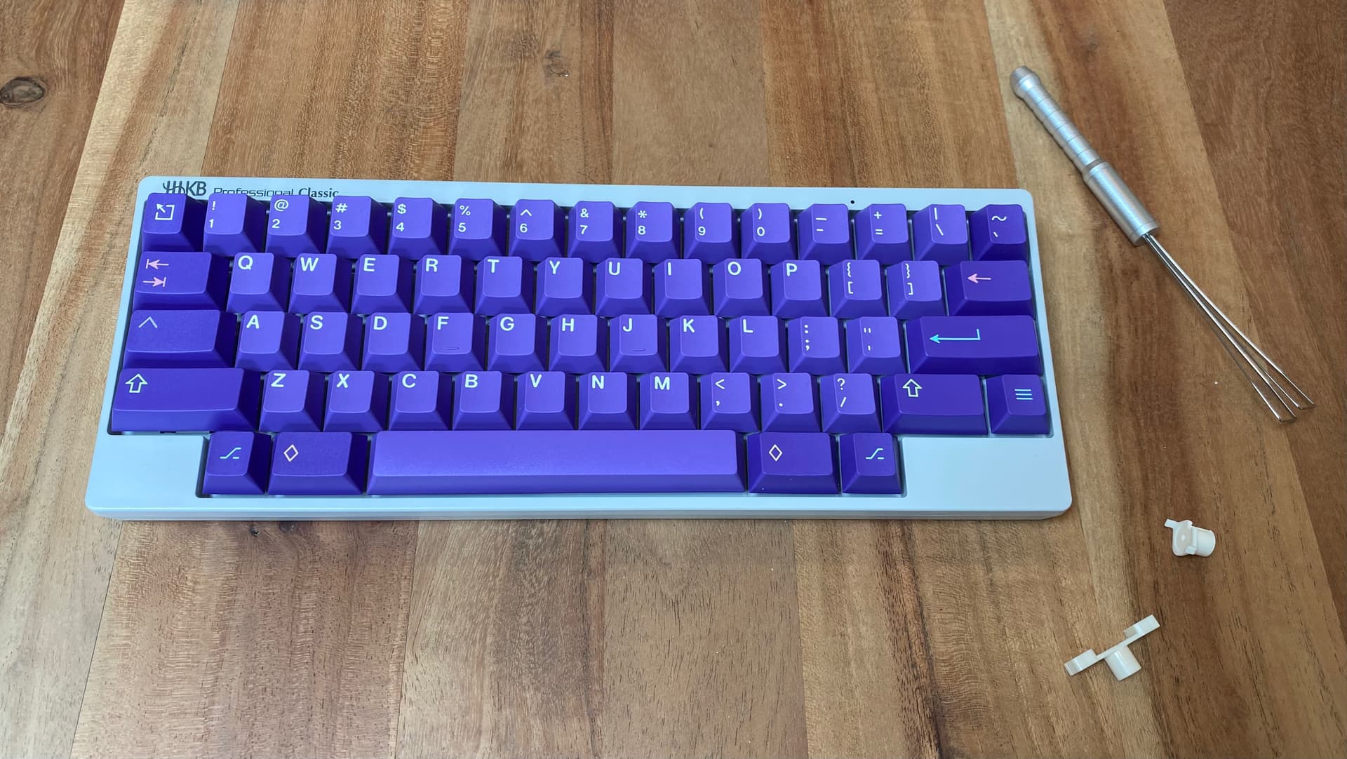

A few projects I have been working on the last few weeks:

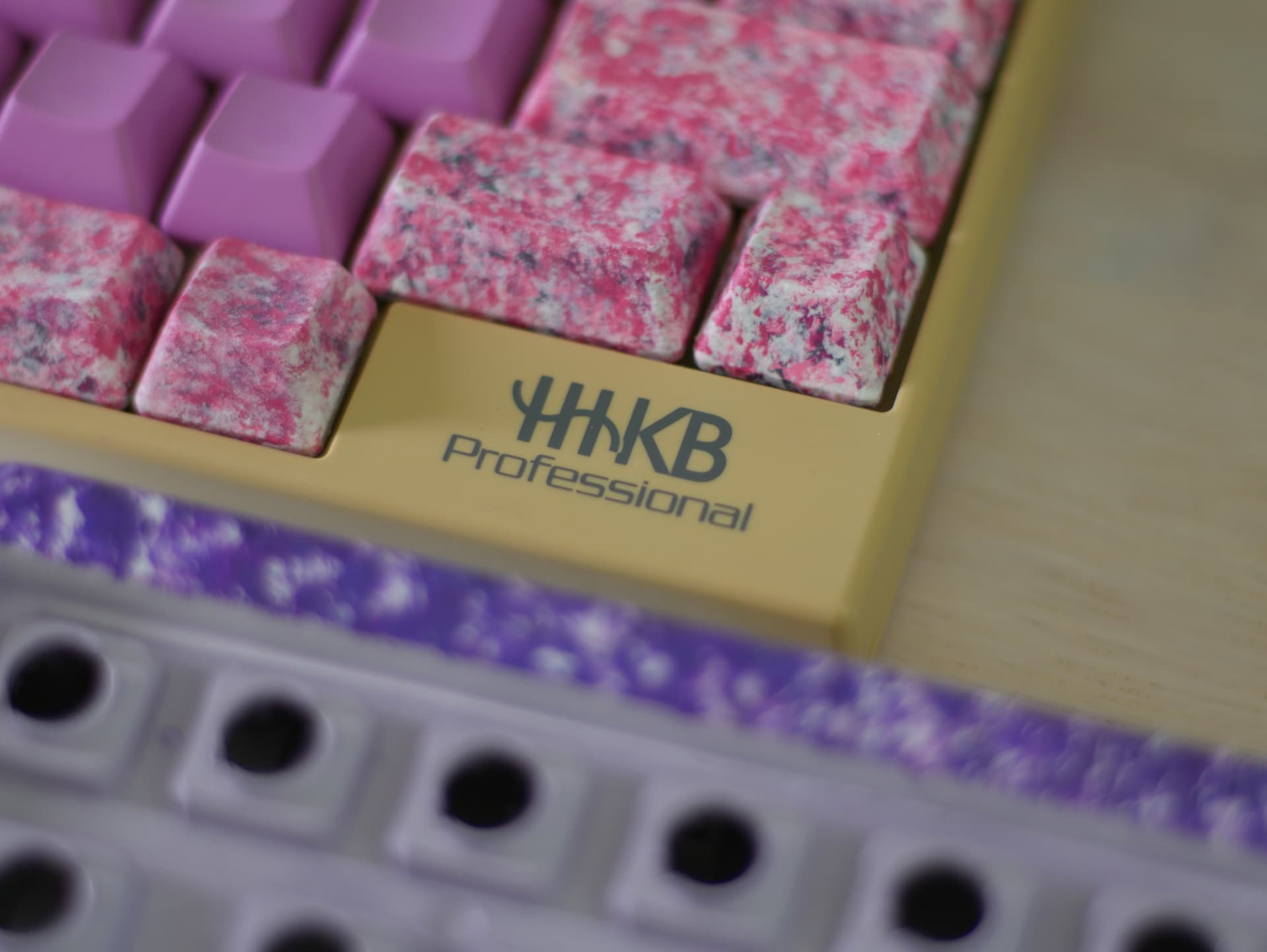

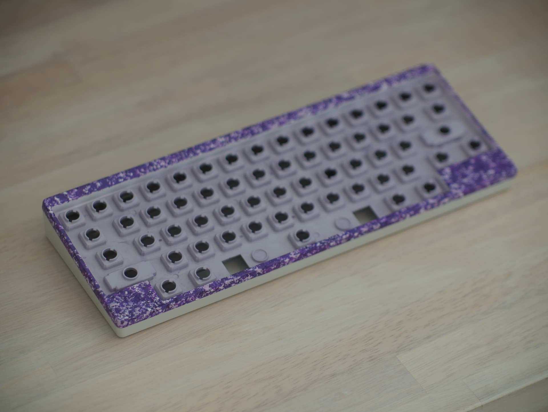

Pro 1: Dyed Alphas and Painted Mods
Pro Classic Case: Painted
P1040864
dye looks p good, any issues with evenness? also did u use stock topre caps or kbdfans blanks?
