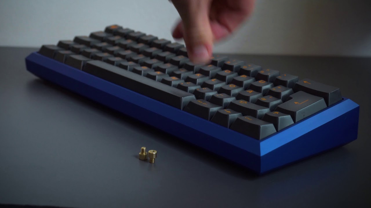

Weird flex with a STEEL PLATE and no center post. Granted, he is pushing harder than you would type, but the flex cuts on the PCB are a contributing factor to center flex. With the fr4 plate on the Salvation, this would be amplified (or you can snap off the center portion of the plate if you want to hit the bottom of the case with the PCB while typing). I think there will be a good amount of flex before the effects of the leaf springs on the Salvation, but they will provide flex around the edges too.
My question is: would it flex the same with a normal PCB without weirdflex ?
Leandren must’ve really been pushing down super hard if that is a steel full plate under there. Even if it’s a thin boi steel plate. My experience with a weirdflex PCB on a full plate (a POM full plate to boot) was the flexcuts did very little if anything to affect a normal typing experience. That is what actually drove me to cut the plate into a half plate. So I’d take this video with a huge grain of salt. Sure with a weird flex PCB any plate will show more flex when being pushed on heavily, but this does not translate over to normal typing. If anything, a full plate & weirdflex PCB will feel a tiny bit bouncier than with a PCB without similar flexcuts. Nothing transformative like when one is used with a half plate or plateless though IME.
He was thumbing it pretty hard yes, lol. I do see your point where a half plate / plaitless build would be far more flexy. I just got a weirdflex in along with POM full plates and fr4 half-plates – some experimentation is in order it seems.
