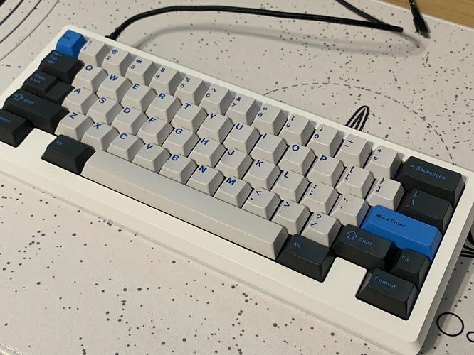

I feel like it’s certainly worth the price I paid, and I love being able to buy in-stock items.
I have lubed and filmed gateron 8008 inks in this one. Built it with the included plate foam.

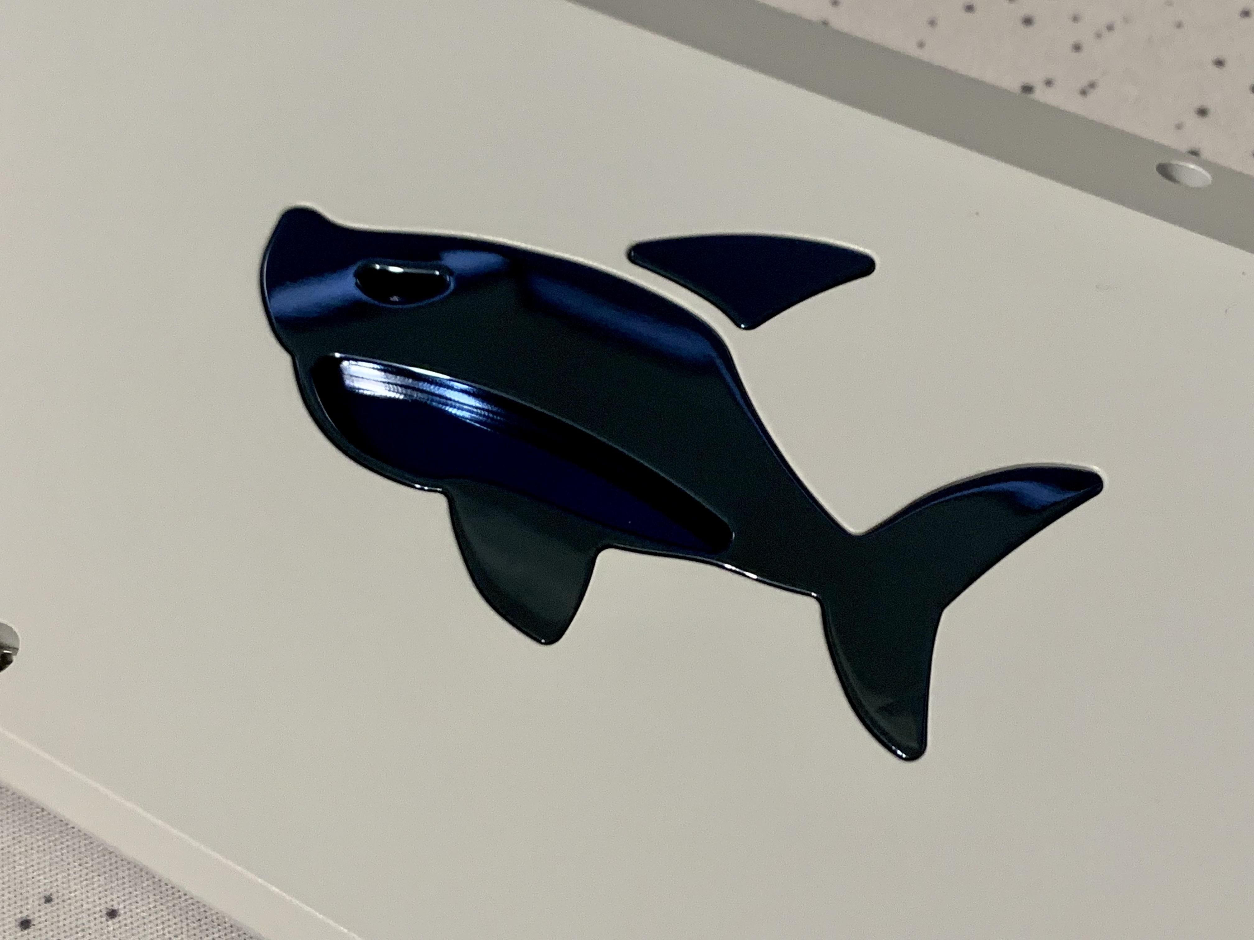

Favorites:
- The board angles are amazing. Very interesting design and makes it fun/easy to move around on the desktop.
- Finish is top-notch. Very smooth e-white coating feels and looks perfectly premium.
- The blue color of the plate adds a nice touch of character
- The weight gives a nice heft to the small form factor. Shiny blue sharky is beautiful
(See photo above)

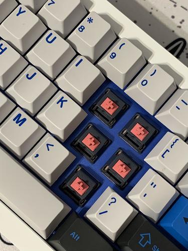

Things that could improve:
- The overall feel is on the firmer side. I think a softer plate or a flex cut PCB would make for a more interesting feel. Don’t get me wrong, it’s not harsh, but adding flex could make the kit stand out more.
- I had to cut the included plate foam to accomodate 2u backspace and stepped caps.
- Bottom row of plate is swiss cheese to accomodate split space and isn’t as nice looking without keycaps. I don’t use split space and I prefer a fixed Tsangan layout.
- Key feel is a bit uneven around the board. The top row feels much firmer and sounds different than the rest of the board. Probably could try building with a flex cut PCB to even it out more.
