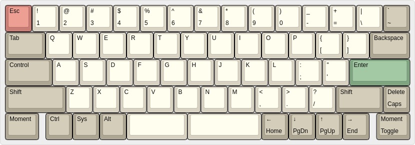

The first is a split ortho with similar keycap compatibility to 60%. Nothing too novel if you’re familiar with the FoldKB, but with arrow keys similar to the Planck.
The second is an inside-out 60% with mirrored inward/upward stagger on the alphas. Probably the least practical of my designs, but none the less an interesting thought exercise.
And last but not least, a compact TKL. This is actually the one that is most likely to come to fruition. TKLs have a special place in my heart and I also like space saving but I do like some kind of blockers around the arrow keys and a segmented F-row. Ideally the corner of the plate/case below the down arrow would be cut off.

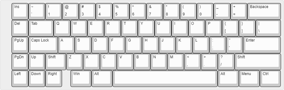

This has been something I have been playing around with lately. I prefer a 65% layout, I am right handed, but because so many years of playing games with WASD, and the fact that my mouse is in my right hand when working, I would prefer to have my arrow keys and nav/function buttons on the left side of the keyboard. That way I don’t need to reach across my keyboard with my left hand to use my arrow keys and nav buttons.
The only concern I have is the 1.25 left shift, as I touch type and use both my shift keys. I have been paying close attention to my left-shift-usage, and I only actually press the far right side of the left shift, so I think it would work.
That’s cool! Sort of a southpaw type of 65%. I don’t think I’ve seen anything like that before. I think it would also work well with the under-represented 70% layout as well, which would allow for a full size left shift (even if just for the sake of keycap compatibility).
I have that layout in my keyboard editor as well, but I never use that many extra keys. I kept going back and forth on “why not add extra keys it can’t hurt” versus the compact layout.
But now that you mention it, my mouse is on my right side, so extending the layout on the left doesn’t have much of an impact, AND it solves the 1.25 shift problem.
Thanks!

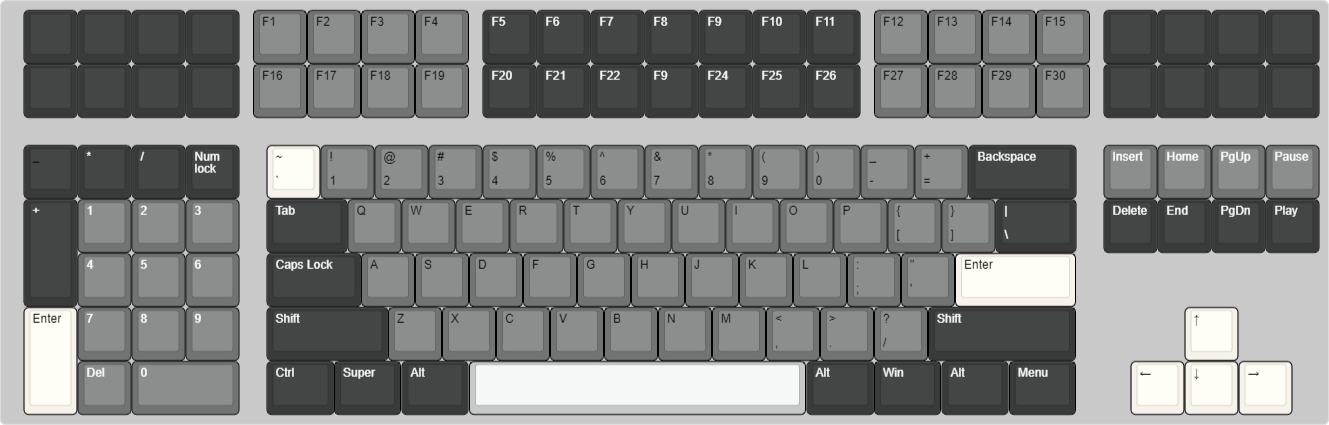

Ortho compact(ish) 75%, WIP name, used to be 86 keys, added a macro row and moved the knob to the objectively ergonomically superior left side, now 92 keys, thinking something related to uranium because it’s element 92.

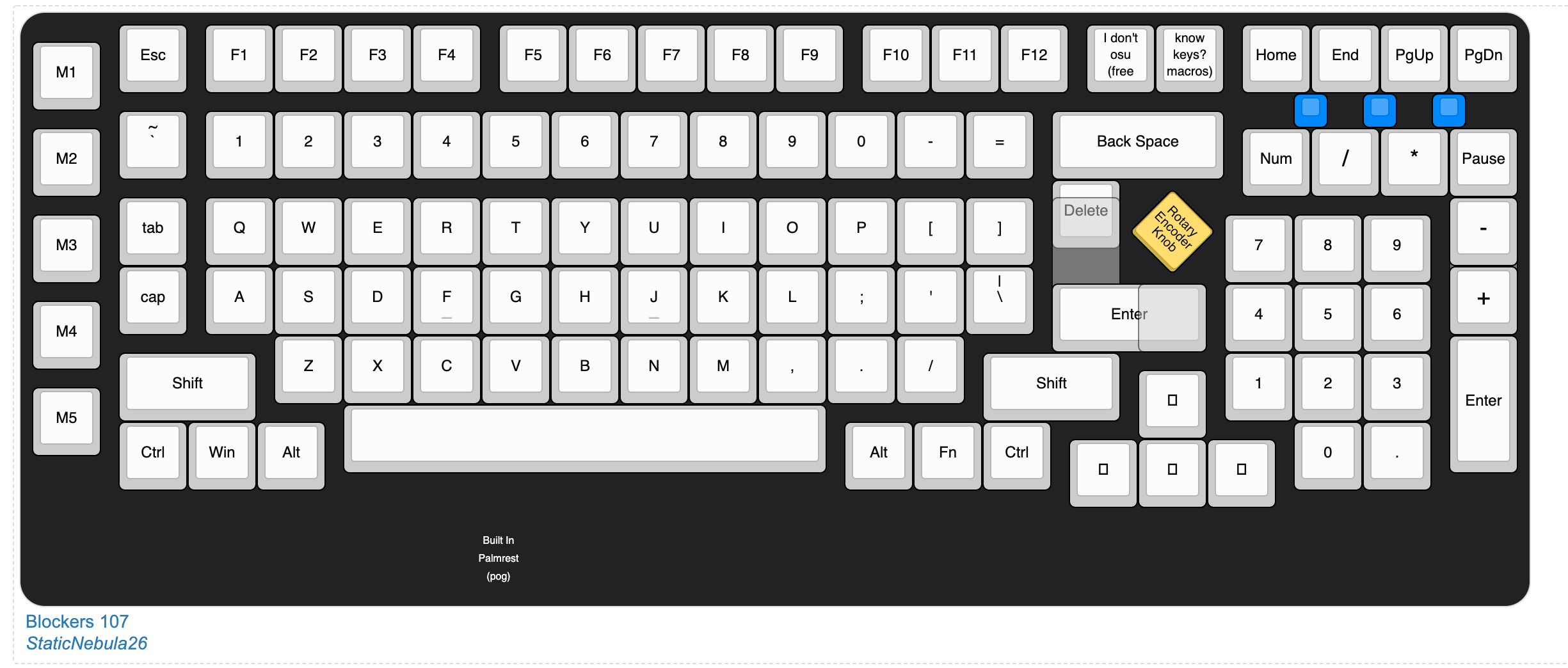

gmmk pro loosely inspired layout, mainly out of spite towards blockers and arrow clusters that hang down like on the gmmk pro but this one being basically a full size, it’s kinda a vibe now.
also, l o n g b a c k s p a c e
Interesteteing! This is something I like except the macro keys.

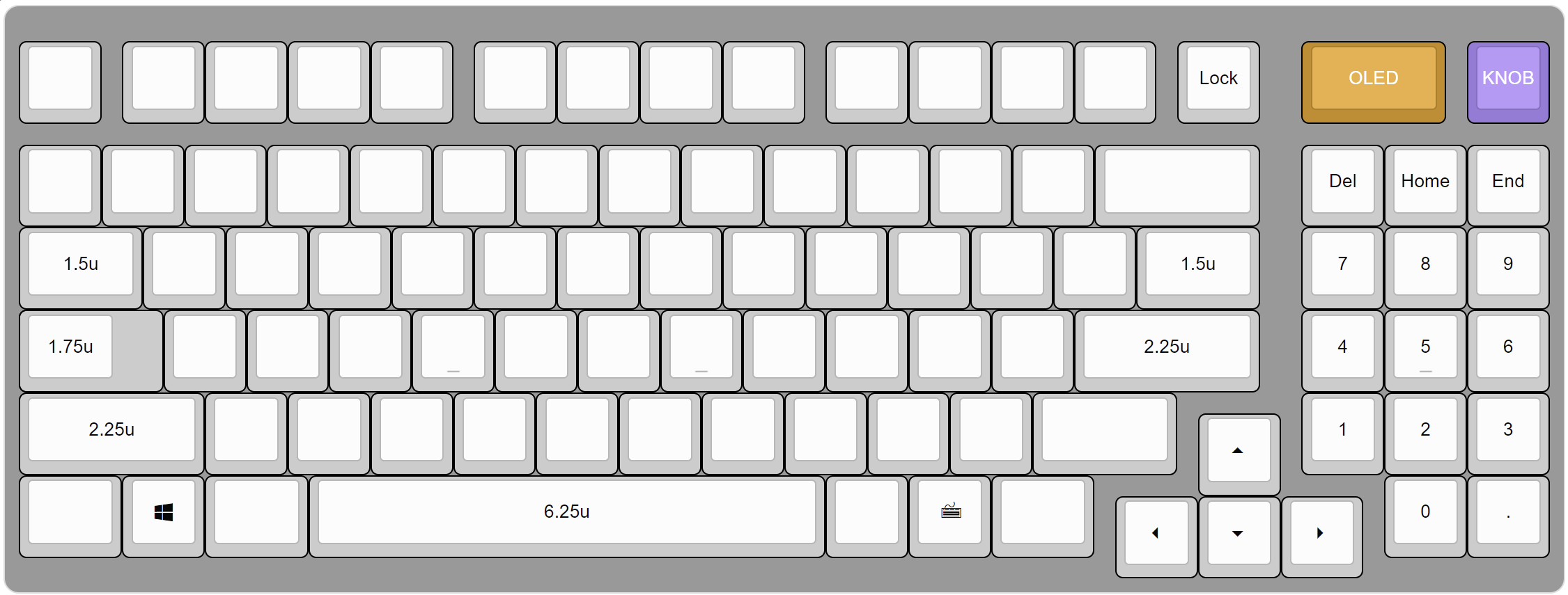

Just came up with an idea of a compact layout with numpad and OLED. As I find numpad are good for quick number input, but I don’t usually use calculator inputs (-+/*), so I got rid of those keys and replace them with Del, Home and End instead (can still be remapped).
For a compact layout, the Enter key is already close to the number cluster, so there’s no reason to add an extra Enter to the right.
Lock key should be multi functional (For example: Numlock on layer 1, Scroll lock on layer 2, Print screen on layer 3).
