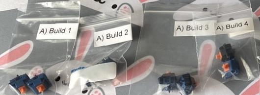

I am going to answer 2 and 3 together. Yes, films are necessary for the optimum experience. These switches are so important to me that I sent some to a professional builder to test four different concepts for building Meteor Orange.
Here is what I proposed, and the builders’ response:
- Film the stock switch and lube only the area surrounding the leaf, probably with 3203. The factory lube on the stem is already sufficient. Create 2x of these. Lube stock spring.
Filmed with TX 0.15mm films. Stem lubed with 3204 (top of switch (L/R rails) and bottom of L/R rails and bottom of pole. Very minimal points lubed. Stock spring lubed with GPL 106.
- Film the stock switch and replace the top housing with a Cherry housing, lube the area surrounding the leaf with 3203. And maybe lightly-lube parts of the top-housing. Create 2x of these. Lube stock spring.
Filmed with TX 0.15mm films. Stem lubed with 3204 (top of switch (L/R rails) and bottom of L/R rails and bottom of pole + front of switch (area above the legs). Stock spring lubed with GPL 106.
- Film the stock switch and replace the top housing with a Cherry housing, lube the area surrounding the leaf with 3203. And maybe lightly-lube parts of the top-housing. Create 2x of these. Replace spring with lubed 55 G 14mm TX spring.
Filmed with TX 0.15mm films. Stem lubed with 3204 (top of switch (L/R rails) and bottom of L/R rails and bottom of pole + front of switch (area above the legs). TX 55G spring lubed with GPL 106.
- I am going to leave the remaining 2 switches at your discretion.
Filmed with TX 0.15mm films. Area surrounding the leaf lubed with 3204 (sides, pole, top and bottom) and lube cleaned off the front legs. 60G TX long spring lubed with GPL 106. One switch has a Cherry top
Essentially, I thought that the second build concept worked best for me. This was basically:
Don’t do the bare, most-minimal possible lubing, but also don’t be generous. Lube where you think there are shortcomings in the factory lube, while otherwise preserving it. A careful use of 3204.
You can see from the second build concept where those areas are.
The Cherry top-housing was important to the sound and feel of this build. I think the Cherry top was taken from an MX Brown, but I don’t think that matters. I’m using MX Silent Red for the build.
The stock spring feels fine to me, weight-wise. Sure, it needs to be lubed and all, but I like the weight.
You’ll noticed I tried 55 G 14mm TX springs in some others. They work fine but they feel a bit more ‘harsh’ somehow. Stiffer. I don’t know. They may indeed be more rounded, but the stock Meteor springs just felt more relaxed. This is a very mellow tactile.
The films improve the switch, because I feel that the housings are not as tight as they could be. And because I want to use Cherry tops, films could be an important asset here. They do seem to improve the sound somewhat, which is very much-needed.
Using TX 0.15mm films for the testing, but Deskey films are going to be tried soon.
So yes, lube it, film it, and maybe use Cherry tops if you can.
![MeteorOrangeSampleBuilds](https://www.keebtalk.com/uploads/db8059/original/3X/2/6/26beef6042110254ebff3e49bc21f3e09ffd97a9.jpeg)
