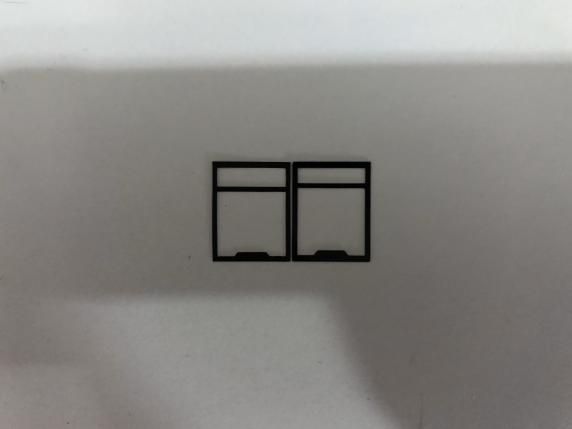

The thickness is the same 0.15. It is just the form which is a bit different.
Left is KeBo and right is TX.
The Material of KeBo is softer.
I can’t tell how that shape would affect the switch, someone has experience regarding this?
It actually won’t matter too much in the end, but I believe it would largely depend on the toelrance, shape and clearance the bottom housing provides.
Here’s a somewhat farfetched picture comparison of this:
You can see how the clearance that the leaf part provides differs slightly owing to the width of the leaf itself (metal contact bit). So a smaller width would be better tended to by the TX film. And vice versa.
However, I believe it would just end up being a nuance of sorts and not really mattering a lot.
