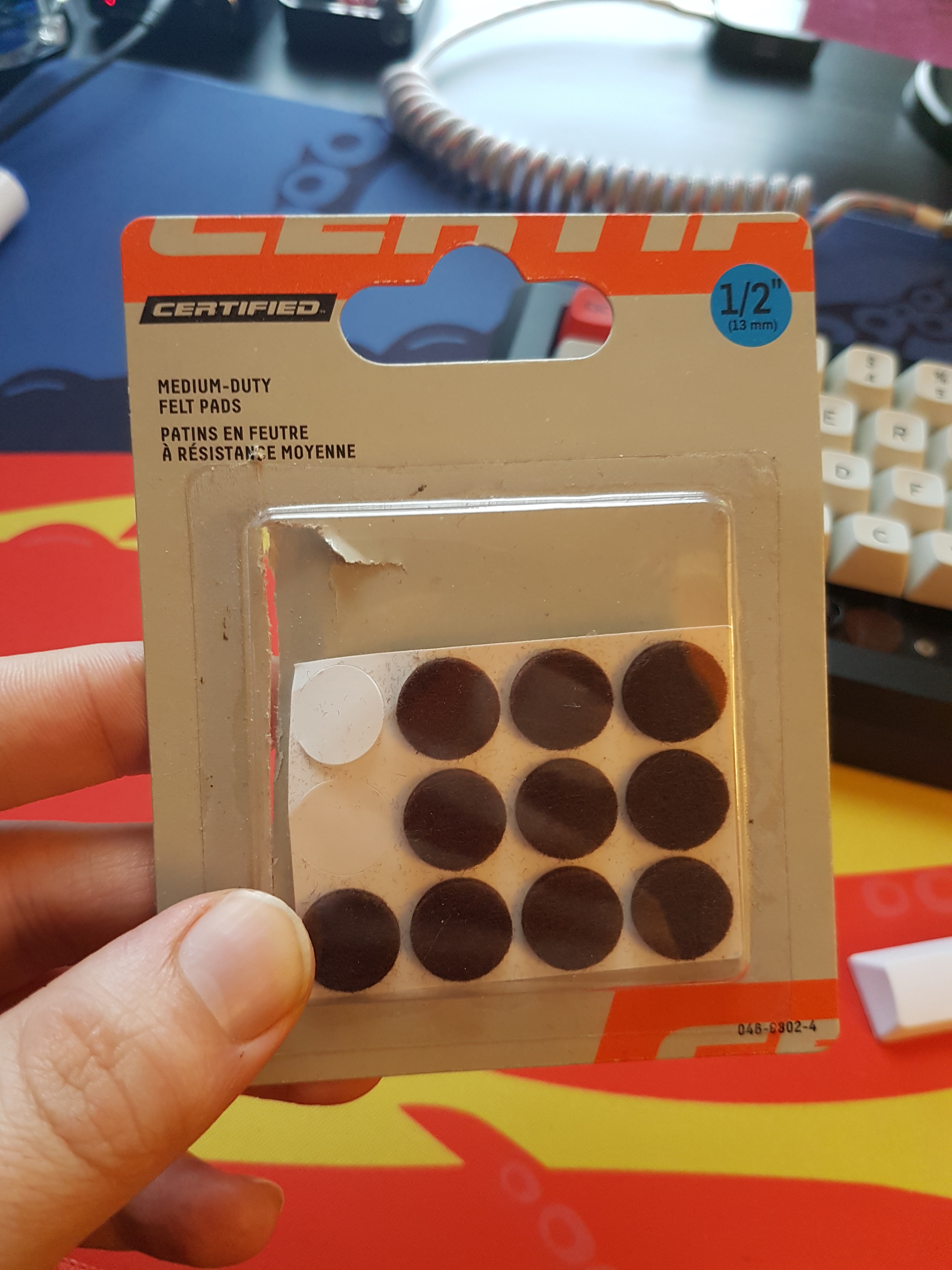

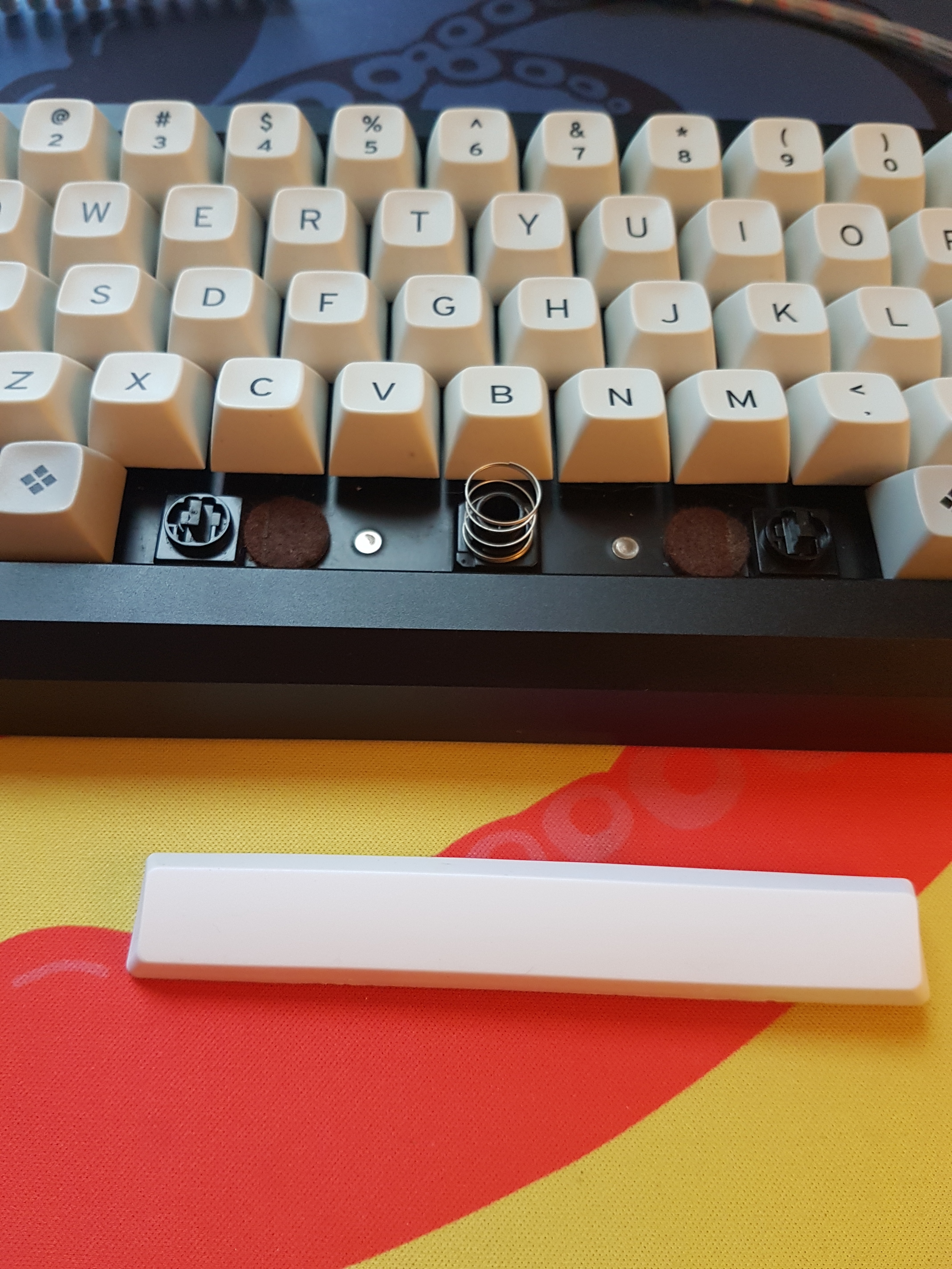

Okay, so there’s 2 main things I’m doing with my Heavy-6 to silence the keys. One is that I’m using hyperspheres for all of my keys to silence the upstroke, but my spacebar gets special treatment because its loud AF.
Even without silencing rings you can get a pretty big sound improvement by picking up some felt pads from the hardware store for $2 (like you might use to silence a cabinet door) and sticking a couple where your spacebar lands, like so:
That, on its own, will make a big difference and makes the bottom-out of the spacebar feel nicer too.
As for downsides, I’ve found that my hyperspheres reduced the tactility of my keystrokes by “one notch”, if you think of the Topre tactility scale as something like this:
45g Topre < 55g Topre < BKE Light < BKE Heavy
I used to use BKE lights but when I got my hyperspheres the tactility was less than what I wanted, so I ended up buying heavies to make up the difference and now it feels great for me. So basically my BKE heavies feel similar to BKE lights unsilenced now and that’s perfect in my books.
Thank you! The space bar is by far the loudest and most noticeable “clacky” key. I’m going to try the felt pad mod as soon as possible!
Yeah, absolutely. Once I started making recordings and listening to them it really stood out as being several times louder than any of the other keys and clearly a good target to make the board quieter.
It took me a couple of attempts to find the right thing to quiet the spacebar down but I’m really happy with these felt pads. Easy to apply and remove, cheap as dirt and they take just enough noise off of the spacebar to put it in the same territory as the rest of the keys, so it blends right in. Depending what’s at your hardware store you might have to try a couple things to get the right thickness so it doesn’t affect your spacebar travel too much I guess, but that’s about the only thing that you’d have to pay attention to.
