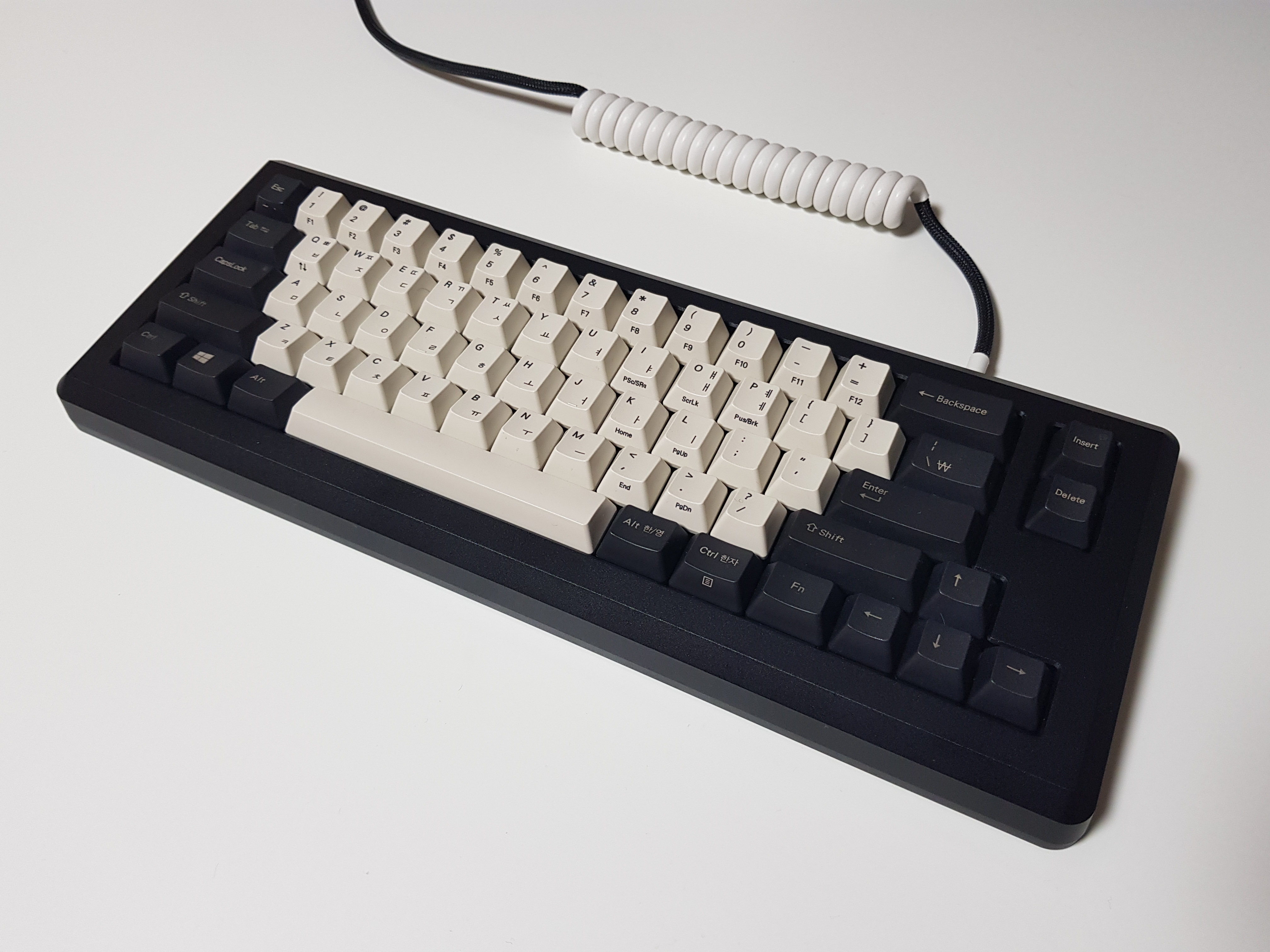

What keycaps do you use?
Factory leopold caps from two keyboards. Alphas are from the beige/grey fc660c. Mods are from the white on black fc660c. I originally wanted to get Novatouch sliders to put GMK Monochrome on it but I feel much better sticking with the factory sliders.

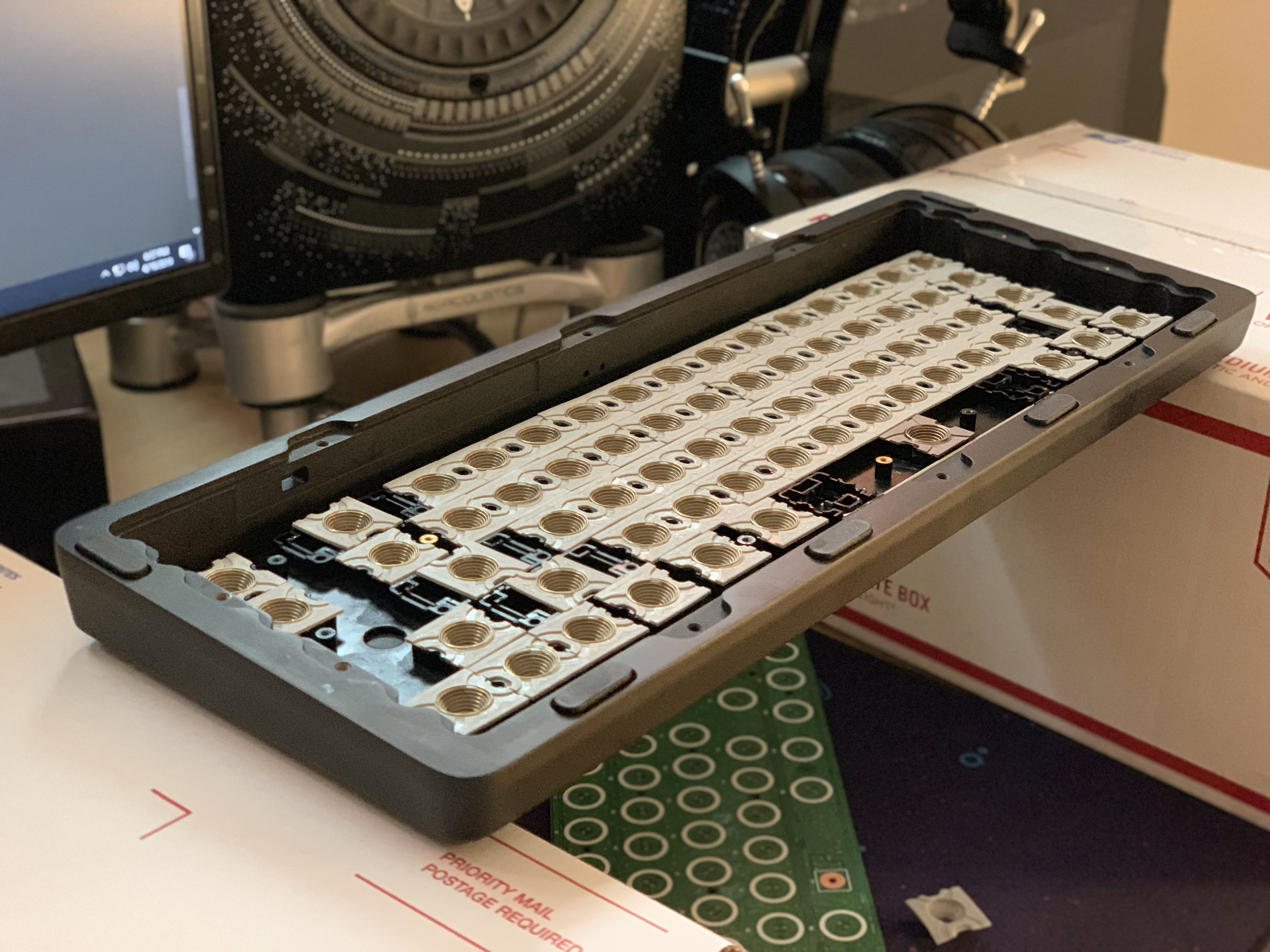

edit: above question was along the lines of “why mount the plate to the case before adding the PCB to it/assembling fully”
The plate screws into the PCB. I found the easiest way to assemble this was to screw the plate into the case first and make any modifications you want after that, with the plate already mounted solidly on the case.
This confers a variety of benefits - namely, you are much less likely to accidentally move the plate around because it is now one with the heavy 7lb case. Also, bezel of the case gives you a bit more room to “hook” it onto the boxes or platforms on either side, further reducing the room for error (where normally I’ve had the steel plate slip off of the boxes before and ruin all of the work put into assembly).

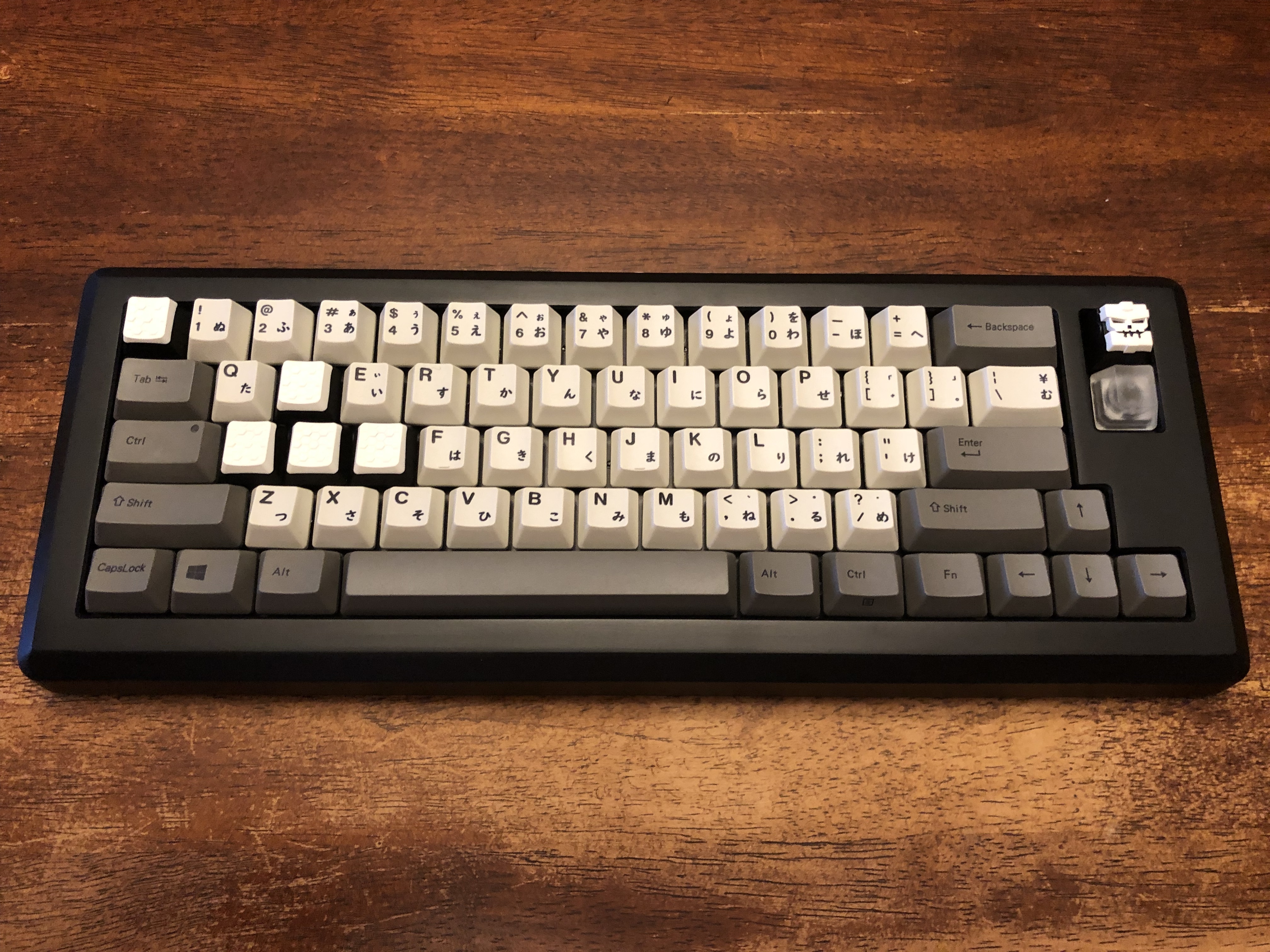

@ whalematrontron Very Nice! Did you cast the mods yourself?
They’re from Blizzardmods - he does raffles once in a while, although I bought them off another user on mechmarket.

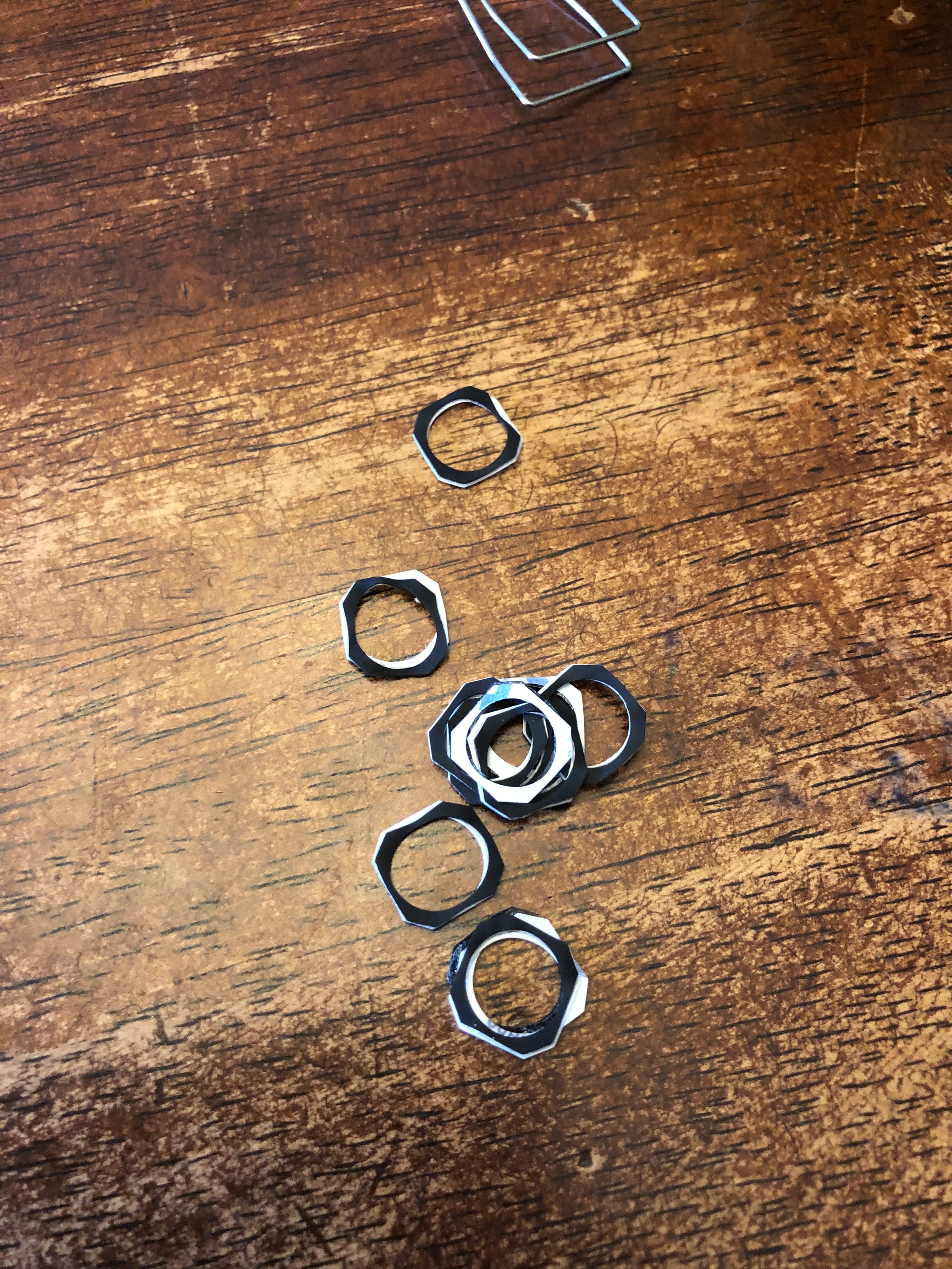

For what it’s worth, the biggest time suck was taking the backing off the teeny tiny rubber upstroke silencers and applying them.
These things are the devil.
And since there were aftermarket domes (BKE Redux Heavies) the silencers were absolutely necessary. Like, totally non-negotiable. I’m not complaining, I’m very happy they were available. This thing would sound like a jack-hammer without them.
