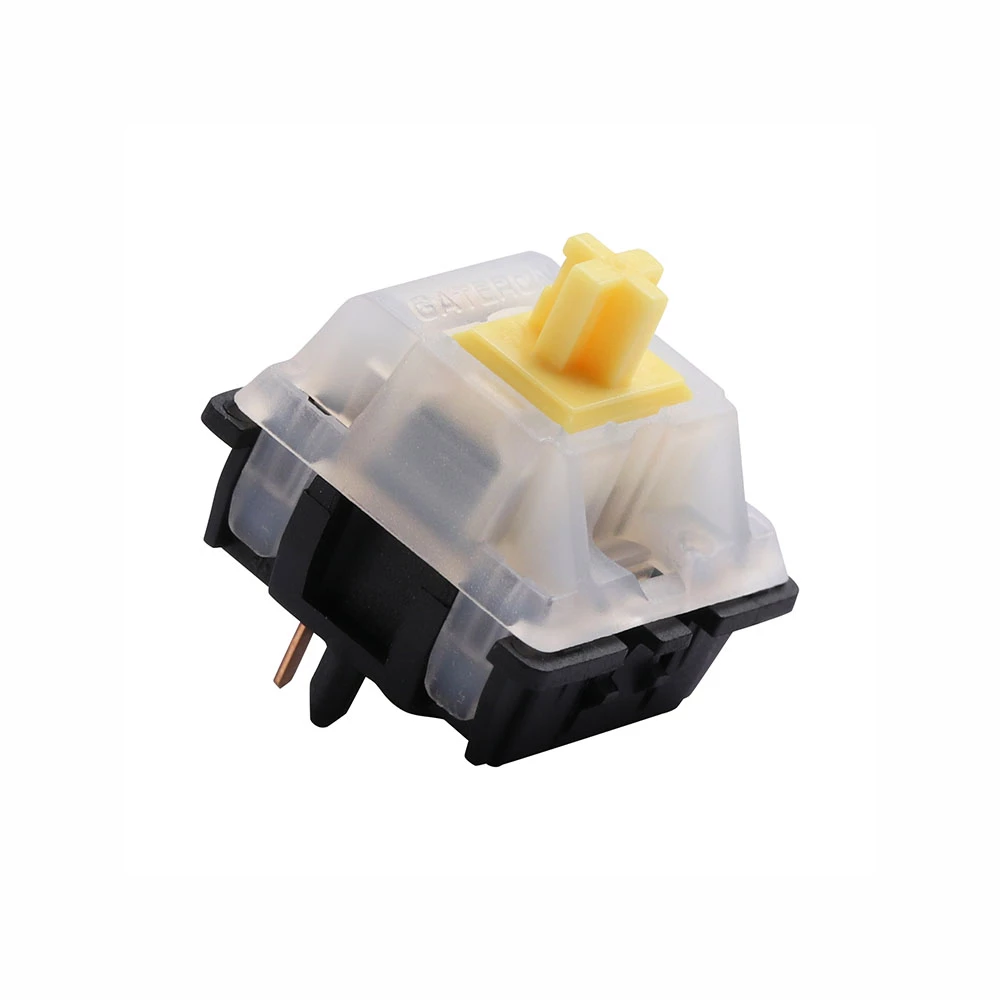

→ Specifically, I’m hoping someone out there will be able to help me find a visual distinction between a normal KS-9 and a KS-9 Pro 1.0, but I’m sure there’s plenty more Yellow-related trivia that could be added here.
Edit: figured it out. Pro 1’s have a little bar of plastic in the middle of the LED slot (helping to avoid deformation during removal), and from what I can tell, original KS-9’s do not.

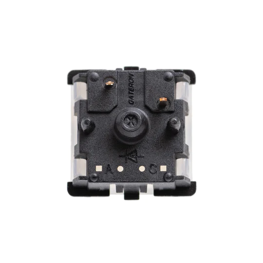

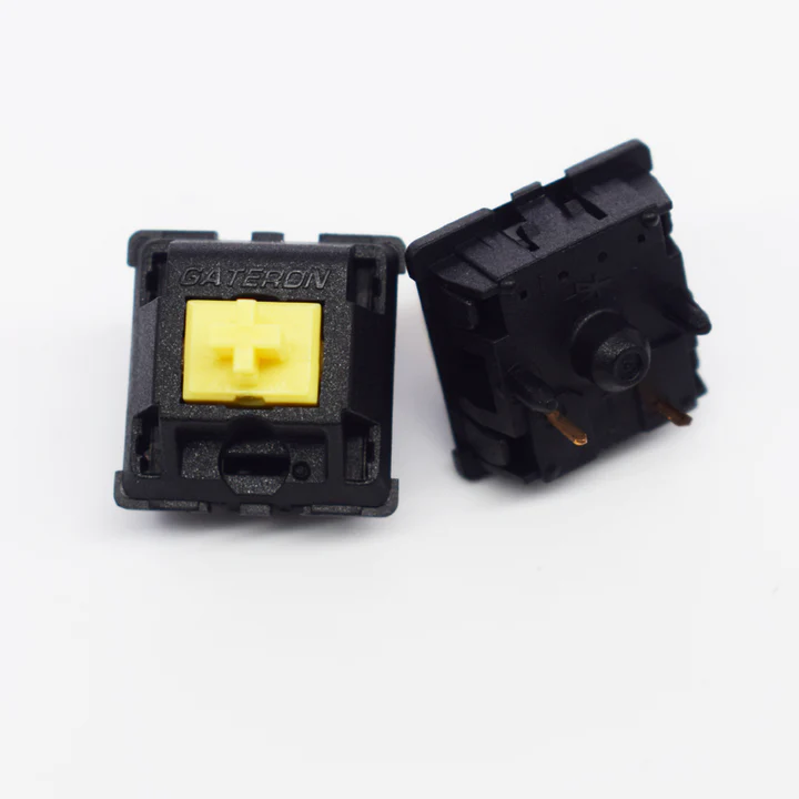

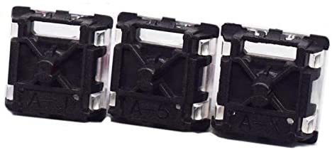

  • KS-3 series: The all-black one. These have a housing shaped to accept round, two-pin LEDs. I’ve seen some sources say the housing is Nylon (polyamide; semi-crystalline thermoplastic) and other sources say the material is unknown, though I think the general consensus is that these are Nylon.

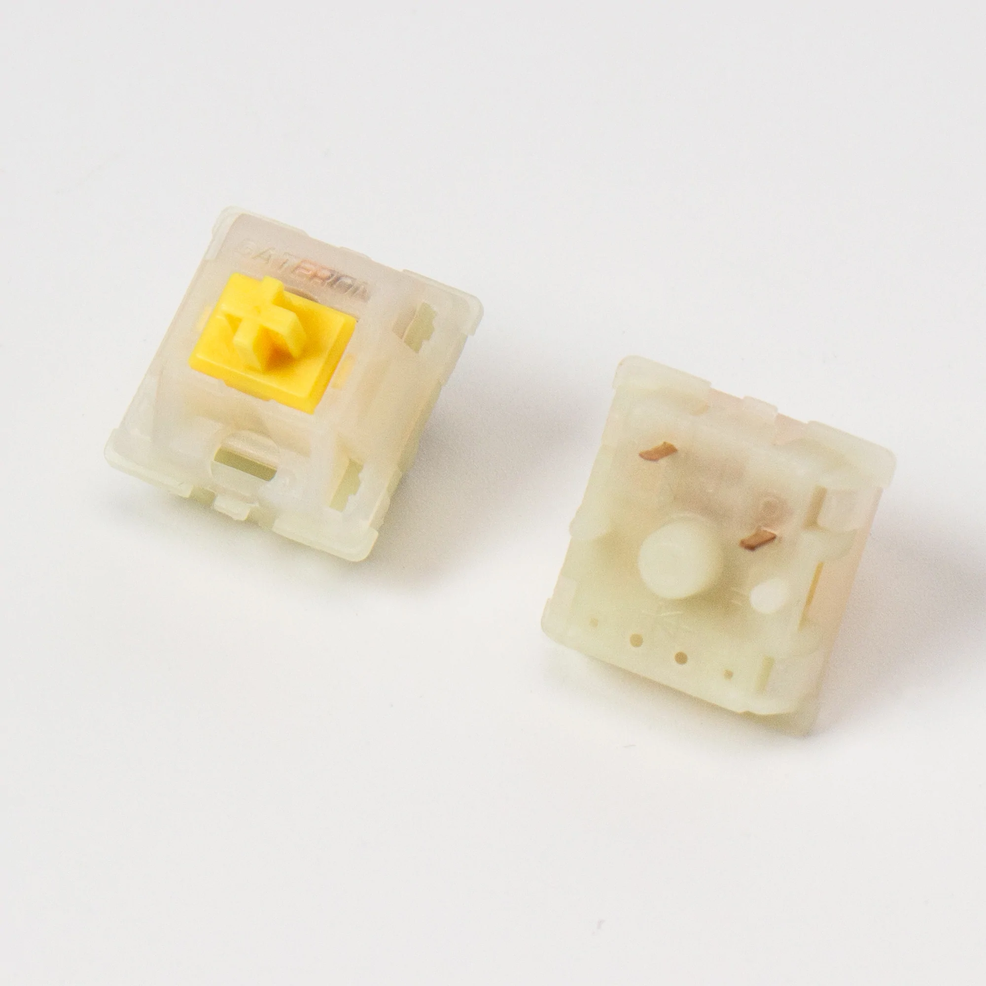

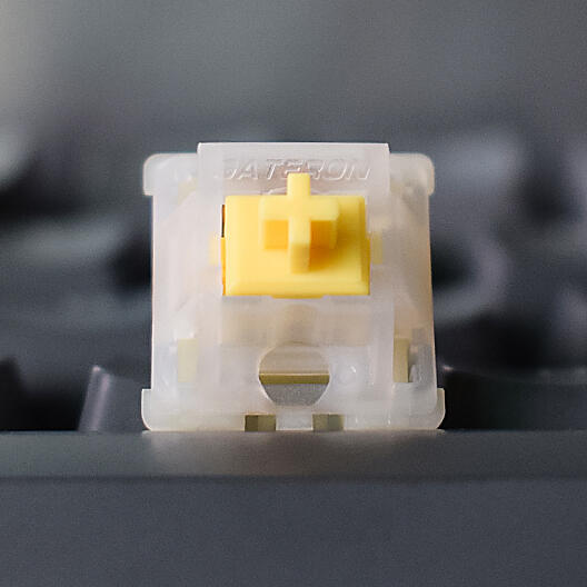

  • KS-3X1 Milky: The all-milky ones. I’ve yet to see a definitive ID on the actual plastic used for these; it’s generally softer than the black plastic used for KS-3s. I’ve seen some vendors say it’s a Nylon-blend. With the examples I possess, the 3-X1’s have a different mold both for the top and bottom housings when compared with a KS-3. I’ll also note I have some of these with the little curve carved out of the leaf side of the housing, and I have some without.

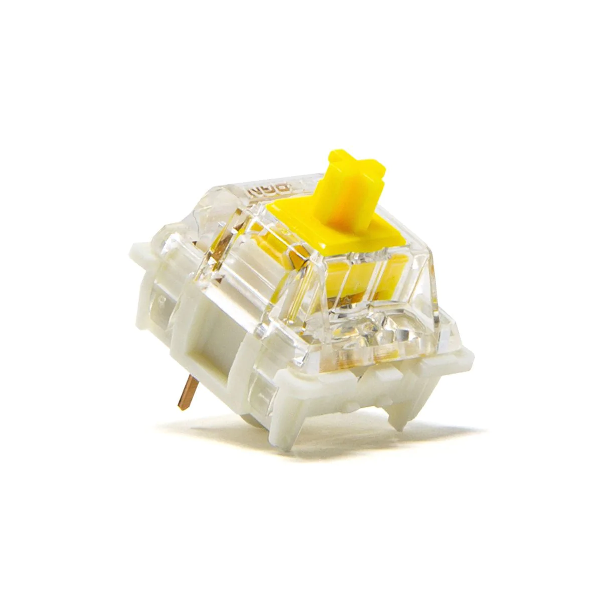

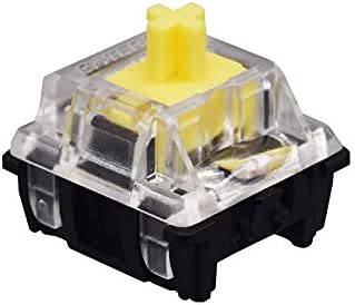

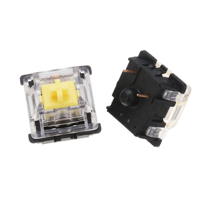

  • KS-8 series: Black bottom, clear top. I’ve also seen these with white bottoms. This clear top has a slot opening for the LED, and supports jumpers or diodes in addition. This is actually the first kind of Yellow I tried back in like 2016 or so, and I remember them being smooth but a little hard and wobbly feeling.

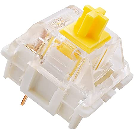

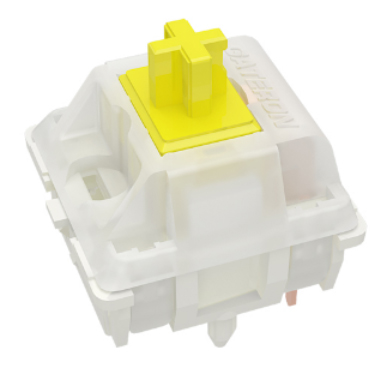

  • KS-9 series: White bottom, clear top - I think. Here’s where confusion genuinely enters the picture for me. I understand that the cavity in the bottom housing that accommodates SMD LEDs is a hallmark of these, but that’s about it. I have mostly seen switches sold as “KS-9” with white bottoms and clear tops, but Gateron’s own render for the product appears to show a milky top. Further complicating the KS-9 designation is the fact that that the “Pro” versions appear to be a direct branch from it. At least some of these have the housing curve, but I’m not sure if all of them do.

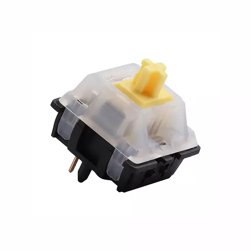

  • KS-9X14 G Pro: Tthese are an updated iteration of the KS-9 that utilizes updated molds and a new factory lubing technique. As of writing, the Pro series is in its second revision (branded as 2.0), differentiated by a more transparent top housing that has a shaped light lens over the LED cavity, making it only compatible with SMD LEDs. I believe both versions have the contact-side top housing curve.
  • KS-9Y35 G Pro 2.0 - this version is visually distinct from other lines, being the only one I’m aware of that has both the light lens and metal contacts, but as far as I can tell, the 1.0’s only visual differentiation from regular KS-9s by the presence of that small bar of plastic in the middle of the LED slot, which I belive helps avoid deformation during removal.

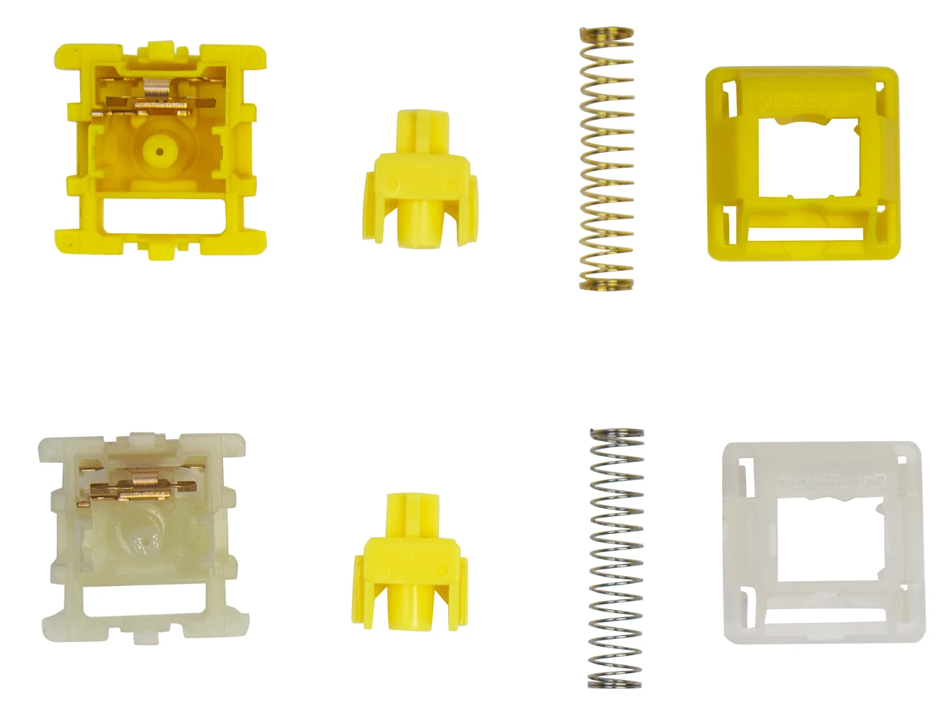

  • KS-25 CAP: Currently in its second revision, these use the more recent CAP design with the stem going around the inside tube instead of inside it. This tends to provide a more stable-feeling travel. All of these have the contact-side housing curve. There are milky and yellow-gold colored versions of these which I believe do have different housing materials as well as different colored springs, but the weighting is the same and they are otherwise very similar. As far as I know, both versions of both colors fall under the KS-25 designation.

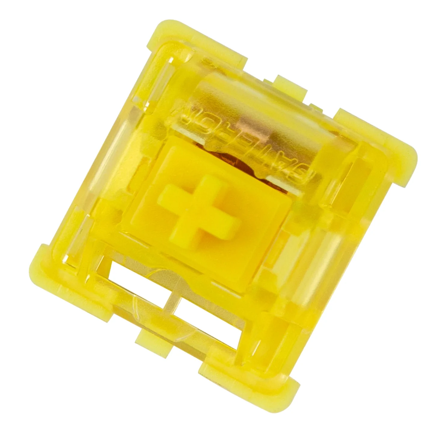

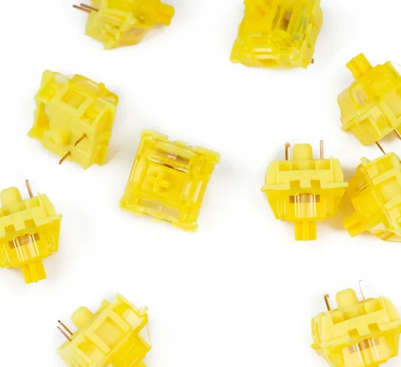

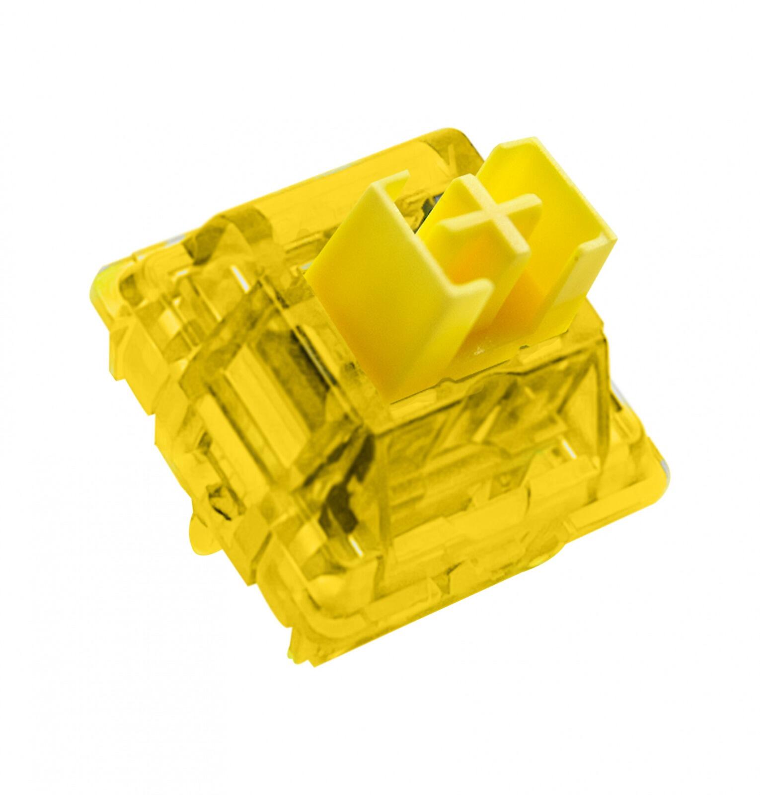

  • KS-8X62 Ink Yellow: Transparent yellow housing, dust-shrouded stem. Made with a proprietary plastic blend in the housing and features a shorter travel and actuation distance. I haven’t seen any of these with the housing curve, but it is present in Gateron’s rendering of the switch (which oddly does not feature the shrouded stem present in the description on the same page). Supports through-hole LEDs as well as jumpers and diodes.
    Ink Yellows have “box” stems but aren’t referred to as-such by Gateron
    Weird render that looks more like a Phantom Yellow

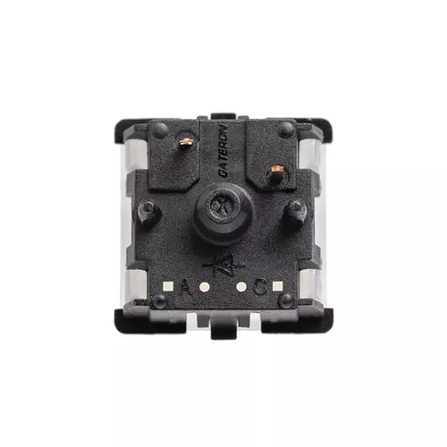

  • KS-3X47 X / Gateron X: Milky top and black bottom like the KS-3-X47, but featuring a new housing mold. Visually distinguishable by a letter “X” engraved into the divot of the large center pin. These are supposed to have polished surfaces and improved tolerances, but I’ve yet to try them myself. I’ve only heard good things, though. As far as I’m aware, there’s no overlap between the X line and any of the others like the Pro line. This is not related to Drop’s “X” branding. All of these appear to have the housing curve and support through-hole LEDs as well as diodes and jumpers.

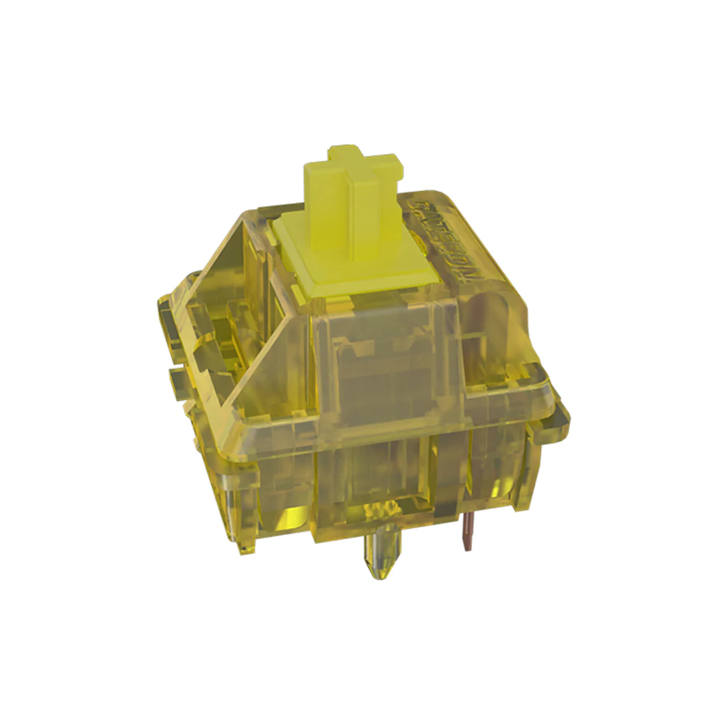

  • KS-7Y32 North Pole Yellow* : This all-crystal-clear switch gets an asterisk because I’ve only seen the switch referred-to this way outside of English-speaking circles, but I’ve seen it so I’m mentioning it. I’ve seen varying reports on the materials used for these; most English-language vendors are saying polycarb housing and Ink-material stem.
    So far, I’ve only seen “North Pole” as a single switch here in the US, but Gateron’s site calls it a “series” - and Chinese retailer mechkeys.com sells three different versions of this glassy-looking switch: Yellow, Red, and Silver. On this site as well as Gateron’s, I’ve seen images of the switch both with and without a dust shroud - not a thin-walled one like the Inks have, but one with a circle cut out of a rectangle, like TTCs and some others have. Apparently the shrouds follow the Gateron convention of visually indicating shorter-travel switches, though unlike in other series, the Red is included in this shorter travel / speed category. Only the Yellow has a regular stem - so it looks like this is the version we got here in the US that’s just called “North Pole”.

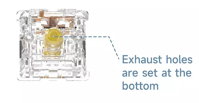

  • There’s also now a 2.0 version of the North Pole that adjusts the clips and adds a color-coded exhaust port - so not only can you tell the 2’s from the 1’s with this colored area, but they are also color-coded with Yellow, Red, Silver - Yellows being the ones sold sometimes without a color distinction.
    Thanks to @d3L7r0n for pointing out these exhaust bits also functionally act as dampening for the down-stroke.

The milky Pros are for real, IIRC they use a new bottom housing mold, the pro stems (new mold again), & the OG milky top mold still. I got a batch & they are markedly smoother than pre pro all milky yellows I have. The sound is pretty much the same & the milky pros have a little less stem & housing wobble.

I have both the V1 and V2 of the North Pole switches. The V2 “exhaust” port ends up significantly reducing bottom-out to the point of making it almost a “half-silent” switch, in my opinion.
I was not aware they were marketed as Yellows. Thanks for the info, as always!! :+1::+1::+1:
