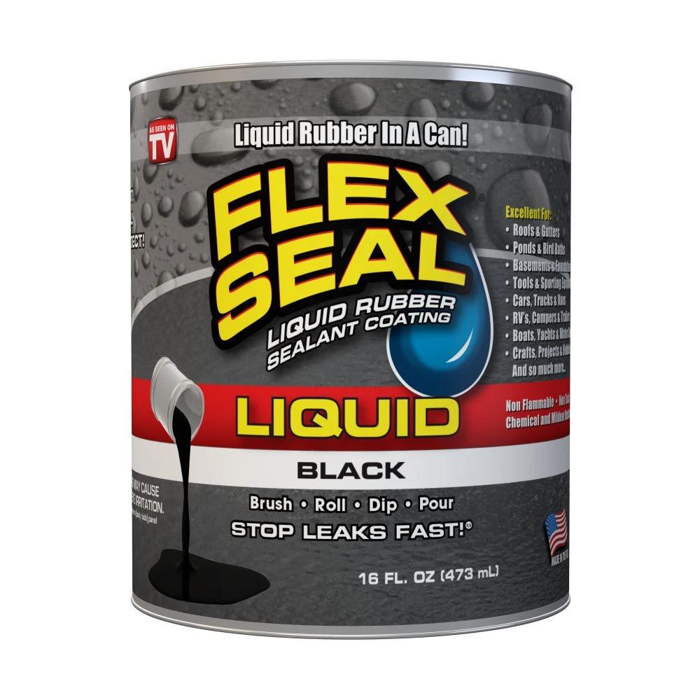

Aight someone please go with this under your PCB and tell me how it goes :joy:
