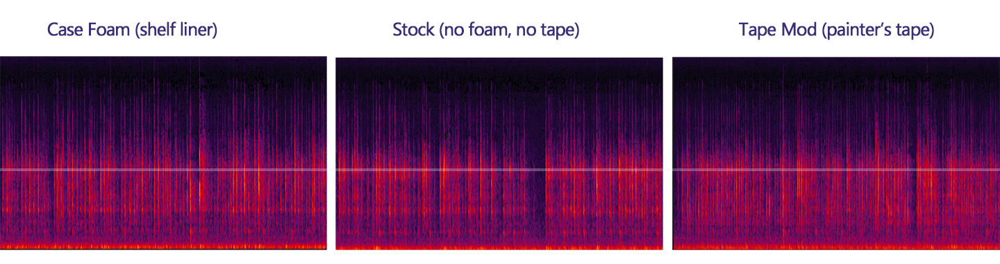

I built my Obliterated 75 yesterday. It has Lavender Durock switches (Nylon). After I got it assembled with case foam, I didn’t like the sound. So I decided to try the tape mod. I took recordings of (roughly) the same typing test back to back. Pretty interesting results. To my ears the tape mod sounded the best.
This morning I tried to do some quick science, even though I had not planned to share the experiment. But it turned out too interesting to not share!
I took the hastily recorded memos from my iPhone into Adobe Audition and opened the spectral frequency viewer. Here are the results placed side by side in Photoshop. I labeled the data below. I put a thin white line around the 3k Hz level for better comparison.
My analysis is that the case foam (first chart) seems to even out the frequency in a way that prefers the full range of the spectrum as compared to the stock case (second chart).
Then we have the 3rd chart, the tape mod. It looks even more evened out, frequency-wise. But this mod tends to spread the sound out very smoothly on the mid to lower end.
In terms of science, this is extremely crude. That’s mostly because I had not planned to share the results. However, neither the phone nor the keyboard moved positions. I typed the same phrases, and the tests were done back to back within seconds. I did the tape mod first. Pulled it off and did the stock test. Lastly added the foam back into the case. There is quite a bit of noise contamination from ambient noise, but I’m standing in a large open room with nothing of note changing throughout the experiment other than the modifications.
I suppose it’s possible my iPhone could have done some noise reduction trickery which would make all this data meaningless.
Evened out sounds to me like tape mod is trapping sound. Tape mod also seem to trimming (cleaning?) high frequencies. The chart matches well with my observation of the tape mod effect which is rounded clacks with improved thocks.
I guess the tape won’t let the PCB vibrate as freely, so the lowest and highest frequencies will be dampened a bit because the board won’t resonate as much.
And my personal theory is that some boards become louder because the whole PCB will vibrate instead of just a section once the tape is proplerly stuck to the whole pcb. But I’m not sure why some do and some don’t.
