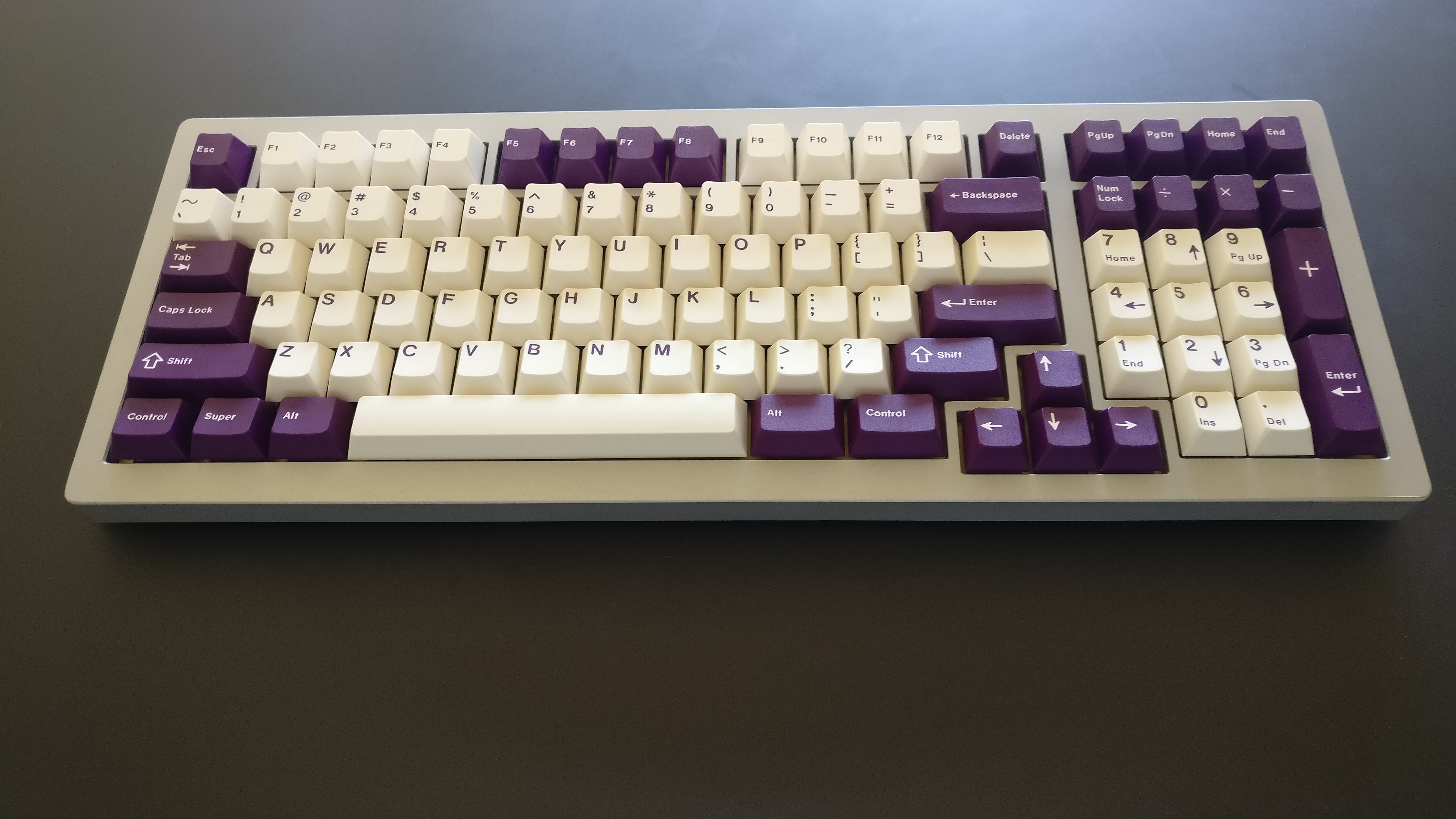

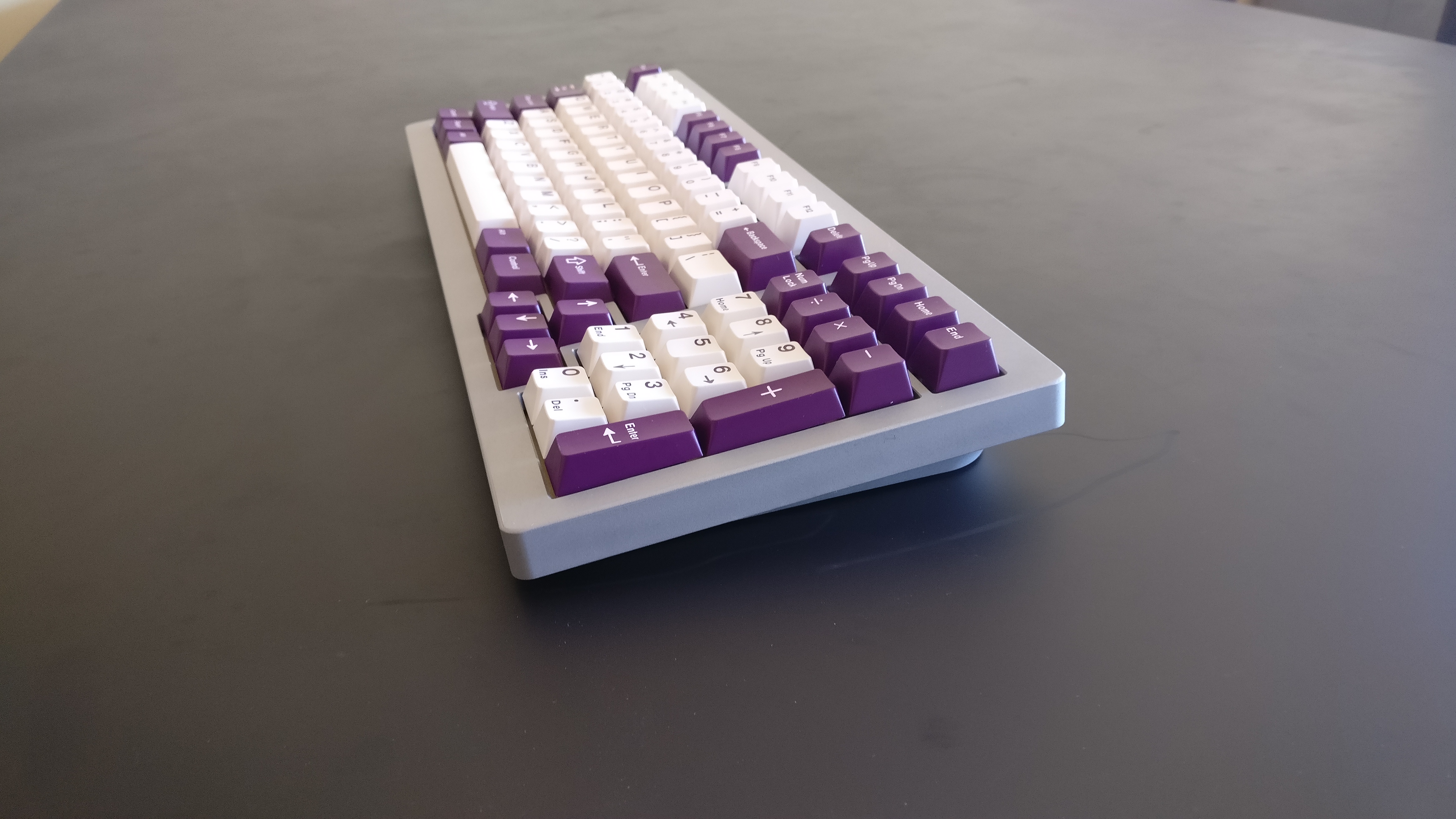

Lastly here is the Winghead build 3, this was the last keyboard I had to make.
I ordered long time ago Thick Thock DL springs 62g.
Was planning to make ergo clears with them but two unexpected events came recently.
  1. I LOVE my Gat yellows and linears in general, I will probably never take the tactile route again :smiley:
  2. I could not find Gat yellows in stock.
So decided to use these springs with Gat blacks with the hope I could have something similar to the Yellows (and indeed it is).
This time I bag lubed the springs with Krytox GPL 105, stems (only them) still lubed with Krytox 205g0 but with a tad thicker coating to see how it goes.
If you lube only the stem like I did (and like does @jshufelt for quite a long time), applying a thicker coat does improve the smoothess without any bad consequences.
Used same brass plate with same sorbothane+foam treatment as the other ones.
Put my last keycap set to good use, Hiney’s VOC .
Here is the result (sorry for the very bad lighting):

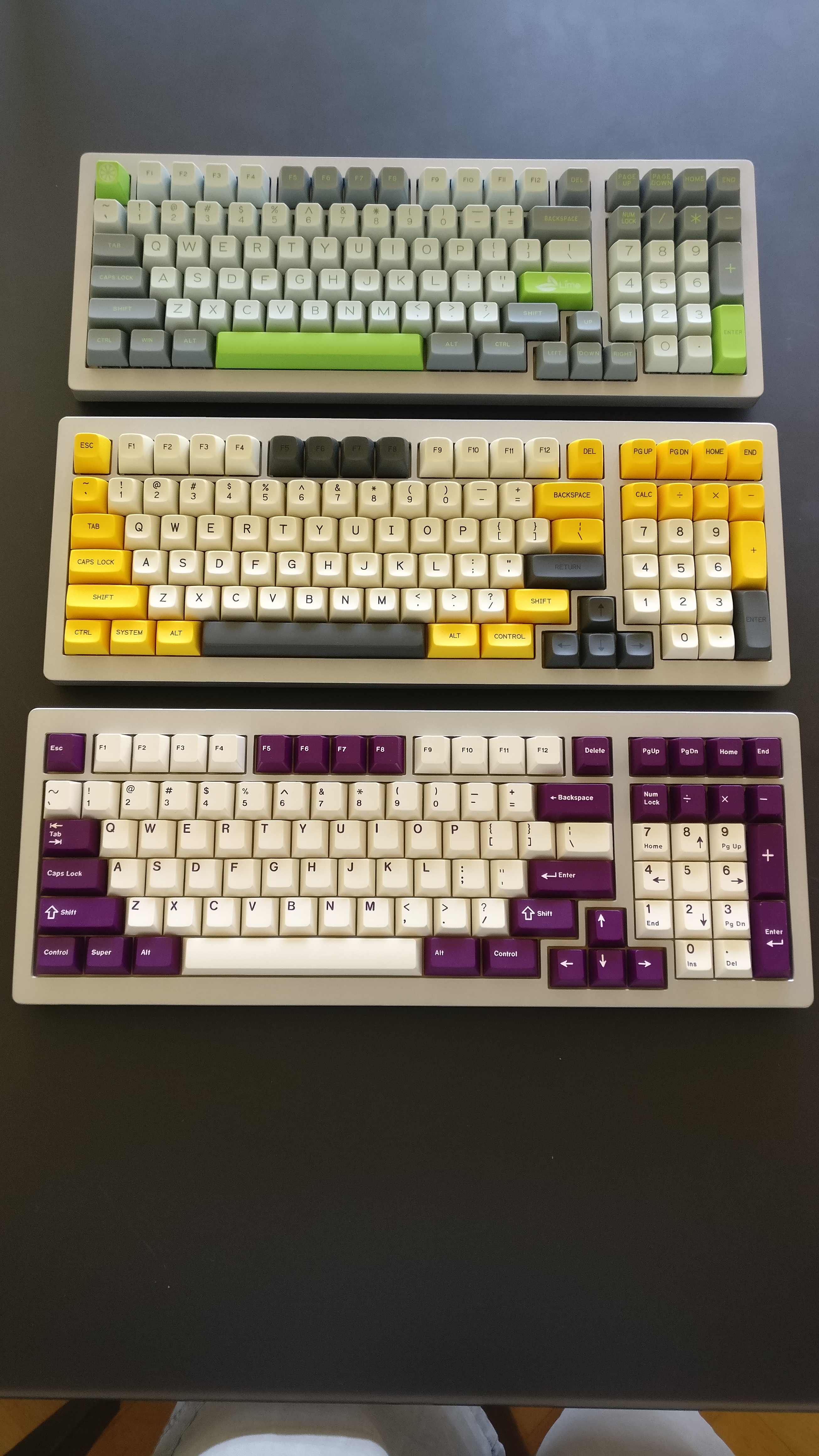

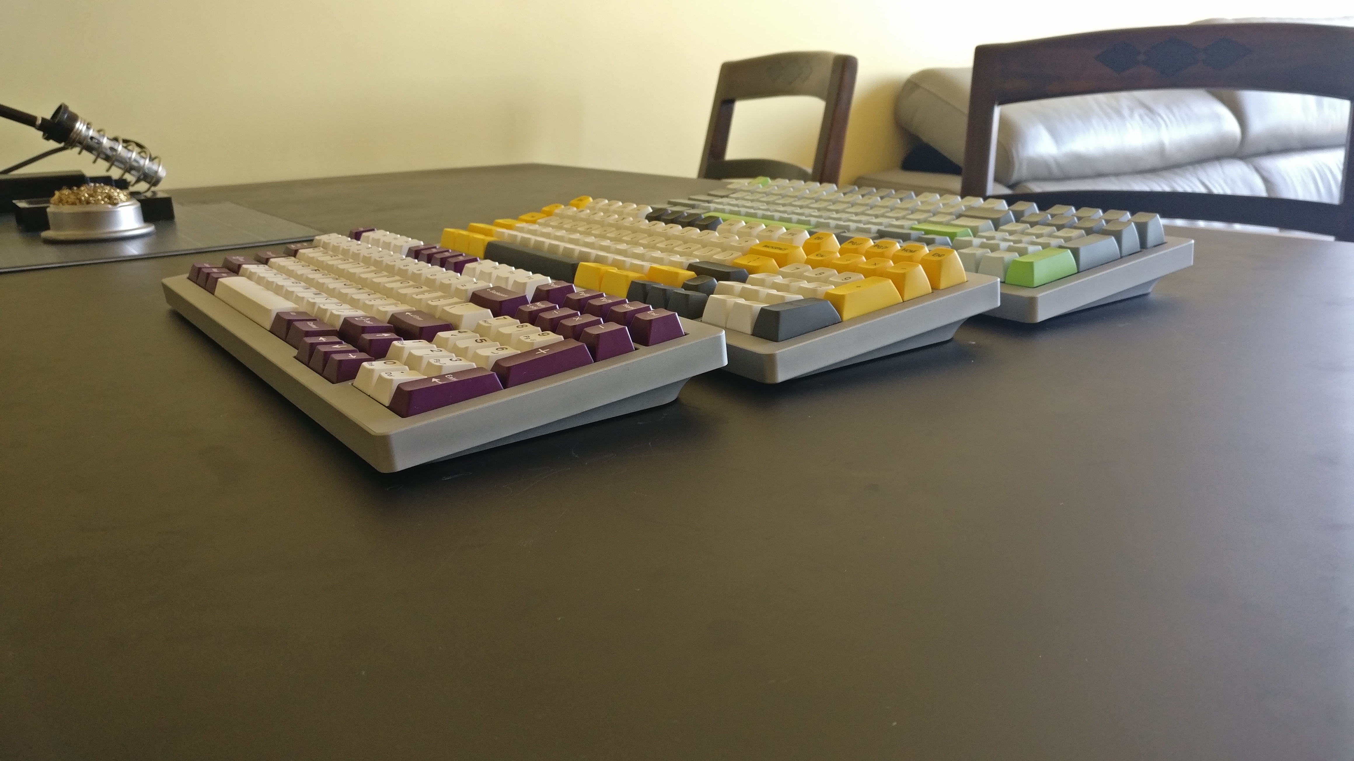

The collection is now complete and will very soon be dispatched to different places were they’ll have their use.
Took some pictures of the 3 brothers altogether before they live their happy life alone.
